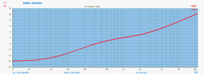

No comments on the RIAA feature?
You asked for... ARIAA.. using upcoming V3.50 and using the FFR (Fast Freq. Responce) feature 😀

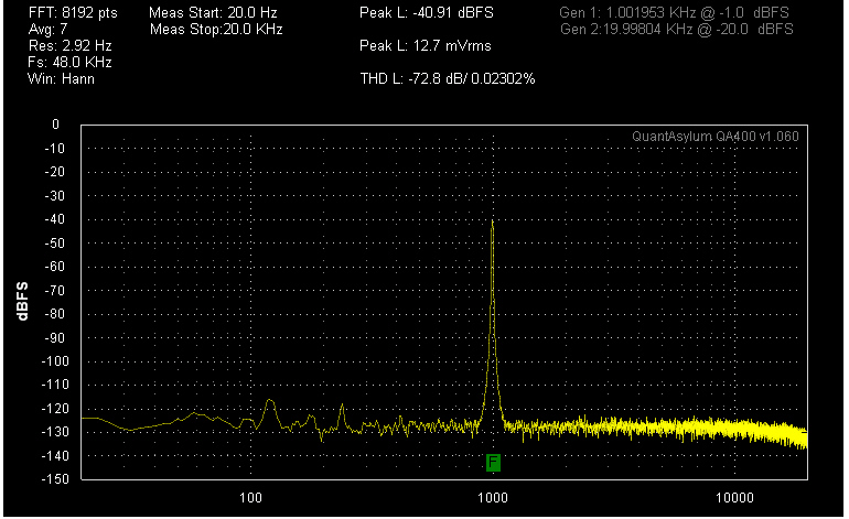

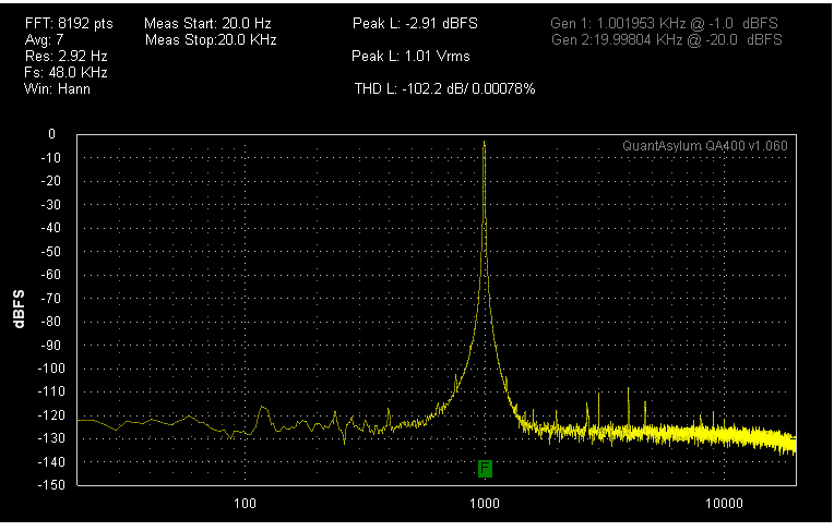

To those who know more than I do, I have two questions:
1) Why is the bottom of the sine wave so narrow from the internal oscillator and wider on the external oscillator? (looking at the -100 to -130+ dB range on the 1K signal)
2) Why is there some 60Hz noise on the images with the external oscillator. I'm assuming cable routing or some AC device close by (or maybe agdr's cat from earlier pictures!)
Thanks everyone for the information!

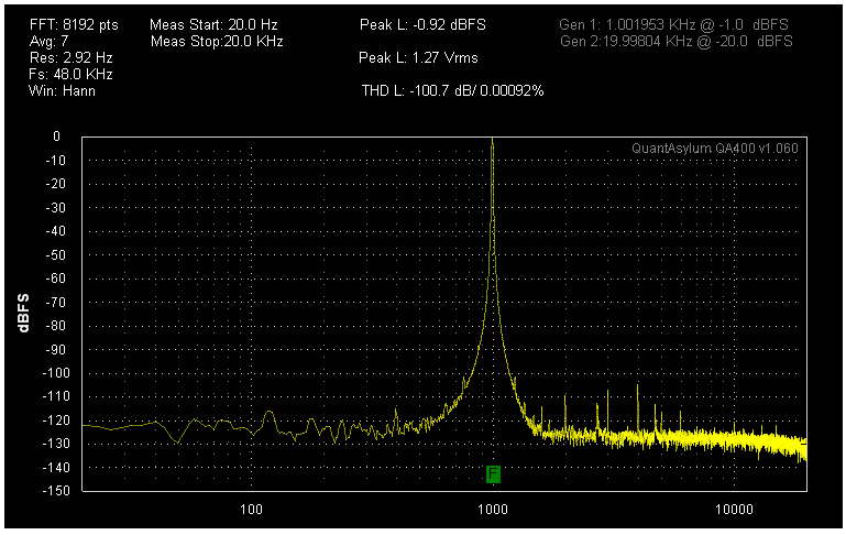

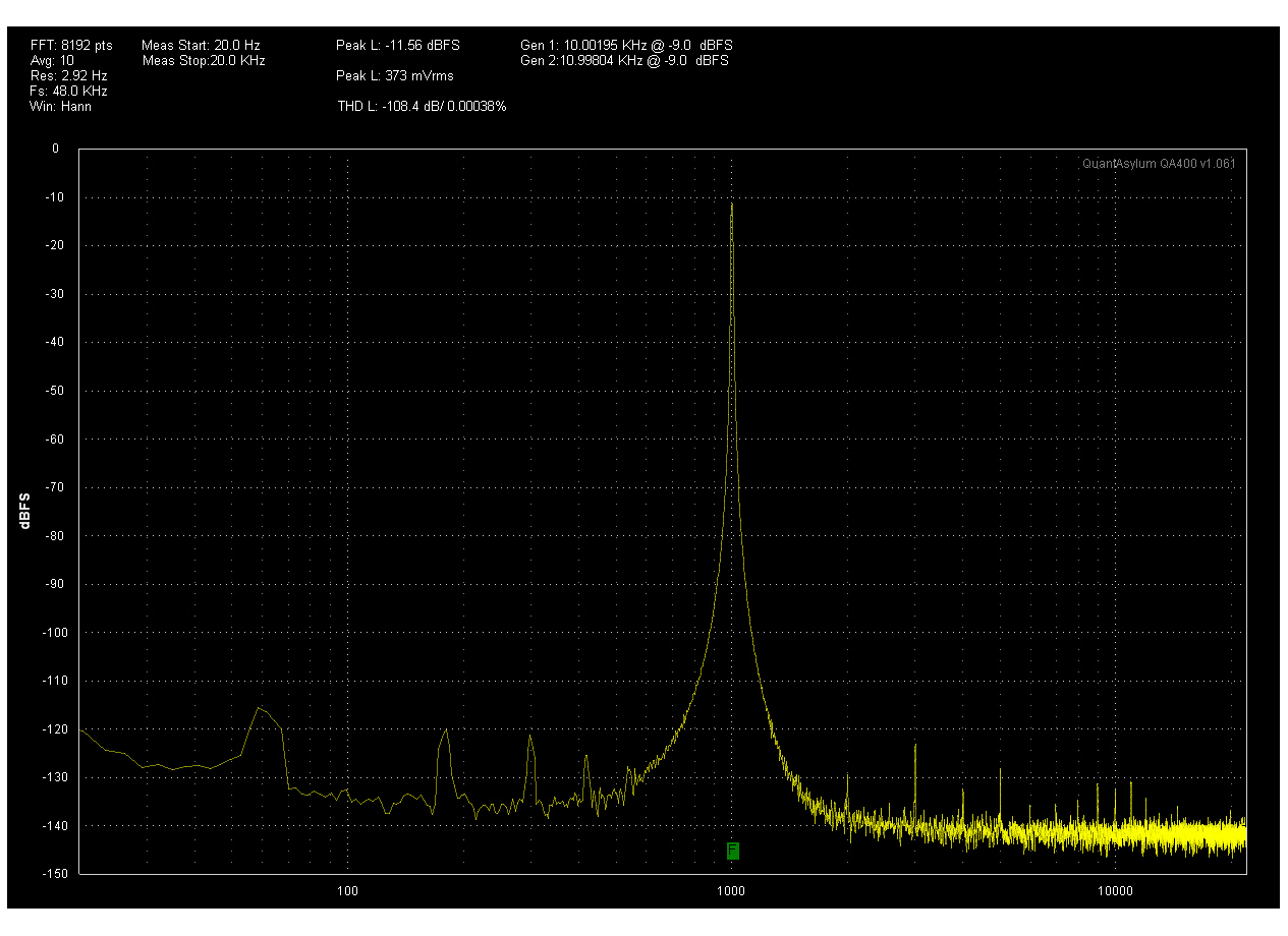

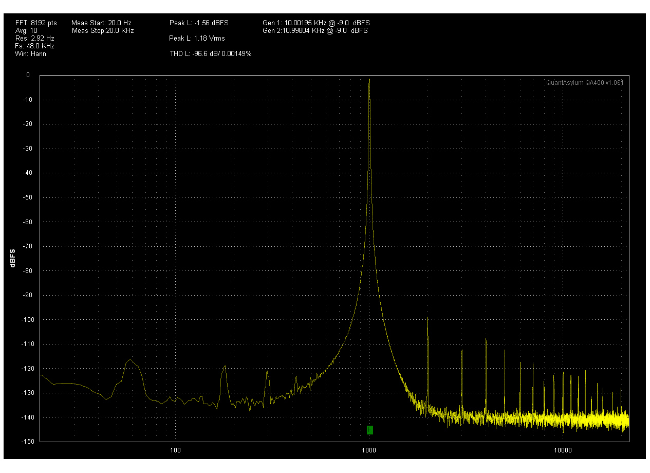

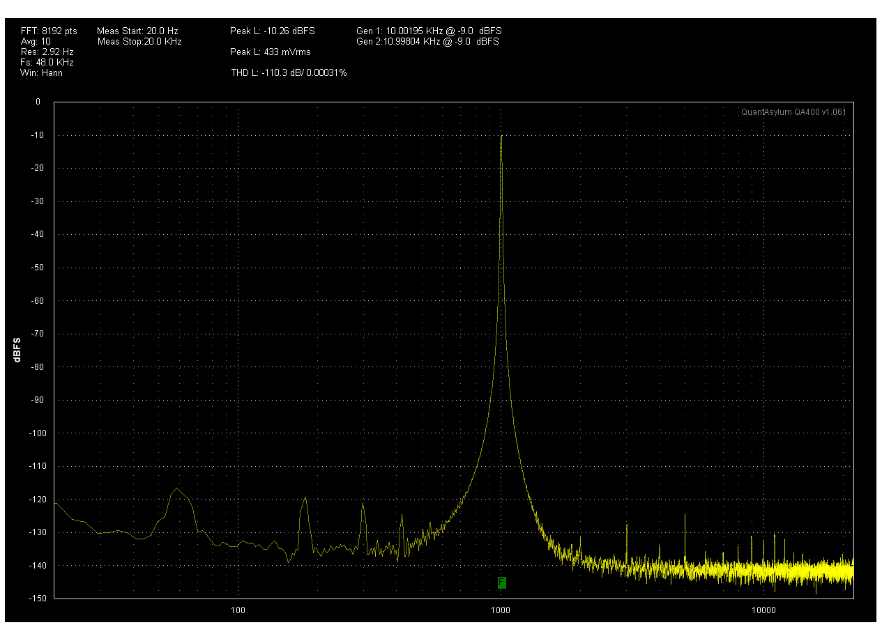

I own a QA400 almost ca. 2.5 years, and I only noticed this now.
As the input signal reduced down from 0dBfs, the THD improves, and it improves a lot. Am I doing something wrong?
The signal is coming from Victors 1kHz oscillator.

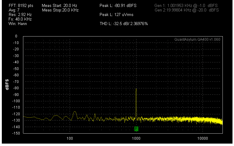

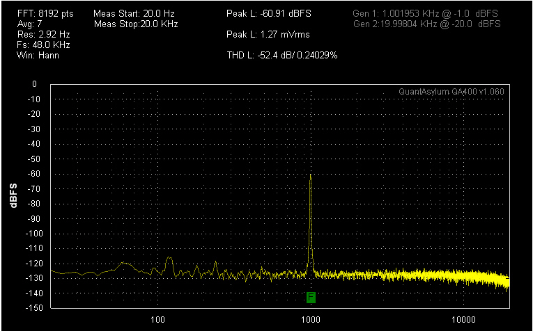

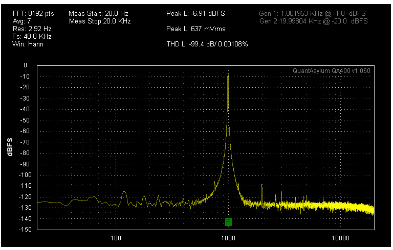

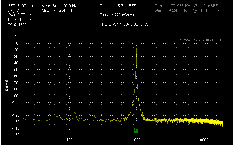

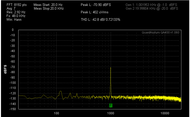

Monotonicity
Measuring a CD player with a test CDR made in CoolEdit shows perfect monotonicity (I think it's called that).
I know some players don't like the 0dBfs signal, so early I included in the measurements the -2dBfs level.
Going down on the level scale I have, 0, -2, -6, -15, -40, -60, -70, and -80dBfs in the pictures.
I dont think you are doing anything wrong. I found similar errors. So, I had to compare to more accurate instruments to see the 'real' values for thd.
-RNM
-RNM
-RNM
Thanks for the reply, and what did you come up with?
What max dBsf level the most believable? Would be nice to know.
I saw that around -10dBfs prvide the lowest THD reading.
The measurements are repeatable, so for comparison is OK, but not for absolute measurements.
I wonder from where the problem arises , is the circuits (if any) before the ADC, or maybe some kind of power supply problem (to low voltage)?
I guess it's no circuit diagram available for the unit.
Regards.
Late to the party but simply put, QA makes use of coherent sampling(the oscillator frequency is always set according to the fft bin length).
If you take a look at QA measurement plots, the 1khz test frequency is never matched at 1khz but offset a little so that an integer number of cycles is always captured within the FFT length set. This results in almost no widening of the skirt. O
You can easily do the same with a calculator and a little math in ARTA or similar programs if you are using a DAC. Using a QA unit does this automatically for you.
