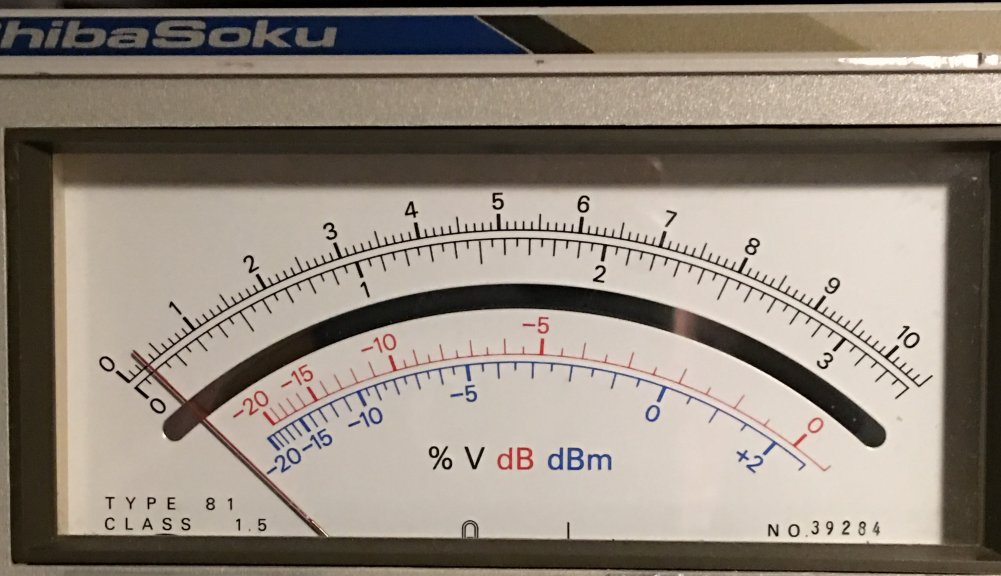

You converted from percent to voltage.
The meter is FS 100% @ 10. If you read 1 on the meter that is 10%
10% of .001% is 0.0001%. % to voltage is %/100. So 0.0001% /100
0.000001 Vrms or -120dBV
Doing the math
David,
If I follow your example above, 10% of 0.001% is:
0.1 * 0.001 = 0.0001 Percent.
At the 0.001 Percent METER RANGE setting
FS (Full Scale) the needle would be on the 10 mark.
Following the needle down, it would correspond to 0 dB.
IF the needle was in that position it would correspond to -100dB.
The Meter Scales are concentric:
V
dB
dBm
In the example that you gave above, on the percent scale (upper)
IF the needle was on the 1, that would correspond to
10 Percent OR -20 dB change to the METER RANGE.

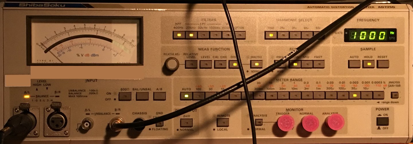

NOTE: To those following the 725D has a series of push buttons
to the right of the Meter, see the attachment.
I would multiply 0.1 * 0.001 = 0.0001 Percent
OR
add -20 dB to -100 dB, -100 plus -20 = -120 dB.
I think 0.0001 percent equals -120 dB (approx.)
In the indication below (for the sake of argument) on the top scale
the needle indicates point 3 (.03 percent). The mid point to the
number 1 on the meter would be point 5 or .05 percent.
1 corresponds to 10 percent or .1 %.
So the math would be:
0.03 * 0.001 = 0.00003 percent or right around -130 dB.
If my statement's are incorrect please assist as I have to re-think.

Your numbers are correct, however levels below 10% of the meters range are going to be of degraded accuracy. This is where an external calibrated FFT becomes very helpful.
Victors oscillators can have harmonics in the -140 dB range. The newer ones are better than my first gen samples. I will buy an updated set soon.
Okay, got it Damien, I thought I was doing the numbers correctly,
this is where the button on the far right side of the METER RANGE
buttons, we press it for an additional -10dB of gain, which puts the needle
above the 10 percent range.
When I've done this it corresponds to the 725D's under 10 percent indication.

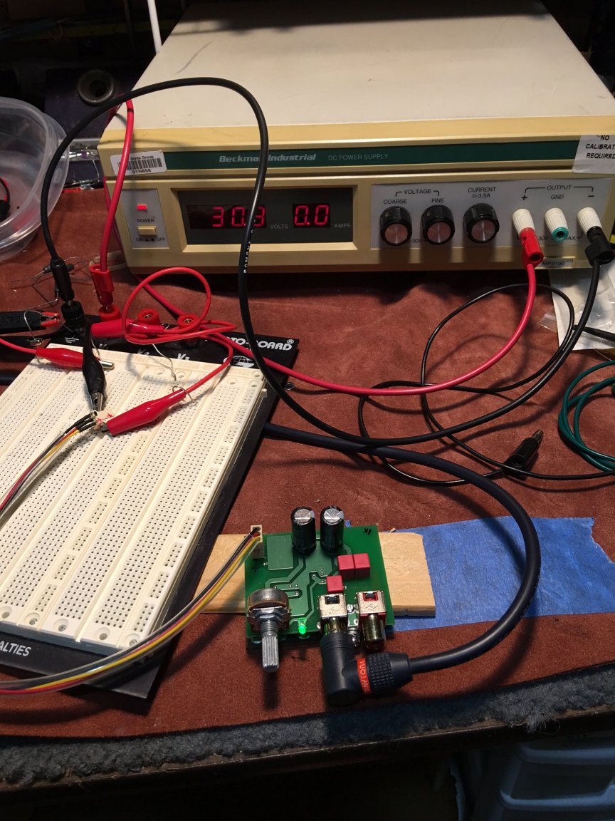

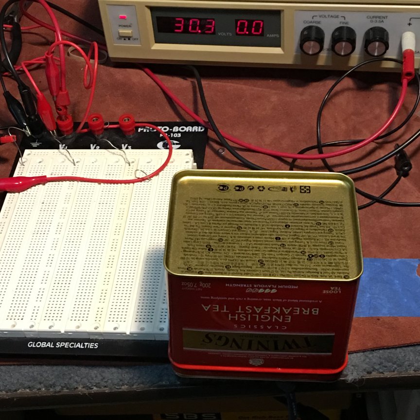

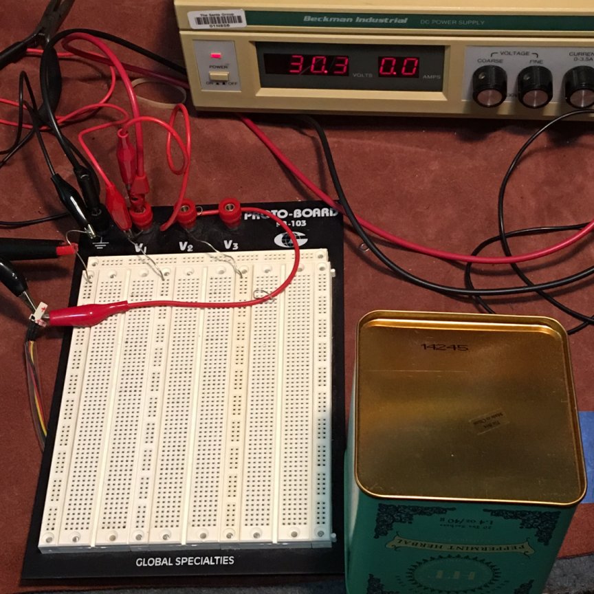

So yes, I did get my Victor's Oscillator working again. Lambda Power Supply
wasn't so good with Oscillator. Measured 0.1 percent on 0.01 percent scale.
For THD of 0.001 %. 400Hz and "A" weighting.
Best was using a Beckman Medical PS at battery voltage specs.
That was four 9 V batteries?
It lowered THD to .1% on .001% range. The can didn't make
a difference with the lower battery type voltage range.

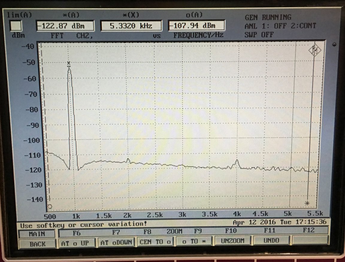

Here are two pics, one of the set up, the other is the FFT.
FYI - the tin didn't make a difference, neither did the
tin's orientation. In this case I used the 30V PS, the
max it could do.

Point 3 on the meter is 3% not .03%. 3% is the fraction 0.03 and your result is correct but your sticking percent in where it doesn't belong.
The meter is scaled 0 to 10 which is 0 to 100%. The meter scale is not in percent it's a factional part. If you want it in percent then multiply the meter reading by 10.
Sync-
Below -100 dB (.001%) using percent to describe the number creates the opportunity to have lots of errors. On the 725D the lowest range is .001% for THD+N and .0003% for THD. The meter will read from full scale (.001%) at 10 being .001% to 1 being .0001%. Similar for the .0003% scale. But with all of those zeros we all get like politicians and stop counting. Stick to dB which is easier to mange and harder to get the wrong range and scale with.
