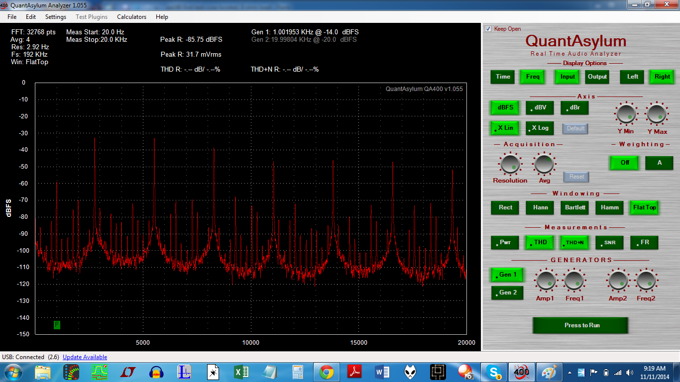

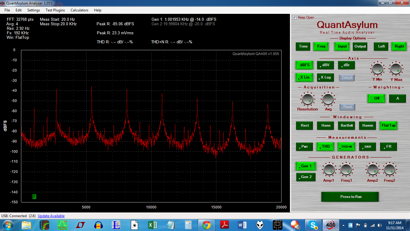

Here are the results, 8 ohm purely resistive load ( 3 resistors soldered together ) -14dB input, verified as producing 2.73 volts output. QA190 set to /10.
Looks like a resistor ladder is the only solution -- or the batteries are too low.
Will try brand new ones and build a ladder.
Or this is *really happening* -- which you'd expect to hear, as the noise is above the fundamental.

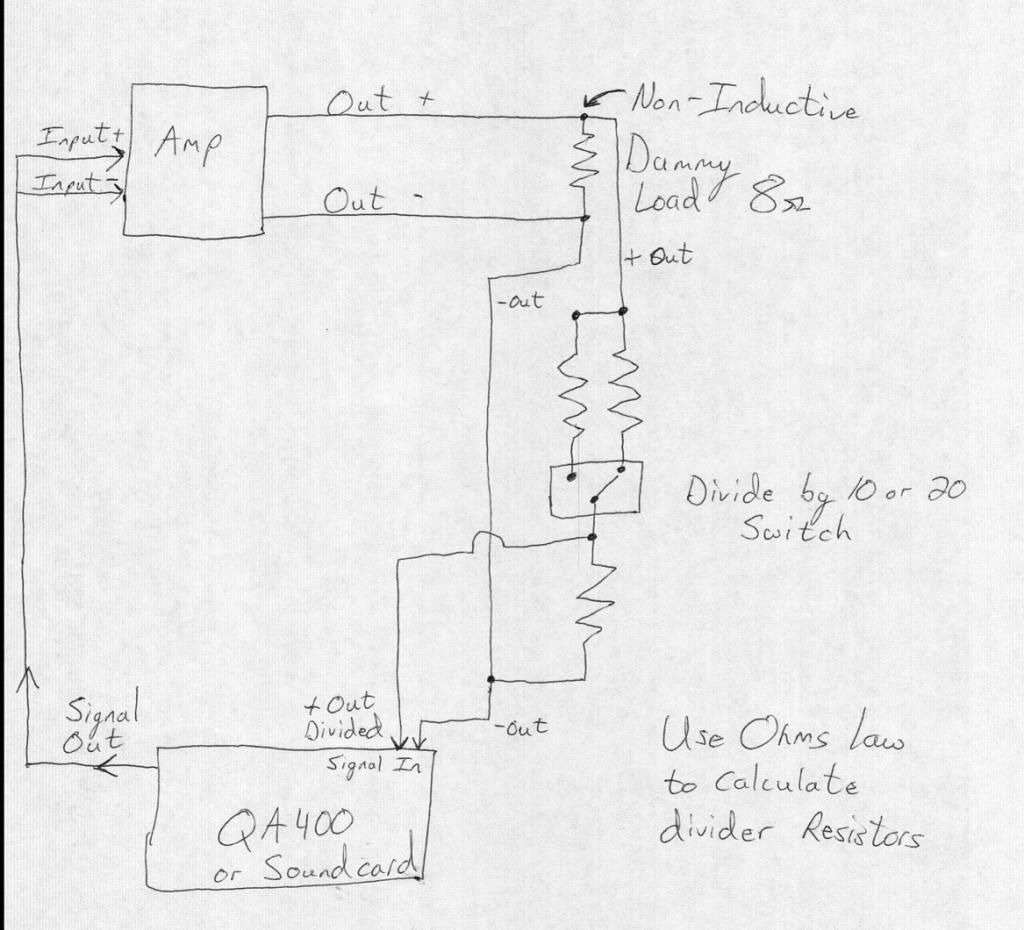

Here are some quick images to help you along the way.
First, you need a divider. This is a simple sketch of a basic divider. Many have built similar and more elaborate (including over-voltage protection). Use Ohms law to figure out your divider ratios. I like to do mine in volts and not dB. I used divide by 10 and 20 as an example. You will need to figure out the base resistor that works best with the QA400. Others can chime in; I don't have a QA400. Again, this is a simple sketch to help you understand. Mine is much different than this, but all in all works great with low and high power amplifiers.

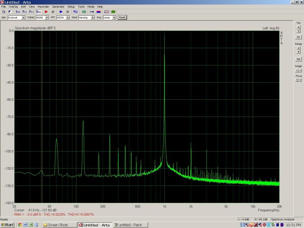

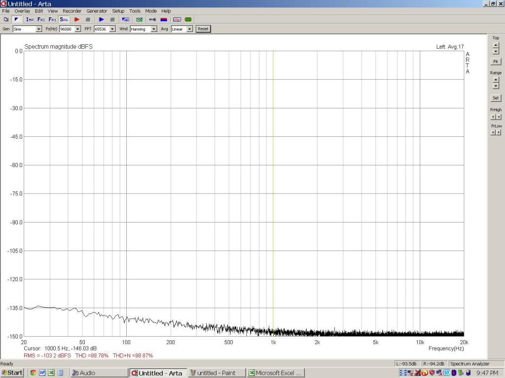

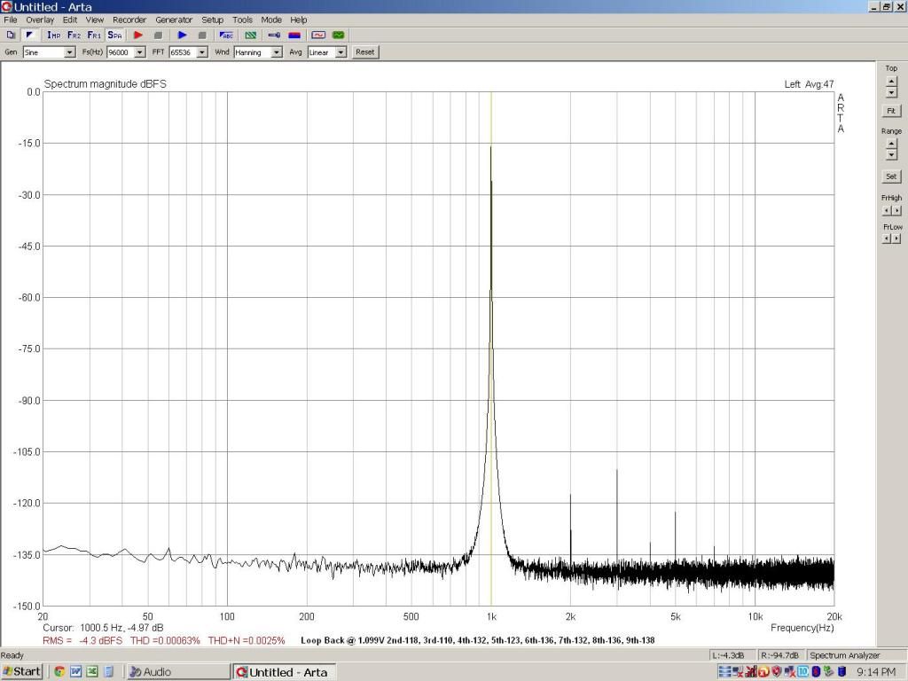

Here are some shots using ARTA and a sound card. Use these for reference purposes.
Loop back:
No signal:
Here is a solid state power amp at 10 watts:
Hope this helps.
What Skidave said.
That's a drawing of what I said earlier.
You can skip the switch, just calculate the divider.
1audio said to use a 100k/1k voltage divider to start - close enough.
For a one time setup you can just put the 100k/1k across the 8 ohm resistor and connect the QA to the amp ground and the center point of the divider - the 1kohm goes to the GROUND side.
You only need one input to the amp. Unless it is a balanced input amp, and the F5 is not. Assuming you test one channel at a time.
Skip the differential box for now. Get the QA400 measuring correctly first.
Keep it simple.
No twisting of anything required. First get something like a reasonable looking display. Like one of those shown. It can be imperfect, but you ought to have big tall spike for the fundamental and harmonics much lower down.

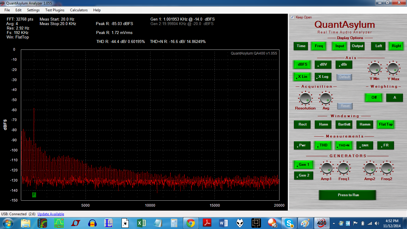

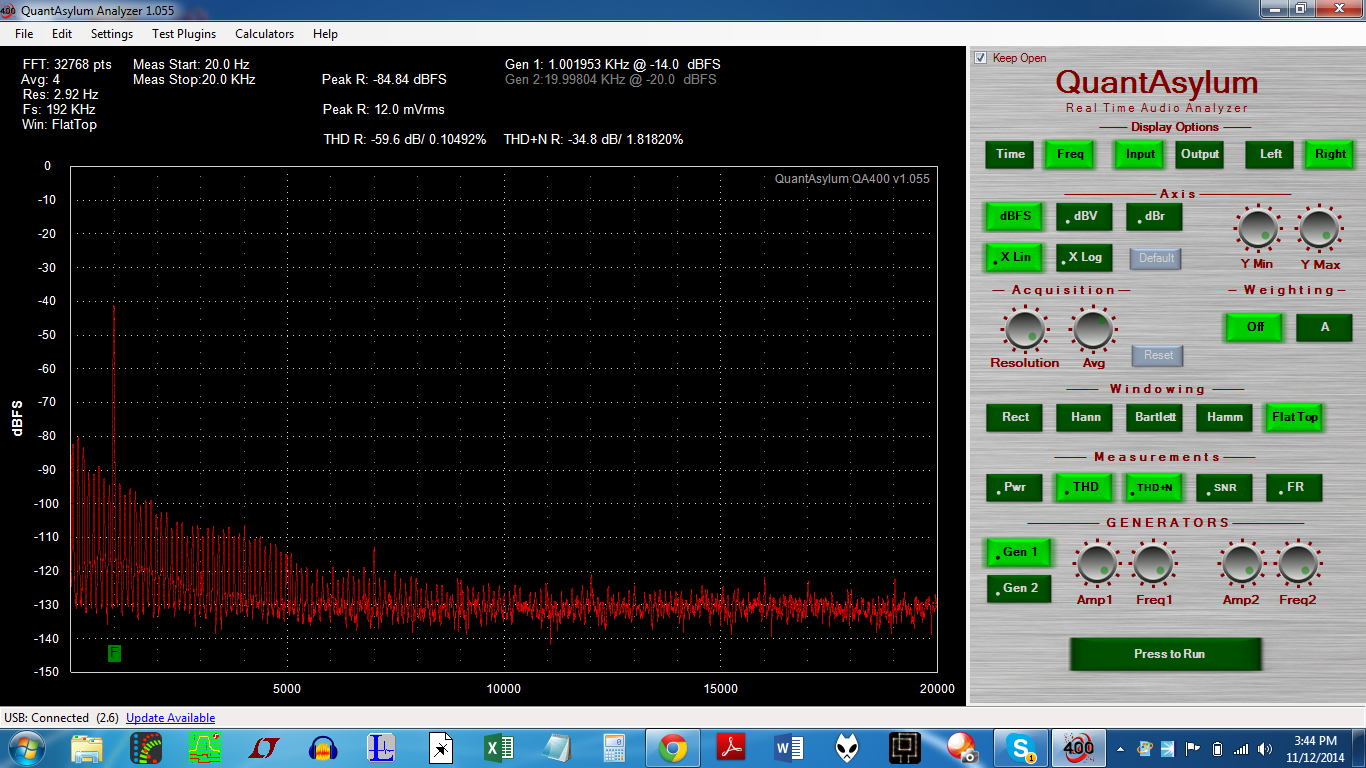

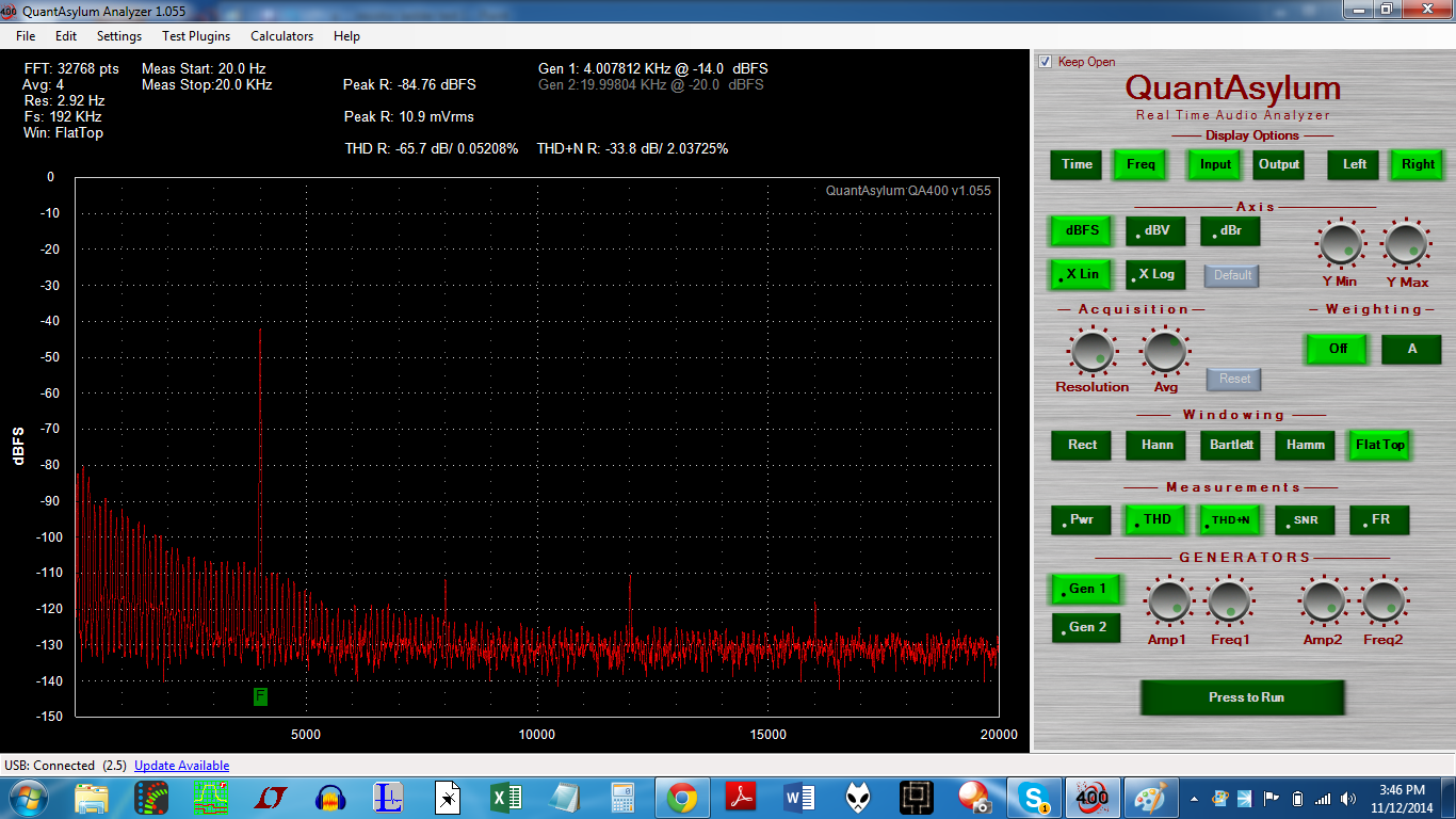

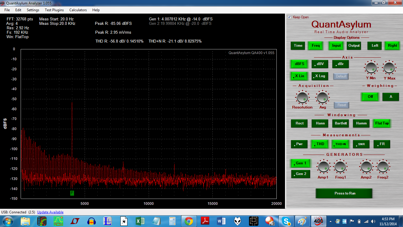

I used 10 watt resistors for the divider. Here is what I got, delivering -14 dB.
First test is 1KHz, next is 4KHz. Going to swap out the cheap aux circuit transformer for a potted toroid.
Next will be a repeat of these measurements.

So what is going on? Same setup, perhaps the contact from BNC to RCA was poor so that the value of the fundamental could change so much??
Still not happy with the boatload of harmonics. Will try Quasimodo, but then, may have to rewire the amp.
When you say -14dB what do you mean? Do you mean the amp output voltage is -14 dBV (200 mV??)? Or the signal into the amp is -14 dBV? The input to the QA400 seems to be about 10 mV. Are you using the -40 dB attenuator (1K/10 Ohms) I suggested? The signals are really close to the noise floor and if the output of the amp is under 1V you can connect directly. Just be really careful.
I'm confused about the reference to a transformer or toroid -- what do these have to do with what you're doing? The amount of hum signal is unreasonably high -- if you are transformer coupling the measurement gear, that could be why. Or if you are measuring with a current sensing transformer, well, then don't do that.

Ummm... dear BigE, what are you doing??
If you followed what skidave put down on his drawing, you would not likely have results that look like that... also you've got the bottom axis not set up so that you can see it clearly... think you want to switch the preferences/options for linear vs. log on that axis??
What I'm not seeing is the expected 2nd & 3rd harmonic, so somehow I doubt that we are seeing the output of an F5 amplifier... even with the odd noise that is showing up...
how about a jpeg of the set up?
BigE you are testing without the differential box?? It's important to not use the differential box at this point.

-14dB is the same as what gets sent out from the "settings/generate fixed tone" menu. I set that to 60 Hz and -14. The output of the amp is 2.77 VAC when the tone is applied. The 1K - 10R series resistor network is in parallel with the 8 ohm load. What you see on the graphs is taken across the 10R resistor using a BNC to alligator clip connector. The input to the amp is provided with a BNC cable with an RCA adapter.
