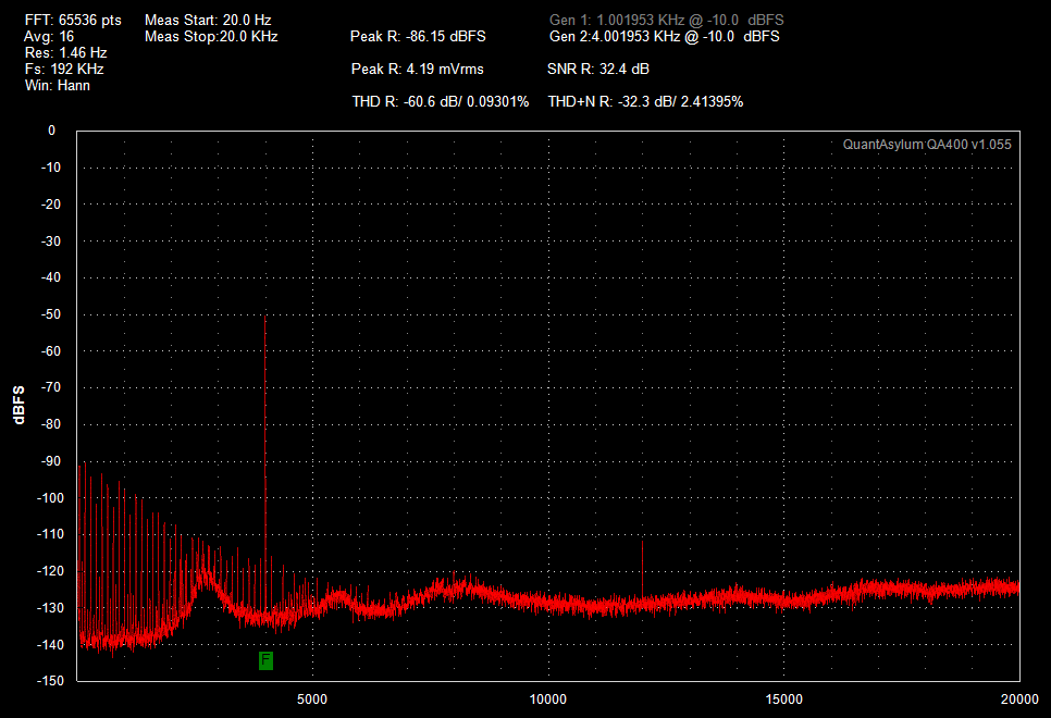

So, I built a resistor ladder, with 33 ohms and 10 ohms. Generatiung a 1000 Hz test tone at 0dB provides a signal of 1.31 V RMS at the midpoint of the ladder.
The BNC to alligator connects signal to the center of the ladder. The impedance of the load was set to 43 ohms, a 1K Hz signal was generated at -10dBFS. The chart is the first below.
The second chart is a 4K signal at -10dbFS. It shows almost exclusively, 3rd harmonic.
I am not sure if I set the impedance correctly..... the impedance the amp sees is 43 ohms. The impedance that the analyzer sees is between the gnd and signal: 10 ohms.... what figure should I use?

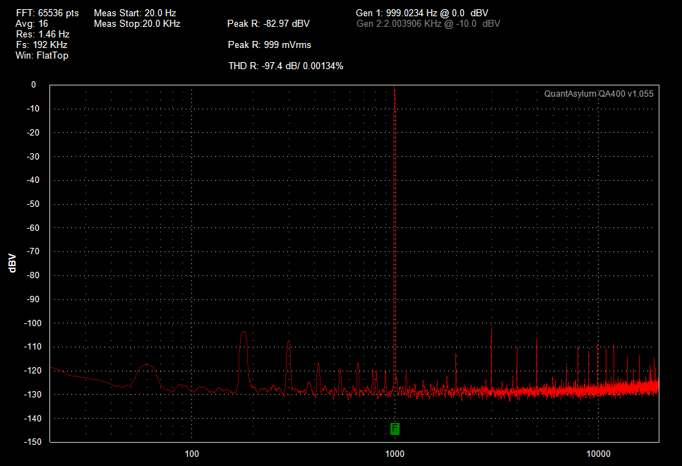

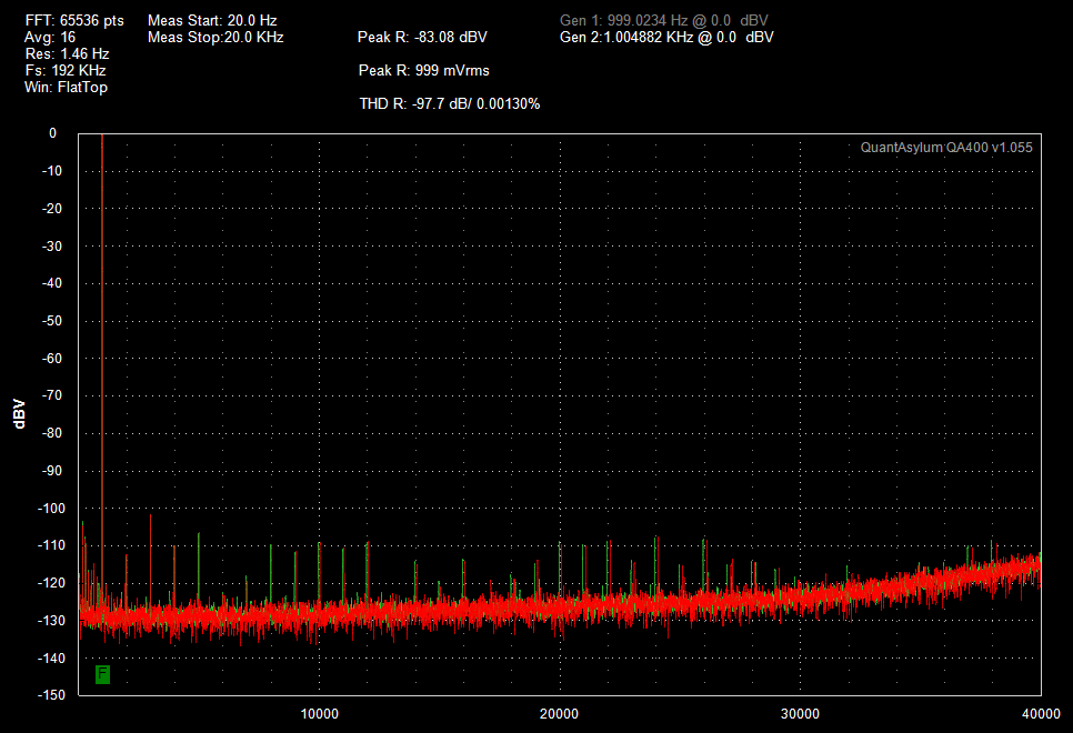

A loop back test of the QA400 shows excellent results, and no hum. So, it is not part of the test rig.
BTW: Should I be exporting the results of the loopback test at each frequency of interest to subtract from the measurements of the DUT to attain the *actual* THD for the DUT?
That would be a *really* cool calibration routine to add to the unit.
And a lie. The harmonics do not add and subtract nicely that way. You need the internal harmonics to be at least 6 dB or more lower than anything you are measuring. When they get closer they can add or subtract depending on the phase relationship and you really get no useful results.

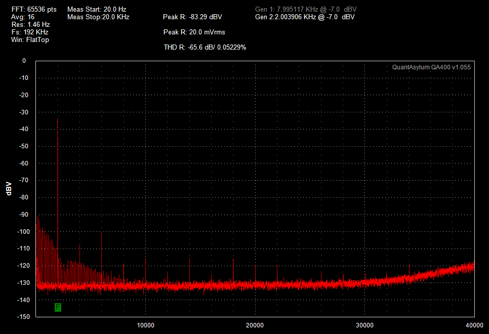

The 1K/10ohm ladder is not good right now. There is too much noise to get the harmonics out of the grass.

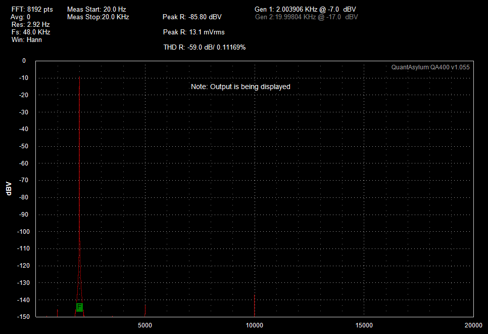

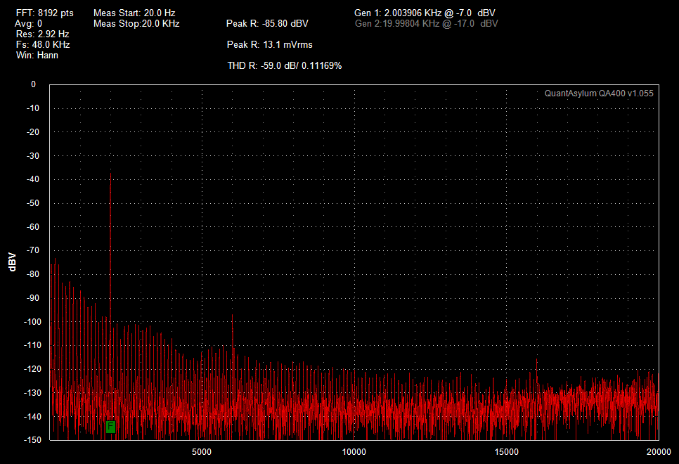

However, I sense there may be something wrong here. Please see the attached graphs.
The output is being taken from a resistor ladder of R1=33, R2=10 ( R2 is connected to ground) across an F5T ( gain approx 23 dB). V2 is voltage across R2.
Calculations show that it is 1.47 VAC RMS however, the analyzer reports it as shown in the chart.
No external gains are in use.
Why is the output window not showing 3.35 dBV? Instead, it shows -37 dBV.

The QA400 is calibrated for 1.27Vrms full scale. If you input 3.35dBV that's 1.47Vrms. This will drive the QA400 into hard clipping. You need to input a useful voltage no more than 316.23mVrms (-10dBV). Otherwise you will only see the distortion of the QA400 input amplifiers. Don't assume the output from your attenuator. Confirm it with another meter.
Most DMM will work to 500Hz. You can reduce the gen frequency to < 500 Hz and get a fairly accurate measurement in the AC setting of a DMM or other AC volt meter.
It would be helpful for us if you include a screen shot of the QA400 control panel along with your plots.
Demian explained this to you in a recent post. If you are not going to take our advice then it's difficult for us to help you.
