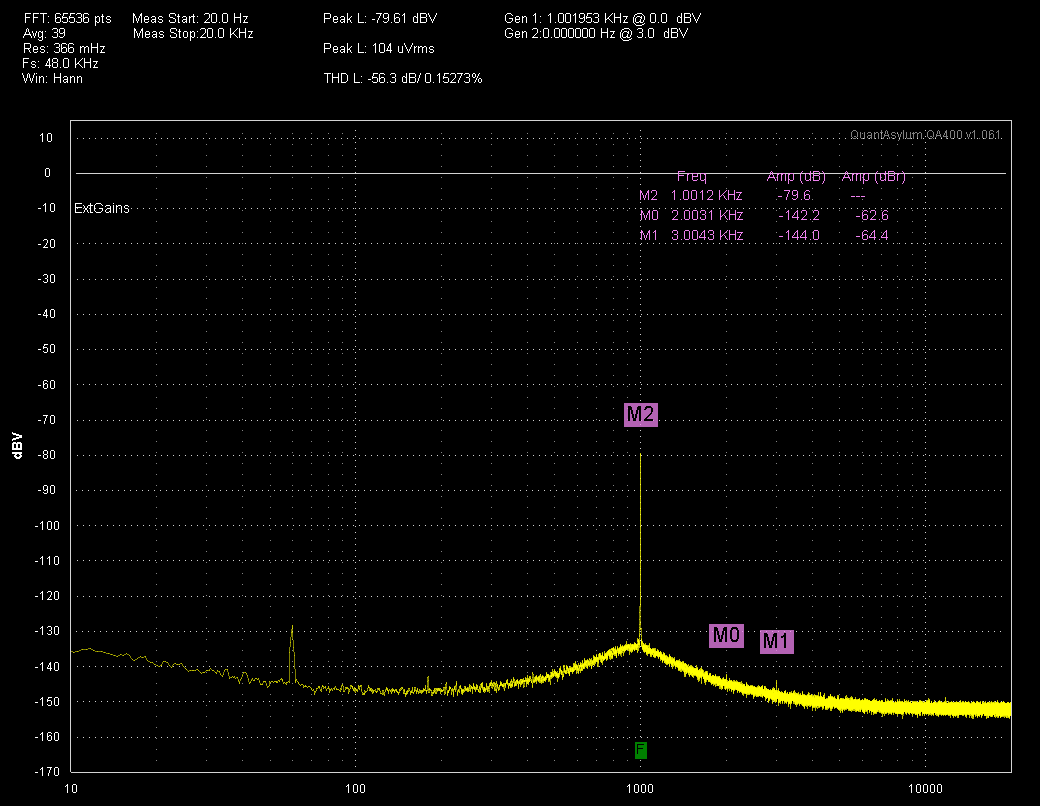

Your plots look like ur picking up "other" stuff. Also the fundamental is too low.
Davada, how did you get the noise floor down that low and no LF pick up??
That looks amazing.
Faraday cage?

This is a McIntosh tube amp, a 50W-2, ought to have similar distortion characteristics to the F5 ur testing... FYI
(I think I was using an external osc which was not exactly precisely "in the bin" and that accounts for the shape of base of the fundamental, iirc)

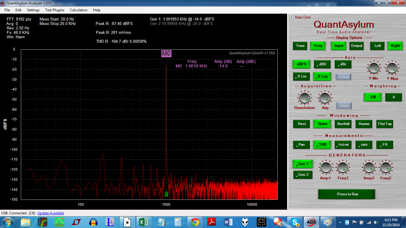

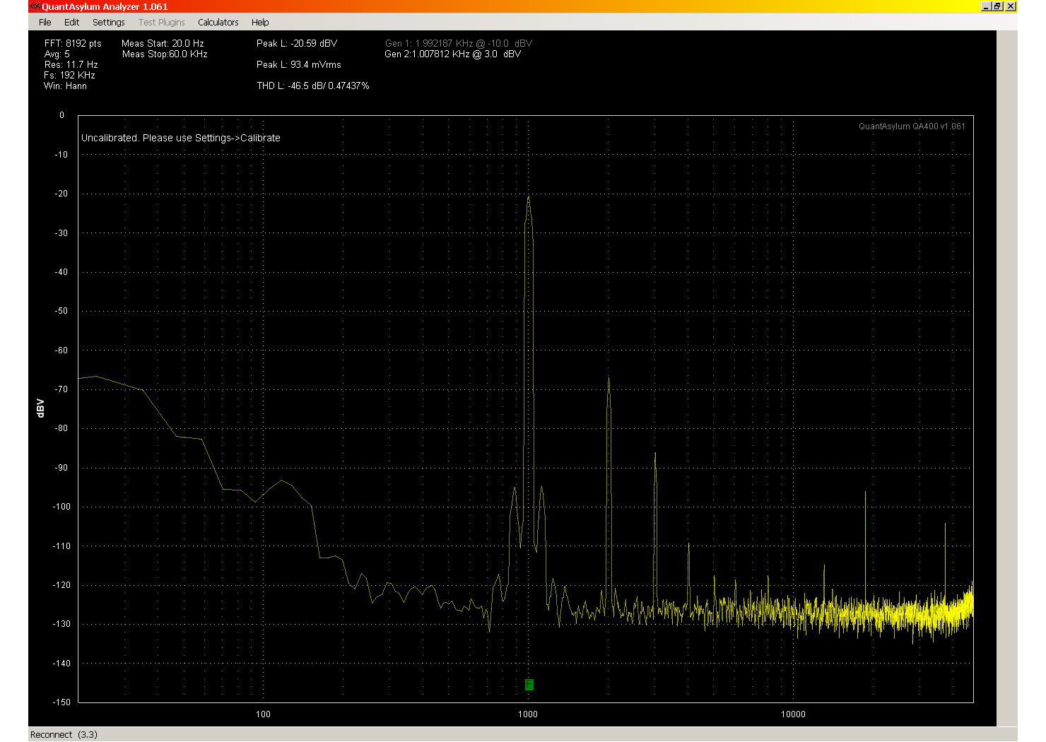

OK, so here is a loopback test. Is there anything funky going on here? I should be using Flat top I suppose. The laptop is plugged into the wall inh the first shot, and running on battery power second shot.
You have a lot of hum in this loopback.
1) were you using a BNC to BNC cable?
2) try it with the laptop disconnected from power
3) use higher resolution to get a lower noise floor. I start with 16K.
4) What else is connected to USB on that computer?
5) Are there any large power transformers nearby?
The harmonics are very good. The hum spectrum points to a rectified power source since the second harmonic is the strongest. it could even be a power cord nearby radiatng that is supporting a large load like a monitor, an amp, a heater, an old scope ??.

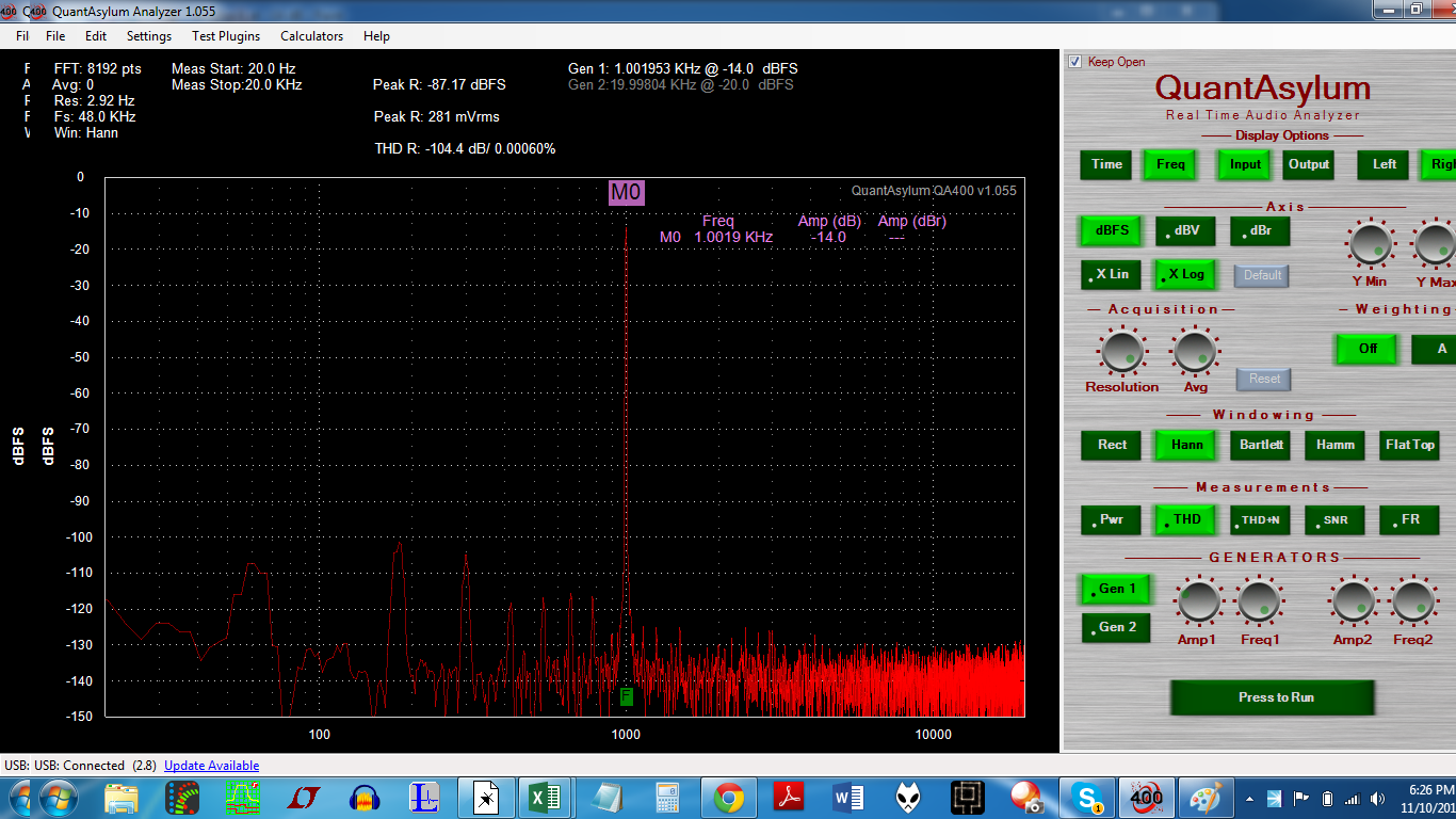

OK, so here is a loopback test. Is there anything funky going on here? I should be using Flat top I suppose. The laptop is plugged into the wall.
You're getting a lot of mains pickup - surprisingly it's a little bit worse with battery than without.
Also, try adjusting the generator output for -9dBFS. That I find is the sweet spot for my QA400 in loopback.
One more thing - turn on averaging.

Yes BNC to BNC.
I editted the post to include the laptop on battery. Same....
What else is connected is a microsoft ergonomic keyboard/mouse.
I am in the basement of my house in Toronto. Our house is third from the transformer on the street.
There is an old scope but it is off. I will unplug it.

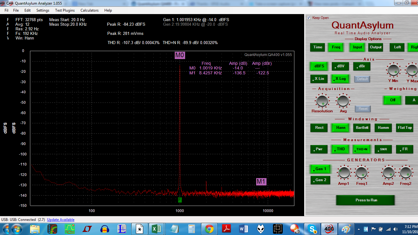

Below is a loopback that uses 12 samples averaged per point, and 32K samples for the FFT. The A/D was bumped up to 24/192 stereo.
I had a problem with those screw in florescent lights once. It was raising the 2nd H on a 1kHz fundamental. Turned the light off and the problem went away. If coax cables are coiled up they act as a pickup for hum and rectified power.
The averaging helps. Using the higher sample rate raises the noise floor and potentially the distortion. You have no distortion issues in this.
Do you have a big coil of wire available? You can connect it to the QA400 and use it as a search coil for the hum fields. I doubt you will find it any other way. It could even be a lamp ballast. I have similar issues and when I raise DUTs 10" above my bench hum will often go away. I really don't know the source of the field. I'm sure it will contribute to my insanity later. . . .

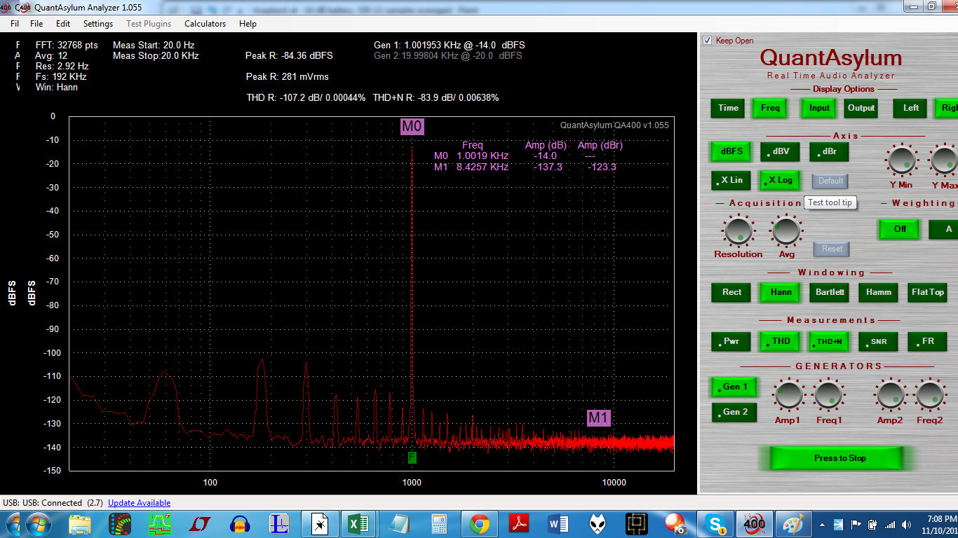

CHECK THIS OUT: I twisted the coax from input to output during the loopback test, and the harmonics vanished. The loop formed by the coax was acting like an antenna.
That's better.
the change from 0 averaging and 10 averaging makes a big diff, so hard to compare results... but it looks very good now - probably better than mine in terms of where the floor is...
