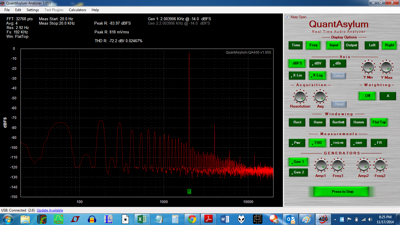

Please see the charts attached to post 1426. I see no significant gain in noise performance at 60 Hz at all. Worse yet, the 2nd order harmonic is now below the third. This is opposite to the measurements in 1426.
I am expecting double shielded BNC to arrive tomorrow or the next day.
The sound of this F5T is soft and lacks detail and punch. The F5 I have to compare is not soft, nor does it lack detail/punch. Conventional wisdom says *this* F5T has a higher 2nd order harmonic than 3rd, while the F5 has little 2nd order harmonic. I have made measurements of each amp that show this, albeit with the high noise floor. The charts on post 1426 corroborate this at least for the F5T.
This new chart does not. Why would the distortion now jump to 12% from the earlier 0.025%? Why would the distortion components just not be stuffed into the grass? I assure you that the amp does not sound like 12% distortion. I do not trust this new measurement. Bear in mind, this is all with the same output level. Why would the input level of the fundamental drop, while the harmonics rise?
The whole point to this exercise is to adjust a pot in the F5T to tailor the relative levels of H3 and H2.
And to top it off, there is no lowered noise floor. It's still over 90 dB.
I can try raising the output, but why did this measurement not show the same harmonic structure are the others?
Oooooookay -- so higher distortion gives the sound you like.... De gustibus non est disputatum. (that might be lousy Latin -- it wasn't my best subject)
Although the noise level is at -90, that's not terrible -- the actual signal-to-noise ratio is a lot higher because you have to add back in the attenuation of your output divider, which is significant.
Now you have to adjust the divider ratio and/or the output level of the amp to boost the fundamental signal into useful territory -- between -20 and 0dB. As you do that, the harmonic ratios may change and so might the calculated values. The software analyzer needs sufficient signal to do its work.
I don't know what you are trying to infer, but I prefer the sound of the F5, as it is not soft and dull. It happens to have less distortion than the F5T. With the shoddy measurements I am making, the F5 measures at less than half the distortion of the F5T.

Ok, so I went back to the bnc/banana connectors and rebuilt the network with a 260 ohm resistor ( measured at 267.4 ). The spreadsheet says to expect 0.599 Volts on a true RMS voltmeter when sending out a 60 Hz signal at -14 dB I did this from the QA400 and the meter read 0.598 Volts. The divider is working perfectly.
The next bit was to try the alligator clip. I did not even see a fundamental. There was nothing but noise.
So, I hooked up the BNC to the end of BNC to banana adapter ( across the banana is the 260 ohm resistor). I got the attached. And the H2 is bigger than H3. There is an adjustment pot that can adjust this, so that H2 can be equal to H3 or perhaps even below.
The nasty noise is still there, but this looks like a useable chart. Note the fundamental is very close to what it ought to be. I will redo this test when the new cables arrive.
