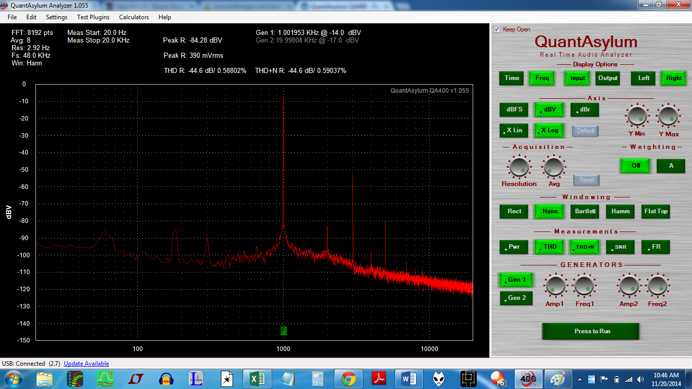

Amp output in the measurements is 2.83V RMS
That should be 28 mV RMS at the QA400 input with the 100:1 divider I proposed. In this plot you show an input level of .68 mV. That's about 35 dB low. Figuring out why will help understand what the problems are.

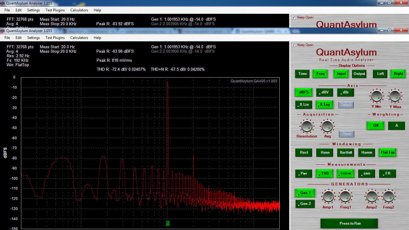

The hum voltages below 10 mV are usually inaudible on speakers. That would be about -50 dB on these plots. If you set the plot to dBV its easier to gauge actual voltages from the signals. The Flat Top is good for measuring a signal's level. Its not good for looking at low level noise etc. Use the Hann window for looking at harmonics.
You describe a noise issue as well, can you describe the noise any more specifically?

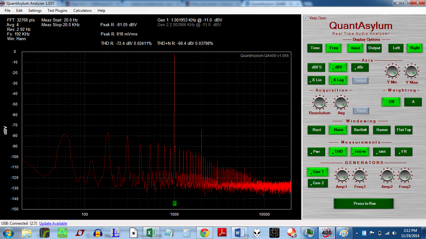

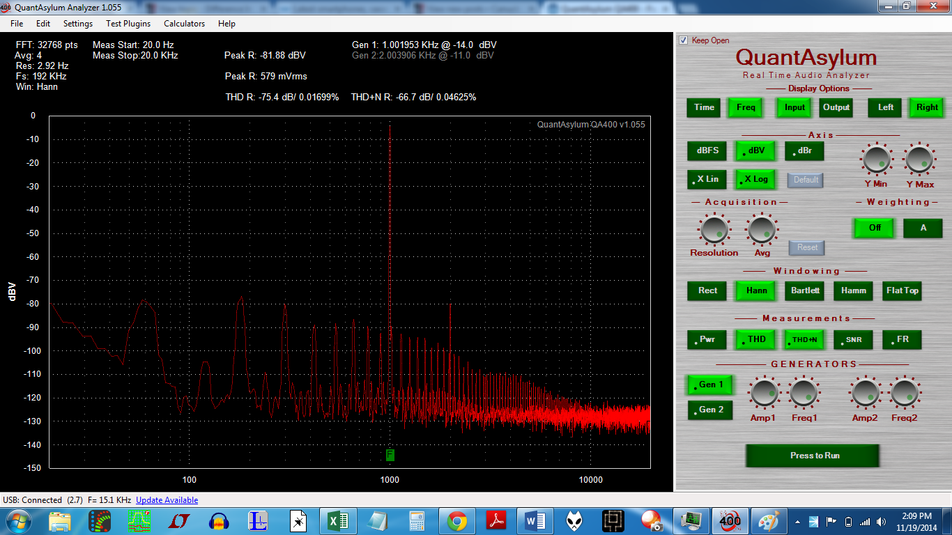

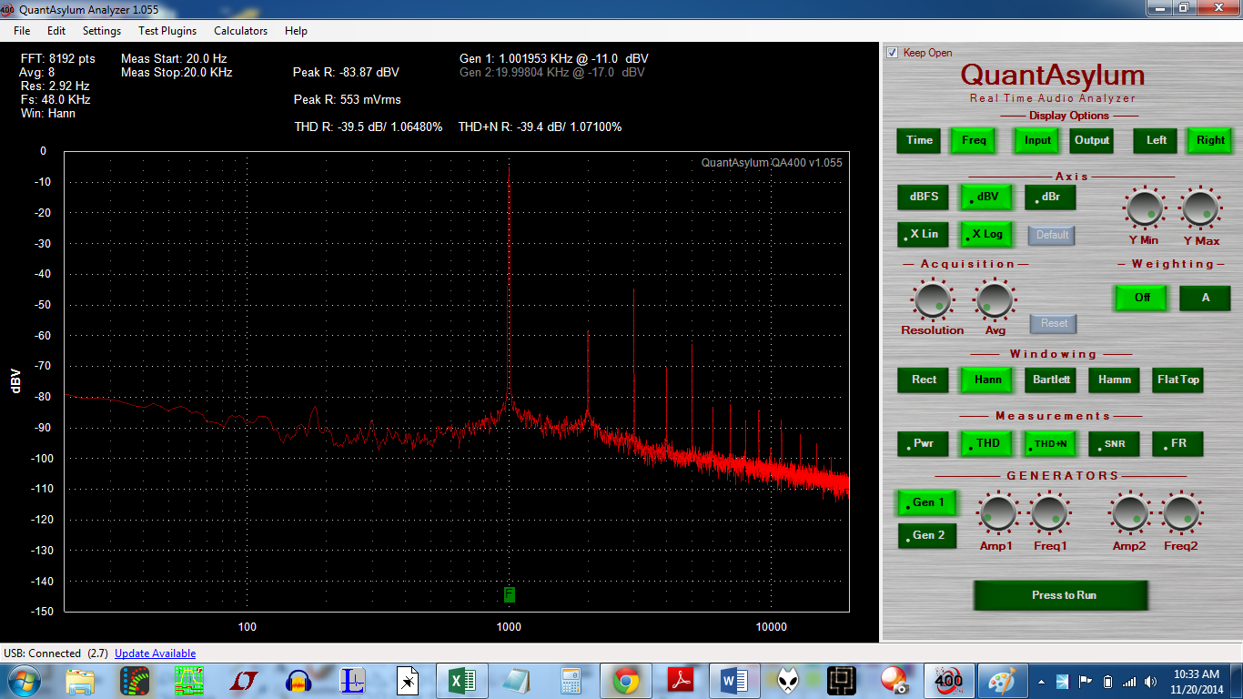

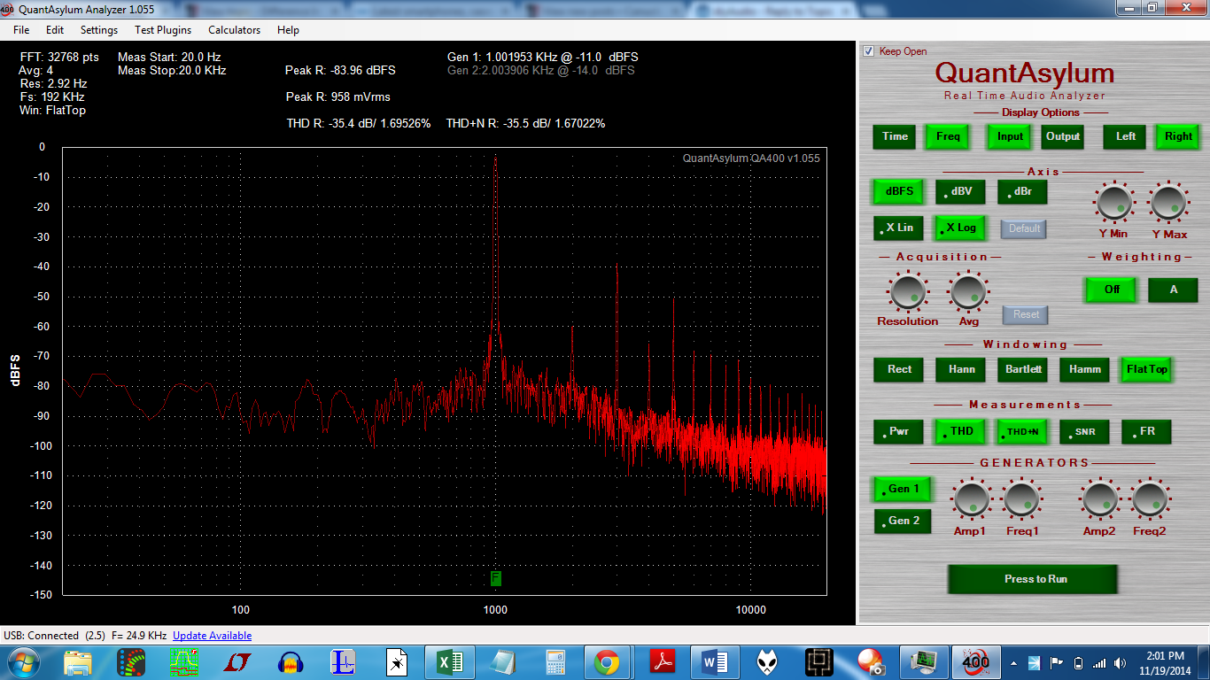

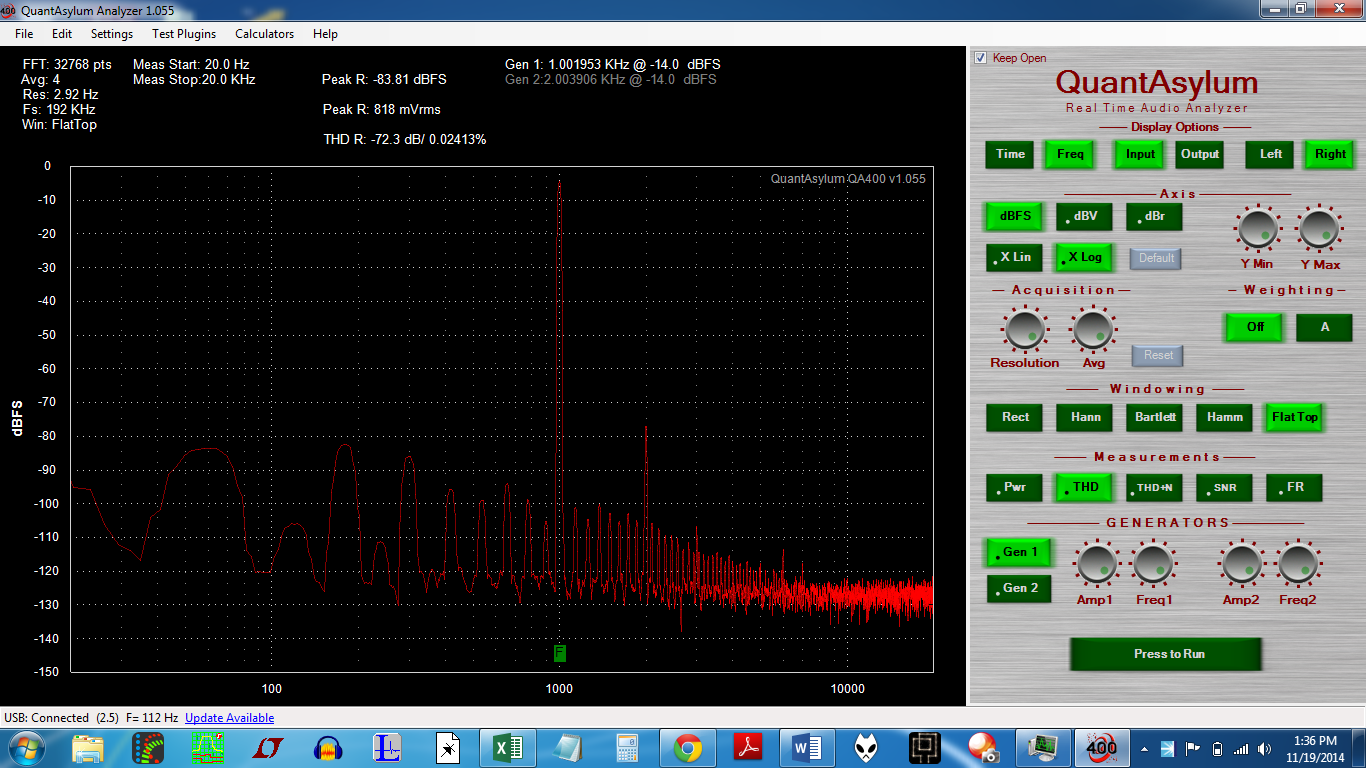

The results of the longer cables. Included is a chart with the hot output only. This is a snapshot, as it bounces up and down quite a bit. Will retest with Hann, and will change to dbV. The resistor divider is 1K/270 Ohms. Signal taken at 1K/270 Ohm junction

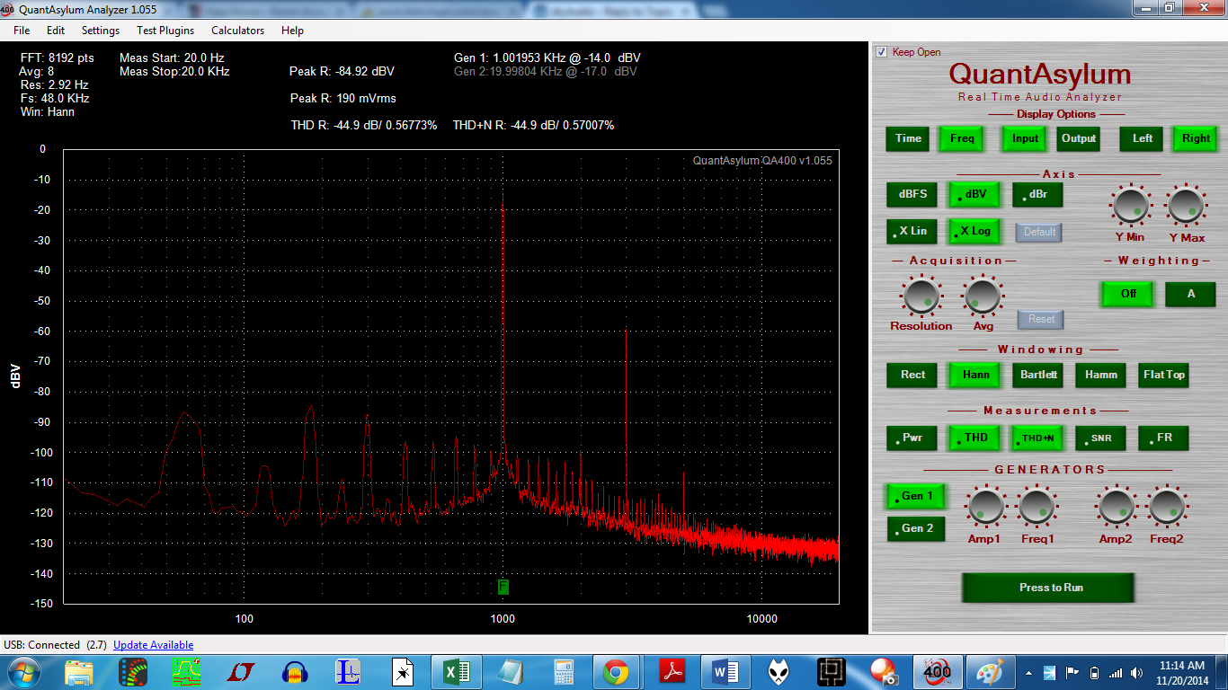

Hann and dbV. The resistor divider is 1K/270 Ohms. Signal taken at 1K/270 Ohm junction
1audio, the noise issue is just that noise you see in the charts, obscuring the harmonics. So yes, a stronger output signal with appropriate divider would be the trick.
My spreadsheet says: 0.8 volts in, 23dB gain, 11.3 V out, 1000/100 ohm divider => 1.023 V to analyzer, and 15.5 watts into 8.2 ohms, which will fry my load resistor. I will need to obtain a proper 8 ohm resistor to make these higher power measurements.

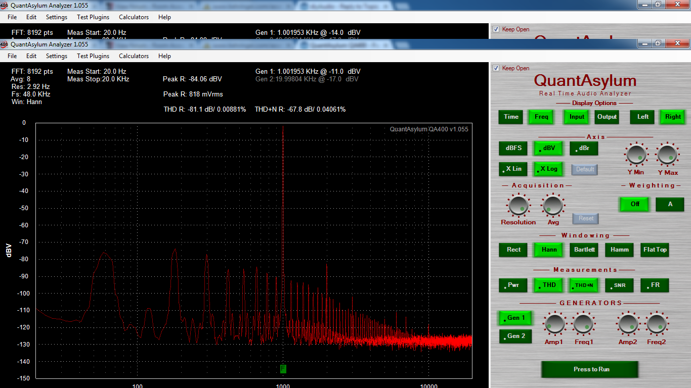

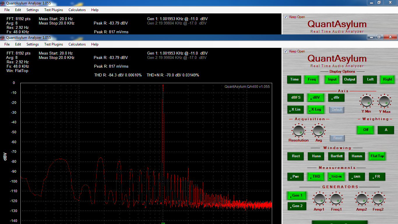

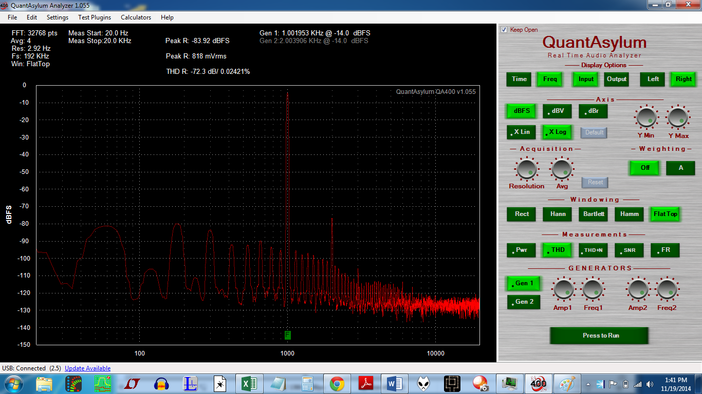

I just plugged in all over again, now the amp has been left ON for two days. I got some very different results. I have an enameled steel can with a lid, and putting the unit into the can makes no difference. The second shot is with the pump for the home heating going. Actually, I now think that is the compressor for the fridge.
What's the set-up diff between these plots -- the second is quite good.
The first image is the right channel, the second is the left.
I fried the right channel once, and replaced all the P channel devices. I was fooling with P3 on the front end board. Also, during early development, the output shorted, and a wisp of smoke arose from a capacitor in the PS section. Removing and measuring the caps showed no problems, so I continued with it. Maybe they should all be replaced.....
Another difference is that the pot P3 is not bourns on the right channel. I want to try to set P3 to lower the distortion -- it is a feature of that pot. And the entire purpose for this analyzer.
I think I will give it a shot.

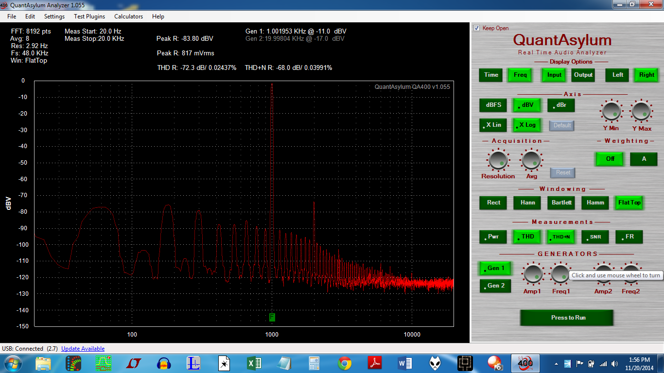

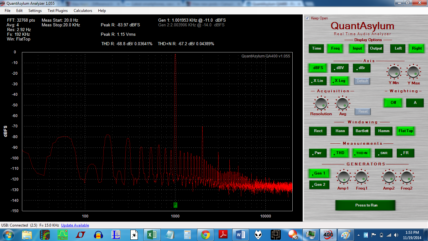

Please find attached two shots... before and after adjustment of the potentiometer P3 in the F5Turbo.
I did NOT try to wring out the last bit of distortion from the adjustment.... this is good enough for now.

Nice. You may be near the adjustment "graininess" limit anyway. But turn off averaging while you tweak the pot to see a rapid update which makes tweaking easier.
BTW, I think I madly misinformed you about the S/N as reflected by the divider -- the S/N you see on the plot is the S/N, no need to add or subtract anything.
