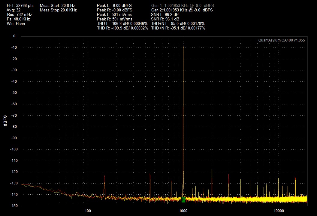

I fired up my QA400 for the first time today, tried to run the calibration procedure, but it'll fail unless I accept the default value of 1.29Vrms, is this normal?
Also, I run a loopback test and got the attached result, and it seemed the THD figure of the right channel is 3dB better than the left channel, again I'm not sure if it's normal.

cwtim01, I think your results look pretty good.
I find that the two channels are close but not always identical.
It is also possible that the calibration is different between channels,
but that's only speculation.
The results you have now are more than sufficient to test the F6.

When I first opened up the unit and tested it, I was on the first floor of the house. The basement finds us sitting with a water meter transmitter.
My bet is that unit is responsible for the noise.
The noise you have seems to be 60 Hz and harmonics of this. I therefore doubt that it is related to the water meter transmitter. The water meter transmitter will probably transmit with very long intervals to save power. So perhaps intervals of several hours, at least if it is battery powered.
There are some cordless phones, which can generate 100 Hz and harmonics of this. But this does not seem to the problem here. I work with the design of such cordless phones and I have seen noise from them when working with sensitive analog circuits. And living in an area where the mains frequency is 50 Hz it can sometimes take a while to identify the source.

Well, IF ur running on a laptop, you can literally switch off the breakers for entire house, sequentially if you wish, and see if finally the noise goes away...
That is a brilliant idea....will try that later. Sleepless night => mistakes can happen.... best to avoid poking about the amp today.
There is a difference in the house since the original loopback test was done... New LG dishwasher and New LG fridge. Perhaps it is one of those?
If you are on a concrete floor, it can induce some very nasty power junk. The rebar and the concrete itself are conductive and often have more than you would think, or want, ground noise. You MAY be able to reduce it by turning off the main breaker to the house, then again you may NOT. Harmonics in the power grid for your location may be there regardless of what you do. It's all fun and games!
If lifting the piece off the floor reduces the interference, then you have ground current flowing thru your building.
Alan Garren
You may have a wiring issue in the house. If the current was going around your space in a large loop instead of in paired wires like Romex you could have a strong field inside of it. This if the case would also imply a safety issue.
You could make a quick mag field probe out of a speaker inductor or wire around a magnetic iron rod or bolt and just explore with the QA400 to see where the field is strongest .

Try running the tests early on a Sunday morning. It's a pretty quiescent time for electrical devices.
