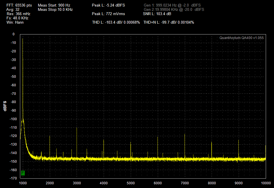

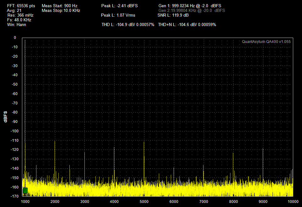

QA400 w/ latest software
I just loaded up the latest software and did an extended loopback test using the melt function. After the random stuff went away this is what is left. It takes 5 minutes or so to get this far and it stops getting better at this point. This was with the Interface attached. I was using the llopthrough in the interface from a USB2 port on the laptop for this measurement so the load was at the max for the port. I saw no drops or errors. Generic USB cables.
Unfortunately the "melt noise" only works as a closed measurement since it needs to be synchronous. Even a small phase shift will cause the level to sink over time. If there were a way to keep the oscillator running between samples it could be used to lock an external generator. That plus a passive notch would permit looking pretty deep into the noise.
The second image is the ShibaSoku generator at -5 dBFS The second harmonic is pretty low and the third is dominant. This is probably as good as it will get.
