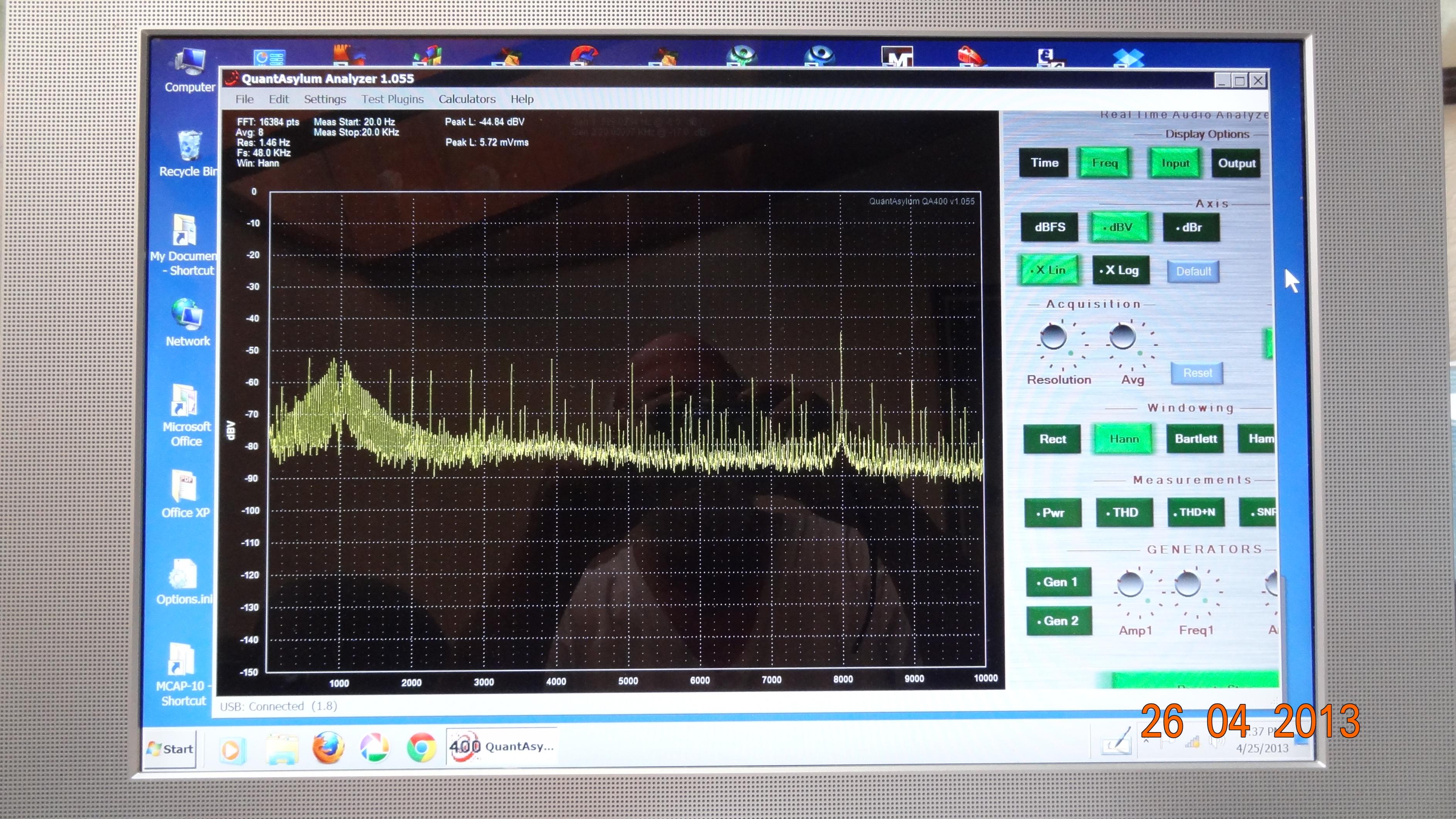

Is your display set to 1280x1024?
I get that with some programs because I use 1024x768 + large fonts most of the time (17" monitor + eyesight problems). Visual Analyser does that too.

Two options. First run it in full screen (double click in the top bar of the window) second, in the lower right corner is a tab you can use to resize the screen. Click and drag. The rescaling is not perfect so you will need to play with it to get everything. I pointed out this issue to Matt a few days ago.
cant see the lower right side of the screen... thats the issue! Cant go there--- what you see is the same minimized or max size. It always looks the same. I can scroll up-down but not left-right.
I'm going to go look at my cpu screen settings... but I like it as it is set.

Ok. I'm up and running.... I think. Had to change the computer Display's text setting to 'small'.
But everything else I use is now too tiny for my eyes.
If they would just put a scroll left-right on it, I could use larger text and still push all the buttons etc on the control panel of the QA400.

What is the resolution of your Display? My laptop os 1366 X 768 and the 768 is really just enough. Horizontally it should re-scale the graph to the space available after rendering the control panel. I suspect something got missed in some setting since this was not an issue earlier.

As Demian pointed out, it looks like you are running a very low resolution and the software was designed for a minimum higher than that. Unless the application is developed using WPF it is very tedious to handle the use cases at the extremes. I run 2560x1600 so I see the opposite very often.
From Matt:
"On the panel, you can grab the panel in an area without any controls (such as between the AVG knob and WEIGHTING OFF button) and then click and drag with your mouse. That will let you slide the panel up and down to expose the controls you need on screens that don't have enough vertical real-estate. The goal here is a way to let users with smaller touch screens easily control everything. There used to be scroll bar (vertical) that controlled the scrolling, but that's just to unwieldy for touch users."

I already figured that out. It's the side to side scroll that doesnt exist and needs to have one that does - side to side.
