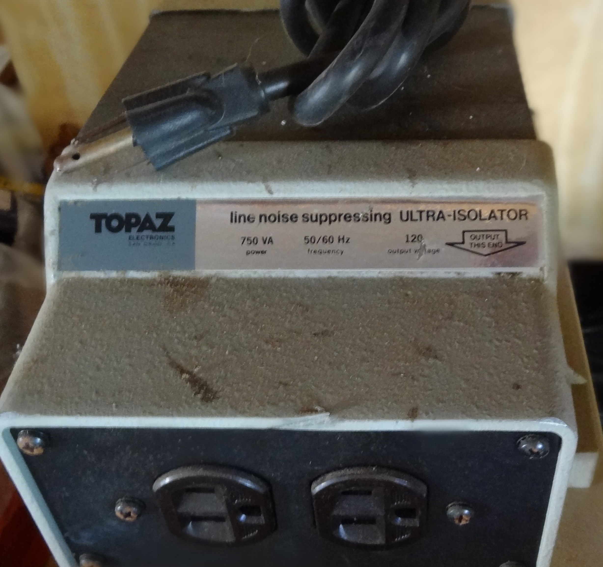

I have a related question to the assembled intelligence here:
My lab PC causes a lot of hf garbage on my equipment ground. Even with the scope probe connected to its ground clip, and nowhere else, do I have a lot of 50-Hz synchronised switching noise, presumable from the PC switching power supply (it's gone when I switch off the PC).
Does anybody have a sure-fire way to get rid of it, short of building a complete linear power supply for the PC (it has crossed my mind...)?
Are there such things as (effective) mains filters for this purpose?

Run a laptop with battery power. It will certainly help. But I like the idea of a PC with linear power supply, too.
I just asked at the end of this thread on another forum. If there's a "quieter" PC SMPS, or even a linear one, recording would be the biggest market for it, and these people would be the most likely to know about it:
Website for optimizing computer performance for Audio - Page 4 - Gearslutz.com
It might be helpful to modify the power supply, put 0.1uF high-voltage ceramic caps across each diode in the primary bridge, add a big ferrite on every wire just before it exits the box, that sort of thing.
But nowadays with everything running on USB, a battery-powered laptop is probably The Solution.

A linear supply for a desktop PC would be a losing proposition. There is a grey area between laptops and desktops with ITX board that can run on less power. You will still have switching supplies on the motherboard and linear regulators for those probably won't work if you could build them.
If you keep the total power under 100W or less (not hard if you don't need gamer graphics or dual I7's etc.) this Habey HB-LR1007-60W Accessories - Newegg.com plus a 12V linear will get you close. The other option is a big isolation transformer. Even if the PC is isolated you still have a monitor to deal with. . .

Does the hash reduce or go away if you remove the probe from the input and short the input to ground with the input switch?My lab PC causes a lot of hf garbage on my equipment ground. Even with the scope probe connected to its ground clip, and nowhere else, do I have a lot of 50-Hz synchronised switching noise, presumable from the PC switching power supply (it's gone when I switch off the PC).
Also you might try removing the probe long ground lead and short the probe tip to the grounding ferrule on the probe with a very short wire wrap or probe grounding accessory to see if your long ground lead is picking up most of it.

yes. Use a high quality (ground) isolation transformer on the PC. Such, those made by Topaz. Check their spec's on the www for the Ultra-Isolation series . Or one of their conditioners with isolation. These are Not made like regular isolation transformers.... these have extream (Ultra) rejection characteristics.
-RNM
[About $150 USD on EBay.]

Hi Jan,
In this context, one thing I've observed is that my Agilent 8 Gs/s DSO is actually internally PC-based. It actually has a fairly standard-looking motherboard in it, and I'm sure the main power supply is a variant of a PC switcher. The scope is vintage 2000 and the OS is a custom version of Windows 98 (yes, a disadvantage). Anyway, with all that bandwidth and sensitivity, it does not show a noise problem.
As someone else mentioned, even if you go to a linear supply to replace the ATX switcher, you still have a handful of Point-of-Load switching supplies on the motherboard to get all of the different voltages modern ICs require (sometimes down to 0.9V and at currents in the 10's of amperes). These POL switchers are non-isolated and operate at fairly high switching rates in at least the mid hundreds of kHz. So they are likely to be less problematic and certainly will not create any 60Hz-related noise bursts.
