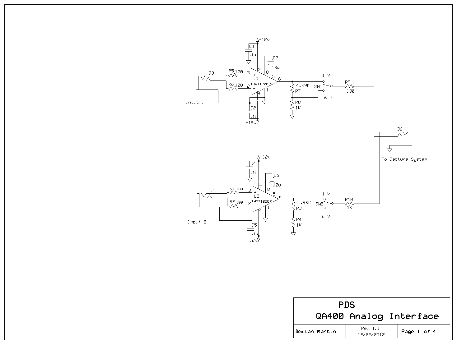

Revised interface schematic

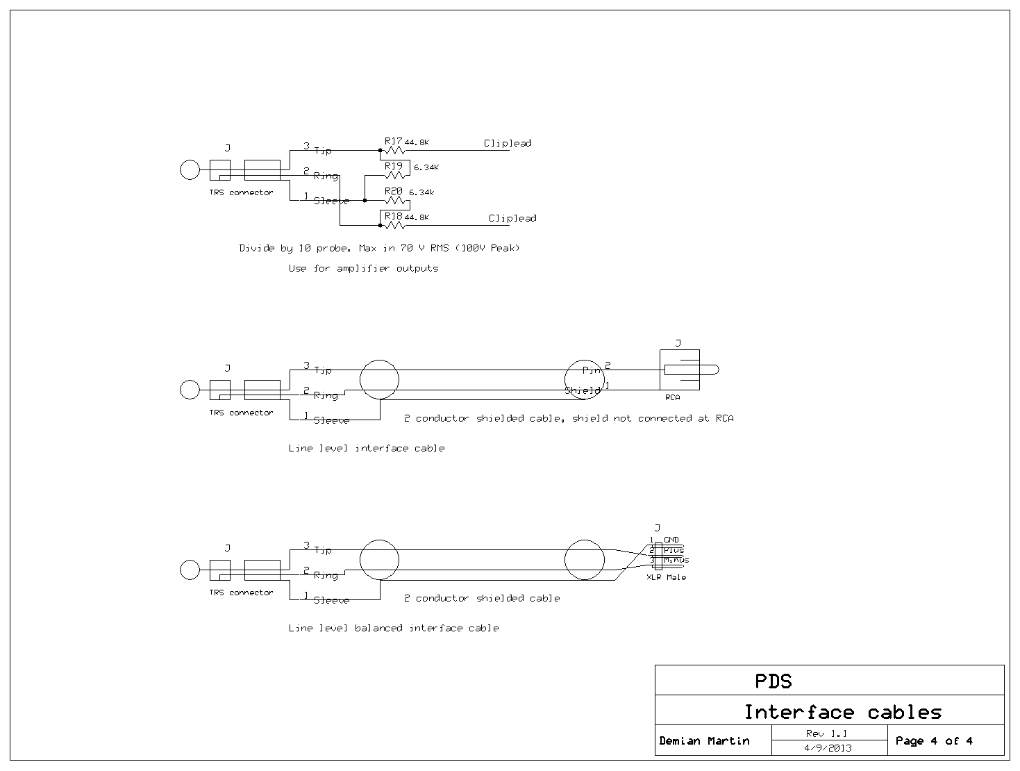

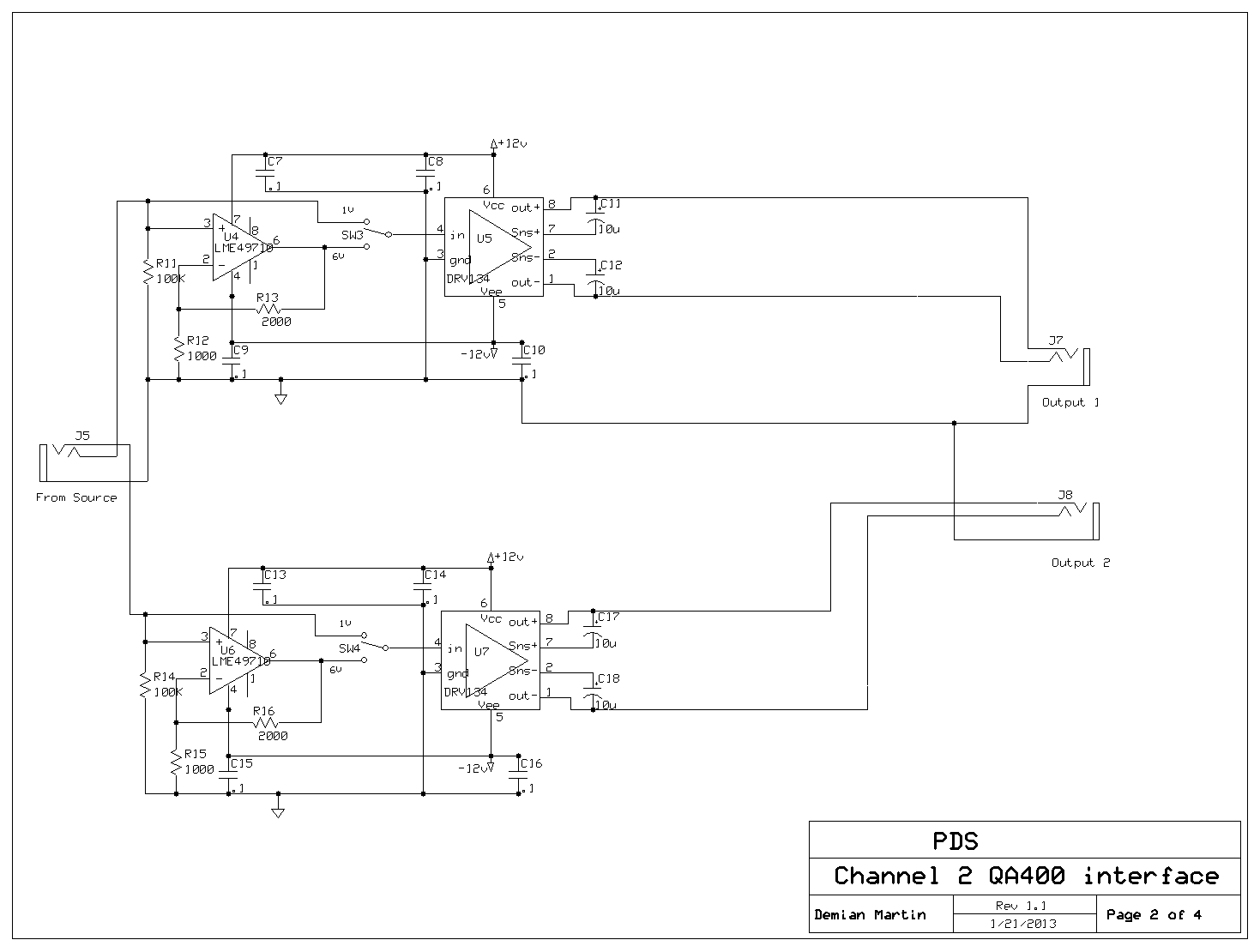

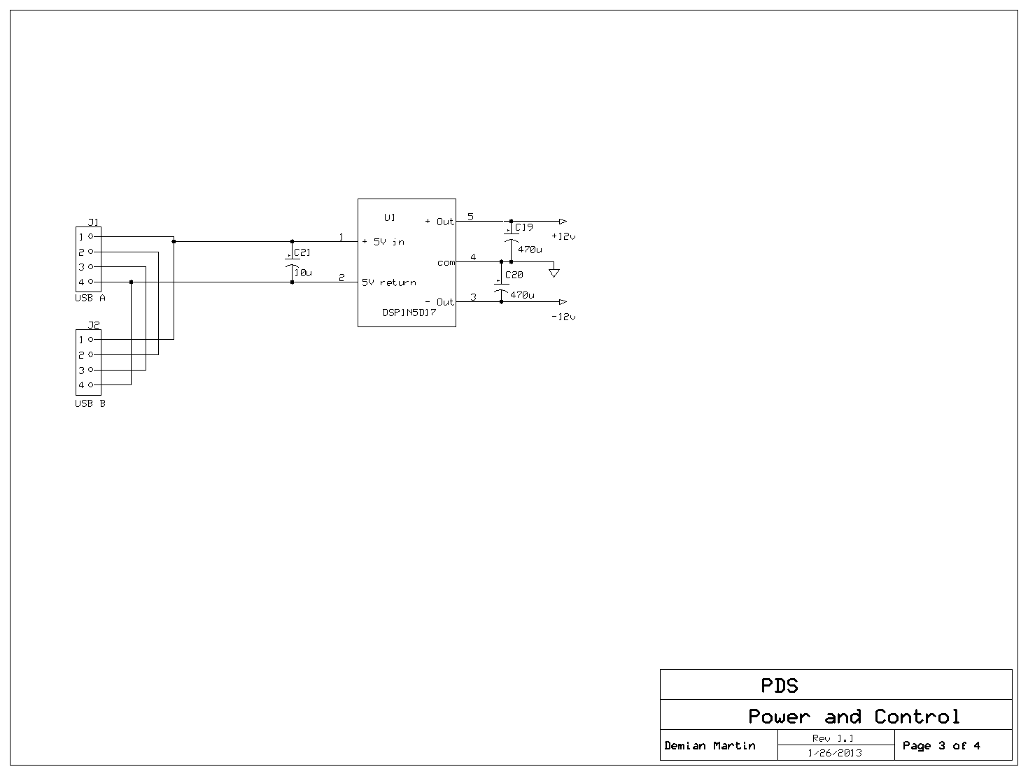

Attached are the revised schematics including the probe cable drawings.
I will probably do a gen 2 of this now that I have it all working and look to see if I can shrink it enough to fit into the QA400 box. That version will be all surface mount etc. I won't get to that for some time.
This has the revised gains (6V in and 6V out) to better utilize the available dynamic range of the parts.
I hope the cable drawing explain better what the concept is.
If there is interest I'll fix the existing layout and post it (with the larger holes for the connectors).
If we are lucky QA will do a second gen of the box with this built in.
