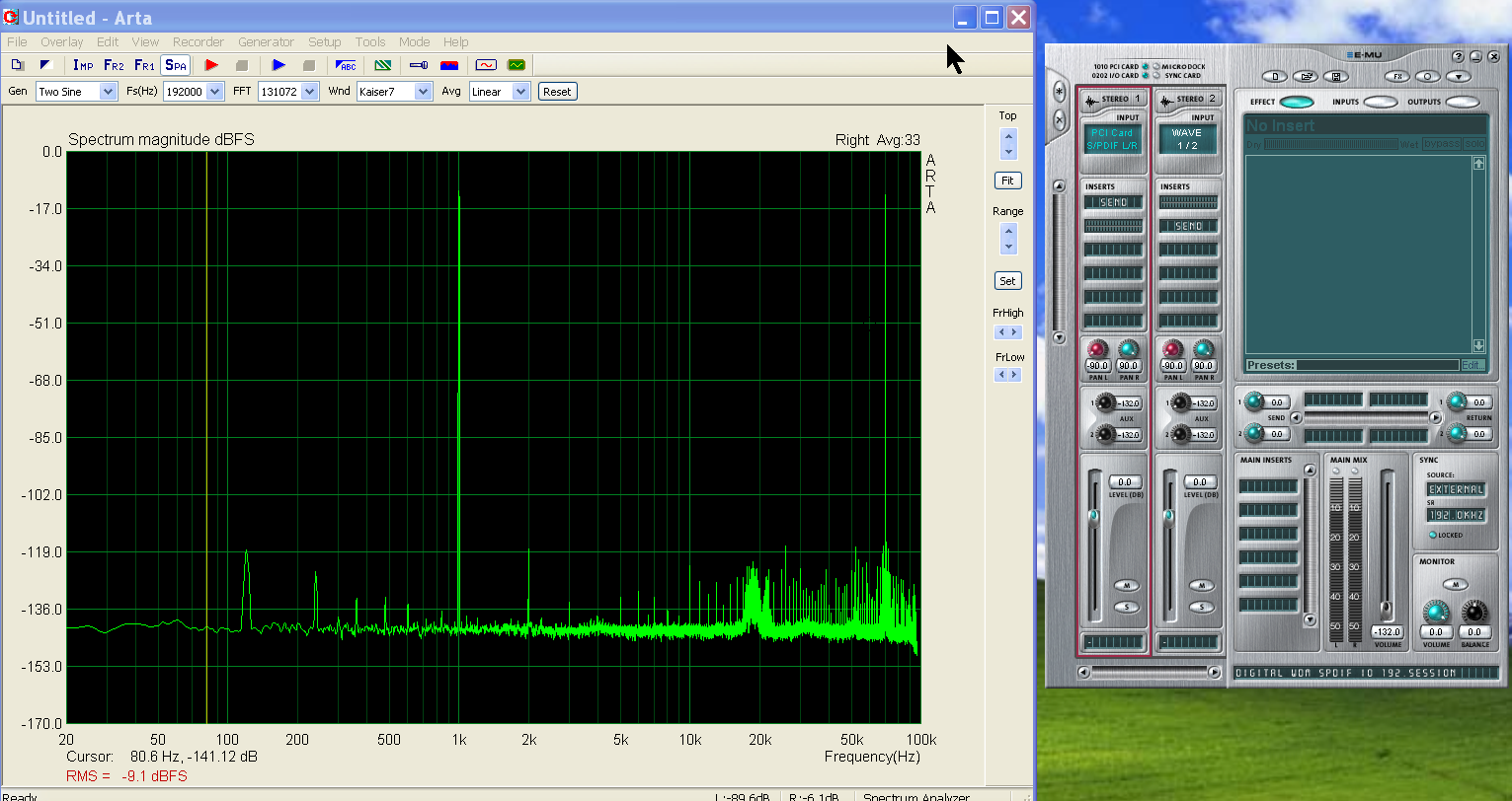

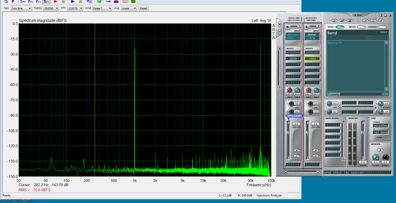

I would be too. I wanted to be sure so here is a loopback done two ways. First on the XP system using the 1616M's digital I/O at 192. Second on the Win 7 system that currently has the 1212M installed digital I/O using ASIO at 192. I'm having trouble with Win 7 and getting the digital I/O working using the windows sound engine. it works fine on ASIO. XP's sound engine works fine both ways.
The cards are going to an AKM AKD4414 demo board and then to an AKD5394A demo board. The system is locked to the clock of the AKD5394A at 192K. If I tell the system to run with internal clocking the out of sync data causes a major dropout every 5 to 10 seconds. it took me a while to find the external sync option.
The Patchmix DSP control app is not easy. It has a jillion options and is cursed with overdone graphics. I'm starting to learn my way around. Its not for someone like me who is changing everything a lot. I'm living with it and I have a number of different sessions stored.

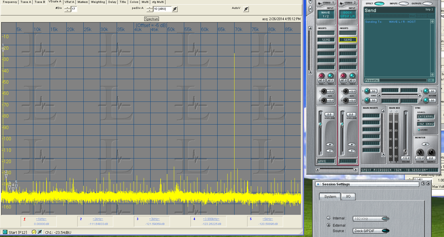

I did get the spdif working with the USBstreamer TOSlink input. The output from the 1212 spdif is AC. The input to the USBstreamer is 3.3V LVcmos. This presented a problem because the streamer input was only seeing the peaks of the spdif signal. I had to put a bias on the input to center the eye at mid logic level. It's going to require a differential receiver like the RS422 which seems to be the standard for digital audio.

As far as the spec its clearly working at 192K or the 70 KHz line would not be there. I think EMU is a pretty disorganized operation and probably passing into history. The latest press release on their site is from 2010.
There are some Win 7 beta drivers I'll try next.
SPDIF and AES are both AC coupled (transformer preferably) and need a receiver of some sort. your biased input should work and the jitter may be high but the data should be OK.
If I switch to 192kHz the spdif output stops. Nothing on the scope.

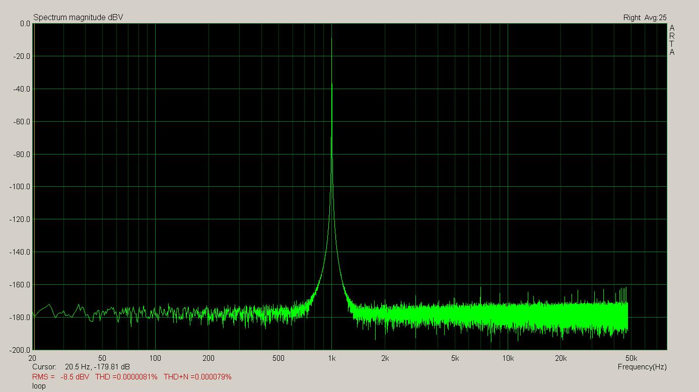

Here is the 1212 looped back to the USBStreamer at 96kHz.
I have one instance of ARTA sending a sine to the 1212 and another instance of ARTA receiving the sine through the USBStreamer. No convertor in the loop.
Digital to digital always looks so good. . .

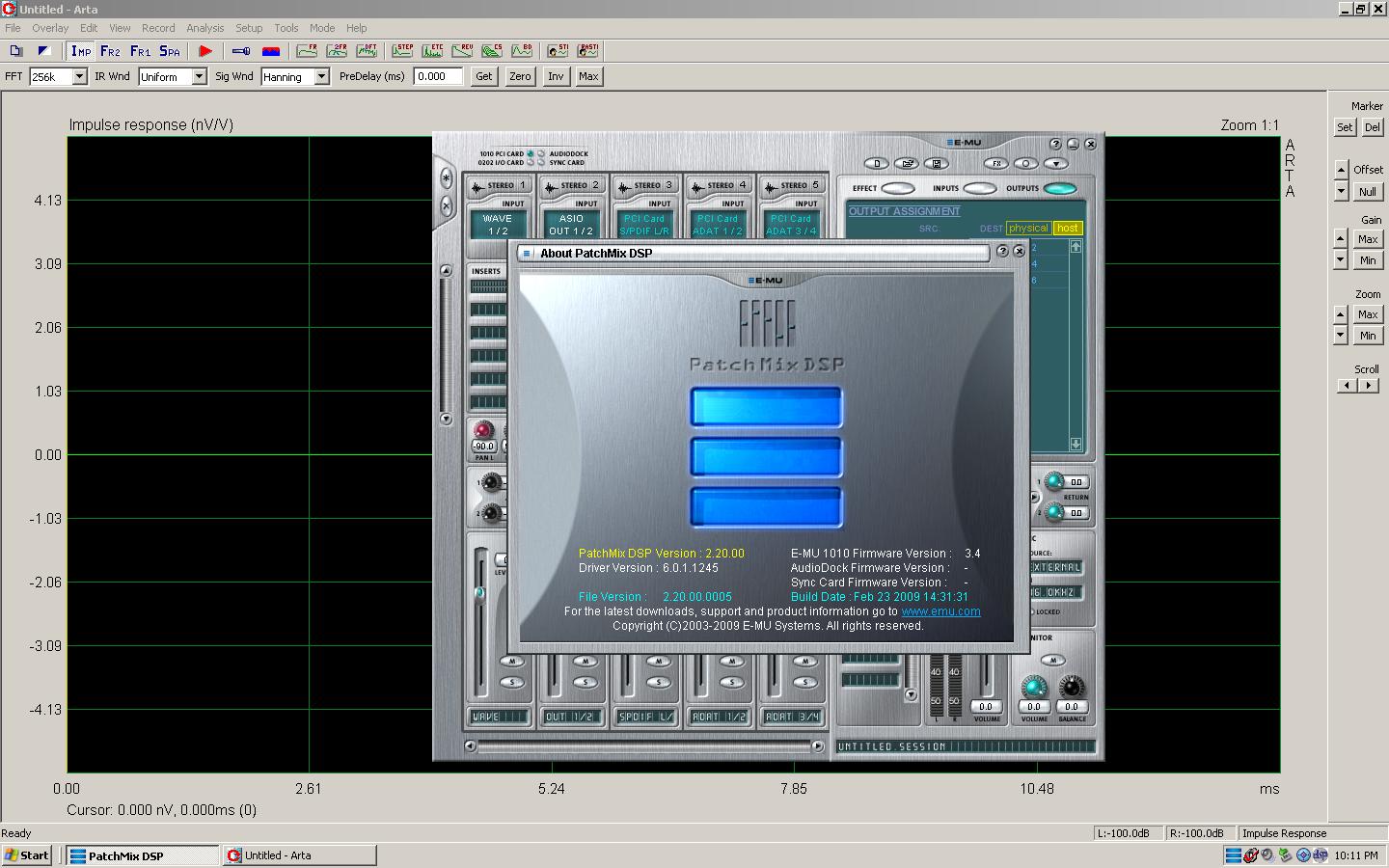

Which OS? Do you know which driver revisions? ASIO or WDM? (Use ASIO where you can.) I have attached some of the sessions I'm using.
OS is XP pro. Always ASIO. Still can't get 192KHz. I'll try your sessions.
I wonder if there is a difference with vintage. The drivers are whatever the last posted on EMU's web Page.
I used to do warranty board swaps for EMU back when it was EMU. We where the only warranty depot in Canada. That says a lot by itself. Great company back then and so where the products. I was shocked when I heard they sold out to Creative. And I mean sold out in every sense of the phase. Been down hill ever since.
OK, I had to check so i swapped the 1212 back into the XP machine. I needed to reinstall the drivers (??) but that took quickly. XP on an SSD is pretty snappy. A few false starts with the wrong session (microdock settings don't work with the internal card) and I got it all working using WDM. Below is the loopback through the external ADC/DAC. Attached is the specific session I used. Versions are on the graphic. I could send the drivers to you but I just ndownloaded them so it should not be necessary.
All this said I would be using a Juli@ card for the work you are doing. Lots fewer places to get lost and only a small degradation in audio quality with the on board DAC/ADC. But you already have this one.

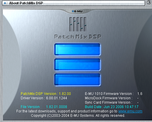

I checked and you have the first gen EMU 1212M. Its not compatible with the microdock. Possibly why its not working at 192 properly. They really revised the card and did not change the name. The way you tell them apart is that the old one has a firewire port. The new one does not. I'll still check on supply of Juli@'s for you.
I See. Well here the driver.

I'm really confused. You have much newer firmware on the 1010. I don't see what is on the card that is programmable? I'm not sure how to get current, or if I want to. I installed first from the CD shipped and then updated. When I did not do the first install from the CD it was really buggy.
