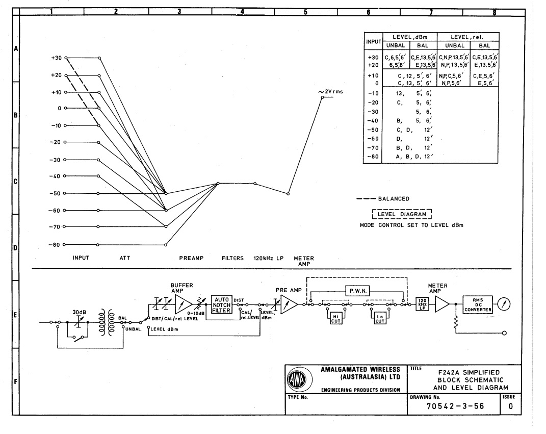

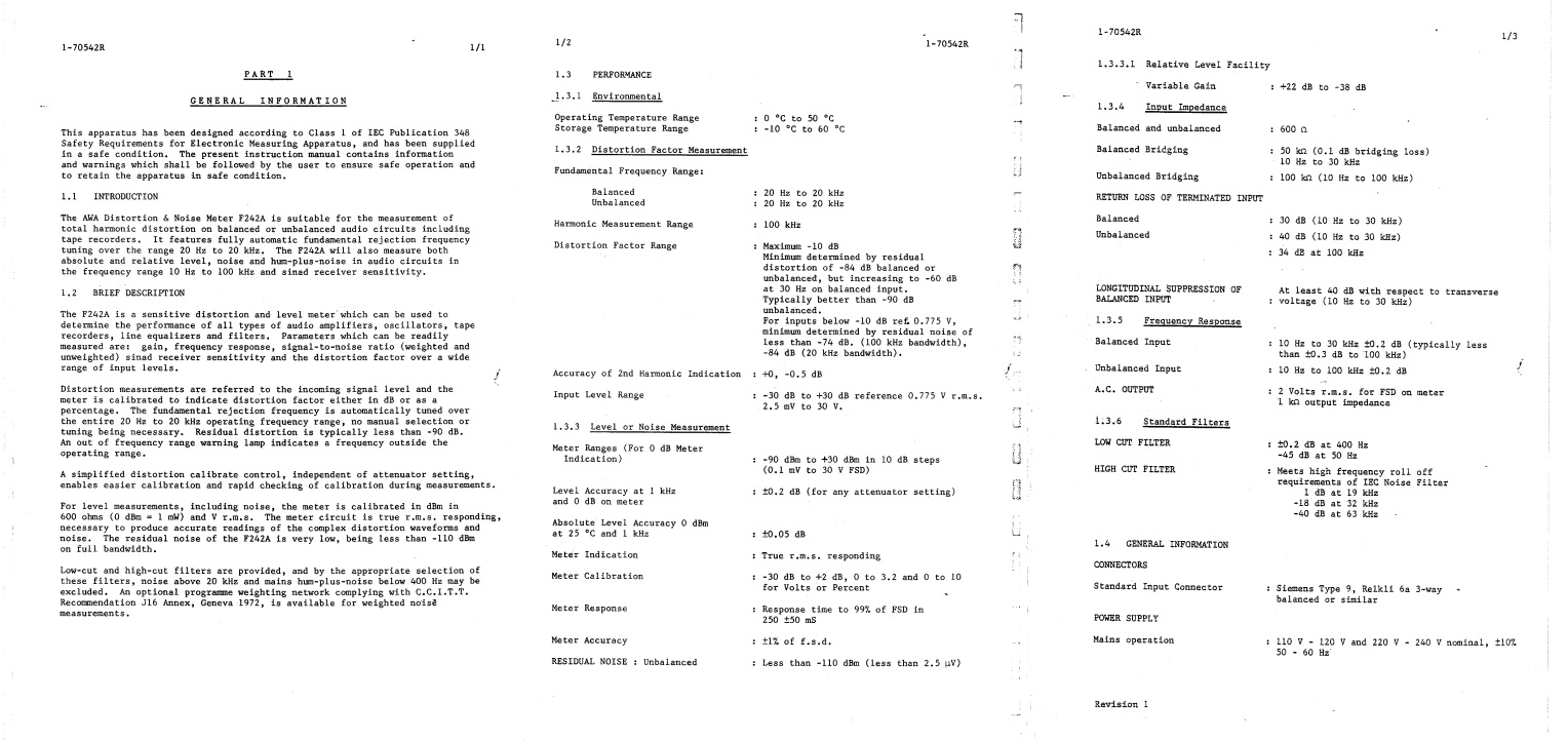

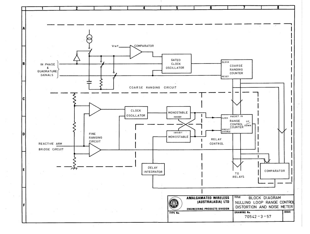

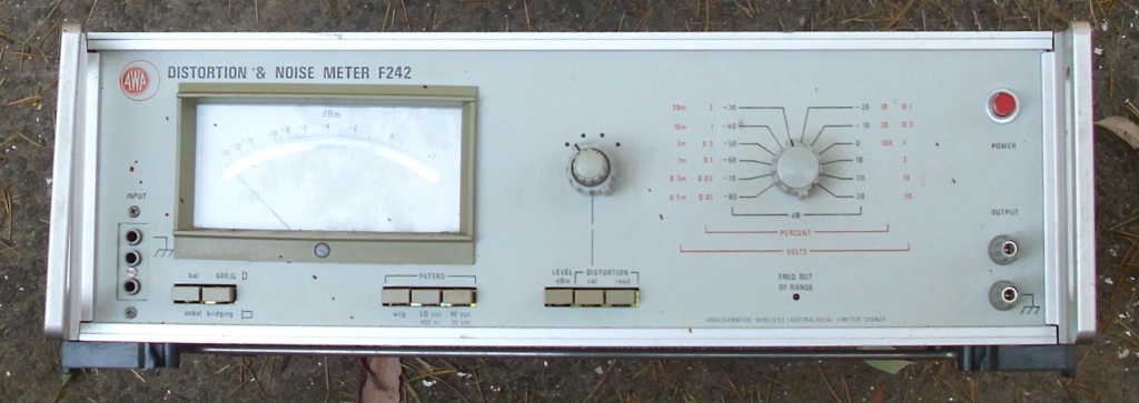

The AWA is an Aus built 80's D&N set.... auto nulling makes life so much easier.
The going price is around $250.00 or so .....if you can find one that is !.
The companion super low distortion generator is the AWA G232.....if anybody knows of one for sale, please let me know.
http://isurplus.com.au/manuals/AWA%20F242A%20User%20Manual.pdf

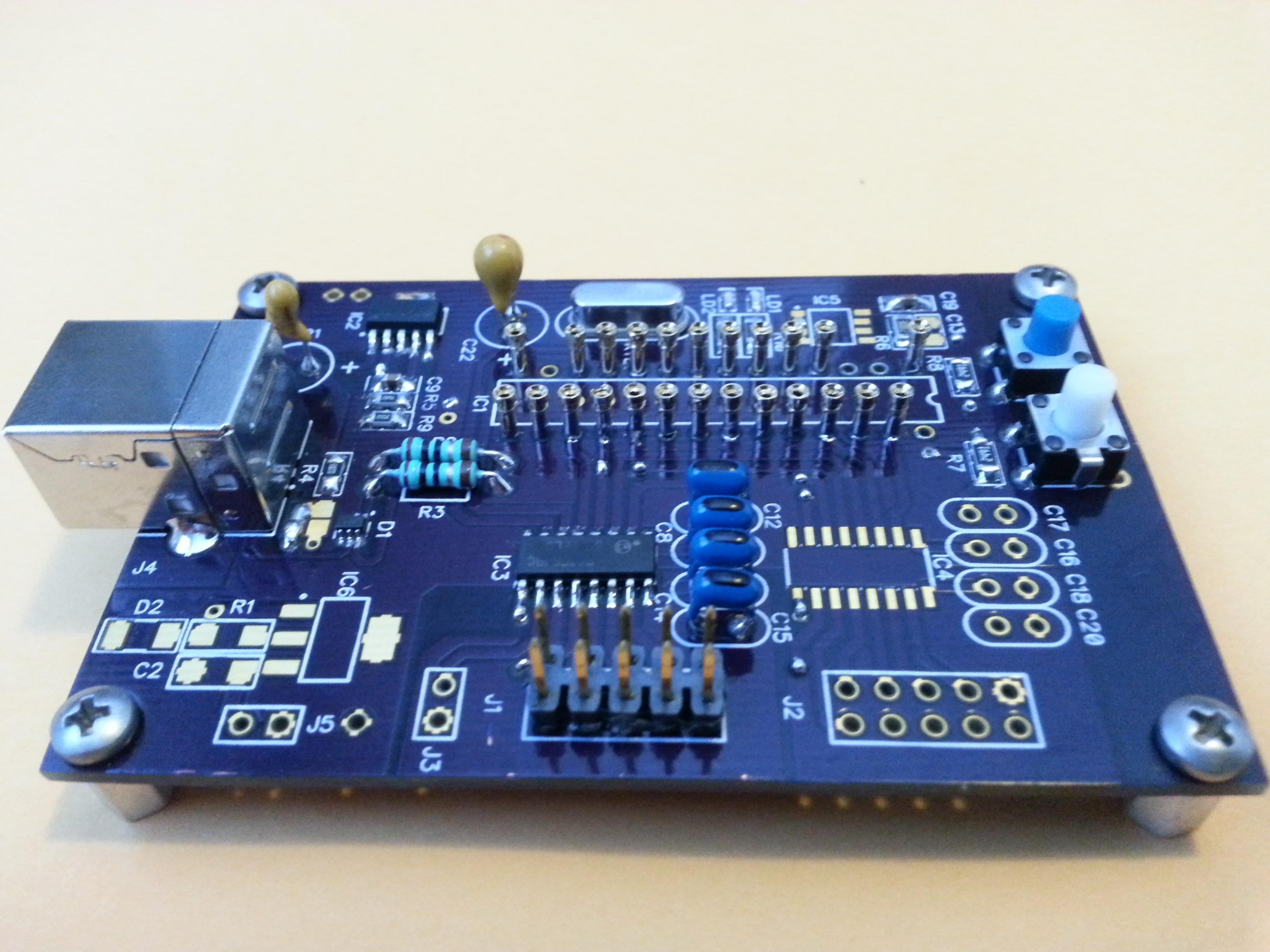

Isolation from USB really does work well. Have full USB control of my oscillator without even a spec showing up on fft.
That looks like a USB to GPIO interface. I don't see the oscillator there. Nicely done. Are you creating the software as well?
It's an isolated GPIO. The controller isn't on the board as shown. That's what all the socket pins are for. Right behind the socket pins is a 20 MHz crystal. Soldering all those pins on both sides was a real chore. But that's what you have to do if there's no plating. There are two isolators which share an SPI port the other ports are for CS or GPIO. One SPI port is assigned to the oscillator and the other for future use. The tuning DACs on the oscillator board are SPI and I used an SPI expander IC to drive the tuning relays. Microchip has an expander which sinks/sources 25mA per pin. Enough to drive a small relay. It's a two wire SPI with one CS to rroute the SPI clock and data line. I can send control data anywhere. The other isolated SPI port will be for the output buffer and attenuation board. Isolated analog is returned to the uPcontroller via a current loop using the IL300. This provides a signal to the uP ADC for level readout. The Software is done. Modified from microchip's demo library. There is also an isolated 1Hz res frequency counter so you know where your tuning is at.

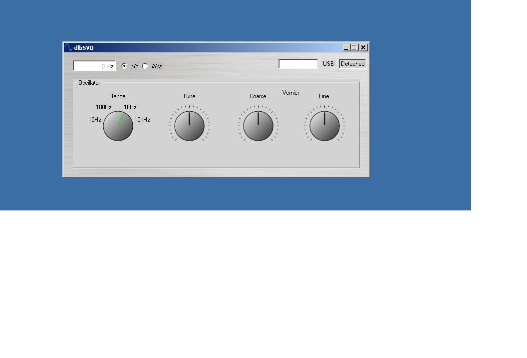

Here's what the UI looks like. More will be added as the project develops.
With the dac tuning I can add slow sweeps and auto tuning.
Using SPI means the oscillator is not married to any one micro controller. Any uP can be used. A PCI that handles SPI is an option as well.

OSHPark identified the problem with the missing plated holes. It was my unintended fault.
I clicked on a unsuspecting check box which removed the copper underneath the drill hit.
OSHPark is back on my list with a gold star for great customer service.
