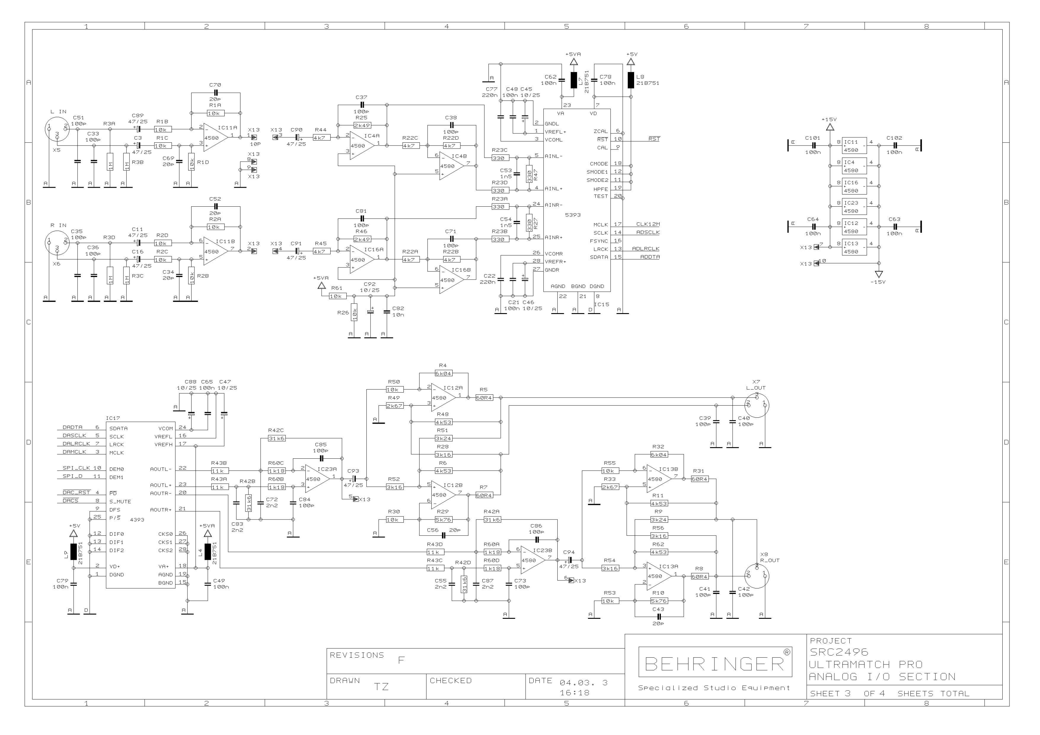

Does the Behringer Ultra Match Pro (model SRC2496) make a good starter basis for this and other things? Wonder which chips it uses. ??

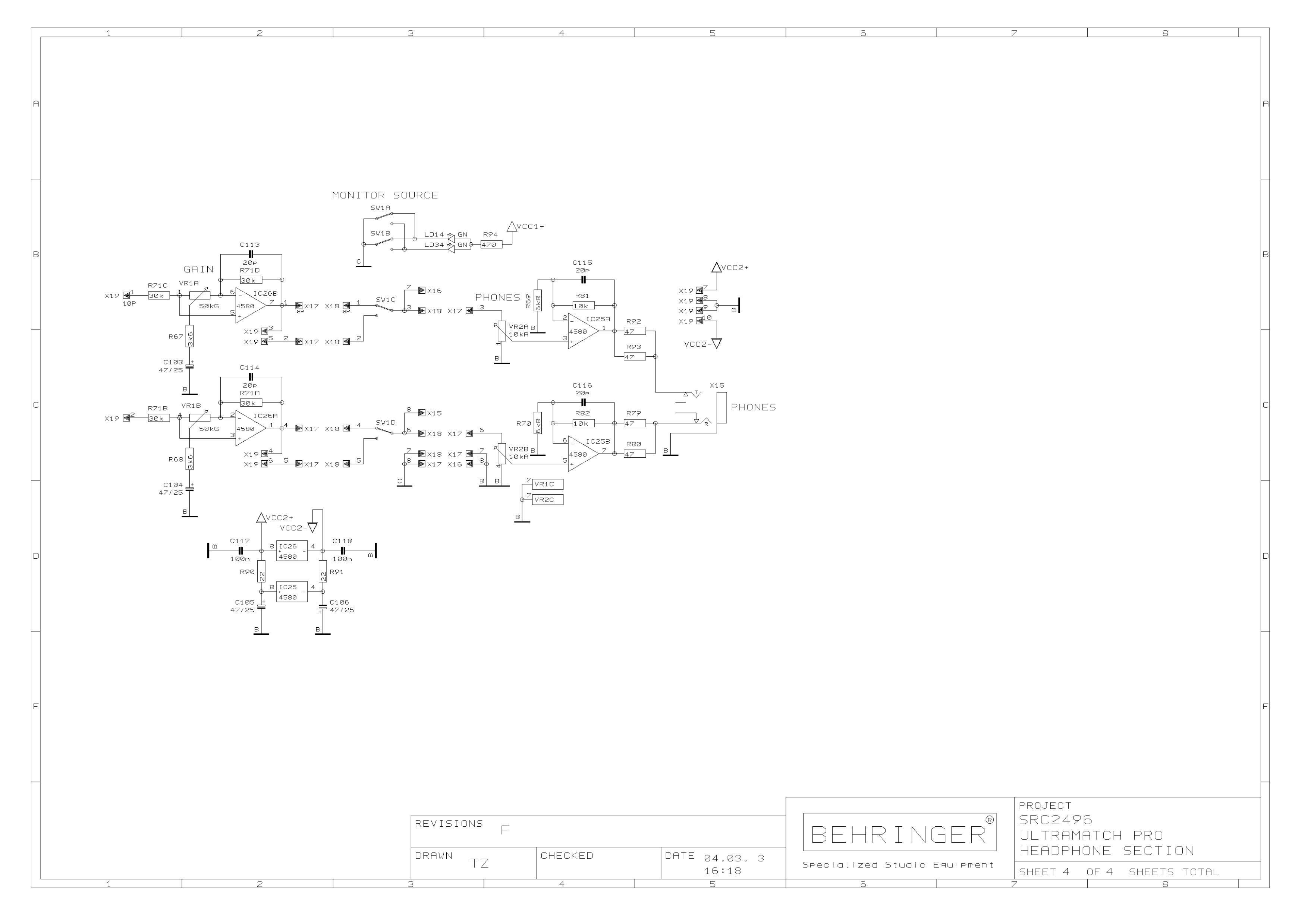

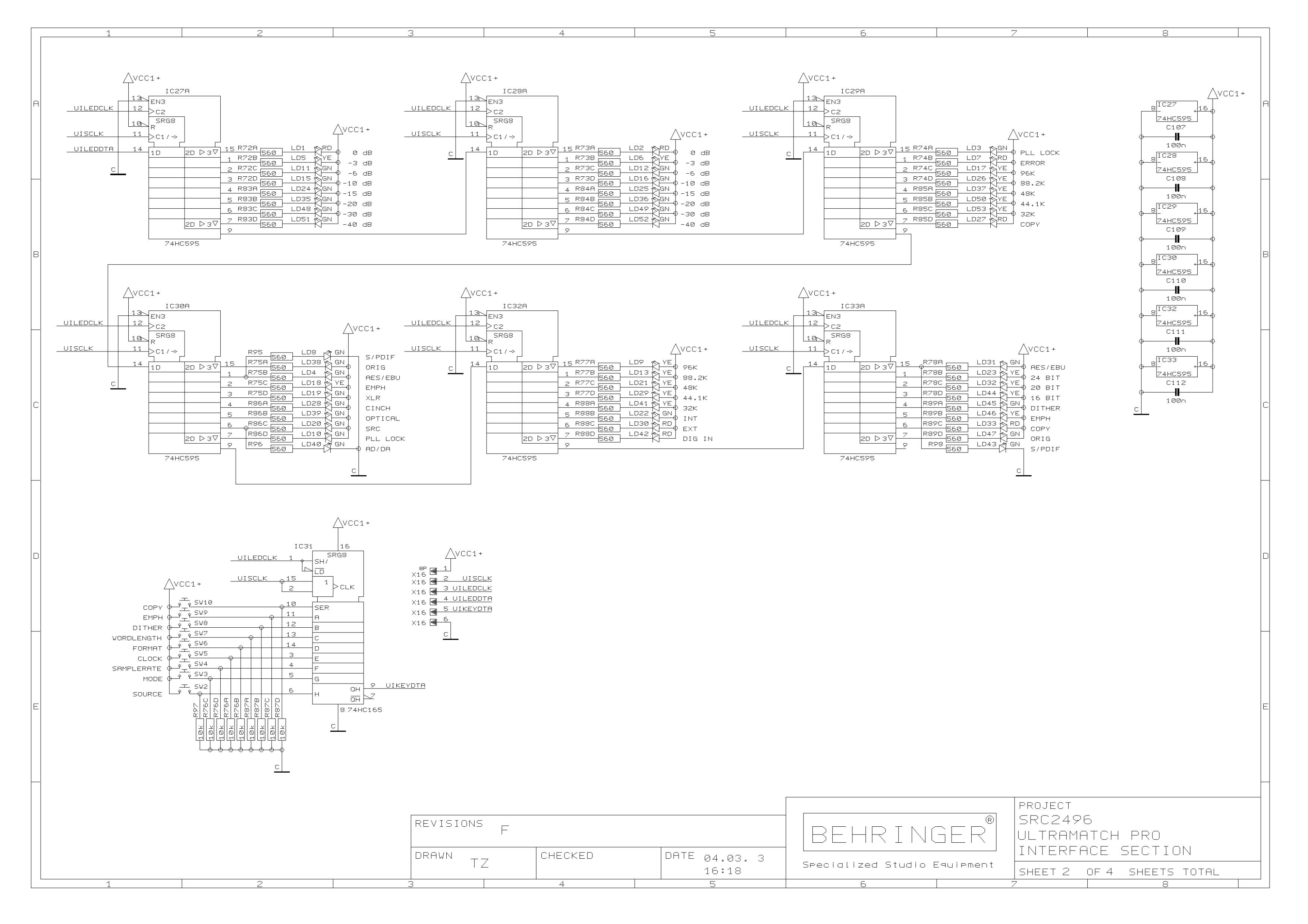

LOL, I paid for a mint condition NOS one on eBay just this morning, I should have it in a few days.Does the Behringer Ultra Match Pro (model SRC2496) make a good starter basis for this and other things? Wonder which chips it uses. ??
THx-RNMarsh
I wonder the same, so I decided to give one a try.
ADC is AKM5393, and DAC is AKM4393.
I have found discussion on the net of the usual Behringer 'ímprovements', but so far no real measurements.
I have an Edirol UA-25ex usb soundcard with spdif in/out.
Hopefully with the Edirol, the SRC2496 effectively becomes a usb soundcard, better than the Edirol.
The Edirol ADC kicks up truckloads of harmonics at input levels greater than about -6dBfs.
So, in combination with AWA F242 D&N set used as auto nulling notch filter, maybe I end up with pretty good loopback testing with any T&M software, unlike the QA400.
The SRC has a front panel stereo input level control.....total pita.
That might get replaced with stepped attenuators or 10-turn trimmers for accuracy, stability and set-ability.
http://www.lampizator.eu/LAMPIZATOR/TRANSPORT/behringer/SRC2496.pdf
View attachment SRC2496.zip
Mods/improvements suggestions are welcome.
Dan.
