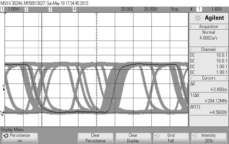

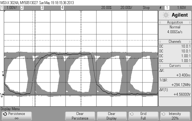

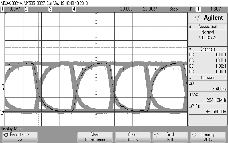

I have attached a couple of measurements, which I made before and after replacing the Toslink devices. The first one is with the original Toslinks, the second one is with a new receiver and the last one is with new receiver and transmitter.
I used infinite persistence and a trigger delay of 20us to get an eye diagram.
Clearly the new receiver improves the signal a lot, but the transmitter also contributes to the clean up.
TOSLINK input 192kHz sampling_USBStreamer as source_20us trigger delay_new TOSLINK receiver in c.png14.2 KB · Views: 308
TOSLINK input 192kHz sampling_USBStreamer as source_20us trigger delay_new TOSLINK receiver and .png14.7 KB · Views: 311
