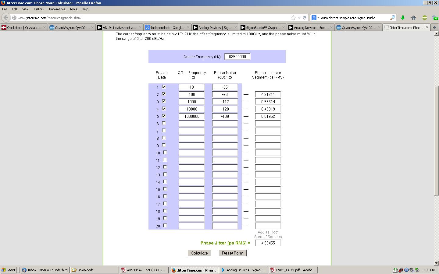

GigaByte lan requires clock jitter well below 1ps. So yes there are clocks available in the fs rms noise. The manufactures don't give very thorough data in their briefs. Perhaps the data sheets more detailed.
Beware of jitter specs published. You need to see the plot. the usual spec is for a high speed network and the lowest frequency is usually 12 KHz. It's easy to get sub picosecond jitter with a clock that would be really noisy for audio. Use this JitterTime.com: Phase Noise Calculator with the actual plot to get a better idea. AES uses the band from 50 KHz to 100 Hz but I would go to 10 Hz just in case. Adding jitter above the highest frequency of interest (top of the passband) is not useful since it won't have an effect. For 192 KHz I would include up to 200 KHz.
So this is what I get for a Fox oscillator claiming extremely low jitter.
They also claim jitter decreases with frequency.
