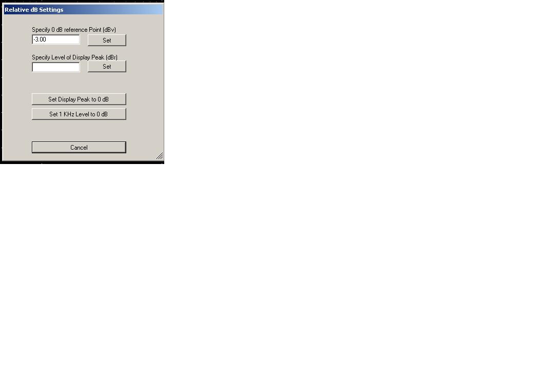

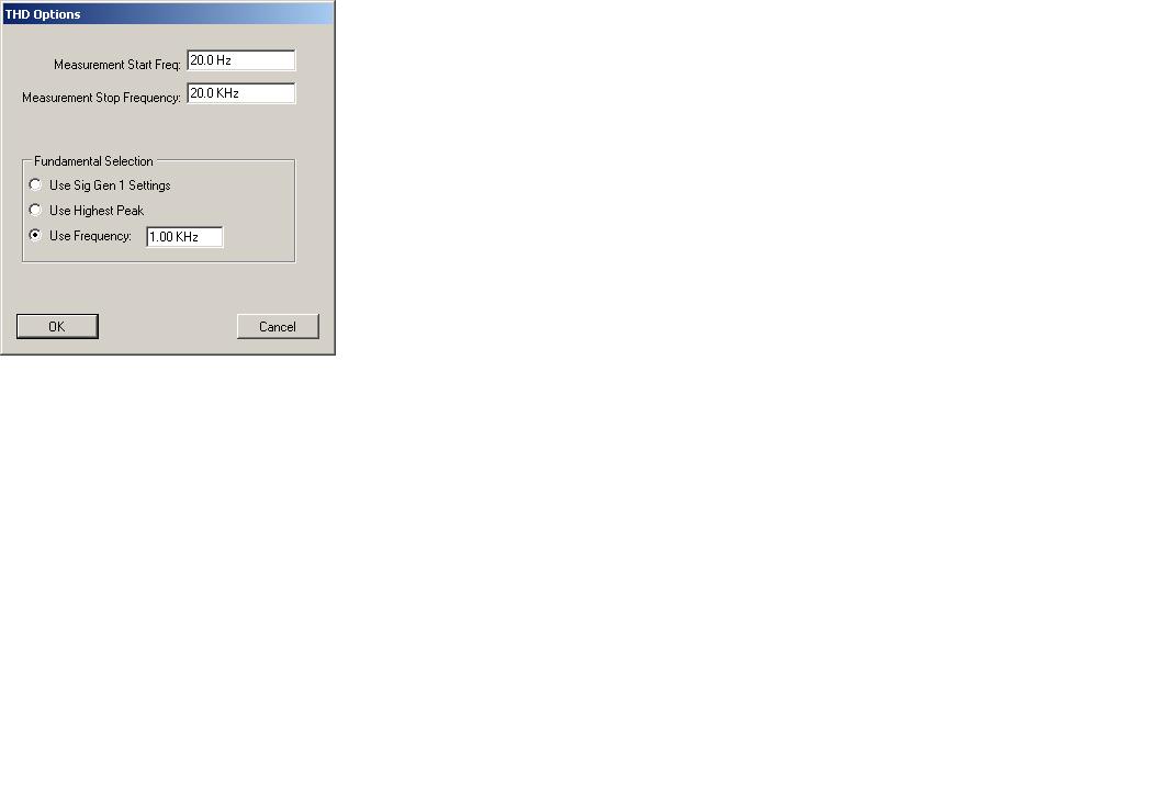

I believe the QA400 can be told to use its internal generator as the reference for the fundamental frequency. The level comes from what is measured at that frequency.
Well here ya go guys. Matt said he'd be delighted to add it in. Boy those QA guys are fast.
Kidding of course. I forgot I had a long discussion with Matt on the use of a notch filter.
Hold the CTLR key down and right click on the THD button.
Hold the CTLR key down and right click on the .dBr button.

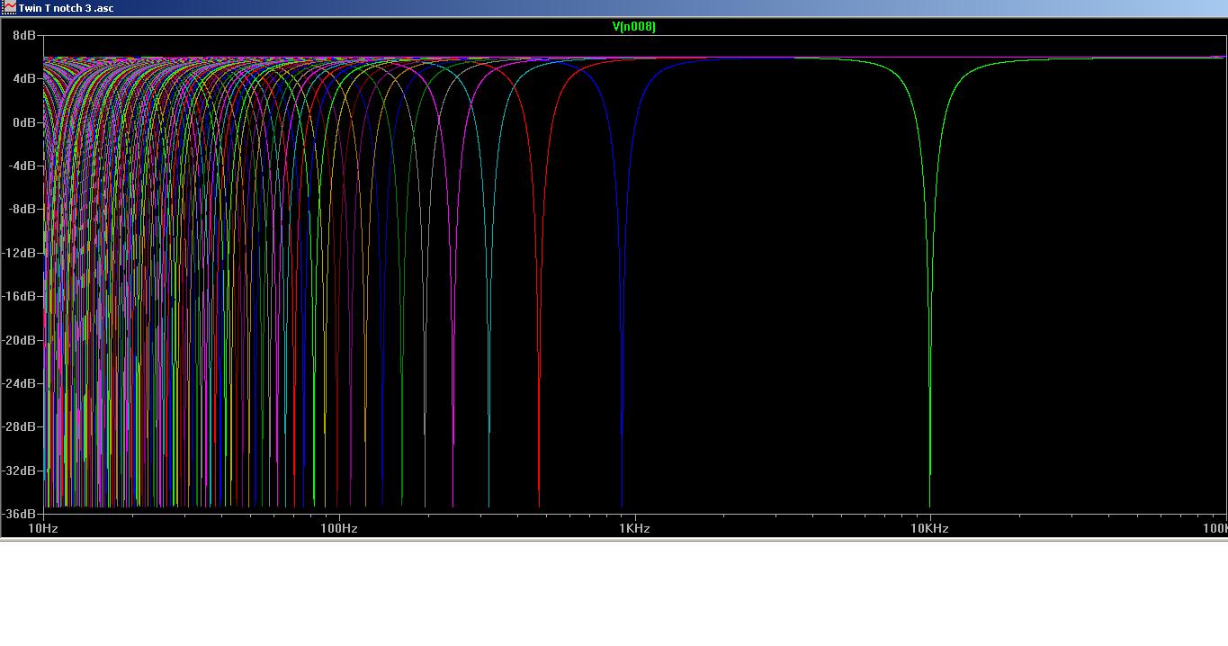

Anything I've done in spice to limit the notch depth also effects the selectivity (Q).
It kind of defeats the purpose. How can we add a stop band and not mess everything else up?
The tuning can be offset from the fundamental. That's one way.

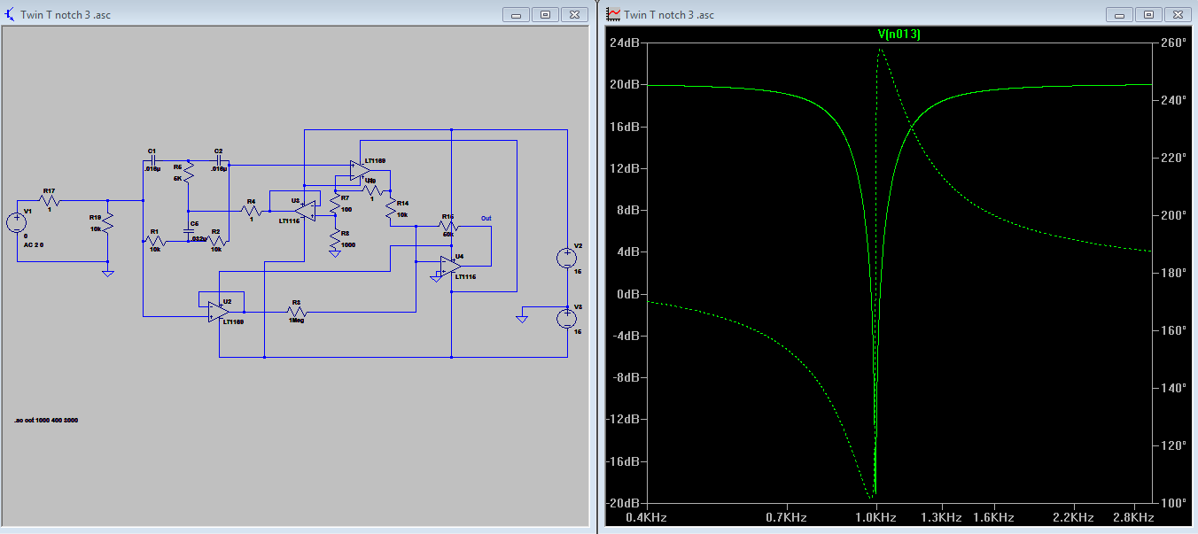

The only practical solution is to mix the fundamental back in post notch. That brings issues of how? Here is one solution based on SG's suggestion, It needs 4 opamps. The distortion contribution of the opamps is less important but I would use the LME49880 FET opamps based on my recent experience with them.

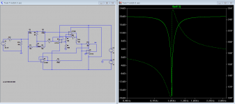

Have you tried this? It only requires one post op amp for the filter.
B&K 1607 notch filter activated
But it doesn't have a consistent limited notch depth and no post notch gain. I have one of the B&K filters and may add this to it. The input is not ideal either. Its impedance changes with frequency and the parallel opamp path brings the opamp's input nonlinearity into play. Low impedance sources are less affected and its not important when the distortions are above -100 dB. It all matters at -130 dB.

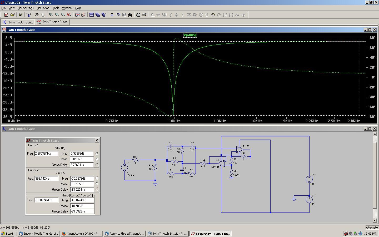

You can add a zero in as shown with R3 and adjust R3 and R4 ratio to get things right.
This add 6dB to the pass band without a huge effect on other parameters. The output gain can be adjusted with a post amp.
I haven't test this at other frequencies.
Tried it at 10k. Seems to hold quite well.
And at 100Hz very stable.

Agreed. I always use at least 20dB of gain. Either a post amp on the notch filter or adjust the gain of the sound card buffer amps. The latter is preferable. The circuit seems to be independent of Q. You can set the Q the usual way. This just places a zero in the stop band.
