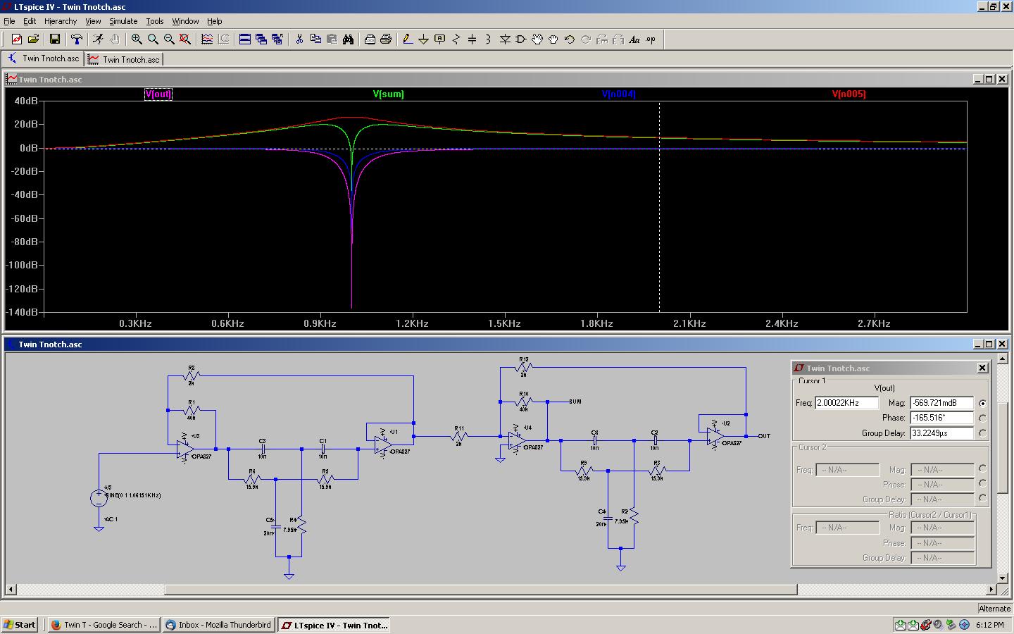

It is my understanding that putting negative feedback around notch filters to reduce attenuation at frequencies outside the notch is a very old technique. I think I first learned of it in the 70s. I believe it was used on many distortion analyzers (not necessarily ones using twin T).
Of course, the positive feedback approach for the twin-T just bootstraps the portion of the twin T that otherwise would be grounded. That reduces loss outside the notch in that approach.
The negative feedback approach keeps the twin T as an ordinary twin T. The output of the twin T is fed to an amplifier and the output of the amplifier is typically fed back to the input of the twin T, often being subtracted by an amplifier in front of the twin T. If the amplifier has a gain of 20dB, there will be 15-20dB of loop gain at frequencies outside the notch, flattening the frequency response in those regions. At the same time, in the notch, that 20dB of amplifier gain reduces the depth of the notch by 20dB. That's the tradeoff.
Quite awhile back I did SPICE comparisons of twin T filters with both positive and negative feedback to obtain the same amount of "error loss" at the second harmonic. I don't recall one being dramatically better than the other, but I seem to recall there was some stability issue with the positive feedback version that caused me to lean toward using the negative feedback version. But my recollection is fuzzy.
I first used the negative feedback version in the late 70's before I built my own THD analyzer. I could not afford much back then and made most of my own test equipment.
Bob
If two of these are cascaded together this is what you get.
I want a controlled, specific, notch depth, either 20 or 40 dB. Then using it in front of conventional instruments keeps them useful. Otherwise you have lost context in terms of the fundamental.

Easy to do by mixing a portion of the input signal with the output of the notch.
Samuel
The negative feedback approach keeps the twin T as an ordinary twin T. The output of the twin T is fed to an amplifier and the output of the amplifier is typically fed back to the input of the twin T, often being subtracted by an amplifier in front of the twin T. If the amplifier has a gain of 20 dB, there will be 15-20 dB of loop gain at frequencies outside the notch, flattening the frequency response in those regions. At the same time, in the notch, that 20 dB of amplifier gain reduces the depth of the notch by 20 dB. That's the tradeoff.
I see, thanks. The addition in front of the filter would need to be done passively, as adding an active stage in front of it somewhat mitigates the distortion advantage of a passive implementation (although the same consideration applies to the positive feedback approach, where the bootstrapping opamp also has a , although more subtle, distortion contribution).

I addressed this same problem in my distortion magnifier. In that design, I subtract appropriately scaled versions of the input and output of the amplifier DUT, with amplitude and phase adjust, to achieve a deep null of the fundamental, greater than 60dB. I then basically add back in the appropriate amount of the original signal to get a fundamental that is, in fact, 20 or 40dB down. This remaining fundamental can act as a pilot tone onto which a conventional THD analyzer can lock. The residual of the THD analyzer can then be fed to a spectrum analyzer to get really down there, especially since the use of the spectrum analyzer largely takes away the analyzer noise from the picture.
Of course, the DM can be used directly with a spectrum analyzer to provide the relative value of the fundamental, as you describe. The DM was written up in Vol 0 of Jan Didden's Linear Audio. I first used the DM approach over 30 years ago to help me measure the low distortion levels of my MOSFET power amplifier. I think I even touched on the technique in the JAES article on the amplifier.
I some situations the DM approach reduces the effects of THD in the oscillator source.
Bob
Samuel
Yes, the use of an up-front op amp will reduce the theoretical advantage to the distortion level of the op amp, so at minimum use of a very good op amp better than the DUT is important. But, of course, the same caveats apply to the limitations op amp distortion place on even the very best THD analyzers.
Doing the mix passively can be accomplished with a simple resistive combiner up front, but then the input impedance of the twin-T circuit is low and somewhat frequency-dependent. This might be OK if the source was a power amplifier being measured.
