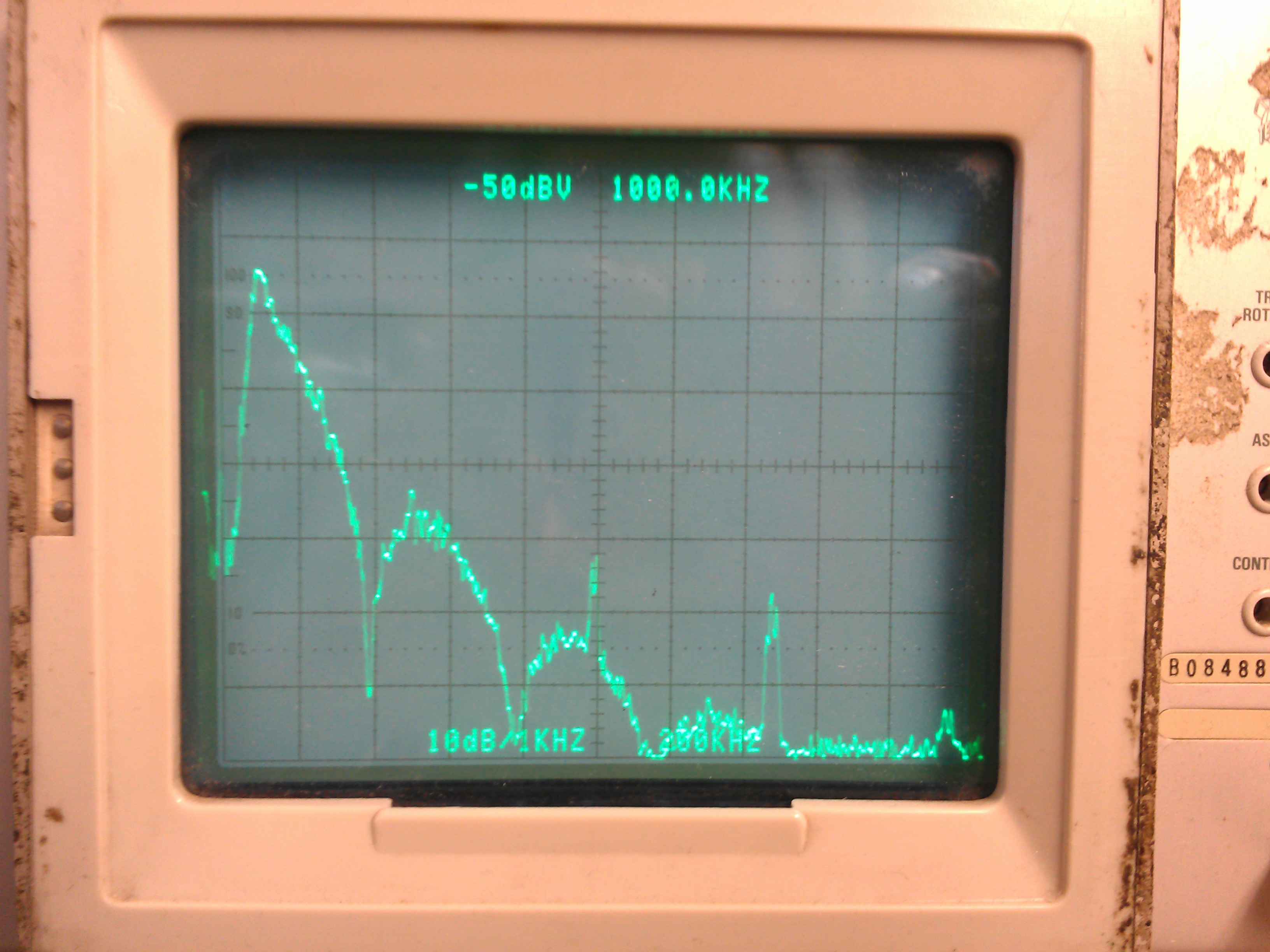

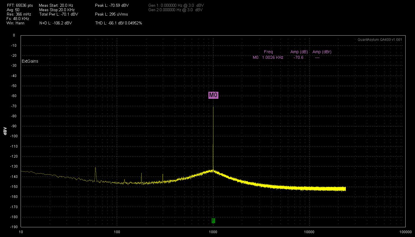

The first plot was the QA400 ADC. KH4400 into the ADC with the system tied to the charger for the laptop. The second was the output of the QA400. Its DAC output into a 7L5. Input set to 1 MOhm. I only plotted to 1 MHz because there was nothing of interest above 1 MHz. I don't see the nasties. Am I lucky? Is there something I'm missing?
Adding 20dB of gain and using the QA's add gain feature to scale the plot. The QA is not quite as good as the EMU0204 but comparable.
I don't really see a problem here.

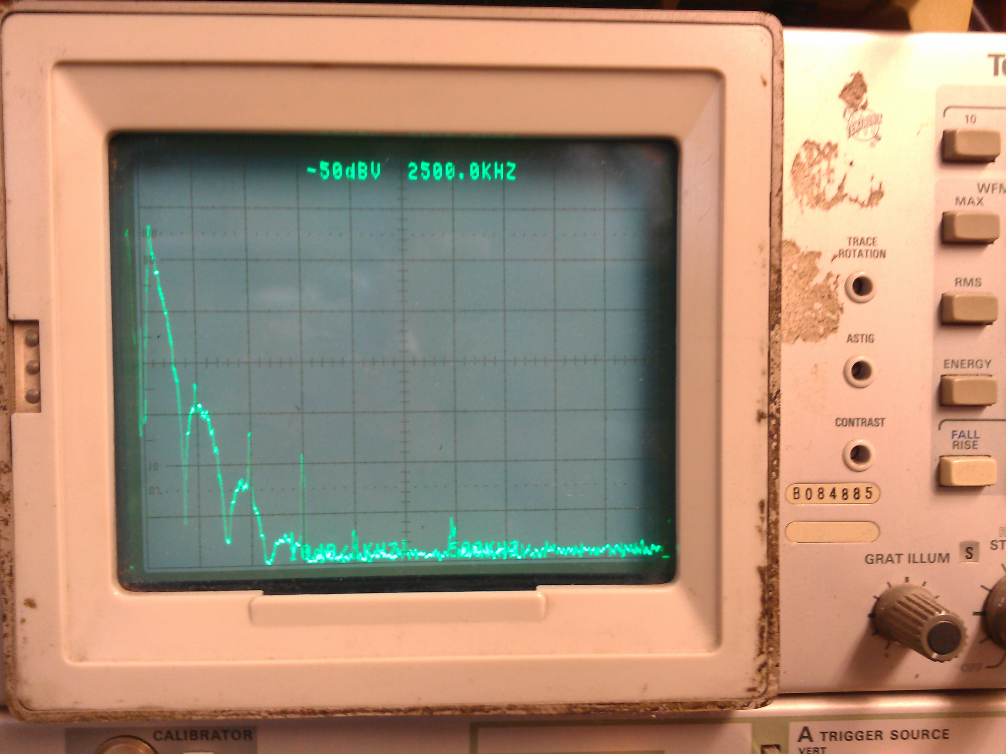

Here's a run to 100MHz with the HP 3577A:
In normal operation, a 20dB attenuator is employed in the 3577A.

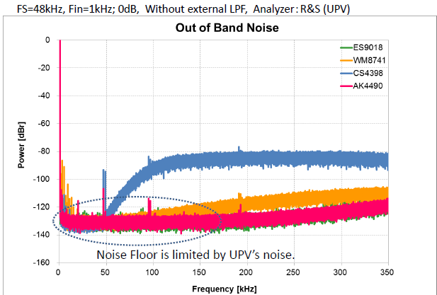

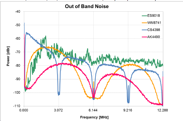

Look at the attached pictures. The Crystal DAC has the highest noise at the edge of the band. That's what you are seeing. Thats their noise shaping. I'm told that the noise shaping on the ESS is "noisy", always changing, unlike the others in this plot. I suspect its because its not synced to the incoming data.
These are generic and will be different with different sample rates.

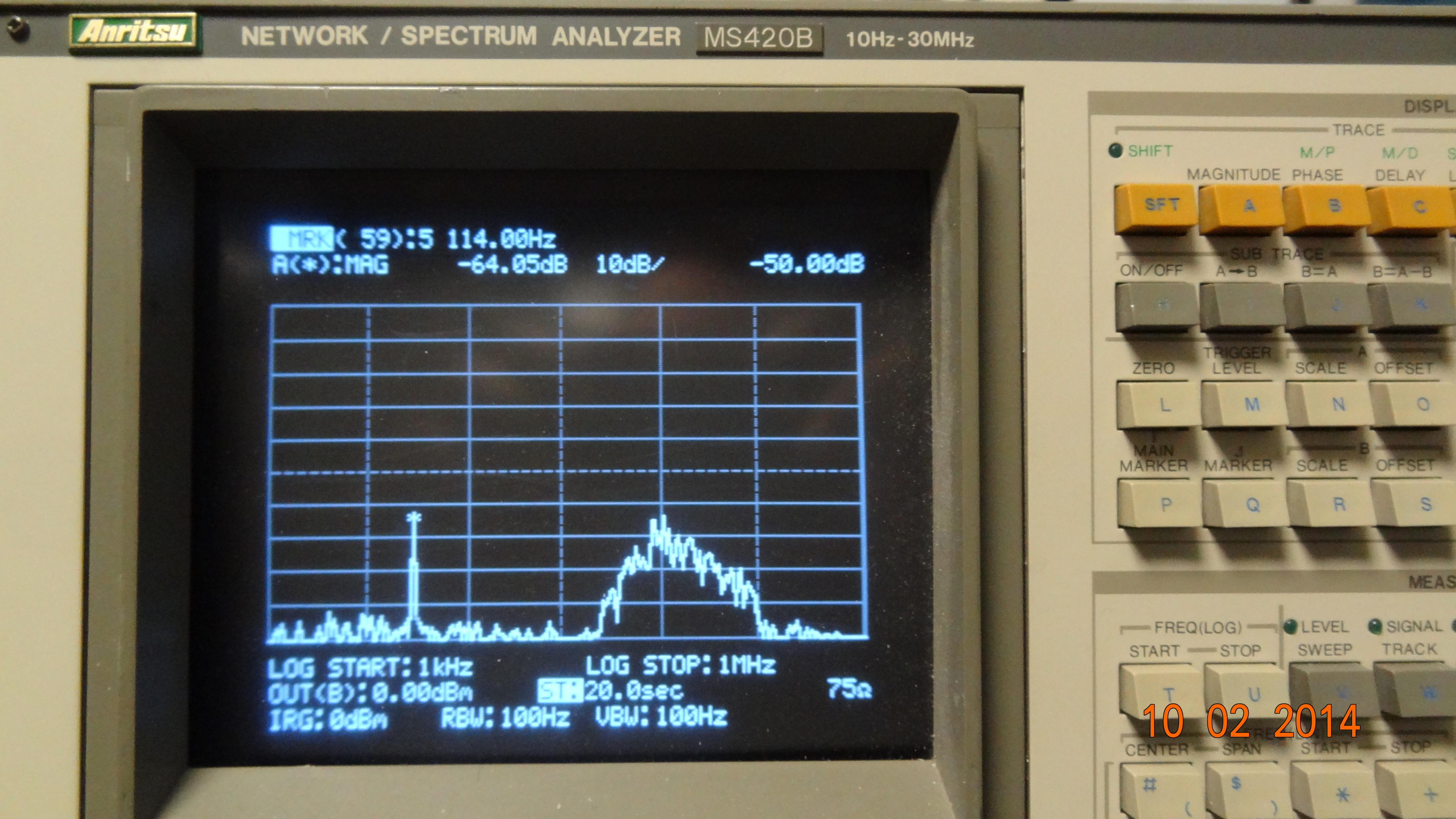

Here are two spectra, both of the QA400 running at 10 KHz -60 dB. You can see some of the aliasing, but most important is the noise peaking at 100 KHz falling on both sides. It looks like the Crystal spectrum I posted above.
