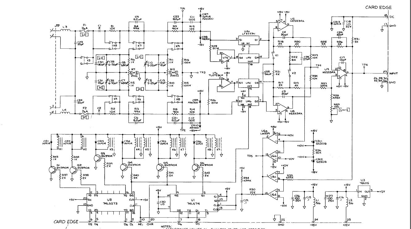

The existing linear circuitry in the QA400 seems to run off a very low voltage -- perhaps 2.4V. I didn't probe around a lot as the fluke leads aren't really designed for SMTs.
Since we're dealing with an instrument with limited bandwidth (the AP will perform FFT out to 103kHz, the QA is 20kHz) it might be useful to transformer couple the outputs to protect them from DC -- AP does this. Then you could also select the output impedance with insertion of a resistor. The outputs of the QA400 aren't happy with low-ish "Z" loads and a compound amplifier around the LME49710/LME49600 would help.
The inputs really need protection. If you're going to build a new low noise, low distortion front end, a low noise power supply has to go with it, especially if clamp diodes are going to be used. I liked the Boonton 1120 front end's protection scheme, but no longer have access to that manual.
As I've blown up many front ends measuring power supply noise and Zout, I would suggest a "sacrificial" socketed opamp, clamp diodes, a bit of RFI protection (and in my case, the ability to "pre-charge" the input coupling capacitor.)

1120
You know, I have a spare board with that circuitry. I'm itching to add a small micro and turn it into an autoranging sound card interface...
