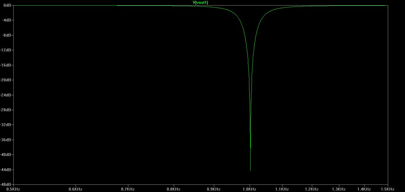

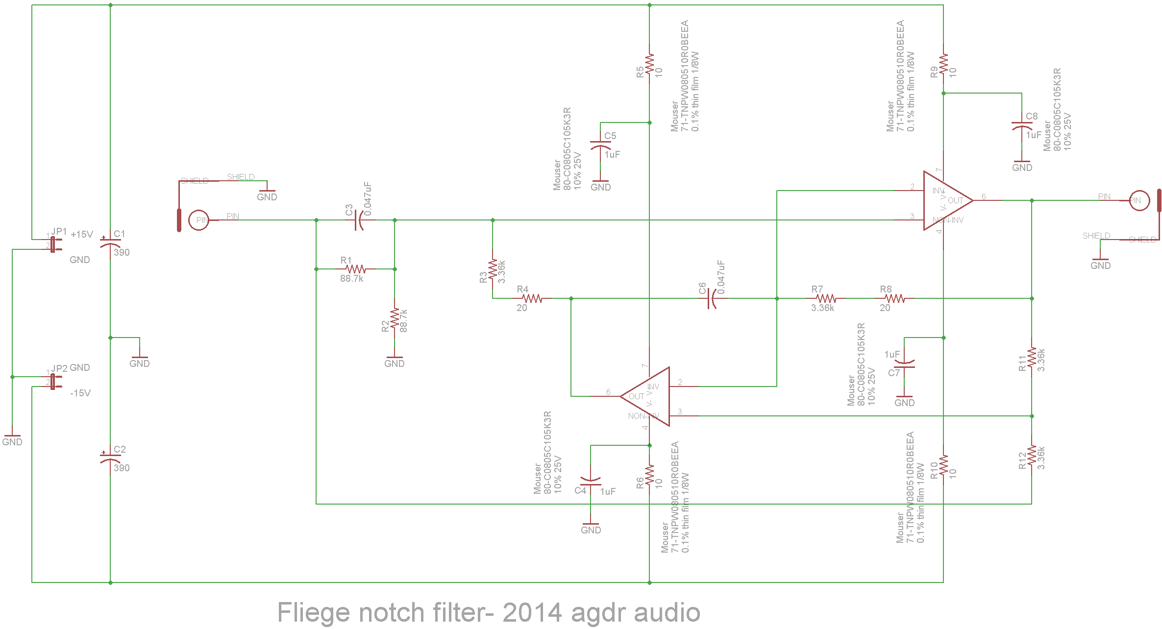

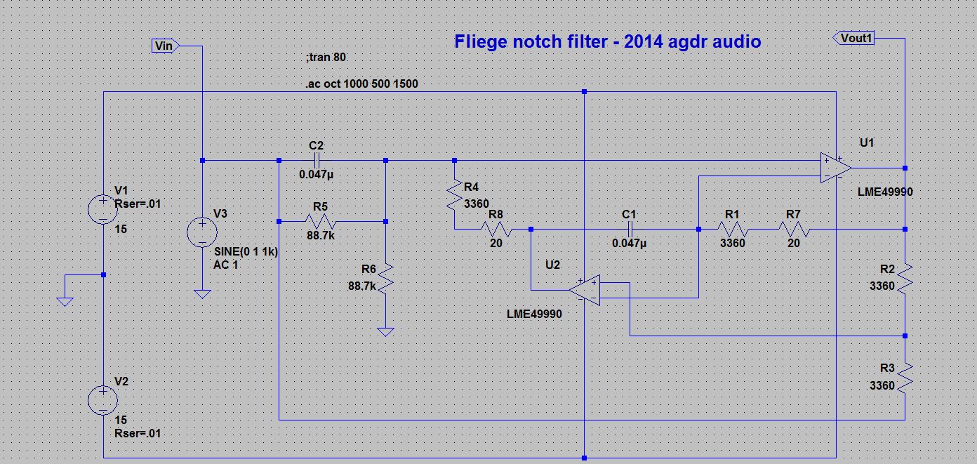

I just received a shiney new QA400 today. 🙂 Not bad for just $200.
For fun I may try a Fliege notch filter. This fellow
Notch Filter Calculator
may have a point about the Fliege being a little more real-world component friendly than a Twin T since it is mainly resistors. For the one capacitor value I've found a 1% polypropelene at Mouser.

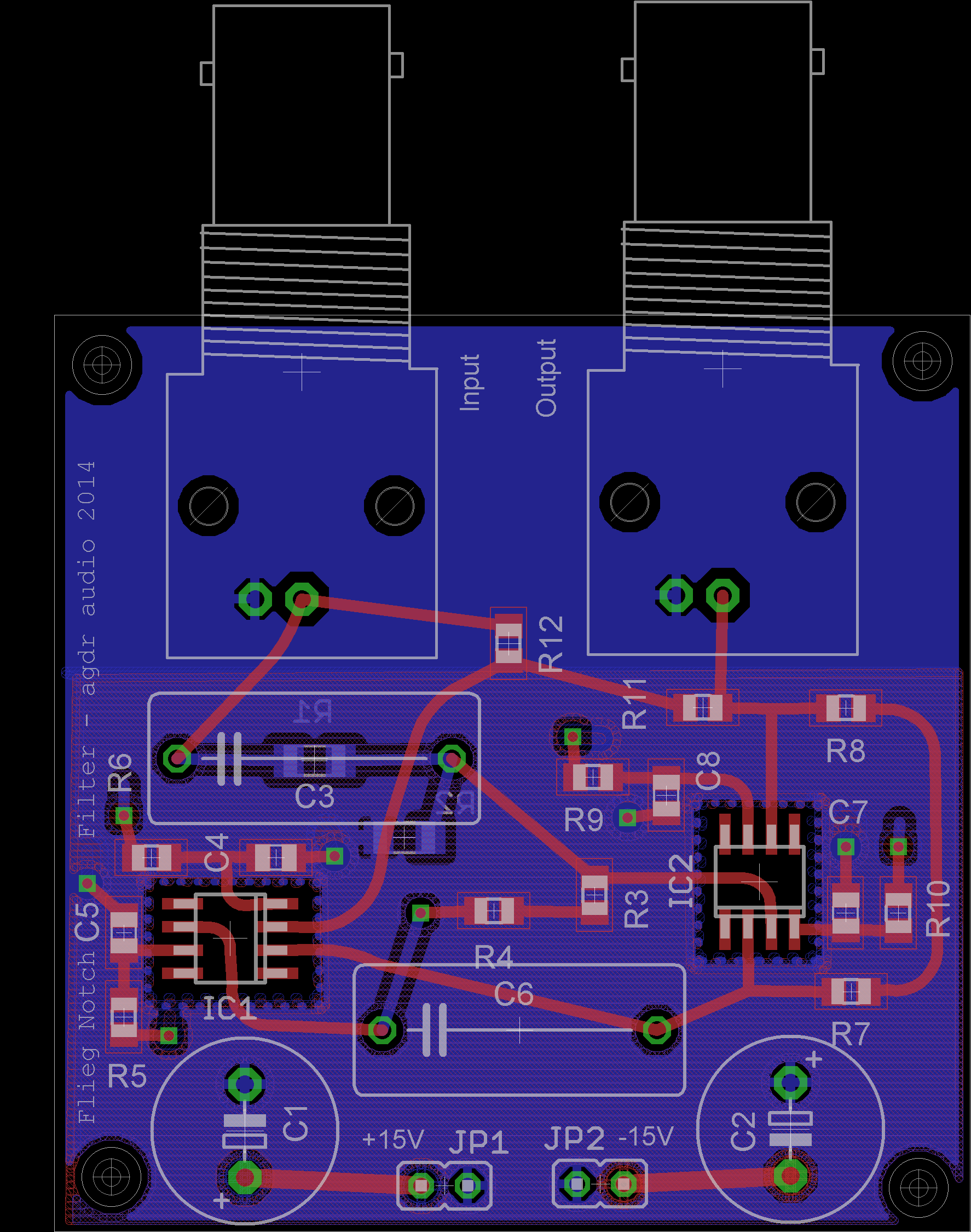

The layout is 4 layer. top = routing, next = ground, next = Vcc, bottom = Vee.

Thanks -- the Fliege looks to me like it requires fairly careful capacitor matching. I'd love to see tuning vs. component sensitivities and to know noise and THD from a real circuit. The Bainter filter also offers some advantages re components. Someday I'll get back around to looking at these.
Yeah, I'll be quite curious how it actually performs. Looks like there is such a thing as a 1% 50V COG MLCC 1206 SMD these days. 81-GRM31M5C1H473FA1L at Mouser for $1.29. Lol - maybe the last 4 digits of the part number being "FAIL" is telling me something upfront. 🙂 I think my caps are going to shrink.
