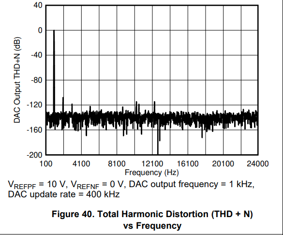

If it has to be TI's, how about DAC11001A with low noise and THD, R-2R-based? The THD performance in the datasheet looks good and covers at least 24KHz BW.
ESS isn't bigger than AKM as far as I know, and doesn't have the track record of a TI or AD where you can still buy parts that are older than some of the interns at my office.
There are caveats to that DAC; it will require glue to interface with, requires an external digital filter, and it seems like the distortion vs frequency is rising in the audio band more than most audio converters based on the posts in the thread on that DAC. That DAC is good for applications where DC precision and linearity are important.

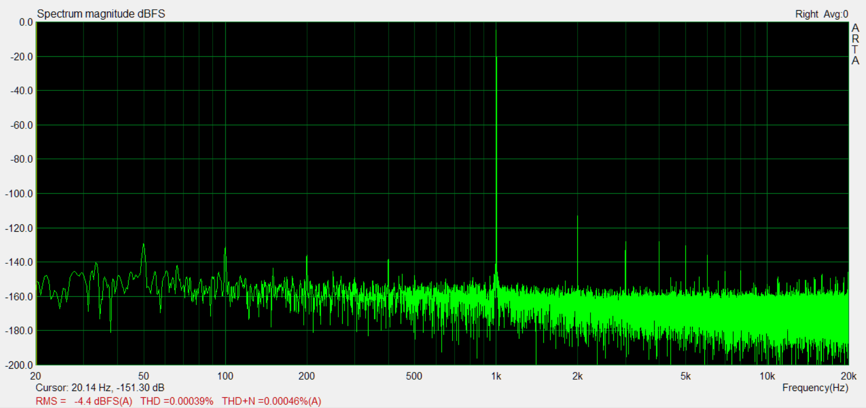

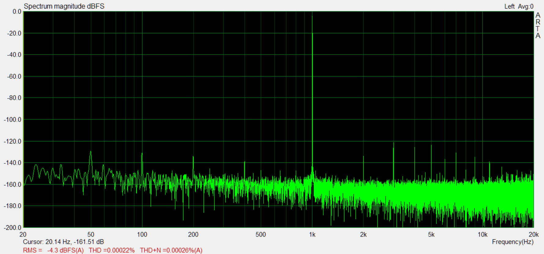

My recent experience with revisiting the 1792 again? Two images are attached. I have no idea which is the left or right channel but both are done at 96kHz with the OS turned down to 32x as this does lower distortion. Effectively cutting it in half, or showing what the performance would be at 48kHz with 64x OS. 64x OS is the default for the 1792 and the only option on the 1794.
NE5534 for the I/V stage, NP0/C0G caps.
One channel does have more distortion than the other but as this was a project I wanted to get done, and then shipped, I was happy to leave things as they were. It's hitting spec, especially if you consider the noise will be even lower in reality as this is including the ADCs input noise.
When you drop the signal level down to around -20dBfs the distortion drops into the 0.0001/2% realm.

Your measurement shows about -110dB below H0 at the 1st harmonic. With an ESS it can easily reach -130dB.
I'm not denying that. I posted these measurements as a comparison to the ones posted above. Needless to say mine are somewhat better than the others.
For one channel yeah, the 2nd harmonic is at around -110dB, the other one is significantly better and you'd always use the better channel for measurements where you need the lowest distortion.
