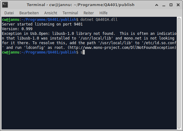

Ok, I finally came around testing the QA401H based web app.
Checking with 'lsusb' the QA401 is discovered correctly.
Unfortunately i get an Error concerning libusb-1.0 when starting the QA401H server application. Please refer to screenshot attached. The machine is running xubuntu 20.04LTS.
Any ideas?

Type the following command in a shell:
Code:
sudo dpkg -l|grep libusb
This will tell you if it's installed.
If it's installed you should see something similar to below (this is from my Debian 10 system)
Code:
ii  libusb-0.1-4:amd64                2:0.1.12-32                         amd64        userspace USB programming library
ii  libusb-1.0-0:amd64                2:1.0.22-2                          amd64        userspace USB programming library
If it's installed then you can find it's location with
Code:
sudo dpkg -L <library name>
In my case, the library is in '/lib/x86_64-linux-gnu/libusb-0.1.so.4'
Code:
sudo dpkg -L libusb-0.1-4
/lib
/lib/x86_64-linux-gnu/libusb-0.1.so.4.4.4
/usr
/usr/share
/usr/share/doc
/usr/share/doc/libusb-0.1-4
/usr/share/doc/libusb-0.1-4/README.Debian
/usr/share/doc/libusb-0.1-4/changelog.Debian.gz
/usr/share/doc/libusb-0.1-4/changelog.gz
/usr/share/doc/libusb-0.1-4/copyright
HTH
Thank you very much for your support. Certainly, libsub was installed before i tried launching the QA401H application. As stated in the QA401H manual.
The library resides in "/lib/x86_64-linux-gnu/" on my machine. Adding this path to "/etc/ld.so.conf" with a subsequent "sudo ldconfig" did not help.
So it's the library name that's the issue.
As per the page mentioned in the post above - this should fix it.
Code:
cd /lib/x86_64-linux-gnu
sudo ln -s libusb-1.0.so.0 libusb-1.0.so
This is creating a symbolic link to libusb-1.0.so.0.1.0
The symbolic link is called libusb-1.0.so.0 - and it is this library that the software is addressing.
Yes, the symlink did fix it. Now the library is recognized by the dotnet framework and the QA401H is able to communicate with the hardware!
