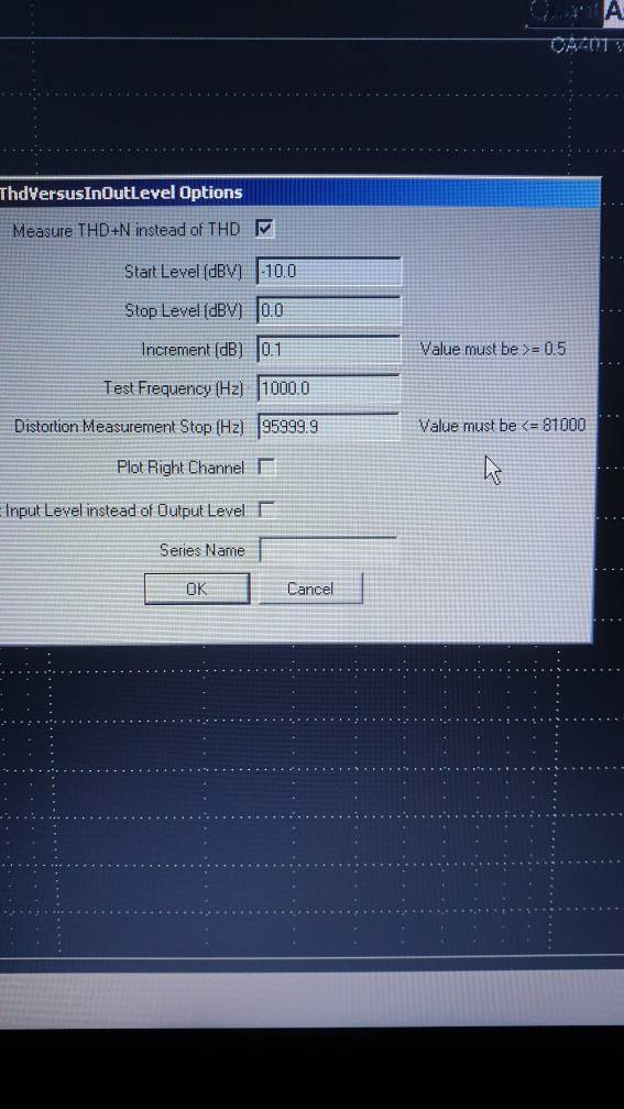

AmpThdVersusFrequency
Is it possible to make the increment minimum 0.1dB even 0.25dB is better than 1.
AmpThdVersusInOutLevel
Is it possible to make the increment minimum 0.1dB.
Thanks @QAMAtt
