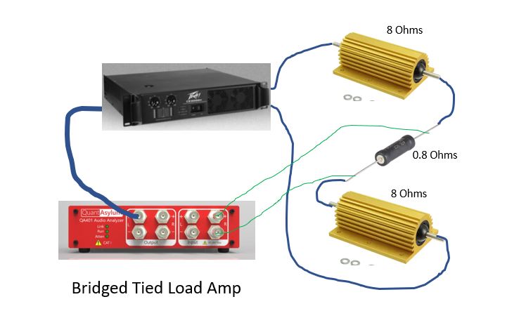

Are you measuring a bridge tied amp? Having the .82 in the middle is best for a BTL amp. It should be on the ground end for a single ended amp. I have been getting great results from the cheap china wirewound load resistors 50/100W 0.01-50 Ohm Watt Shell Power Aluminum Housed Case Wirewound Resistor | eBay they actually measure almost no inductance to 150 KHz. They do need a serious heat sink if you are running them hard. Old trick- dump them into a small bucket of water. They won't get above 100C until the water boils off.
In any case first turn off the attenuator in the QA401. You do not need it with the 20 dB from the load resistor. Second, increase the fft to 64K. These will get you at least 23 dB lower visual noise floor.
Also, are you using shielded cable to the input of the QA401? Those connection could pick up a lot of common mode noise if not shielded.

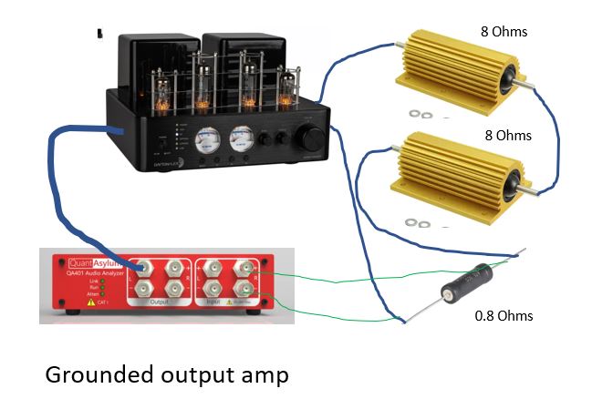

So simple question: to test non-bridged amp, 1 channel, up to 100W RMS, what load should I use?
8 Ohm + 0.82 Ohm will be fine?
So ground from the output of the amp should go to L- input, and output signal (taken from 0.82 Ohm resistor) to L+ ?

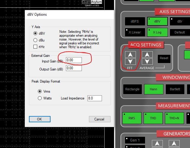

How to change FFT to 64k ? I searched for this option, nowhere to be found...

There are arrows above "fft" that control the fft resolution. Ill post a sketch and explain the connections so it makes sense I hope.
I hope these help. The show the connections for a BTL amp (what you are doing now) a grounded amp and the setting windows and where the FFT settings are.
You want to keep the voltages at the .8 Ohm resistor as small as possible to reduce common mode errors. On a grounded amp one output stays at ground so the .8 Ohm resistor connects there. For a bridged amp both outputs swing opposite each other so you want the resistor in the middle where the swing is minimized.
You also want to add the external attenuation in the dBV menu shown to correct for the external attenuation. Right click on the dBV button to get the dBV menu.
Let me know if you need more clarification.
Thanks a lot Demian! It helps a lot!
My dummy load is built like for bridged amp. Need to build another one for grounded amp.
