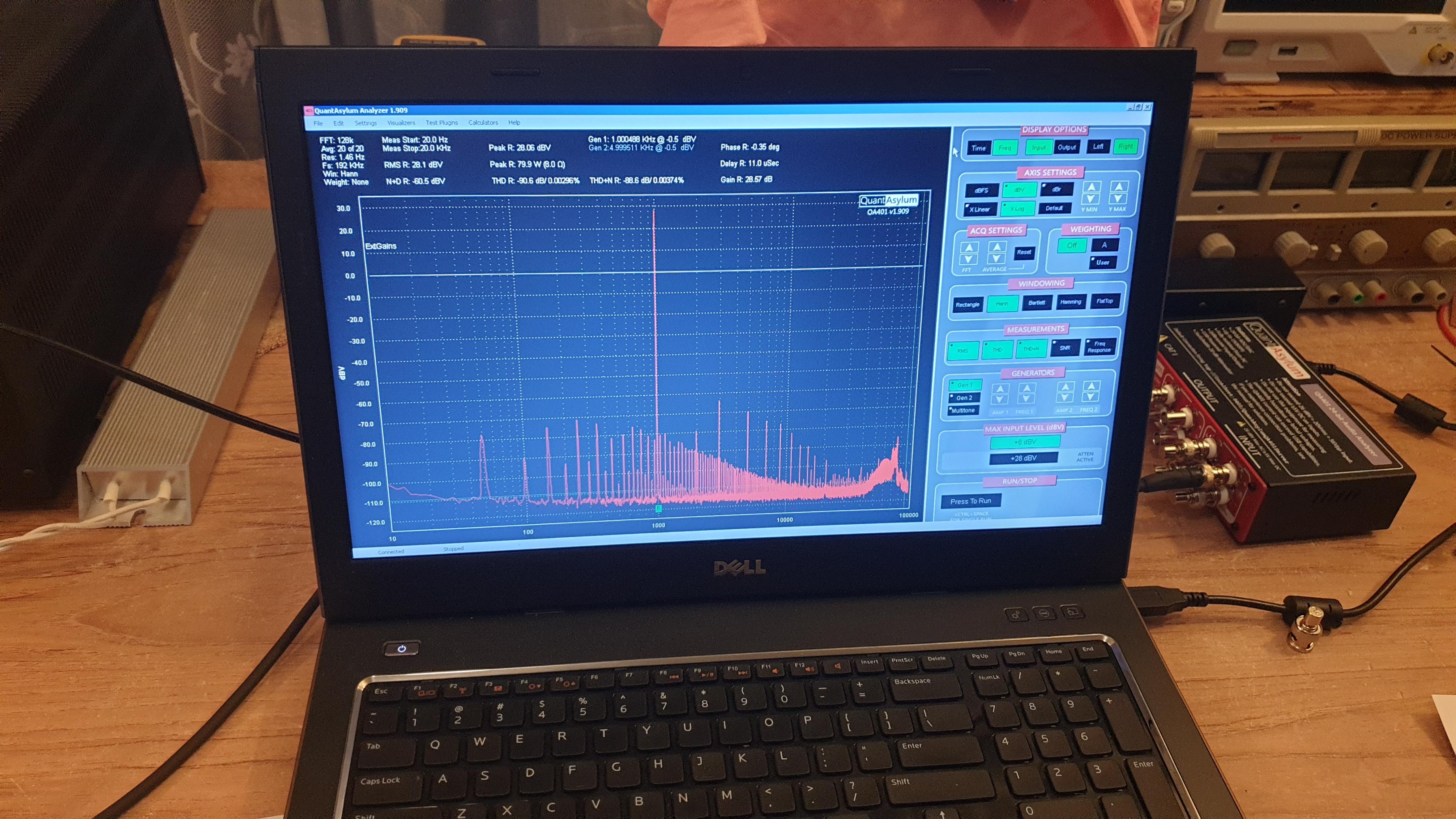

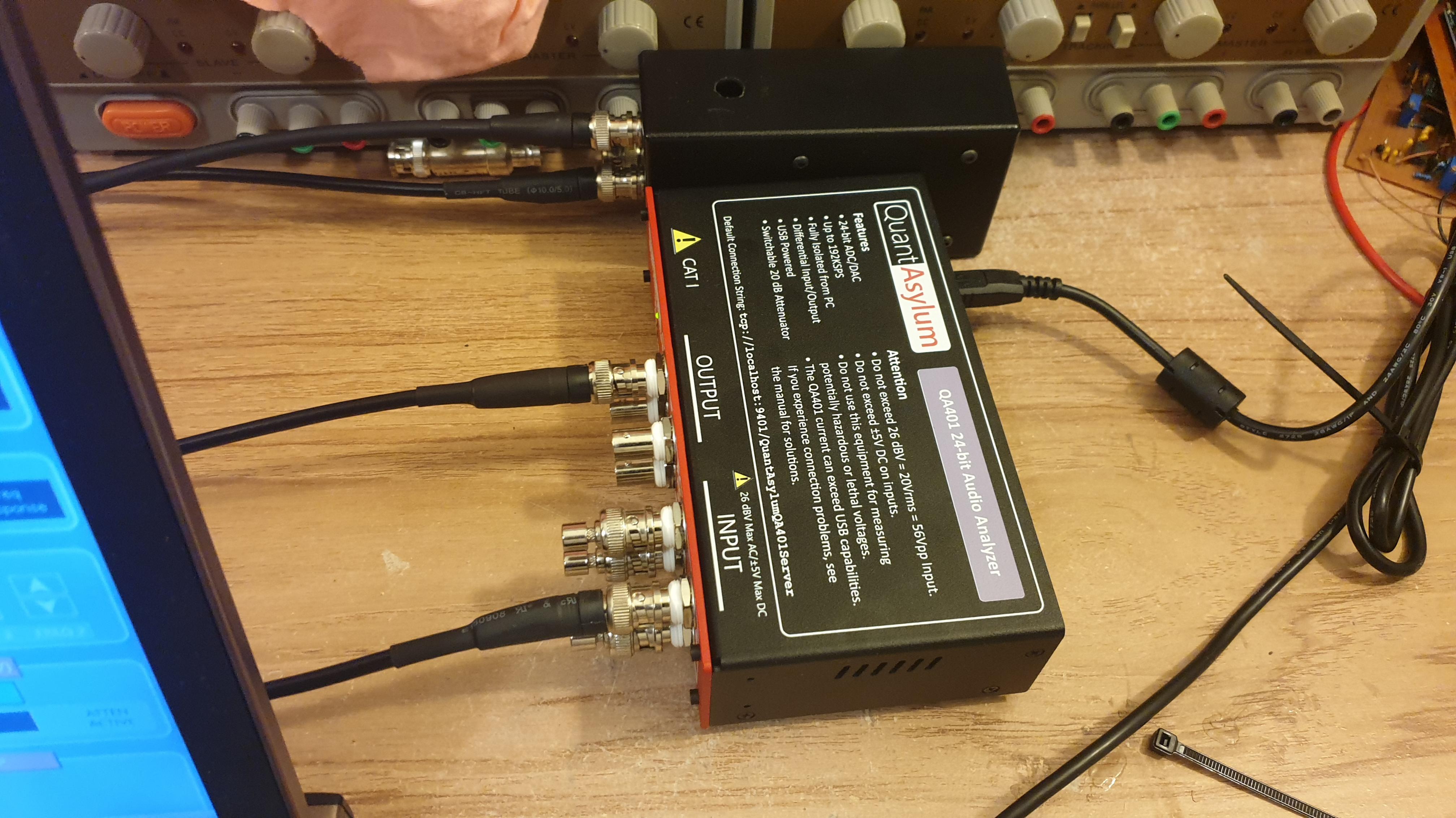

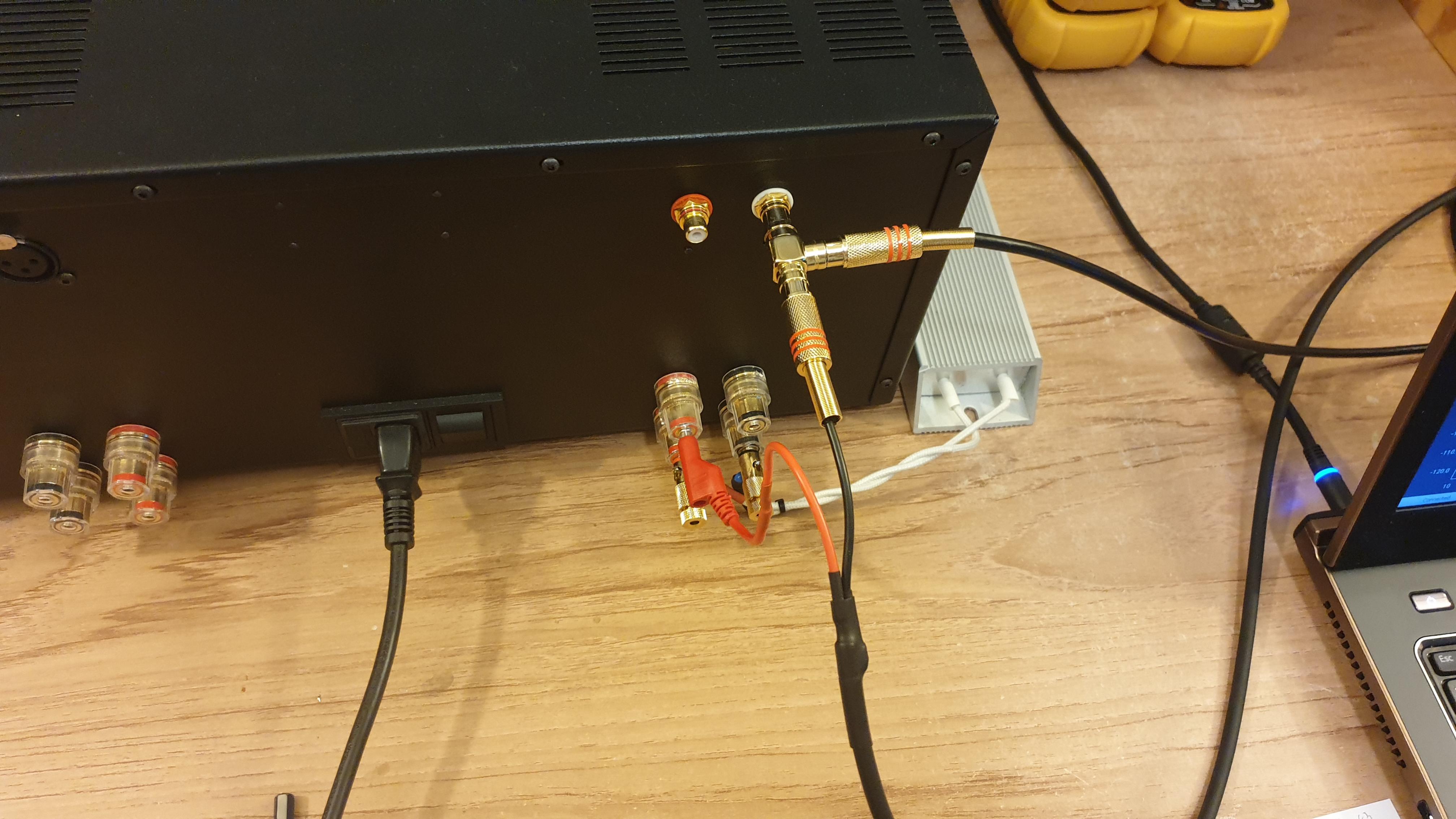

Distortion Measurements

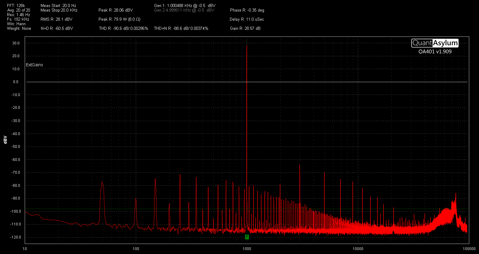

Hi Guy's
I just thought that I would share some information & photo's showing the distortion measurements of my Honey Badger using the QuantAsylum QA401.
I only received the QA401 last week, and so far, I'm very happy with its performance.

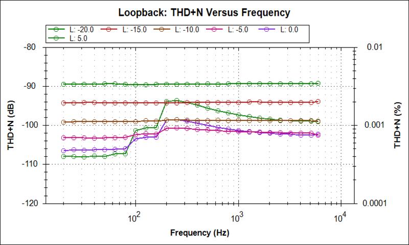

I initially ran some loop back tests and discovered that the lowest THD levels were achieved with a input level of -10dBV and the lowest THD+N levels were achieved with a input level of 0dBV.
I was able to see a loop back THD distortion of 0.00025% at -10dBV input level and a loop back THD+N distortion of 0.00090% at 0dBV input level.
So I decided to try and find a common input level where I could still achieve good loopback results. It turned out that -5dBV was the best choice.
At a input level of -5dBV I was able to achieve 0.00037% THD and 0.00082% THD+N respectively during a loopback test.
I then accurately measured the gain of the Honey Badger. In my case it was 28.52dB or 26.6667 AV.
I wanted to test the amplifier at a medium power levels to begin with so I decided 80 WRMS into 8 ohms would be a good starting point. This equates to an output level of about 25.29V or about 28dBV. I also needed to make some type of attenuation circuit to drop that output level down to -5dBV so I could optimism the readings for the QA401.
This was done by making a L-Pad attenuation circuit. It's the little black box behind the QA401.I measured the input impedance of the QA401 to be about 99K. I then created a spreadsheet to do the calculations for me. See the attached zip file if your interested. In future I will install a 6 position switch with different attenuation levels so I can run a range of output levels and still have -5dBV input into the QA401.
I then adjusted the Input gain level of the y-axis dBV scale on the QA401 so I could see the output power level on the display of the QA401.
The math to set the right level in the input box provided was 28.52 dB (from the Honey Badger) + 5.1 dB (which was the input level that I was getting without and input gain level adjustment due to my attenuation circuit) - 0.5dBV (which was the output level of the QA401 that I needed to achieve a output level from the Honey Badger of 28dBv or 80WRMS) this gave me a final value of 33.1dB
The results were very satisfying and a great starting point for further tweaking and measurement. I have attached a few images of my setup and the result plot.
I was able to achieve a reading of 0.00296% THD and 0.00374% THD+N.
To be honest I have no idea how to interpret the rest of the distortion levels and the harmonics caused by the 50Hz on the power supply.
Is this normal or is this an issue?
I would love to hear some feedback on this plot and what you guys think.
Cheers.

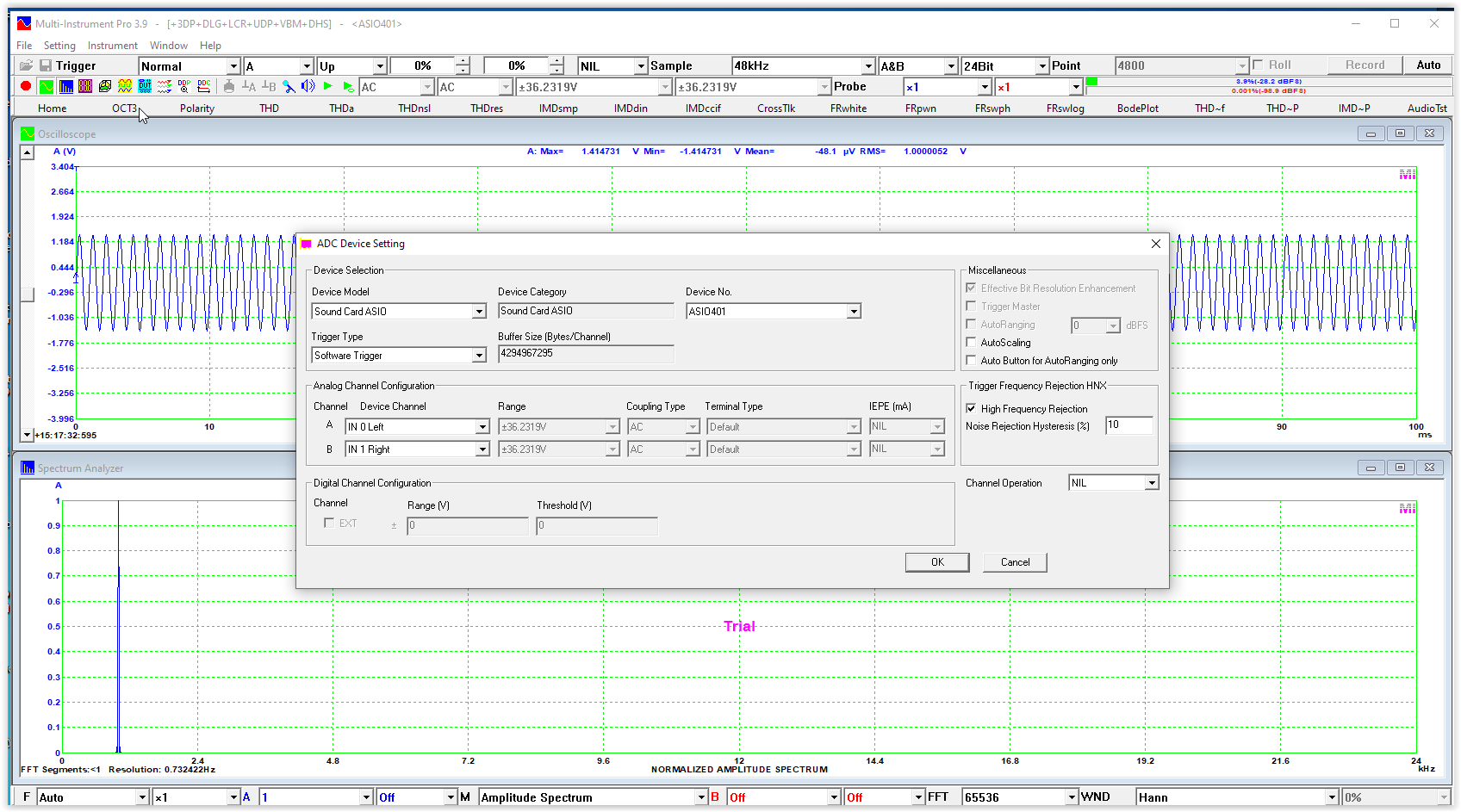

Are there any ASIO drivers in existence that work for the QA400?
I have one (and really like it) but basically the Win7 laptop it currently runs on needs to be repurposed. Many hours of compatibility mode and virtual machine attempts later have all ended in failure. Would really like to get it working with one of the other measurement software tools if possible rather than have to shell out for new hardware...
Any and all suggestions welcome.

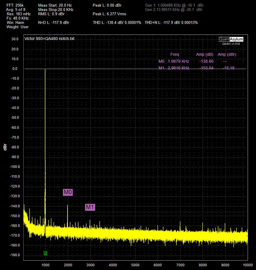

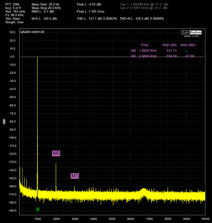

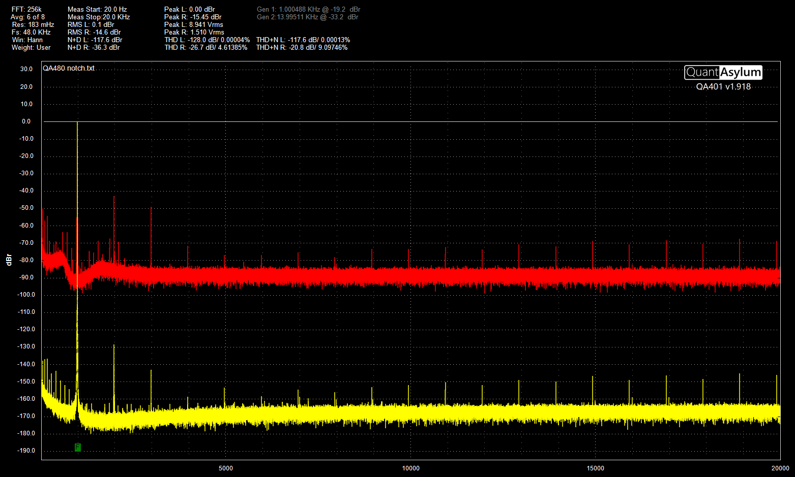

I got a QA480 from the limited run. Its proving its value. I have several measurements using it and the QA401.
The first plot is the QA480+QA401 (yellow trace) compared to the Shibasoku 725D using the Shibasoku AM70A oscillator as a source. Its not the lowest distortion source I have but convenient for this comparison. Except for the differences in harmonic level on H2 H6 the plots track quite well. The close in differences are typical when the residual of the source and the residual of the analyzer are similar in magnitude- they add and subtract. The Red trace is the residual at the output of the 725D. The actual levels are very similar but different references. The QA401 does not provide for separate reference levels for each channel.
The second plot is my battery powered Victor through the QA480 notch into the QA401. This is an early Victor. I believe the current ones are better. And finally the QA480 oscillator into the QA401.
Next task- use the QA401 with my passive B&K notch now that the process is together.
