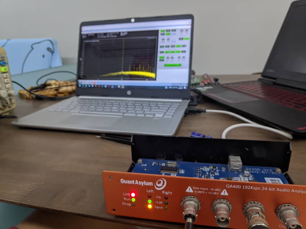

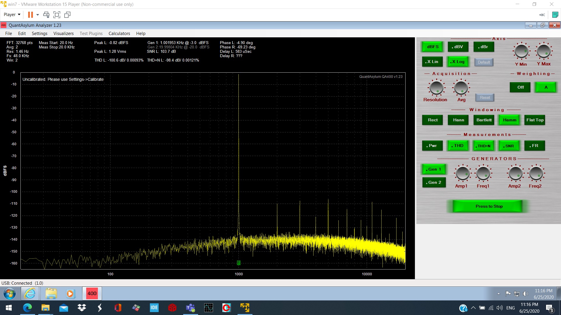

The QA400 doesnt work on my windows 10, but it works under vmware windows7x64home surprisingly. 🙂🙂🙂

Hi M5c, agdr, How did you get your QA400 to work on your win10 box?
Mine just sits there and doesn't respond to anything.
When in created an old os box virtual machine win7, I spent almost a month
fooling around with it but still had the same problem, it wouldn't work.
Couldn't get anything running with it.
That was my whole point of getting the Dell Lap-top so that it would work.
I do have an older Dell Laptop around here but it has no battery and the
strange power supply plug is of the squeeze together type that is in storage
around here. I found it once again that put it where I could remember to
use it when I found the computer again, but then couldn't find the computer.
I have used the Jim Williams method of organization, which worked until
I got married. Then she baggied up everything WillieNillie in various ziplocs,
and boxed them in unrelated boxes etc then moved them all over the house,
attic, garage, closet, workBench room etc and well y'all know....
So what's the secret to getting the QA400 working with win 10?
I feel your pain. Same thing happened to me.
