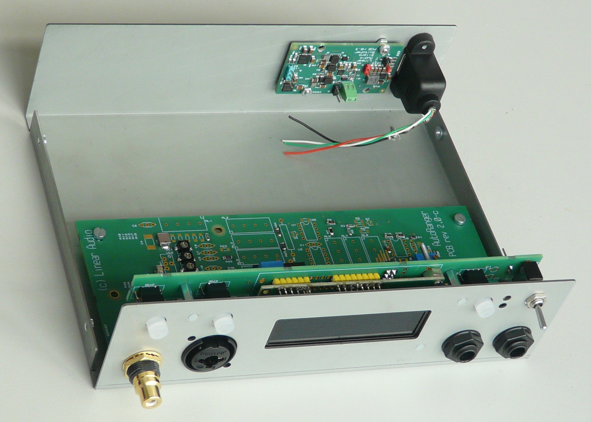

My autoranger for sounds cards and QA400-type test equipment is coming together nicely!
Jan

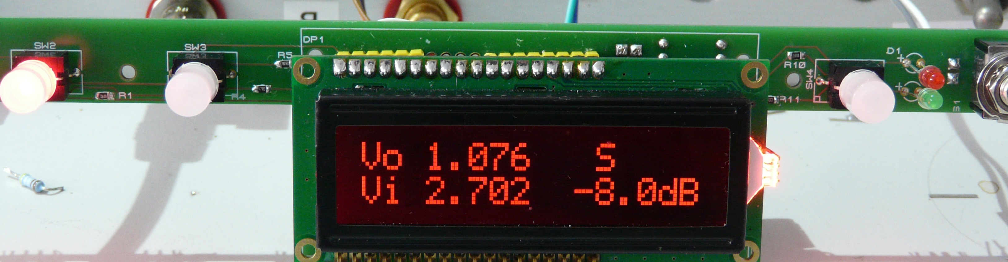

Details please!!! I'm assuming higher voltage input (from an amplifier) and lower voltage out to a sound card / QA device by the autoranger description. Balanced output? I see a USB connector...power or control or both. Looking forward to more info.
Jan
Yes, the numbers.
The max input is 100V RMS (140V peak) so you can directly measure power amp output. Min. input around 150mV. Between those levels the autoranger will deliver around 1V to your soundcard. Fully automatically.
Freq response is flat to 100 kHz at +/- 0.1dB. Distortion -120dB. That should be OK for all those sound cards out there.
To help with setup, the display shows the actual level going into the soundcard and the autoranger input level and attenuation or gain setting applied.
Atten/gain ranges from -40dB to +16dB.
Jan
