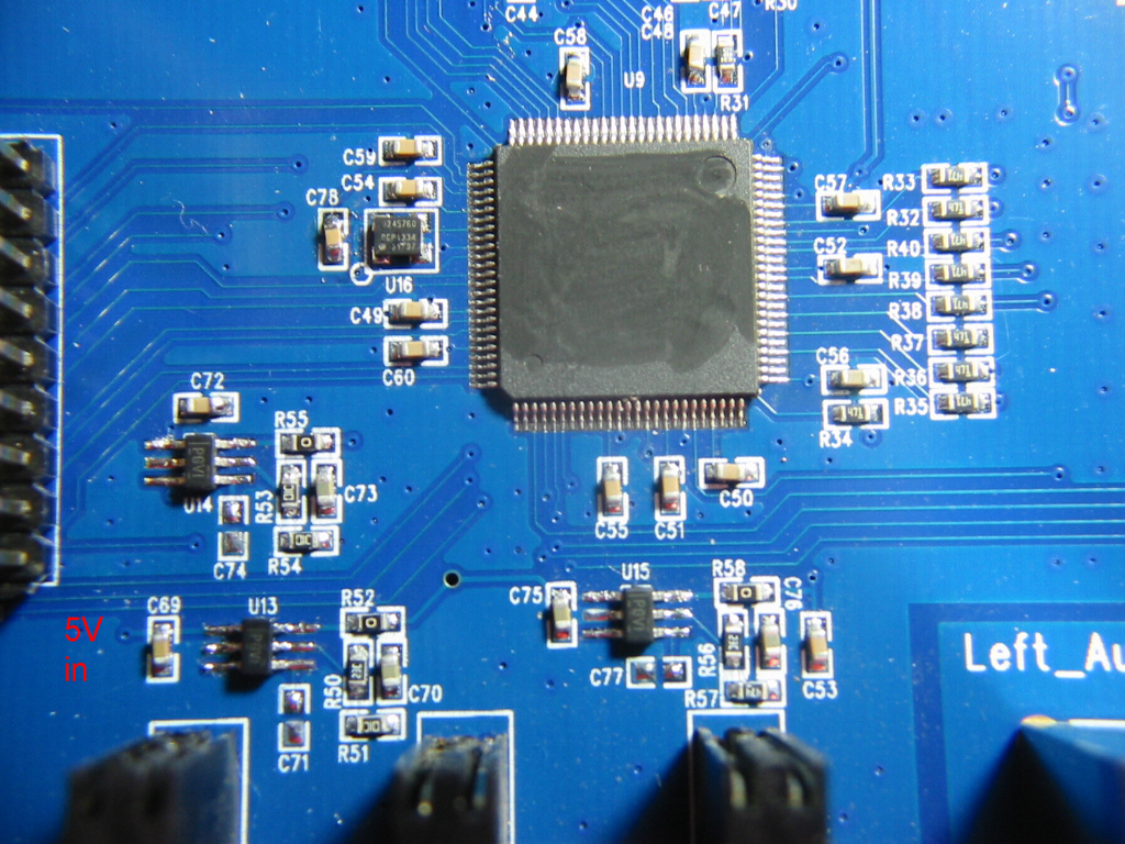

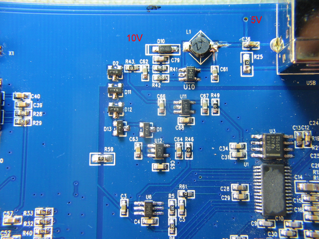

I managed to screw up my QA400 by discharging a 15000uF -40V capacitor through a ground loop, something like this: amplifier - input w a 25k pot turned to zero - QA400 input ground - QA400 USB con. - Computer GND - my grounded soldering iron touching the -40V . Lucky me only two IC-s burnt in it, a low dropout adj. reg. U13 and a boost converter U10 producing the +10V for the analog stages. The whole exercise cost me some nerve wrecking moments, because I don't have $550 for a QA401 and $60 for the parts from Digikey.
I surprised this didn't shut down the USB power before any damage. A ground fault should have just burned some thin trace on the ground.

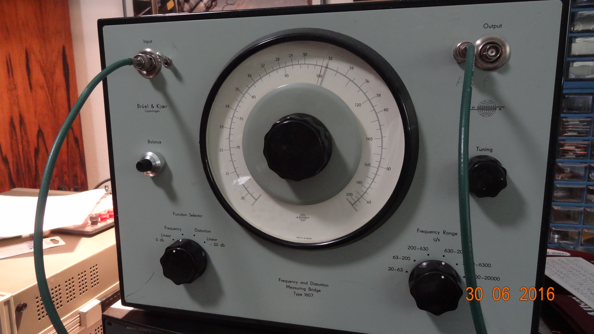

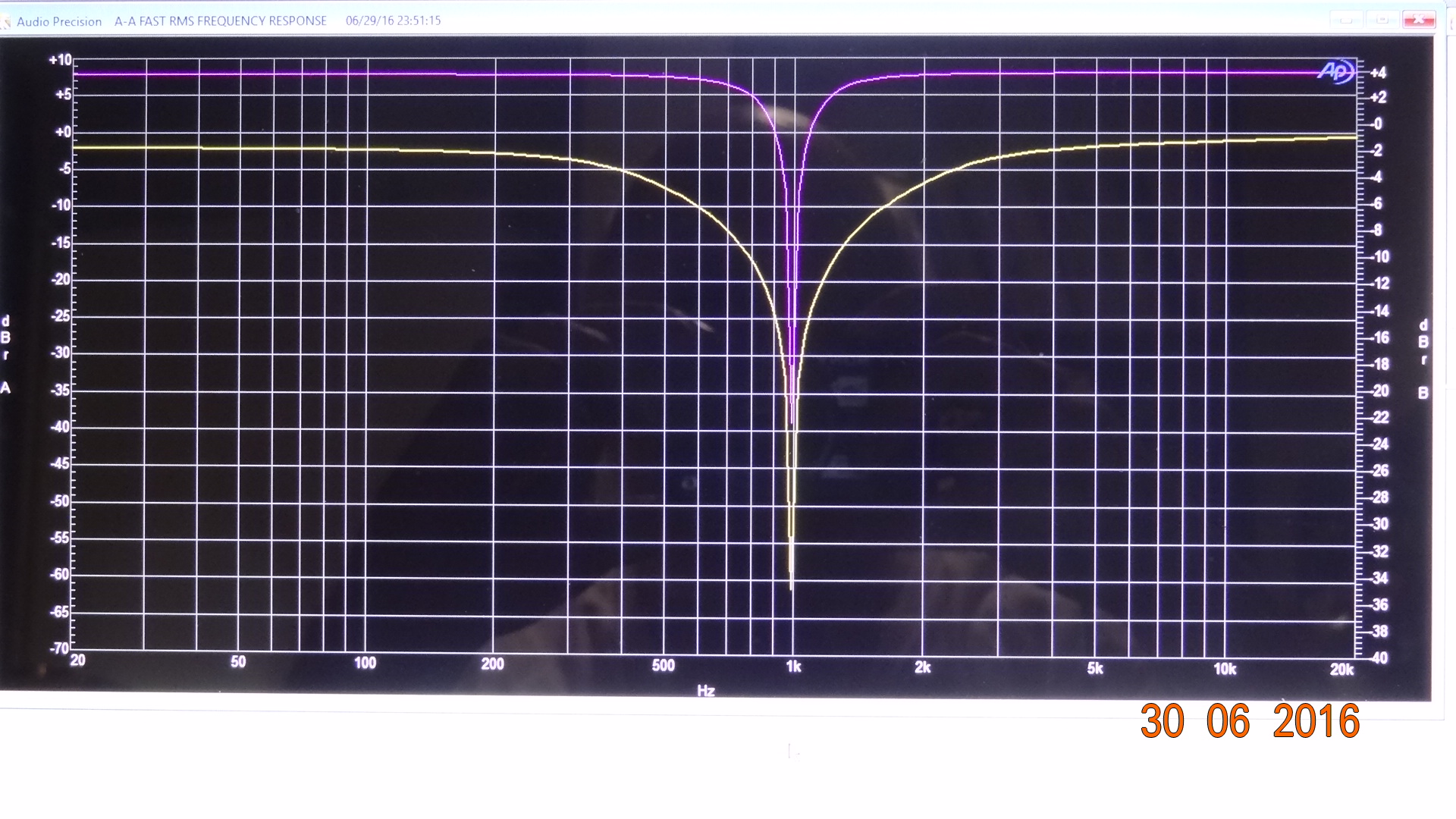

From the HP-339 mod forum.... we used an external notch filter to atten the signal to the ADC for greater linearity in measurement apps. I found a passive notch filter (nill distortion) from B&K 1607. Then I got some help/suggestion on converting it to active for sharper notch width. I have it switchable -- active-passive mode.
Here is the before and after mod affect:
THx-RNMarsh
THx-RNMarsh

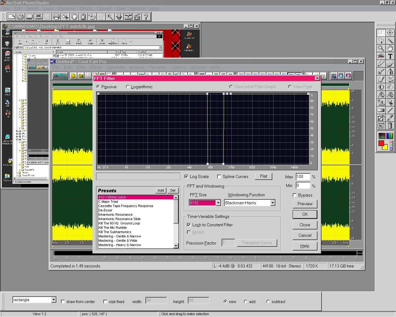

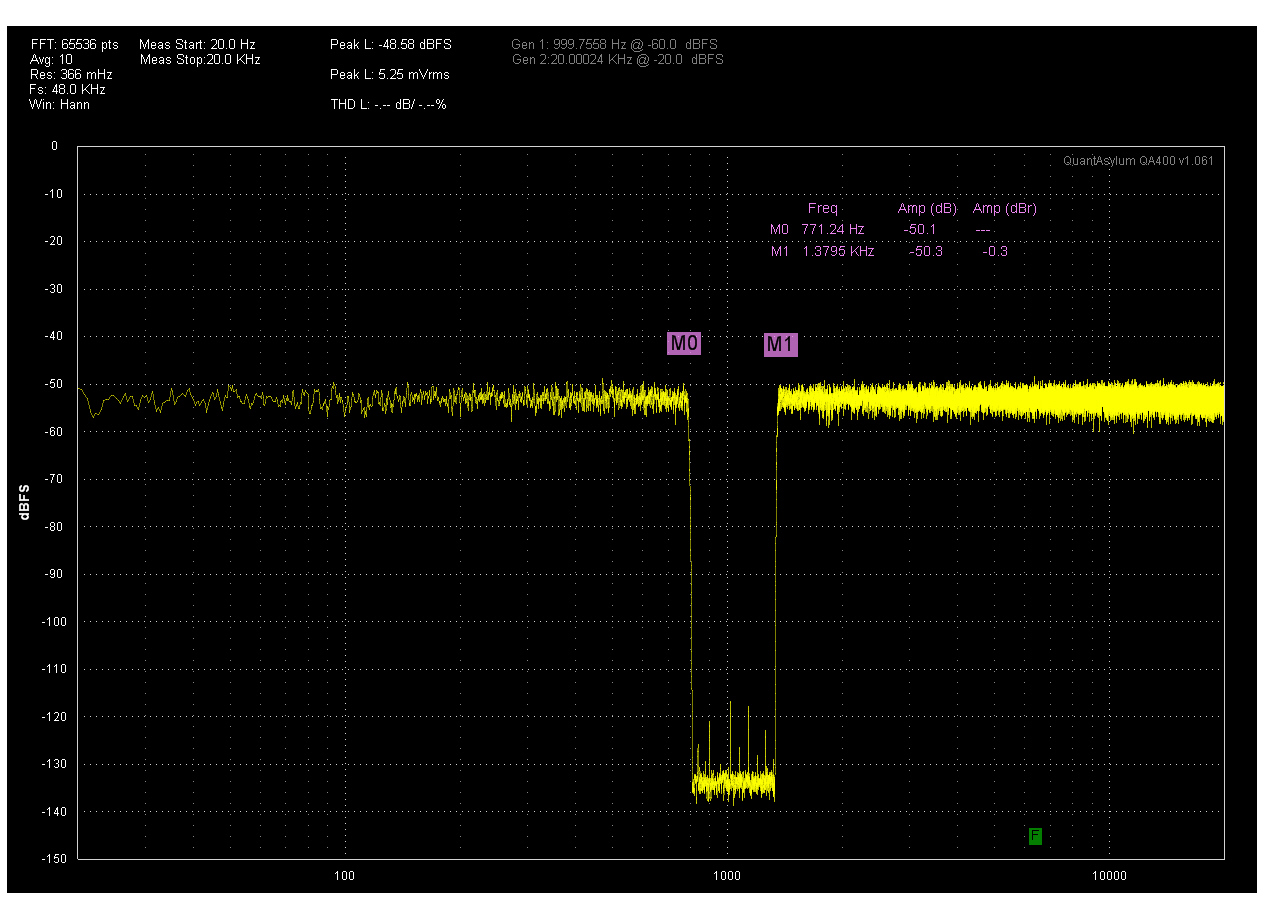

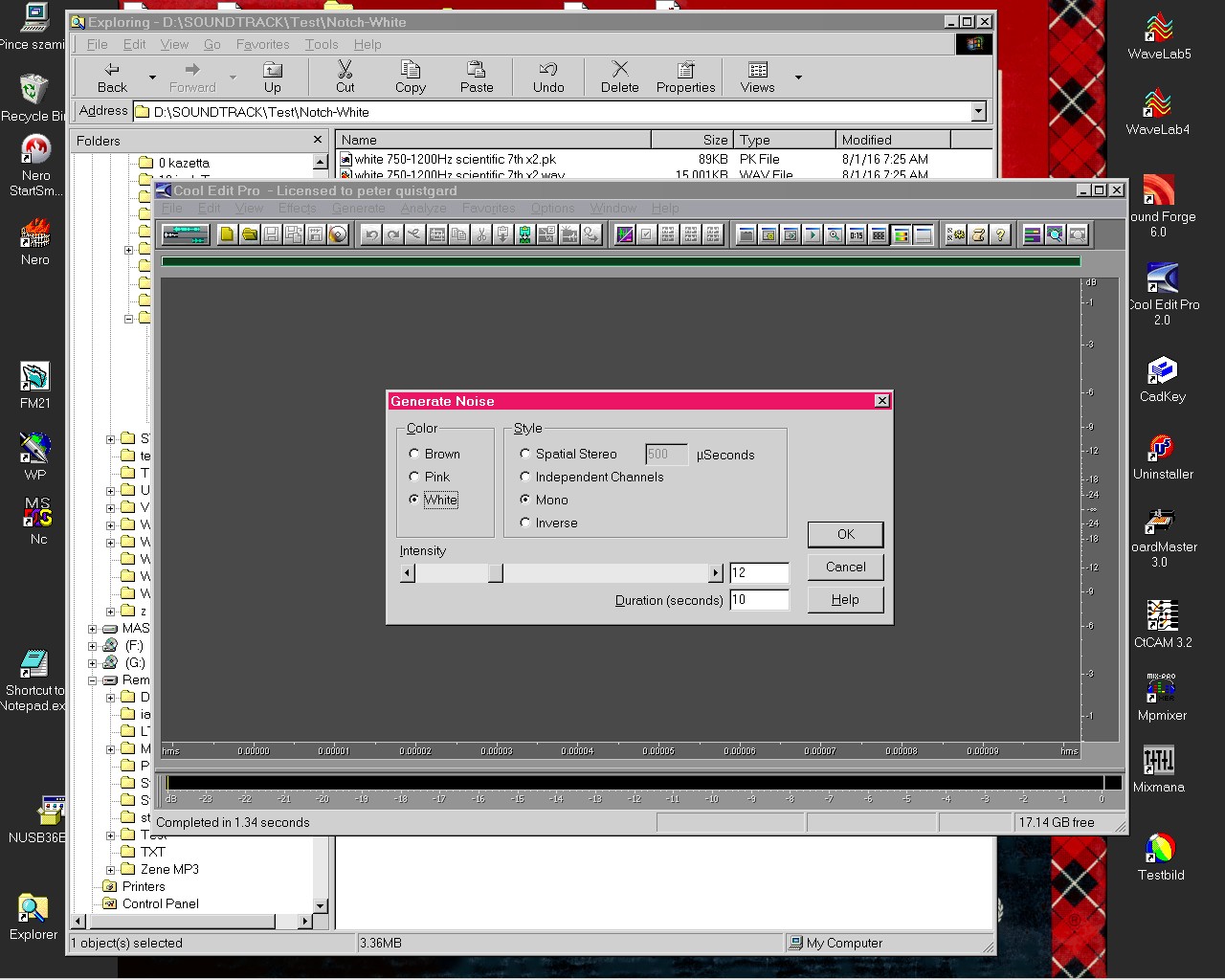

An other subject comes up to time to time, that THD is done on a static signal, what music is not. I tried multi tones with
the QA400, like 6 or 12 tones, no numerical result, just visible one. I can see ca. 10dB rise of the noise floor going from 6
to 12 tones. Probably caused by IMD and the increased jitter. Up to this point for more realistic testing ,more music like
random signal is a noise with gap quite reviling, where anything in the bottom of the gap is distortion. Here's a picture of a
test on a ca. 20-23 years old Philips CD921 (TDA-1549 DAC) with the white noise with gap signal.
