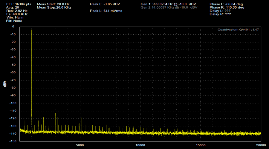

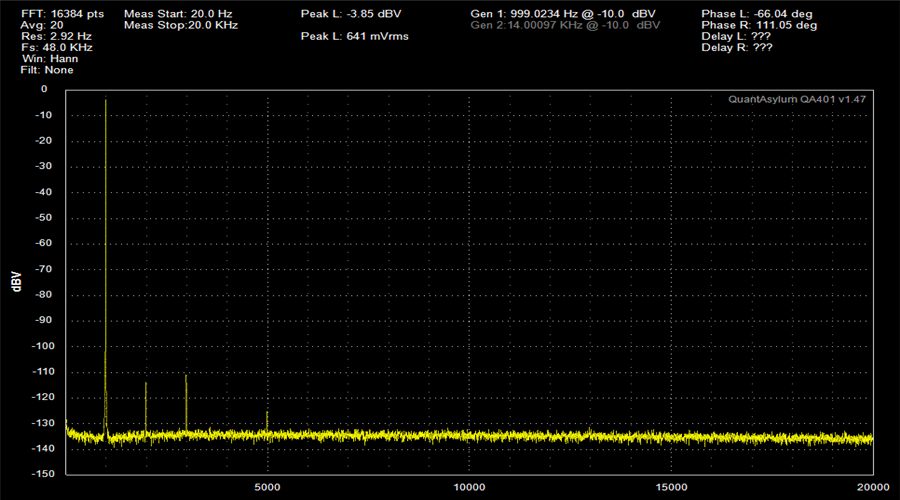

On to another topic: I've had to isolate my QA401 from laptop USB power and supply it externally (Schitt Wyrd in this case.) Some distortion making its way into the measurements if using my laptop power.

I believe the QA401 pushes the USB power spec. at a little over 500 mA. USB 2 is listed as 500 mA max. Most PC's have electronic disconnects that trigger at 1A but may trigger lower. If the supply is at the minimum spec. then odd things might happen. The best way to check would be to probe the +5V on the USB cable.

Plugging into my desktop computer yields a much better result, so it does appear my laptop computer (a fairly new Acer E-15) causes/accentuates the issue. Whether this is entirely USB power related is unclear to me.

Is this with the laptop running on its internal battery, or with the adapter (a SMPS, of course) plugged into the wall? I can imagine this could make a difference, maybe a big one. Of course the desktop also runs on a SMPS, but it might have better filtering.Thanks.
No difference, in this case with PS plugged or unplugged.
Other than using a different laptop (which I don't have 🙂) no other change in configuration.....ie, different USB cables.....makes any difference.

An interesting test sometime would be to put a powered USB hub between the laptop and the QA401. One thing that comes to mind is NwAvGuy's ODAC. Had problems for years with some USB ports requiring galvanic isolation (or a USB hub inserted) until and George B. and JDS labs tracked it down to ceramic capacitors on the USB power lines of a few laptops. The low ESR ceramics caused a voltage regulator in the ODAC to oscillate. They changed voltage regulators and the problem went away. Apparently they had to dissect a laptop causing the problem to find out what USB parts had been used.
Using a "powered USB hub" is essentially what I did by using the Schitt Wyrd. An external box like that off-loads all the power requirement from the laptop.
I suppose the ODAC anecdote you mentioned might be a similar issue, but I'm certainly not going to dissect my laptop for an equivalent troubleshooting routine. 🙂 The workaround I have is perfectly acceptable in my case.

I run a USB Isolator/Power Injector pcb (battery power source) between laptop and DAC.
The result is cleaner audio, and ought to be ideal for T&M.

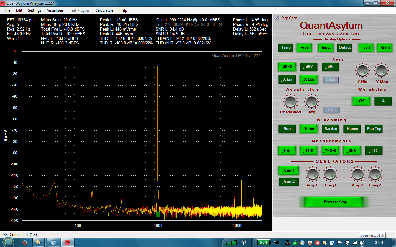

MarkS,
can you explain the two spikes @ 340Hz and @ 11kHz?
I have no idea, perhaps someone wiser will venture a suggestion...

350 (and 150) could be mains harmonics from the supply.

I would observe that in the course of resolving this digital signature problem I've installed the QA400 software and hardware on a total of five computers, a desktop and two laptops running Win7 x64, a laptop running WinXP x32 and a iMac running WinXP x32 under VMWare.
The one thing they have in common is that they all show different shrapnel at the bottom of the screen for the same loop test with the supplied leads 😀

Except that the spike is not at 350Hz, it is just under 340Hz.350 (and 150) could be mains harmonics from the supply.
