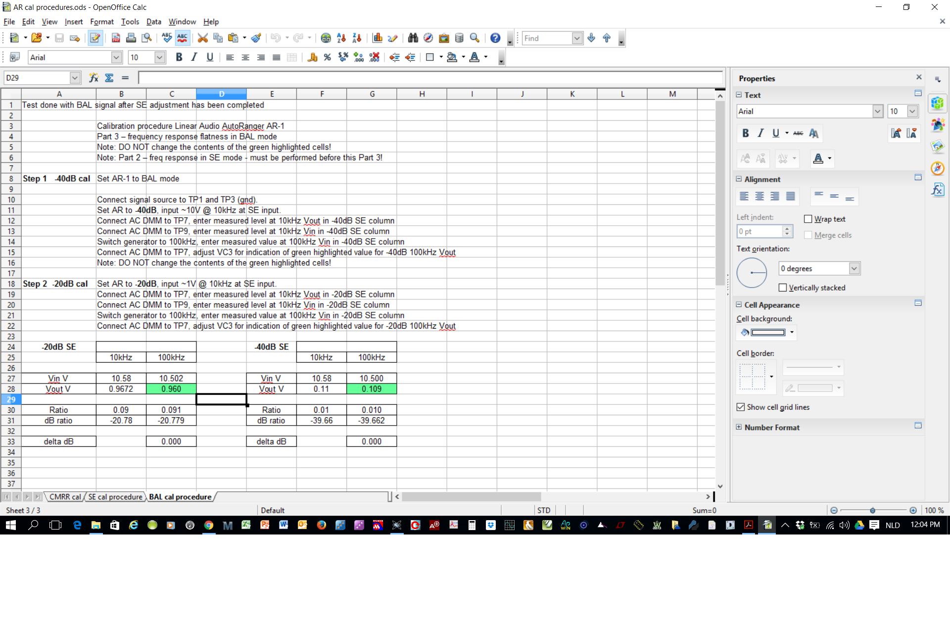

Another milestone in the development of the autoranger!
Finalised and tested the cal procedure.
Especially calibrating the freq response for 0.1dB flatness out to 100kHz is a challenge if you don't have a fully equipped lab 😱
I now have a procedure that needs only an AC DMM with reasonable performance and a signal generator that can output 10kHz and 100kHz, preferably up to 10V or more but that's not critical.
The procedure directs you to do some measurements and enter values in a small spreadsheet and the spreadsheet then tells you what to adjust (cap trimmer) for which DMM indication.
For -20dB and -40dB settting, in both SE and BAL mode.
It's done faster than described!
