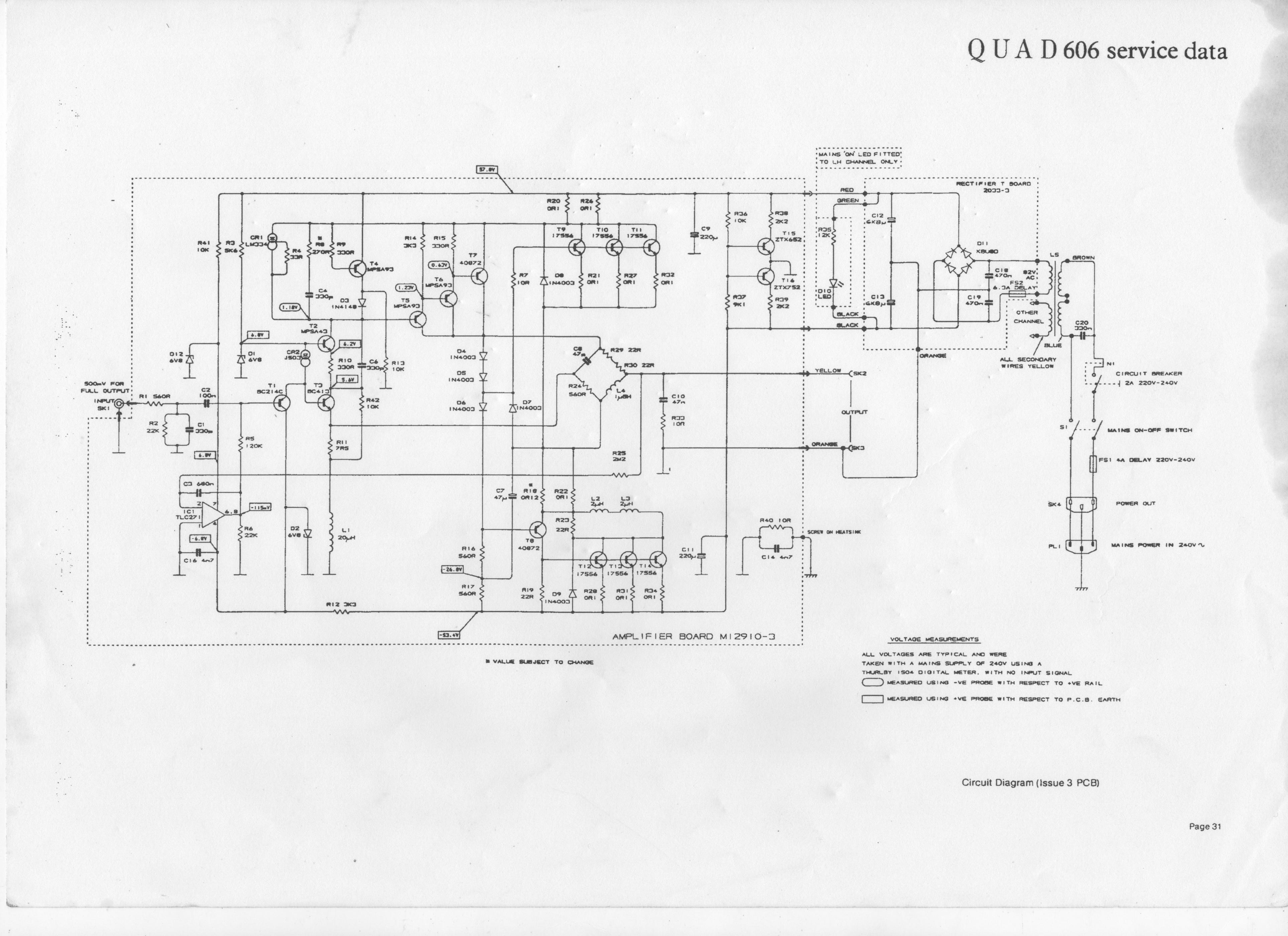

QUAD 909 Clone
My copy of the circuit doesn't have these discrepancies.
Hi Mooly, yes the Quads use enequal rails which is achieved by the vitual ground in the driver stages.
The output stage just uses a virtual ground between two series caps.
The 606 and 909 are virtually identical.

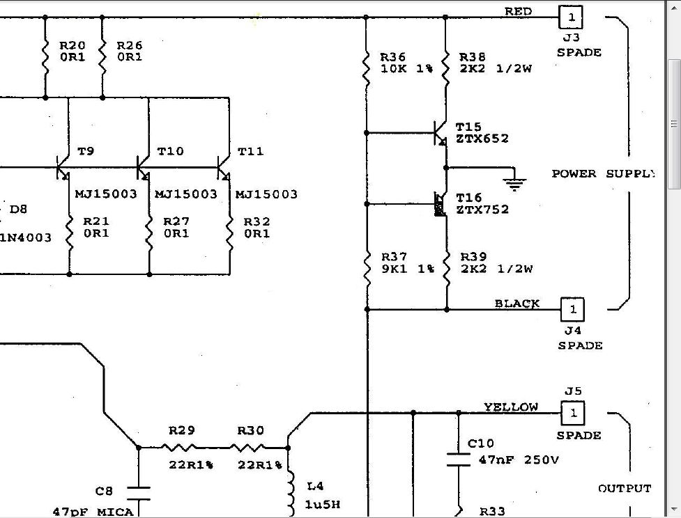

I would expect all the common "grounds" to be connected in such a way that the main smoothing cap zero volts is common to the active virtual ground.
But maybe not.

It's an odd arrangement, 0V seems to float around a bit. 82V vs 80V seems to be the only difference between the 606, 707 and 909, the rail voltages are slightly different.
To me it just seems odd that 0V is controlled by two such small transistors.
I can understand that is how it seems but the 0v line isn't controlled in that sense. It is a fixed point in the circuit that has been designated 0v and to which all other points are referred. This 0v line has no ability to have current sourced or sunk into it beyond a few milliamps... but it doesn't need to.
