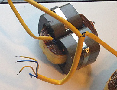

Here's a picture of an ESL63 transformer that I found on the Internet.
It's hard to see, but it looks almost as if the core is monolithic with small chips broken from the upper left edge.
So when someone is in the position to take a look, it would be very helpful to confirm whether it is steel or ceramics.

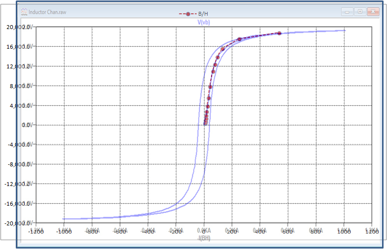

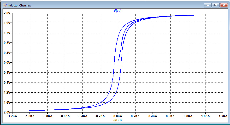

The very best I can get with acceptable silicon steel transformer core values is 3.7% distortion over the speaker terminals with 1R in series and 6Volt rms @ 10Hz applied, giving 15.3% distortion on the secondary.
This is with HC=39, Bs=2.0, Br=1.0, A=1.3m, Lp=0.16 and N=49.
See image. Vertical B axis in Tesla, Hor axis H in A/m.
With 6 Volt pk instead of rms, I get resp 1.4% at the speaker terminals and 5.6% secondary.
So what did the Danish testers apply, a 6Volt pk or a 6Volt rms ?
@ESL 63, maybe you could check the original Danish text in the article if the mention anything about rms or peak ?
Hans

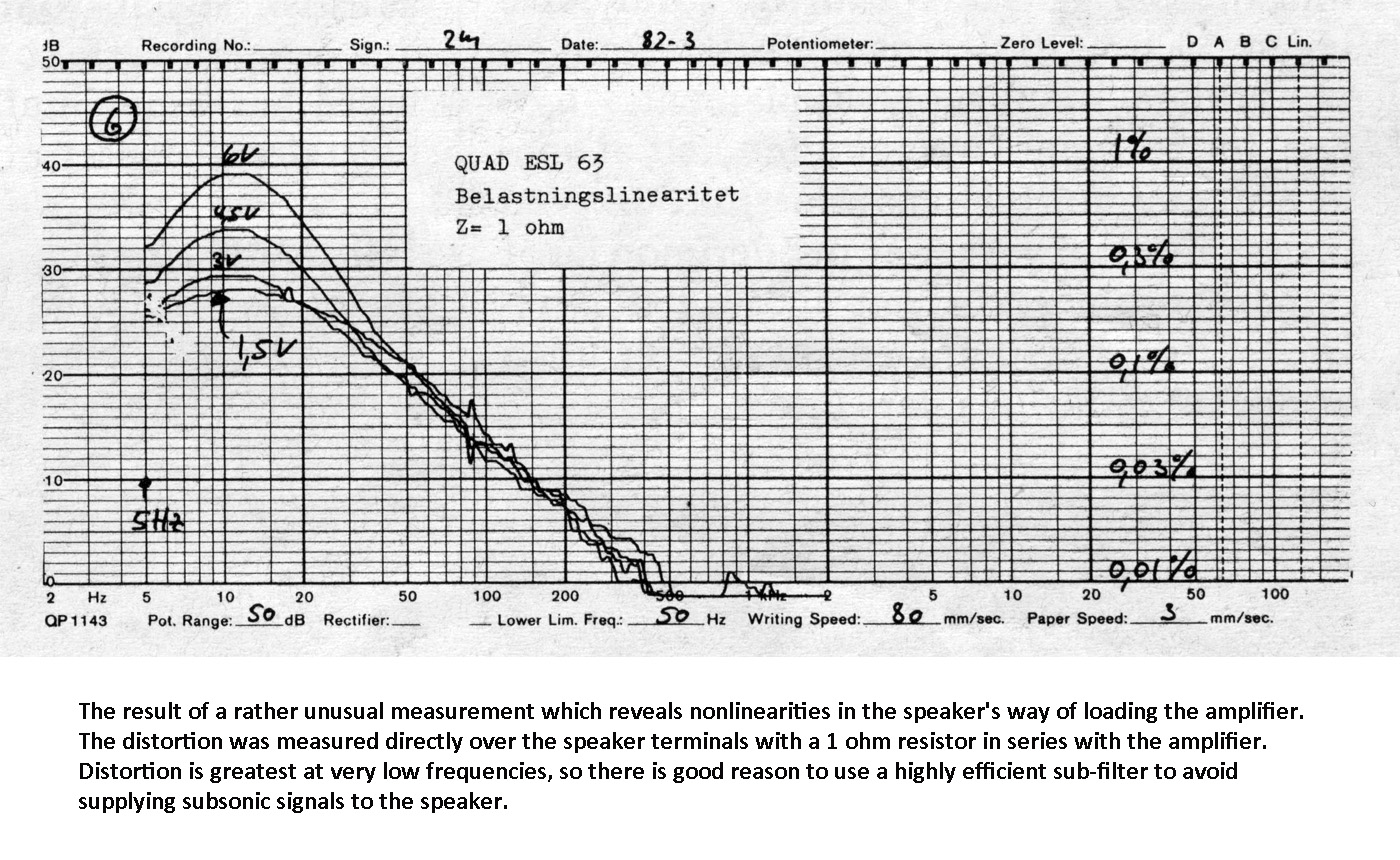

Hi Hans,
I had a quick look at the text. Nothing conclusive other than it states that the measurement was made using a generator and voltages 1 to 3 Volt in series with 600 ohm. I would assume that means rms.
Mogens

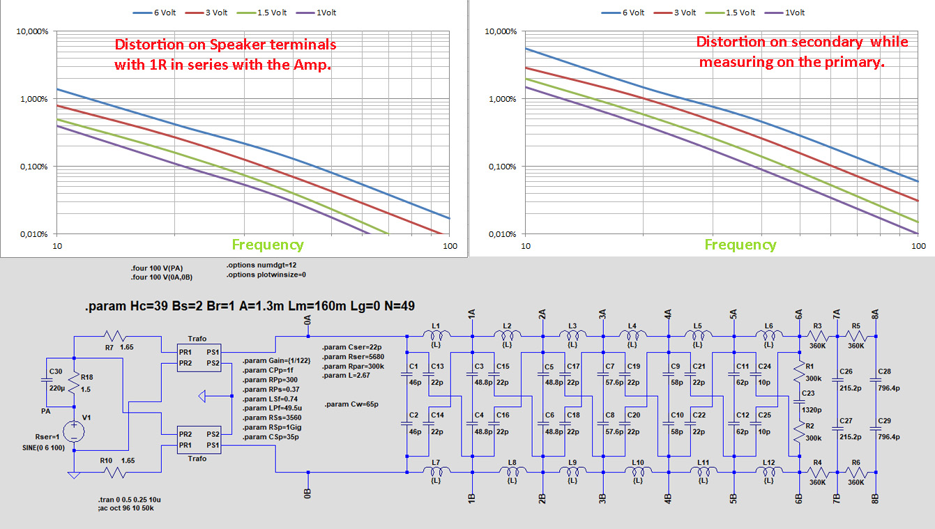

This is what I got with 1R in series with the Amp while measuring on the Speaker terminals.
Voltages as shown are peak voltages of resp 1, 1.5, 3 and 6 Volt pk.
The 6 Volt line is spot on with the 6 Volt Danish test that Mogens provided.
While measuring on the Speaker terminals, I also measured the distortion on the secondary side of the transformers, see upper right part of the image. This distortion appears to be some 10 to 12dB higher as on the speaker terminals.
The schematic diagram that was used for testing is already updated with the capacities that Demian has measured.
Hans

I can also read danish... In the diagram shoving distortion, they state 3 Vrms. Page 5.
"Frequency response 2m distance in lab (i guess anechoing chamber) without gating. The distortion curves is attenuated 50dB. Soundpressure (@2meter) was 87dB, 3Vrms on speaker terminals. and they state that distortion is remarkable low."
As we all know and love.
Page 6.
Intermod. Forvaengning= Intermodulation distortion
"30 on the top curve, 50 Hz on lower curve together with a sweep.The high distortion comes from dopplerdistortion from unlinearity in step up transformers"
This tells us that 30Hz is giving approx 15dB higher distortion than 50 Hz.

Thank you for reading.I can also read danish... In the diagram shoving distortion, they state 3 Vrms. Page 5.
But you refer to picture 4 or 5, while I was talking about picture 6.
See below.
Hans
...This is with HC=39, Bs=2.0, Br=1.0, A=1.3m, Lp=0.16 and N=49. See image. Vertical B axis in Tesla, Hor axis H in A/m.

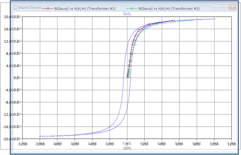

I took the tabulated V & I data from my 20Hz measurements and calculated resulting B-H data points.
Overlaying your simulation on top of my measured data...matches much better than I expected.
It is odd that several of the figures specifically call out Vrms, but the distortion plot you are trying to match just says V.
I would still think it is a Vrms value, but could be wrong.

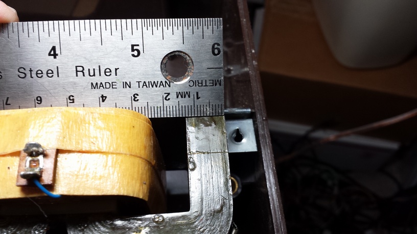

Attached is a pic I took to show core dimensions, which also clearly shows the steel laminations....when someone is in the position to take a look, it would be very helpful to confirm whether it is steel or ceramics.
Steve,
It's almost hard to believe that we are so close with our BH curves.
In your image the vertical axis goes from -20 to +20, while mine goes from -2.0 Tesla to +2.0 Tesla.
Your +20 probably also mean Bs = 2 Tesla, because I don't think that silicon steel exists with a Bs that is higher than 2.0, do you agree ?

My B calculations were in units of Gauss (1T = 10000 Gauss).Steve,

Appologies for the mixed units...and not including them in the plot.(I added them to the legend)
During lunch I plotted up measurements from the other transformer.
The curve is stretched a bit to the side which is usually indicative of a small airgap.
There is more a bit weird with this image than just V.
Below 10Hz distortion is going down while there is no reason for that, so I assume their amp has a rumble filter of some sort starting at 20 Hz.
In that case the distortion at 10hz without rumble filter will be higher as shown, so at the end their voltages could be rms voltages.
The other thing that I don’t get is that the first part of the 6 Volt curve from 10 Hz up to 50 Hz goes down with 12dB/oct which is to be expected with a second order LC system.
But then from 50 Hz and upwards in frequency, all distortion curves are coming together and continue to go down with 6dB/oct.
What could be the cause of that, in my sims all distortion curves have a permanent slope of 12dB/oct. Could it be that this is the distortion from the amp itself ?

It certainly could be the case that distortion from the amp is contaminating the measurement.Could it be that this was the distortion from the amp itself ?
For an example of this, see distortion curves I posted for my ESL transformer at 20Vrms.
You can see that the majority of the distortion is coming from the amplifier.
See Attachment #3 (red curve is distortion at amplifier output, yellow curve is distortion at transformer secondary)

Pict 6 is most likely RMS. Based upon that the other measurements is that. and that thats the standard way to do it.
