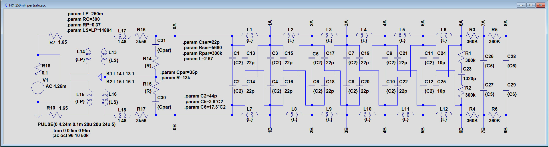

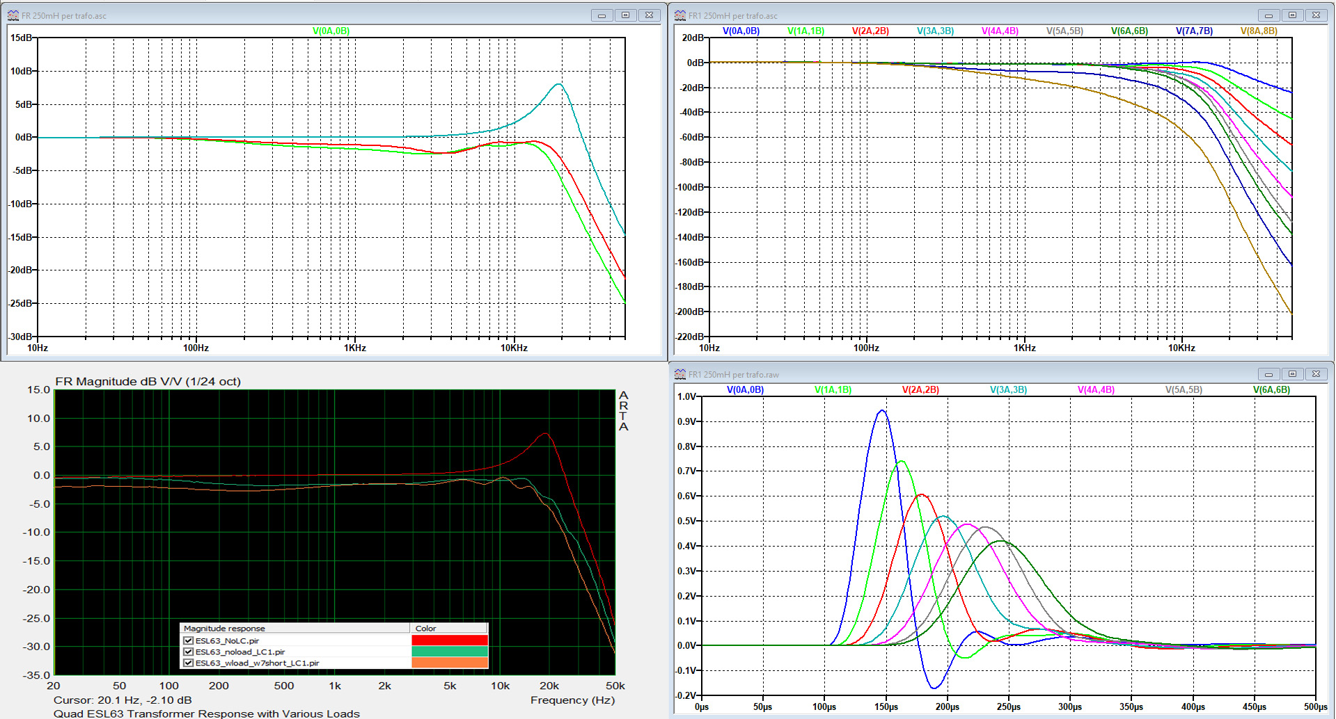

Steve,

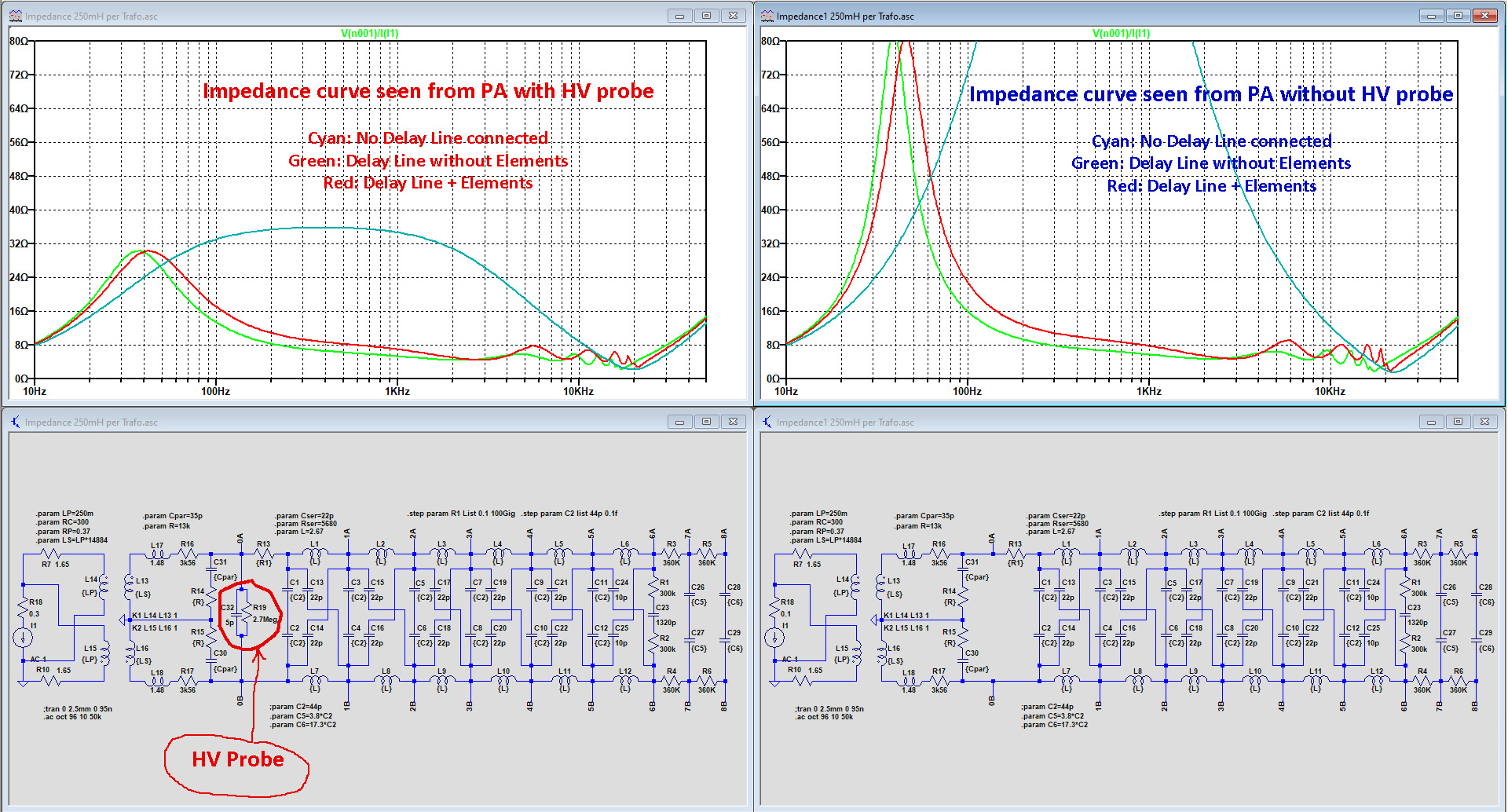

I would stil like to get some of your support in knowing how you defined your transformer data.

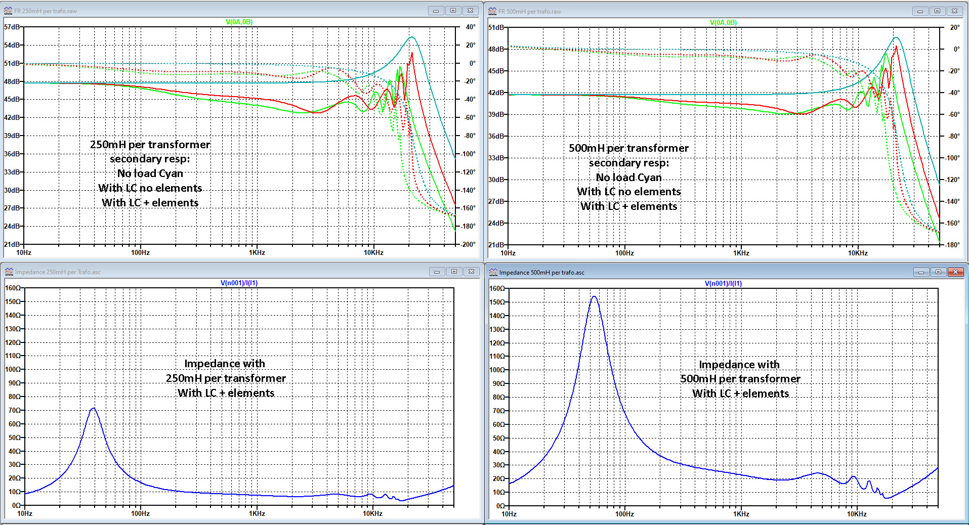

Was the data provided for just one transformer, so the Main Amp sees 2x par. 250mH=125mH with a total gain of 244, or did you measure both as being one big transformer making the main amp see 250mH with a total gain of 122.
In the image below, I have shown for both possibilities the FR and the Impedance.
However I had to increase the secondary 3K65 resistor to 65K for FR and Impedance versions to get the same unloaded FR with 7.5dB peak around 20 Khz as you showed, and also the impedance needed this higher value to keep it from getting too low around 20Khz.
You also see a rapid rise in impedance above 20Khz that is steeper than the real ESL63 is showing, that could mean that the 1.48H leakage may be a bit too large ??
But even with the unloaded FR curve being the same as in your picture, I still see rather large differences with the loaded FR.
Do you still have some additional ideas ?
Hans

In the above image, the red line is with complete load and the green line with LC line but without elements
Could it be that the smoothing that Arta applies to your curves, let them look less zig zag ?
Hans
Instead of increasing the secondary 3K65 to 65K, I can also place a series resistor of 60k in the 35pF secondary cap and leave the 3K65 intact.
This gives better results in the FR and in the Impedance curve.
Will show te results tomorrow,
Hans

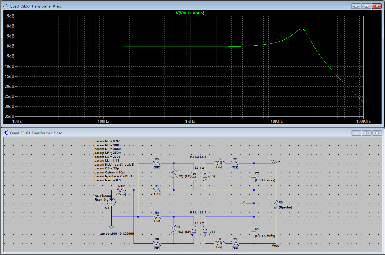

…Do the values for the audio transformer that you supplied refer to one single transformer, or did you measure the set of two as one big transformer.
Sorry for the confusion. The parameters are for a single transformer. You can modify the primary inductance of each transformer as long as you modify the secondary inductance at the same time such that: LS = LP x N^2, where N=step up ratio = 122. Depending on the signal level, it could have a range of values, I just chose a nominal value when documenting the parameters. It will really only affect the LF response, so probably not of much importance for your effort. Attachment #1 is screen grab of a spice model I made back in 2016 when I was checking the measurements. It looks to match pretty well. One thing I notice is that I added in a source resistance of 0.3 ohm, which sounds like a reasonable value for all the connections and wiring between amplifier and my test setup. Looks like I also added in about 10pF of stray capacitance to account for other capacitive loads seen by HV windings not related to the winding capacitance(see response to next question below). Usually winding capacitance is so much larger than stray capacitance that it can be ignored, but the ESL63 transformer is a unique design where such details can become important.
Interestingly(at least to me) if stray capacitance can be ignored, the frequency of the HF resonance is at the same frequency for two transformers (wired up per ESL63) as for one. The reason being that the both LL and CS are in series. So the net leakage inductance doubles but net winding capacitance halves, so the product is still the same...thus same resonance frequency.
… The 35pF secondary cap that you specify is a bit of a mystery to me.
Should this not be the capacity between the primary and the seconday winding ?
This is the self capacitance of the secondary winding which is made up of many layers. Basically each pair of winding layers acts like the plates of a parallel capacitor. With many layers, you have a group of capacitors in series. The net effect is a capacitive load on the secondary that resonates with the leakage inductance. Attachment #2 provides some details on winding capacitance. You can download the full book from here: http://www.tubebooks.org/Books/RDH4.pdf
The capacitance between primary to secondary winding is very small with the ESL63 transformer because the end of the secondary closest to the primary is grounded.

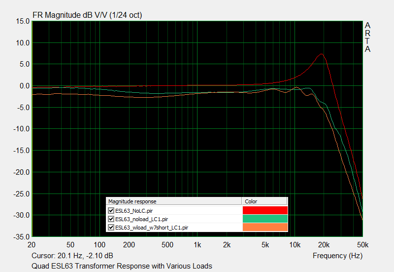

…even with the unloaded FR curve being the same as in your picture, I still see rather large differences with the loaded FR. Do you still have some additional ideas ?
As I mentioned previously, I haven’t done any modeling work on the LC transmission line. My work was geared toward understanding the transformer design. Based on review of the Baxandall treatise, I would guess that the differences you are seeing will likely come down to proper modeling of the shorted winding coupled to each of the inductors. This is mentioned to dampen and gently roll off the top end. See also text related to Figure 3. in Attachment #3. Really makes one appreciate Walker’s accomplishment from 40 years ago!

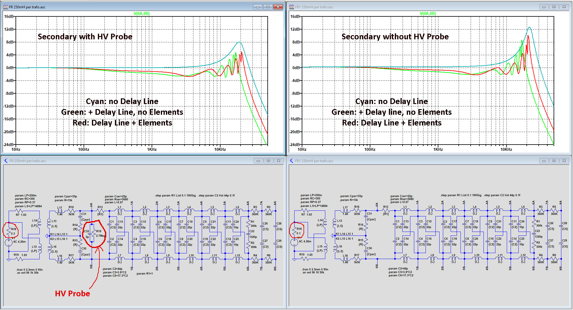

Steve,
Thanks for all your info's and the confirmation that your data concerned just one Audio transformer.
I could replicate your LTSpice sim, but also looked at your original measurement, showing a peak around 19kHz of +7.5dB with your HV probe connected.
To get the same +7.5dB I had to add a small serial resistance of 13K to the secondary 35pF Cap.
To show what a huge difference this 2.7Meg//5pF probe causes, I have made sims with and without this probe.
But I'm still faced with a large zig zag ripple when connecting the delay line.
So I will have to play around with the Delay Line Inductor.
When I had one to measure, It would be of great help.

I think I'm done, thanks to all the excellent info's I got from Steve.
Getting the Zig Zag FR at HF under control was achieved by giving the Delay Line Inductor a Rpar=300K.
In the image below at the left side my sim including the HV prove that Steve also used in the image below from a real measurement.
These two images are as close as I can get.
At the right side the FR and the Impuls response for my LTSpice model but now without HV probe. FR looks very good and the step response nicely shows the delay per segment.
The second attachment shows the LTSpice model, and the third attachment the .asc file.
Hans

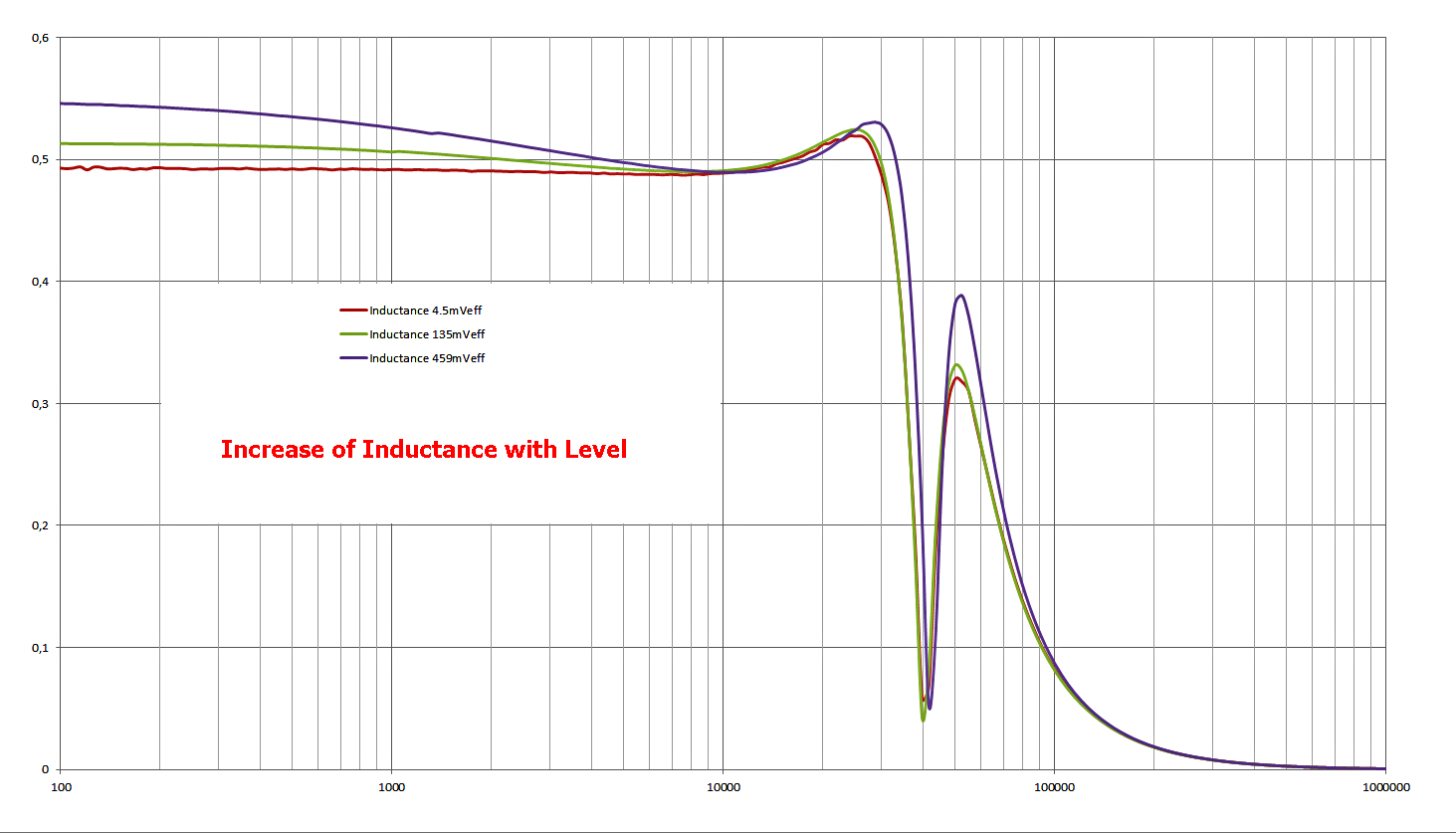

…In your posting #19, the first attachment, You have shown the inductance of the secondary open transformer for a certain frequency while increasing the input voltage. Why isn't the inductance flat up to the point where saturation starts ?
The inductance increases with applied voltage because the permeability of the core increases with flux density which is proportional to the applied voltage. Most core materials that can handle high flux density before saturation have a much lower permeability at low flux density(often a 10 to 1 ratio or more). Attached are another couple pages from the transformer chapter of the book download linked to in post #28. In the table u0 = initial permeability = permeability for low flux density(ie small input voltage).

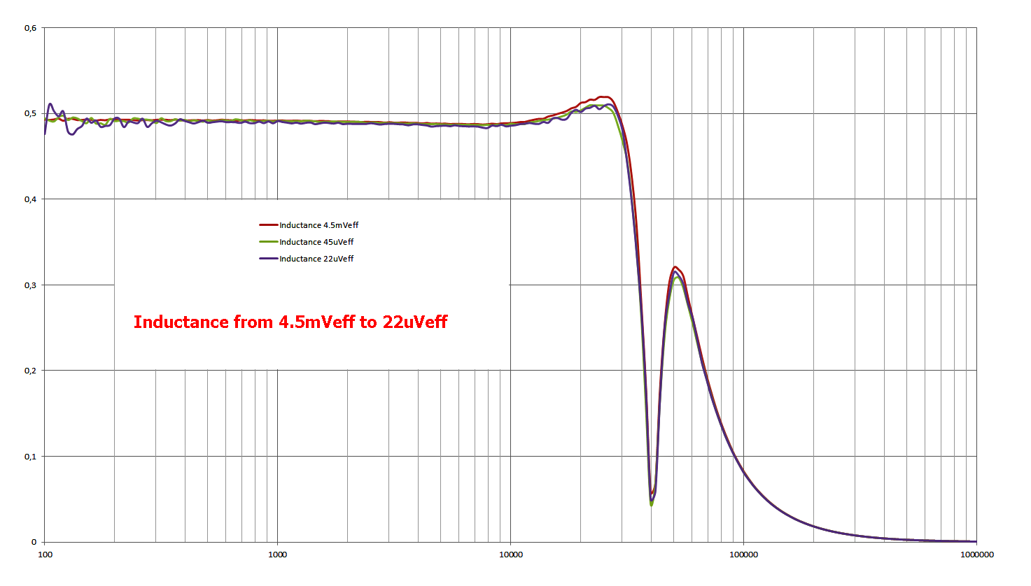

Interesting to look somewhat deeper into this transformer area, thanks again for your info's.
Since I'm not a Tube man, but I suppose you are, I never paid them any attention before and I'm surprised in the huge differences between u0 and umax.
It's a perfect explanation why the impedance at frequencies is so much dependent on level.
I measured quite a lot of MM Cart's over a very large spread of levels and never noticed but a minimal change in inductance.
The explanation can only be that B/H was still around u0 all the time, that's the reason why I was a bit surprised by your graphs.
See level versus inductance in the two images below for a Ortofon super 10 MM Cart, from 22uV up to 459mV, a factor 20.000 in level change !
Hans

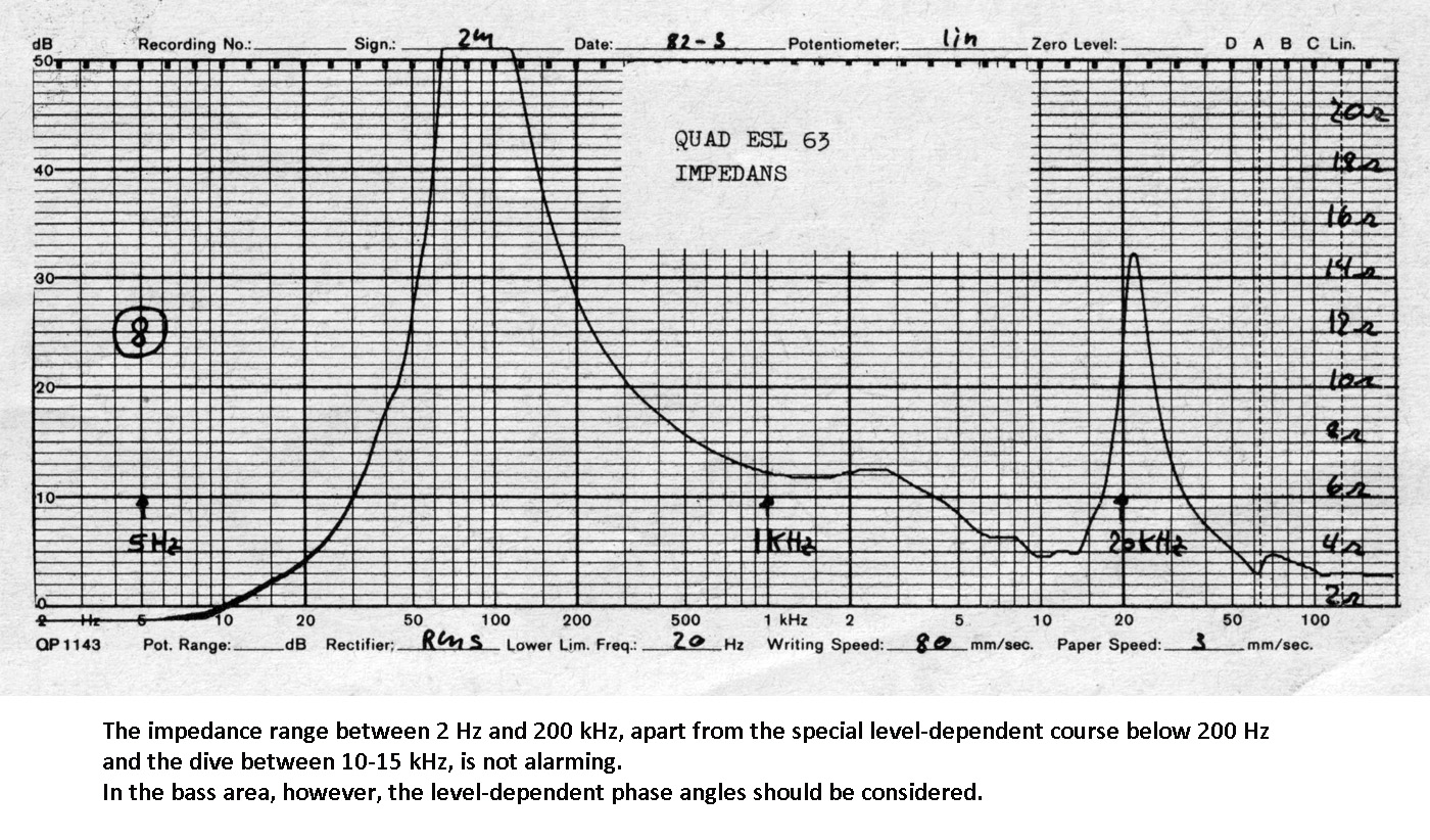

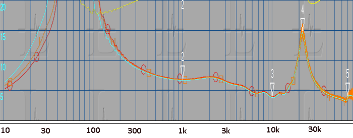

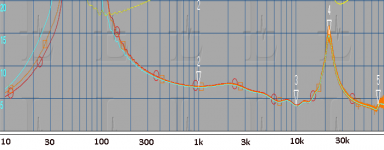

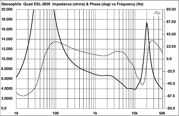

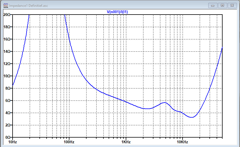

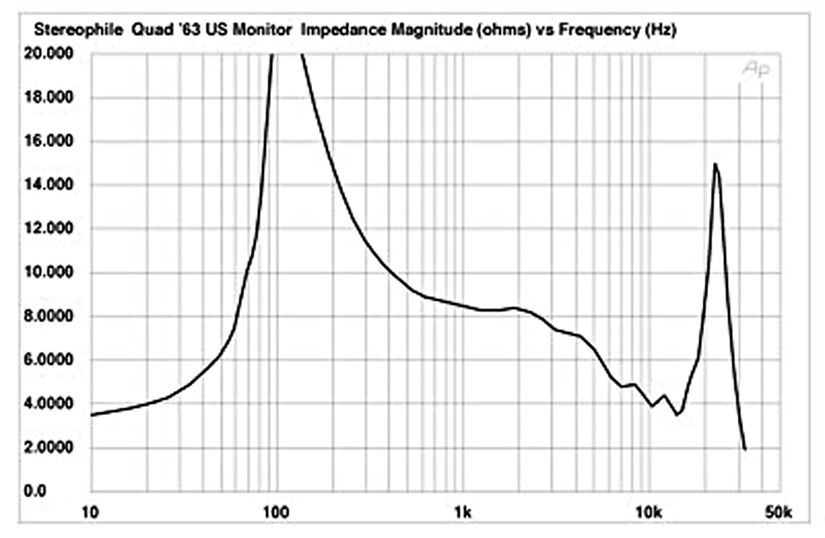

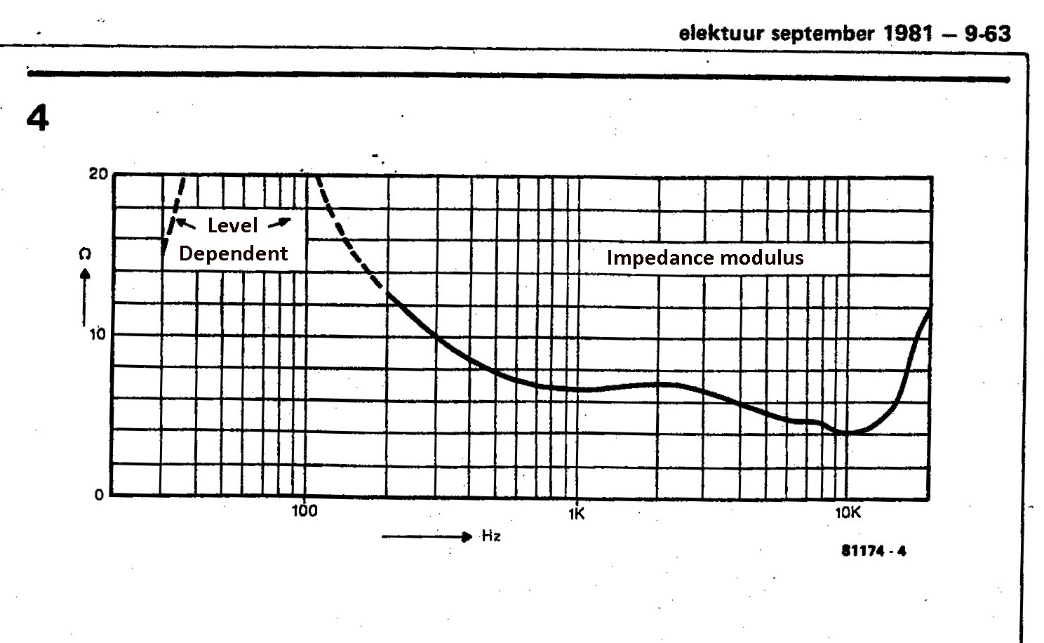

@Steve & Sheldon,
After having managed to get a satisfactory LTSpice model for FR and impulse response, one thing still puzzles me and that's the impedance.
Below a series of various impedance curves, images are normalised from 0 to 20 Ohm and from 10hz to 50Khz, but all being quite different:
1) First image below shows the oldest measurement that I know of from the magazine Elektor in 1981, unfortunately this graph stops at 20Khz, making it not 100% clear whether this becomes a peak or not.
2) Second image shows the impedance curve of the current LTSpice model.
This one definitely has no peak at 20Khz, but it resembles the Elektor image to some degree.
3) Third image is from the ESL 63 measured by Stereophile
4) Fourth Image is taken from the 2805 measured by Stereophile
5) And fifth image is recently measured by 1Audio from an ESL63.
What can be seen is that:
A) all measurements are peaking at ca 20Khz, but not the LTSpice model.
B) the LF peak various quite a bit between all images in frequency and Q.
Most have their peak between 50 and 70Hz, but the ESL63 measurement from Stereophile has a much smaler peak at 110Hz.
C) Only 1Audio's mesurements extend beyond 50Khz, where impedance is around 4 Ohm and still going down, where the impedance of the Sim model is already 14 Ohm@50Khz and ramping up because of the leakage inductance of the transformer.
So what can we learn from this, is it the Audio transformer that has a very large spread, or are different transformers used from time to time ?
And why do the all measurements have this impedance peak at 20Khz, except for the LTSpice model that doesn't have this peak ?
I think the Audio transformer and/or the delay line inductor are still keeping a few secrets. Would be nice if we could do some more measurements on these parts.
Hans

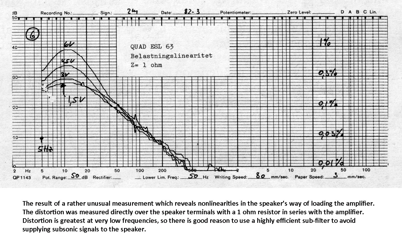

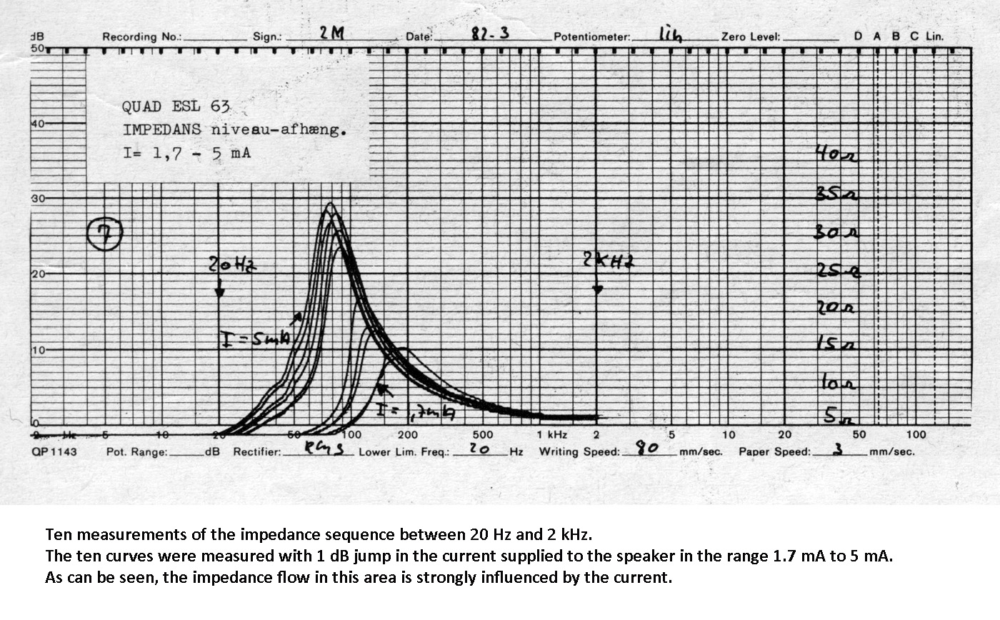

Hi Mogens,
thanks a lot for sending this article.
You are right, Danish is a very difficult language for me to understand, almost Chinese. 😀
I have tried to translate the text belonging to the three most interesting pictures, attached below.
Especially interesting is the Impedance curve for very low currents, haven't seen this before.
But here again is the 15 Ohm peak slightly above 20 Khz in the second image.
Also very interesting is to see the impedance curve from 30 KHz to 200 kHz, again lifting a part of the veil, most likely indicating that the leakage inductance has a Cpar of 35pF in combination with a Rser.
The Audio transformer is a hard nut to crack if you don't have the real thing lie in front of you.
Hans
