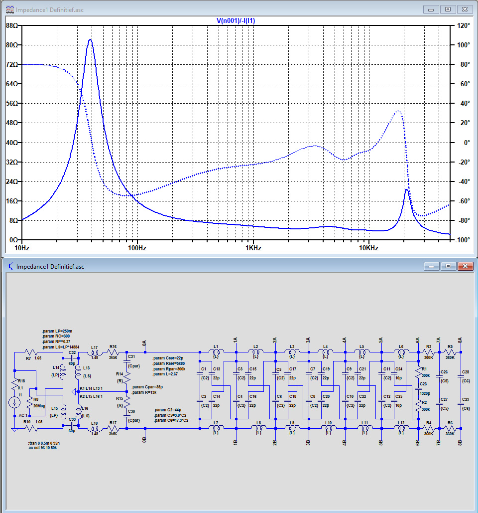

And why do the all measurements have this impedance peak at 20Khz, except for the LTSpice model that doesn't have this peak ?
The HF peak at or above 20kHz is usually caused by the winding to core or winding to winding capacitance resonating with the leakage inductance. Adding something on the order 20pF-40pF between primary and secondary windings you should see the peak appear in the impedance plot. Note that this will make little difference in the response of ESL since it is loading before the leakage inductance. In reality the capacitance is distributed along the winding height, but lumping it in one spot can provide reasonable simplification for modeling.
Steve,
You made my day.
By inserting two 60pF caps between Pr-Sec, two things where achieved:
1) there's now the impedance peak slightly above 20Khz, but without causing any effect of the FR
2) The impedance is no longer steeply going up above 20Khz as it did before, but now stays nice flat way beyond 50Khz.
We're getting closer and closer to the real thing.

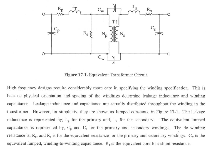

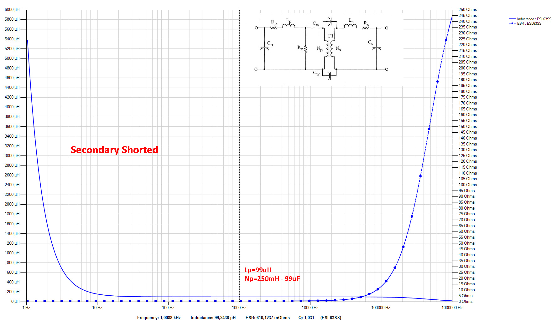

Hi Hans
A good way of measuring the key transformer parameters is to short the primary winding and measure the secondary impedance vs frequency.
The measured response will look like a high-Q second-order low-pass filter response. From that, its quite easy to determine the leakage inductance, winding capacitance and the series resistance seen by the speaker panel.

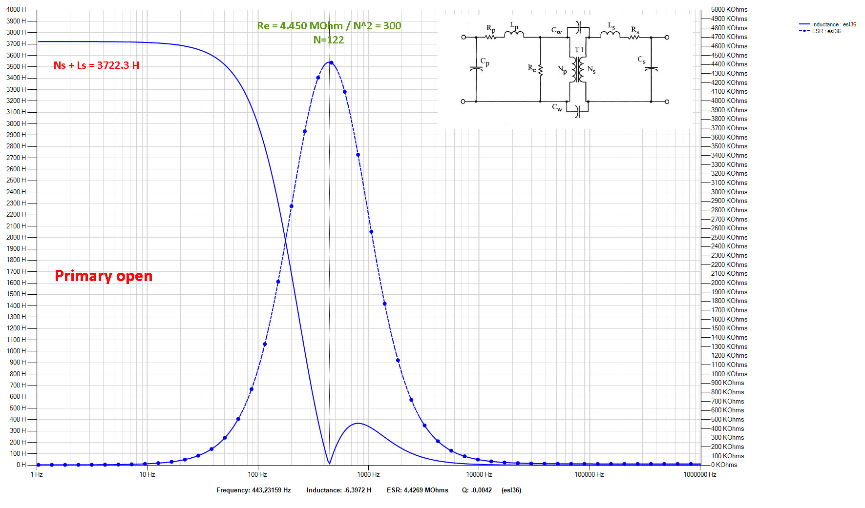

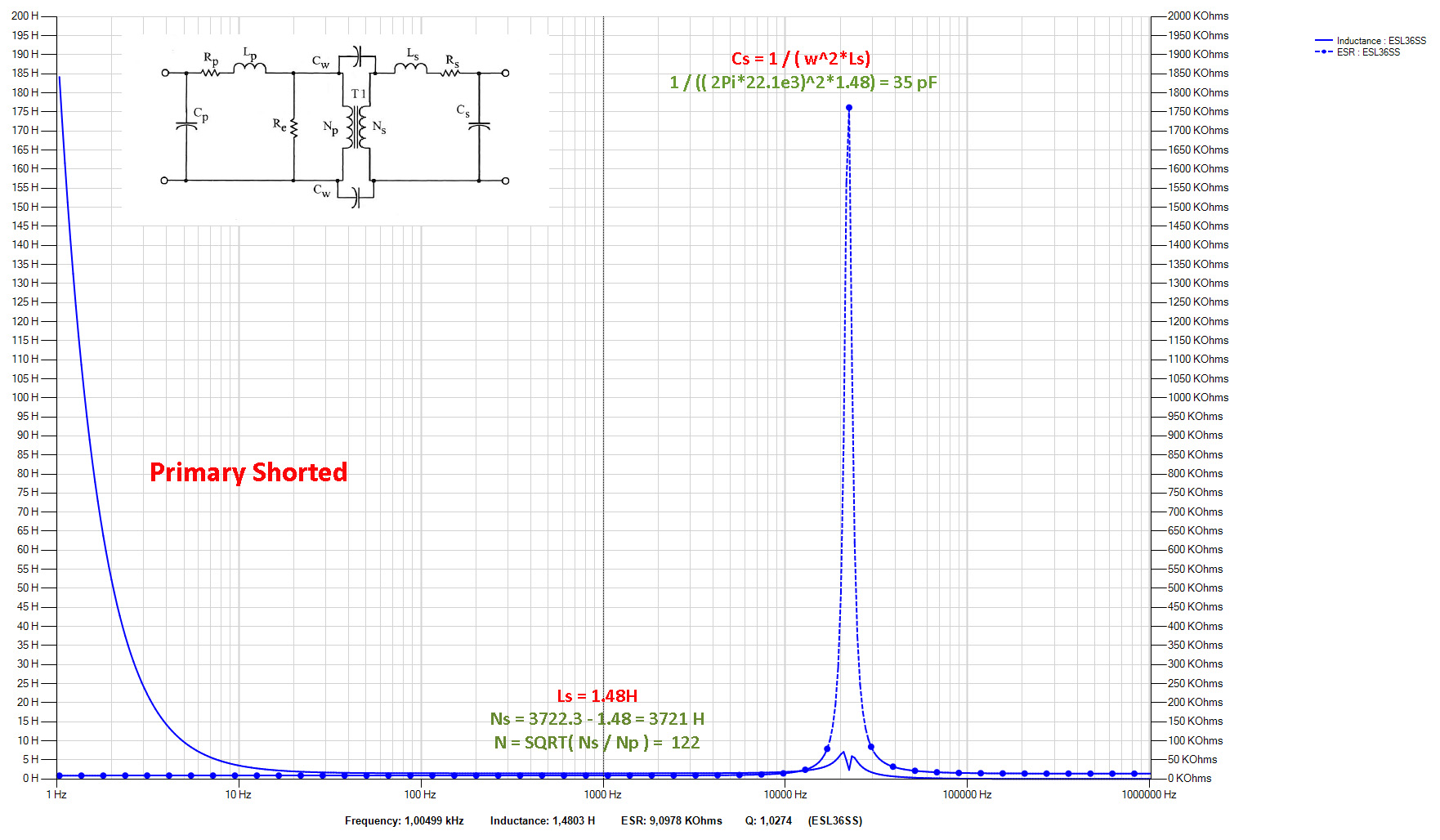

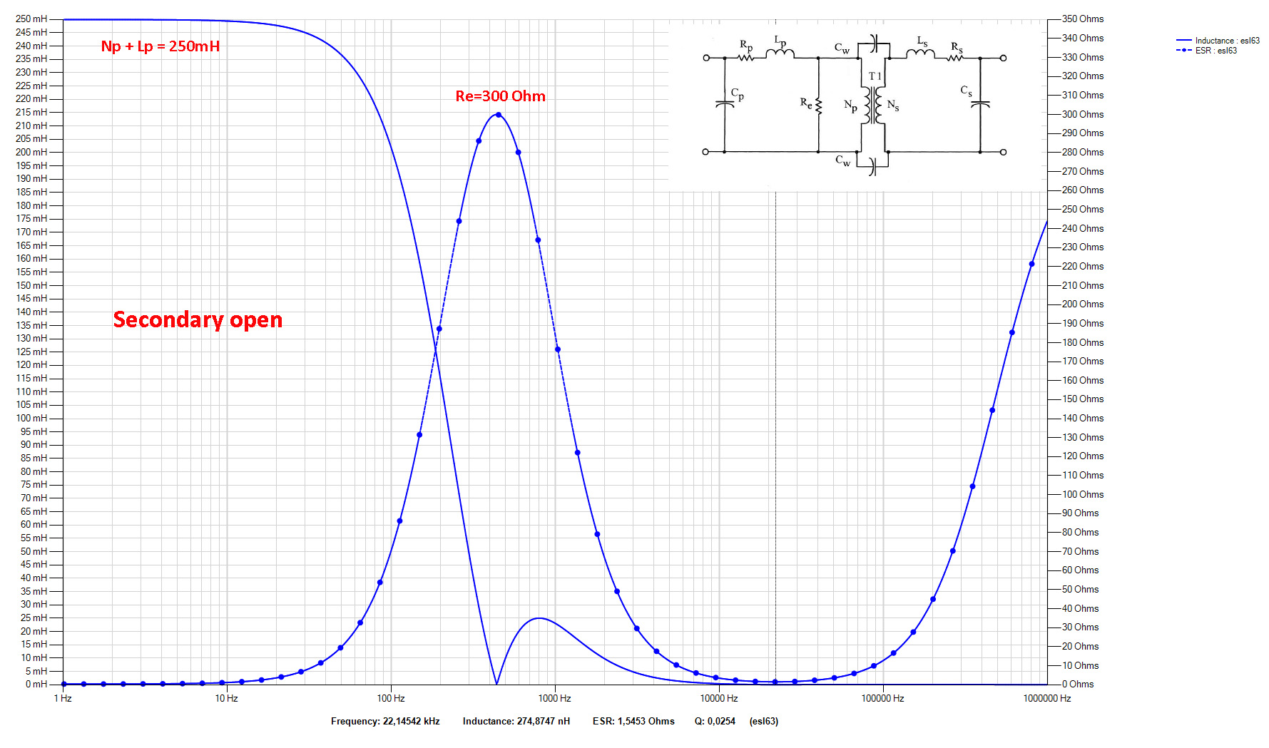

Because of being Corona restricted in my movements, I decided to make a set of virtual VNA measurements, using the ESL63 transformer as used in the current LTSpice model.
I made 4 graphs as follows:
1) measured from the primary with the secondary open, resp. 2) with the secondary shorted, 3) measured from the secondary with the primary open, resp. 4) with the primary shorted.
Rp=0R37 and Rs=3K56 are easily to measured at DC with a multimeter.
The other parameters are found from the measurement with the exception of Cw.
This cap however, that is responsible for the impedance peak at 21kHz, has no influence on the FR, so is no real problem.
The set of measurements are in this case assuming a stable permeability, which as we know is not at all the case.
So several of these measurements will have to be taken at various levels.
With this information I would like to try to implement the real B/H curve with the Chan model, making the model even more realistic.
Hans

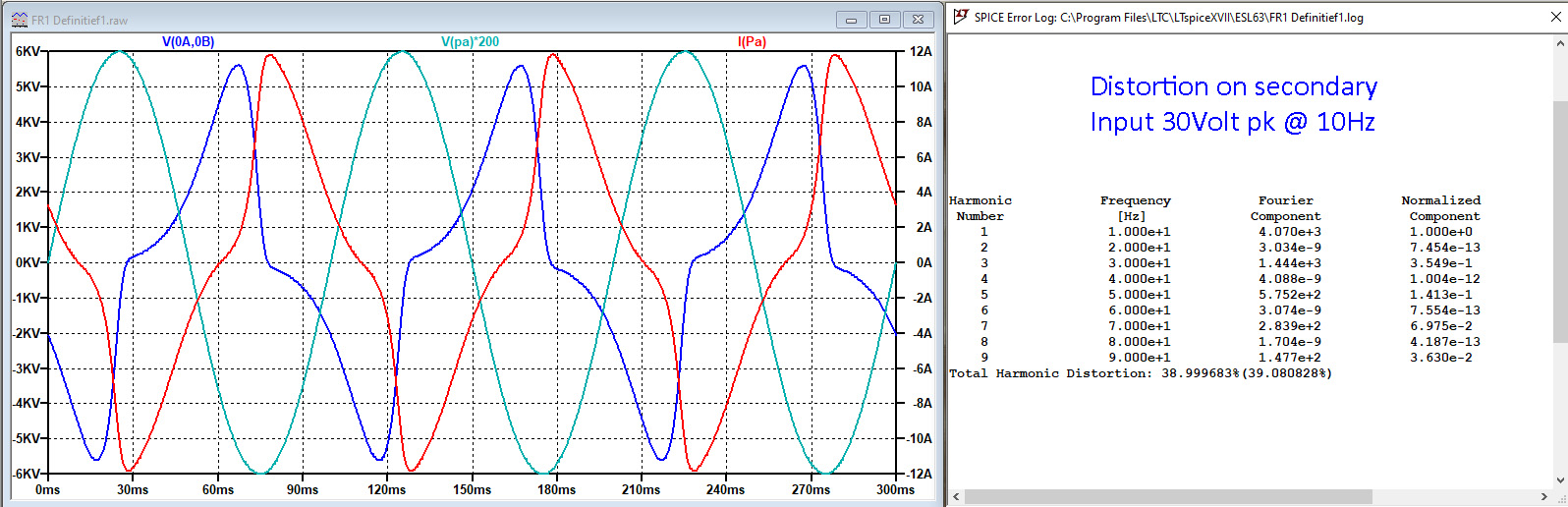

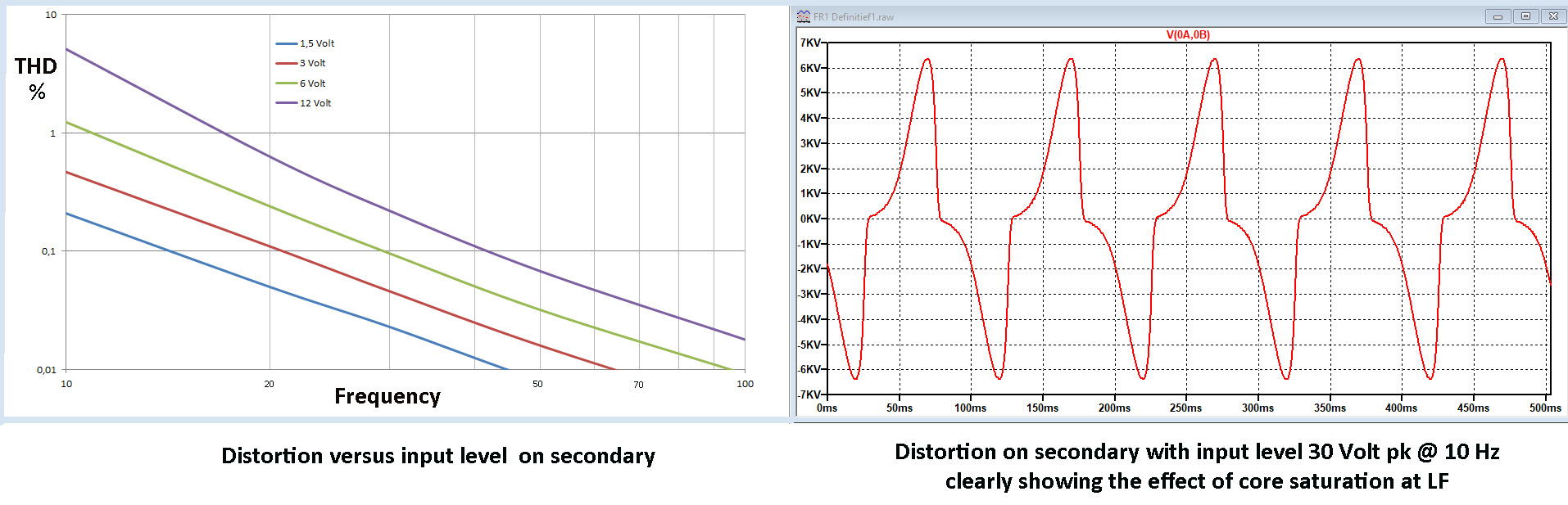

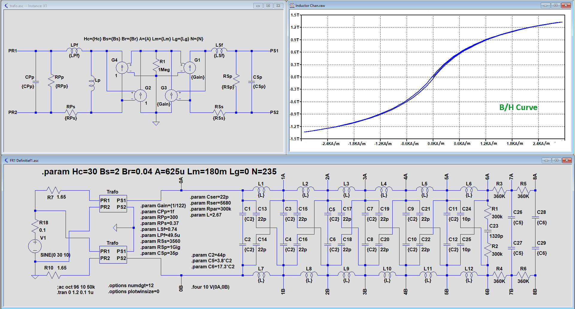

In preparation of the expected measurement results to be taken from the ESL63 audio transformer, I already developed a universal working model for this transformer that has all the parameters of the real one, like saturation, coercivity and remanence.
In the images below I just used a number of assumptions to be refined at a later stage, like length of the magnetic path of 2pi*3cm, no air gap, a cross section of 2.5cm^2 and common used value for Hc and Bs for the (silicon steel ?) core material.
With just 2 remaining variables, Br and the number of turns N on the primary, I steered to get a primary inductance of 250mH and a distortion of ca.1% at 10Hz with a 6 volt input voltage, just as in the Danish test that Mogens recently made available.
This all resulted in the Spice images below.
First image shows the complete LTSpice model with the transformers modules and the B/H curve for the current choices made.
Second image shows the distortion measured on the secondary, loaded with the full ESL, as a function of input voltage and frequency, resulting in the same -20dB/dec reduction in distortion versus frequency as in the Danish test and also ca 1% at 10Hz@6volt. Distortion components are mainly agressive uneven harmonics.
This second image also shows the voltage on the secondary with 30 V pk @ 10Hz applied on the input.
Clearly visible are the saturation effects of the transformer. This is not a combination of level and frequency that the ESL63 should be exposed to, so the use of an anti-rumble filter at 20 Hz is not a bad idea.
Hans

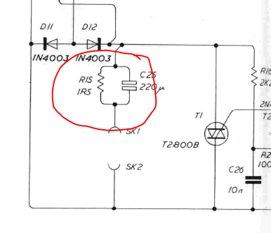

Hans-
You should add the parts circled in red to fully model the input side. They can and often are bypassed and the cap is supposed to bypass the resistor at higher frequencies. I would model the caps as 100 to 500 milliOhms depending on frequency based on the one I just checked. That circuit is there to protect amps from the crowbar protection or so its claimed by some.
Hans-
Hi Demian, thanks for your suggestion.
I also simulated with these components, but it hardly made any difference in the measured distortion.
I understood that this extra resistor+cap is there to lower DC current flowing through the transformers in case of a PA that has a DC offset, causing saturation.
As a sidenote, I have a set of ESL Pro speakers that do not have these two components.
Hans
Demian, here's the sim with the added 1R5//220uf that you advised.
As I said, there is hardly any difference with the previous sim without these two components.
Also notice in the distortion figures that it's all composed of benign uneven harmonics.
This time I have included the input voltage magnified in the image by 200 to compare it to the trafo output, and also the current supplied from the PA has been added to the image.
As can be seen, this asks for a current supply of 12 Amp pk.
A usual 100Watt @ 8 Ohm Amp being used for a Quad ESL, can hardly supply this kind of current, so distortion will be even worse as the ca. 40% as shown here.
But please keep in mind that in all this that it's just an outcome based on assumptions for the transformer that I made in preparation of .
So I'm eagerly waiting for more accurate info, like:
1) the average path length of the flux through the core,
2) the cross section of the core
3) does the core have an air gap
4) is the core indeed a sort of Silicon Steel
5) VNA measurements
