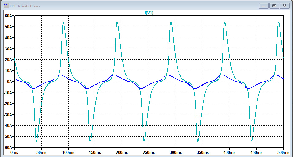

But keep in mind 2 things:
1) at 12Volt 20Hz, distortion is only 0.8%, and it's going down with 20dB/decade giving 0.08% at 200Hz and so on.
This is extremely fantastic, better than any electromagnetic speaker.
2) the previous results shown at 10Hz 30V pk are under the assumptions that I have made for the transformer, which may improve considerably when new data is collected.
Only the 1% at 6V@10Hz is correct, everything above is uncertain.
So for the time being, a good subsonic filter seems like a better investment.
Removing the two 1.65R resistors seems like a very bad idea since they limit the current through the transformers.
See the image below showing the current flowing with and without the 1R65 resistors for a 20V pk input signal at 10Hz.
Hans

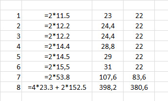

The dead panels finally arrived and I had a chance to measure the capacitance-
These are for 1 panel so the actual load on the network would be 2X. Looking at the panel these numbers make sense wrt the area connected.
I saw no change with frequency from 100 Hz to 100 Khz.
Woofer panel- 152.5 pF
Tweeter from center to edge-
11.5 pF
12.2 pF
12,2 pF
14.4 pF
14.5 pF
15.5 pF

That's great, thank you.The dead panels finally arrived and I had a chance to measure the capacitance-
11.5 pF
12.2 pF
12,2 pF
14.4 pF
14.5 pF
15.5 pF
53.8 pF
23.3 pF
When I interpret your figures correct, the third column shows what I get for the 8 panels.
Last column is what I used up to now, I will correct these numbers in my LTSpice sim.
Hans
