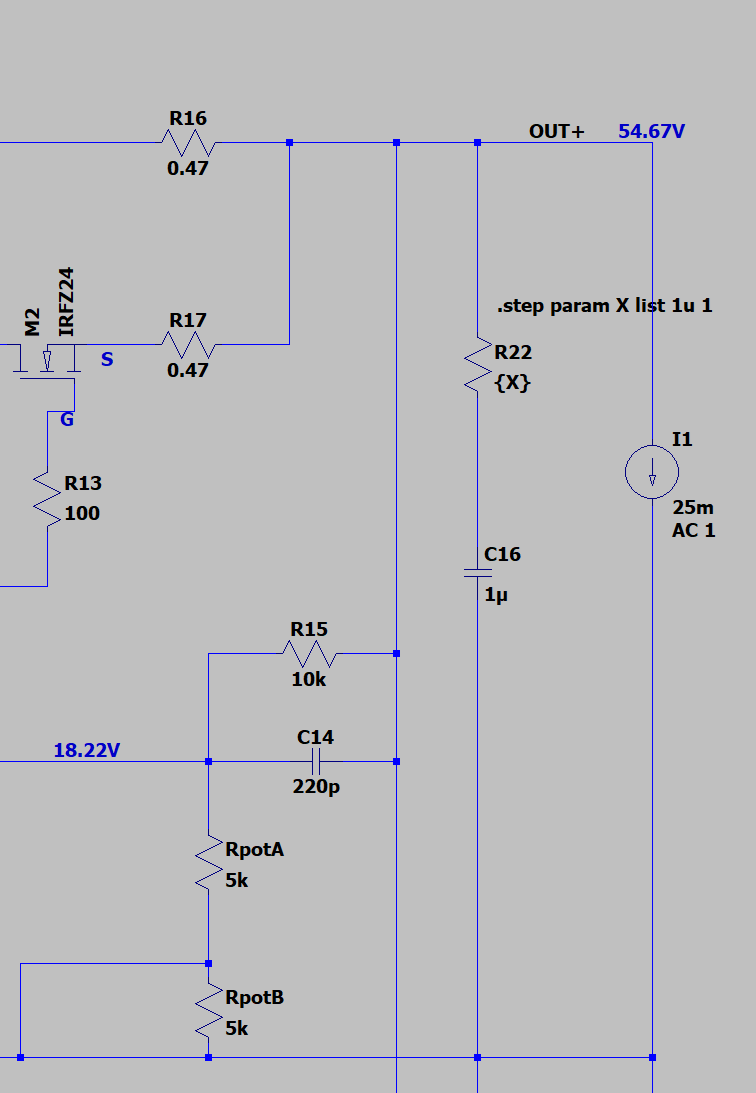

I am not seeing an "*.asc" file on your github repository. (You can post LTSpice *.asc files to DIYAUDIO)

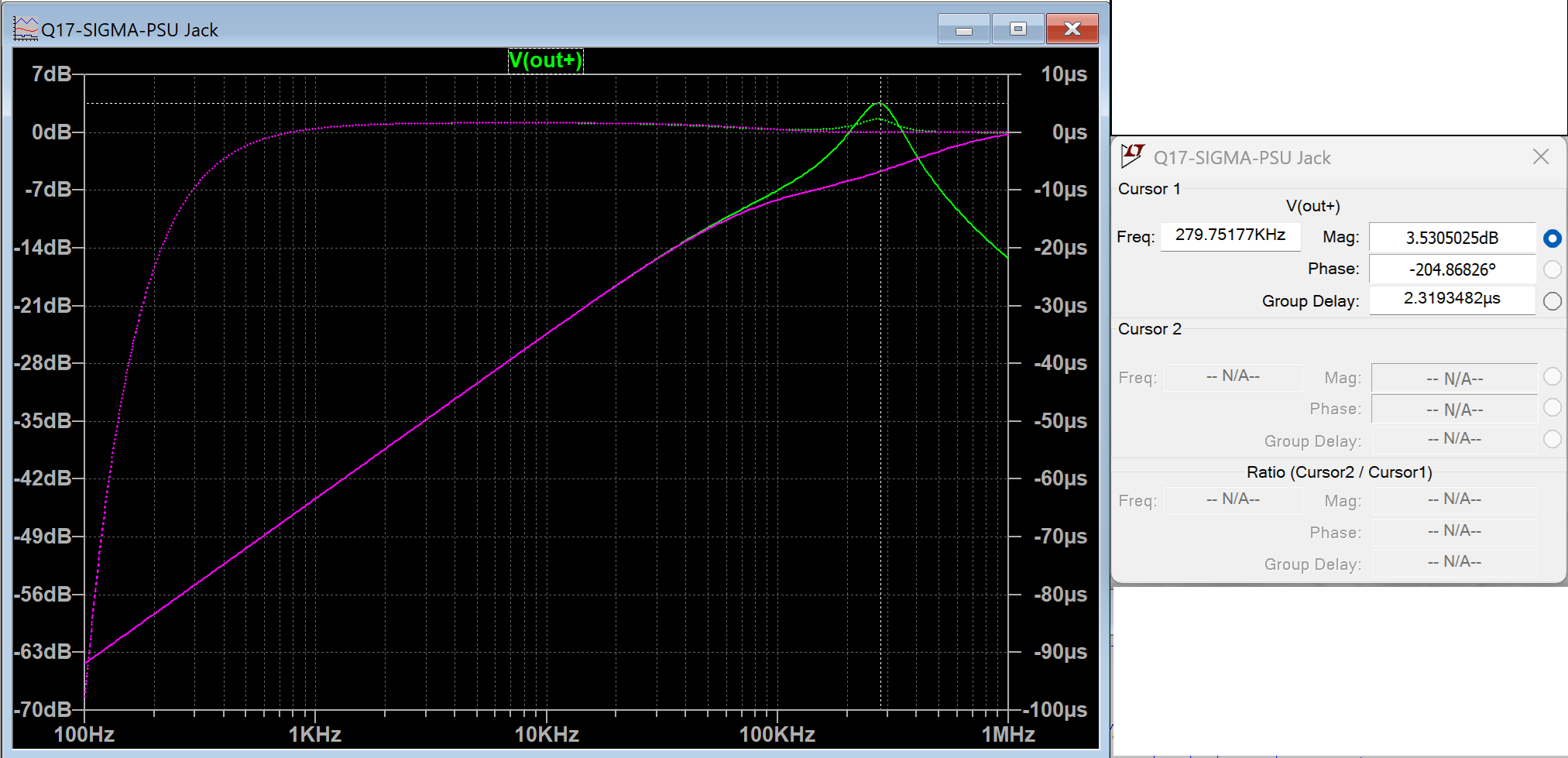

Would suggest that you hang a current source of AC=1, DC=25m on the output. If you run an AC Analysis and plot Vout/Iout you will derive output impedance. Good to know.
From the output impedance you can derive stability.
No, this design is not stable for a very simple reason. Capacitor C16 needs series resistance, even an Ohm. If you use a film capacitor here the phase margin is reduced to 31 degrees at 280 kHz. (Using the Erikson Maksimovich approximation where:
Q = f * tg * pi and
PM% =~ 50.363 * Q^(-0.907)
You could also just eliminate the capacitor as it serves no useful purpose.

It's a flaw you see all the time from DIYr's who think more film caps are better. The remedy is quite simple.

If you find anything that could be improved, give me a summary at the end. I'll fix it on Github when I have a little time.
There's also something I noticed: one of the polarities, the positive one, if I remember correctly, starts up slower than the other. About half a second. It would be good to try to correct that.
About the 1uF red caps at output. I know, I exaggerated a bit for aesthetic reasons, but you don't have to put them in. The 0.1uF at the input are also useless. It's a relic from the prototype that I forgot to remove.
Otherwise, in practice, the power supply is reliable and durable.
