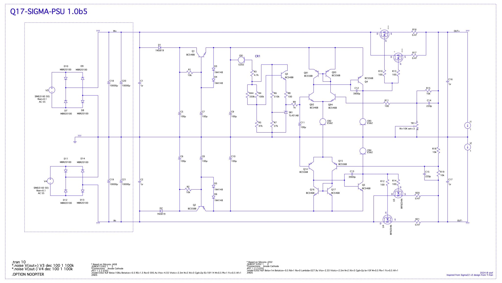

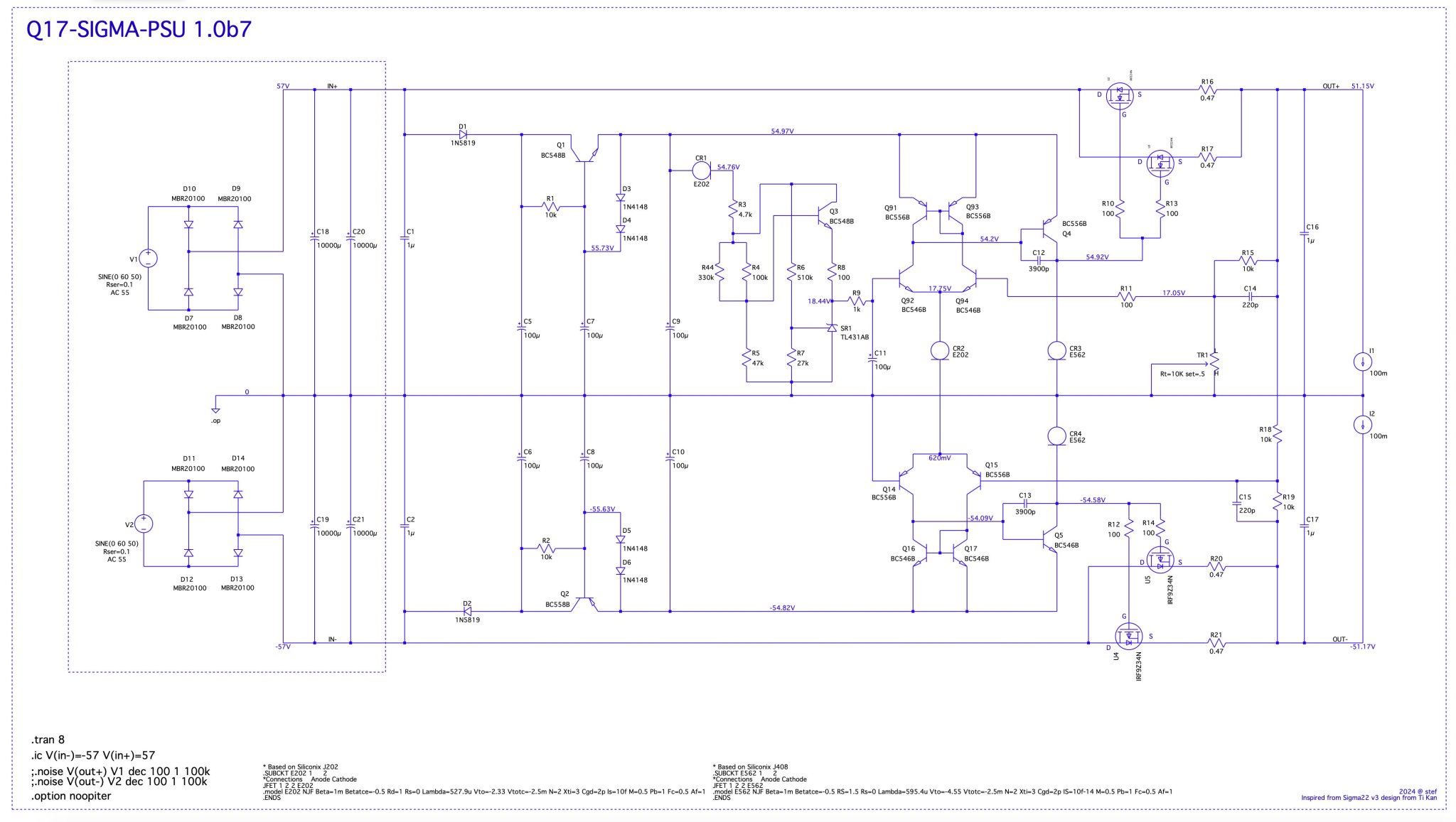

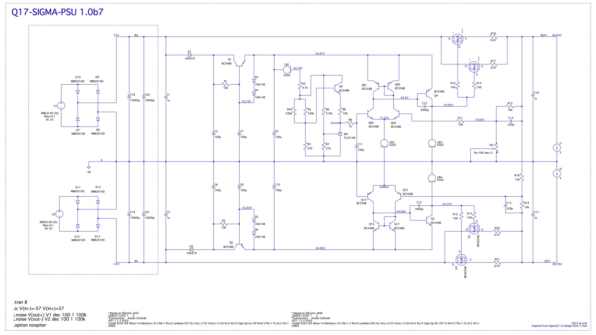

I uploaded the LTSpice simulation on my Github repository.
Total RMS noise on the simulation: 293.8nV from 1 Hz to 100 KHz at an output of 51 Vdc. These are of course "theoretical" measurements due to the fact that in a simulation the components are "ideal".

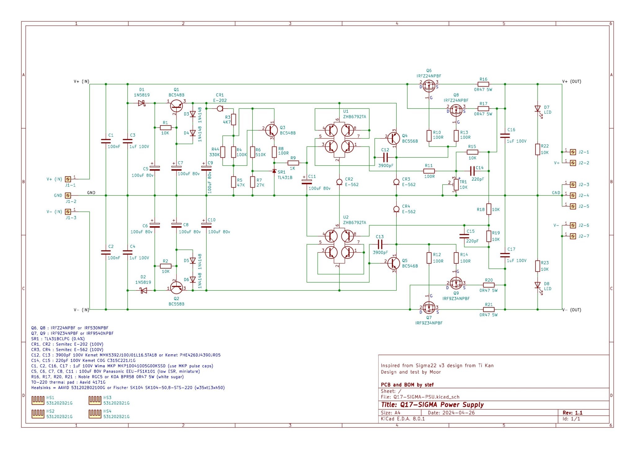

Hi Moor,
I tried the circuit with a single TO-247 MOSFET per channel (irfp140n and irfp9140n) and without 0.47R. The noise is higher (400nV instead of 293.8nV with 2 MOSFETs). I would have to try other TO-247 models to see if it is because of these particular models or if it is general.
Stef.
Stef.
That is interesting ! Two mosfets worse than four ... ? hard to find an explanation. Very curious.
This does the same thing with a pair of good IXTH80N20L and IXTH48P20P.
So confirmed, it is less good with a single pair of MOSFETs. Well, we're quibbling because it's already very low. 😉
Stef.
Stef.

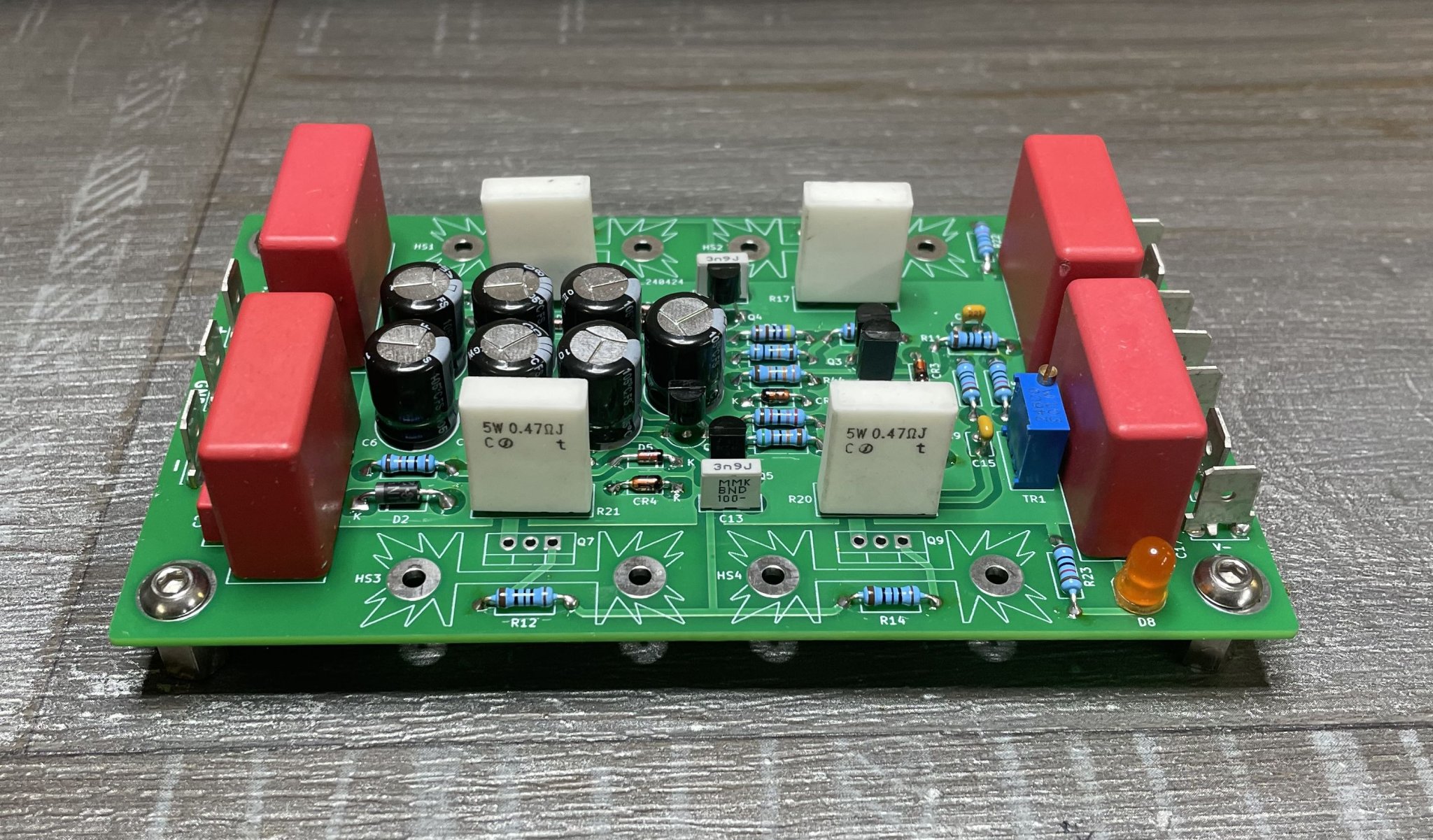

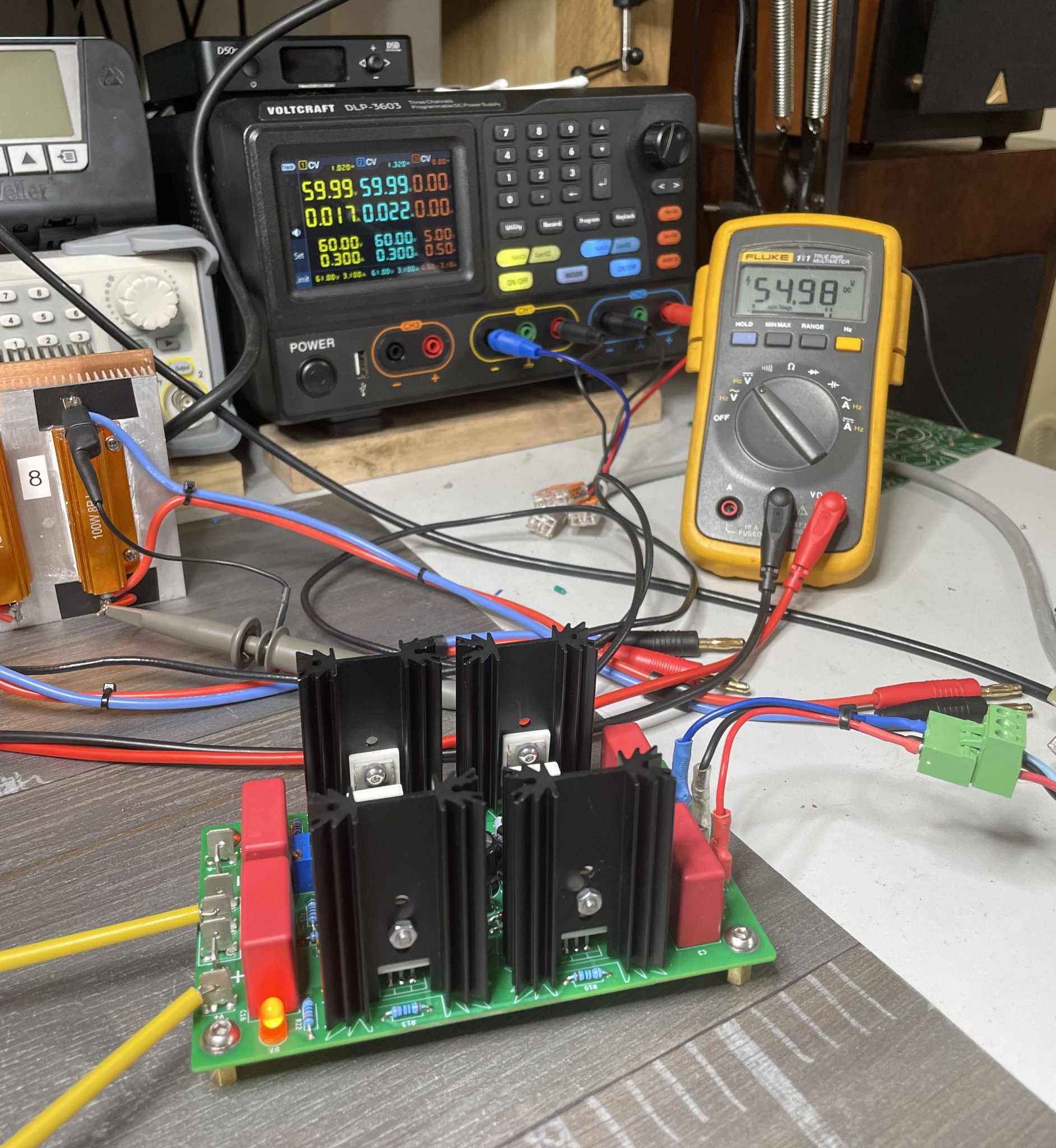

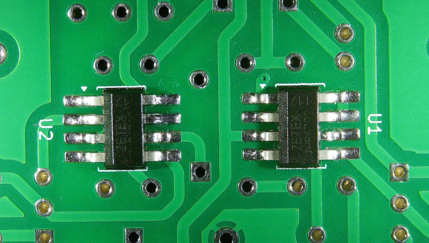

WORKS !!!
A pleasure to solder. The chips underneath are super easy to solder.
Just powered on without load. I'll let it heat up for now.
Max output with 60V input without load: 54.9V
With a load of 50mA, the voltage rises to 55.07V.
55.07 on the positive rail and 55.06 on the negative rail.
The regulator takes 4 seconds to reach 50V and 11 seconds in total to reach 55V.
At 50mV everything is cold of course.
I'm going to bring out the heavy artillery soon to torture her.
ok ... the delay is normal, because you doubled the capacitors from the bases and emitters of Q1 and Q2. But this in turn offered a lower ripple in the simulation, so everything seems very good until now.
I'm going to have to change the ignition delay of my amp. 😉
White sugars are not all at the same temperature. Ideally, you would sort the MOSFETs into pairs.
This consumes a little more current on the negative side.
We will see what the high power tests give.

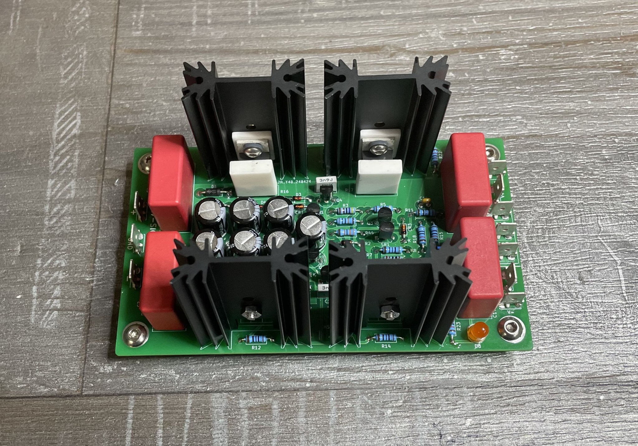

before changing the capacitors, first do a power test ... and measure the ripple. It is good to know it before going back with smaller capacitors
I don't have a 220uF 80V so no test at 3A at the moment. I was supposed to order some but someone bought all the stock at Mouser yesterday. 👽
Yes.
There remains this one in 220uF but 5 mm higher (10x25:5).
661-EKYB800E221MJ25S
I will quietly do my tests up to 1A afterward we will see.
