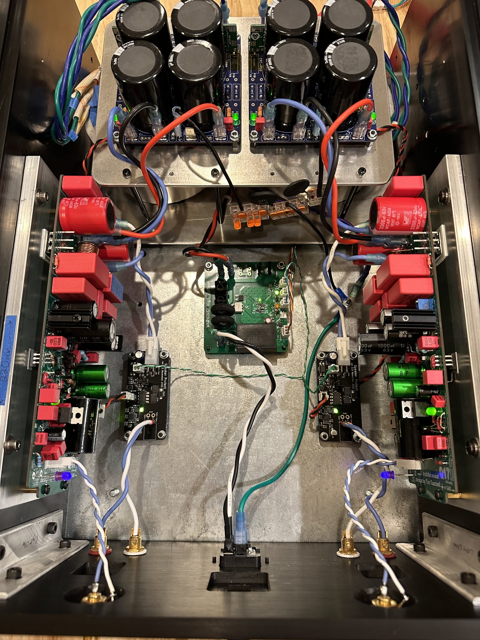

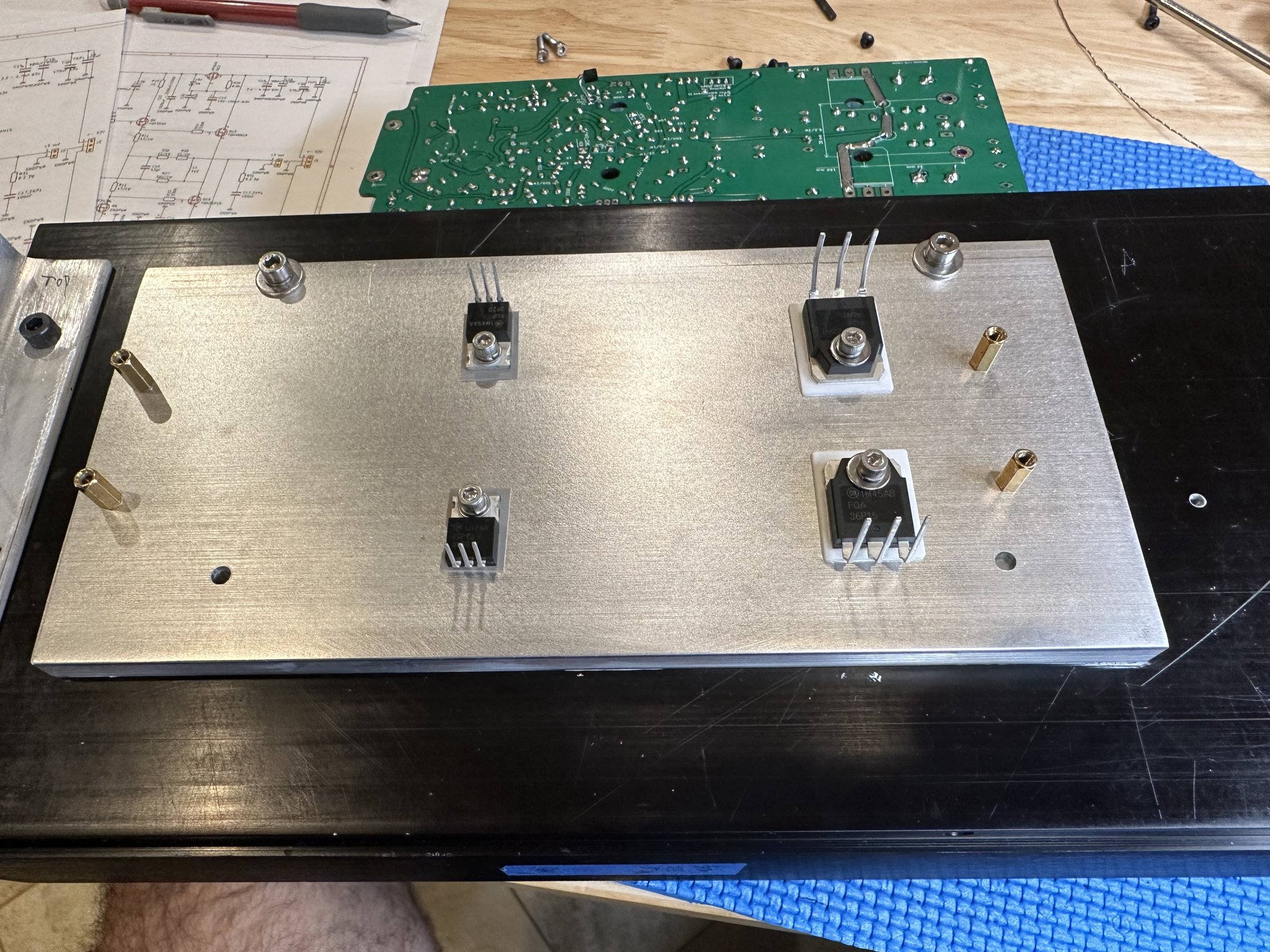

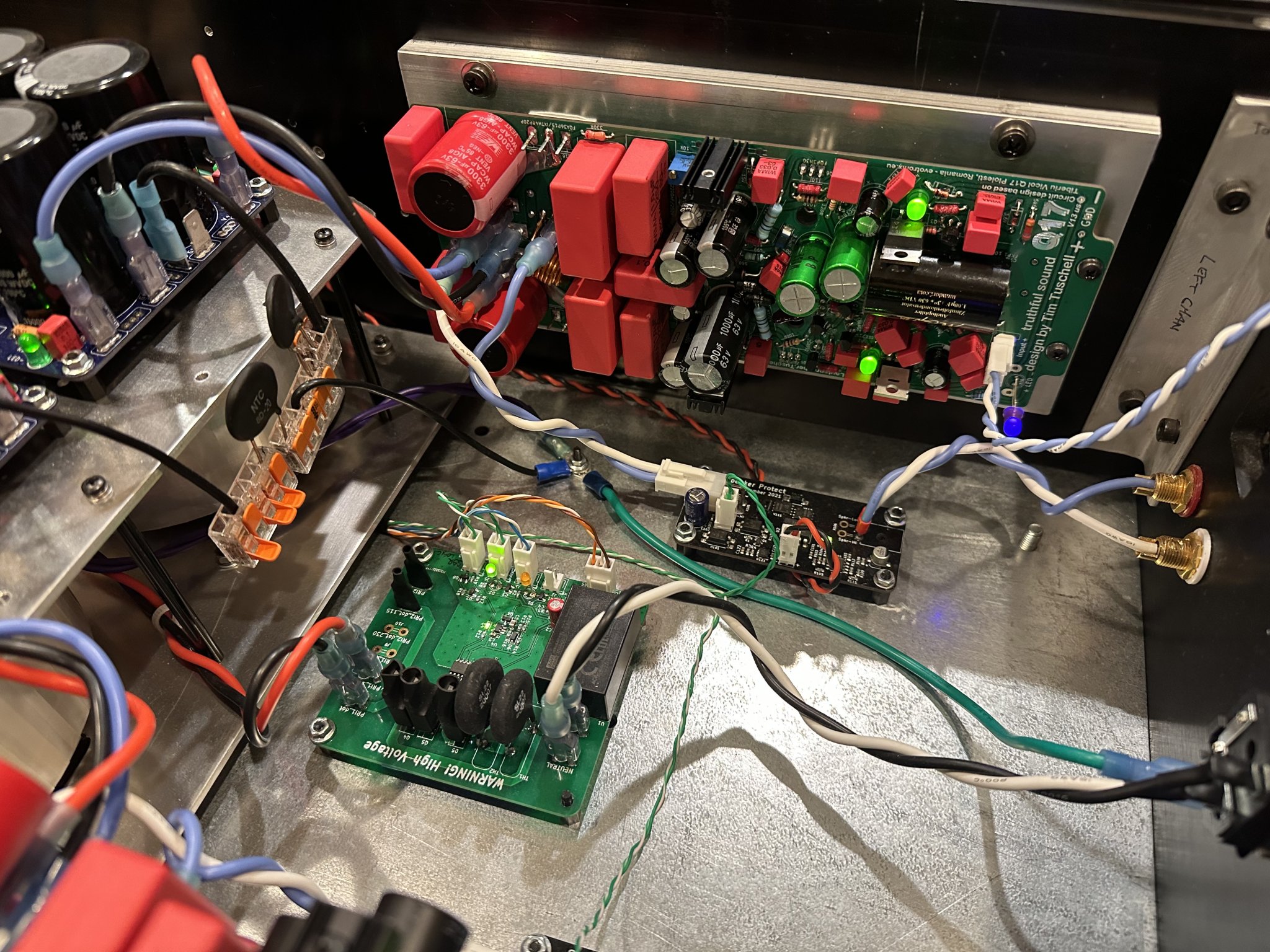

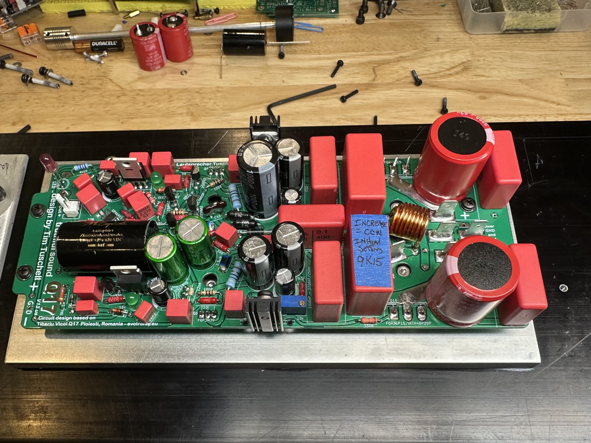

Tim's attention to detail and endless tweaking has further refined Q17. I've had this amp in my system for the last 10 days and it sounds wonderful. Not going to lie, the board layout seemed a bit busy at first. But after building it all components perfectly fit together like a puzzle. I took some liberty choosing resistor type and brand but followed the BOM recommendations exclusively for the rest of the components. This latest layout has even more tweaks then my freshly built boards. Having the UMS hole spacing is a helpful feature for buying ready machined Modushop chassis and the additional space given around L1 is welcomed.
The Q17-V13 is built in the same chassis with psu as the previous Q17 using Stef's boards. It's been alternating between driving two different speakers, B&W CDM9NT (8R/90dB) and a DIY Tang Band W8-2314 coaxial in a TL enclosure (4R/85dB). The amp is dead silent when idling, delivers deep controlled bass, clear non-congested middle and fatigue free top end. My Keeper Amp's Stable is getting crowded, but will need to make room for this one 😉.
Big thanks to Tibi, Stef and Tim for sharing the Q17 Amplifier and the constant drive to improve upon the original!

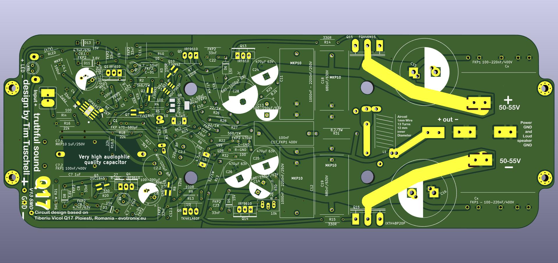

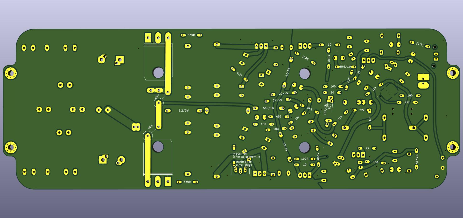

Stef really wants to hold on to the dual power transistor concept, as do some others. So I'm looking for solutions how this can look like - but can't find one that behaves as universal at small signals, as well as at large signals, as the single pair does.
Here I noticed a detail that I overlooked in the previously published variant. That is the matching of R12 to the higher internal resistance of Q6. This is a very small adjustment, but while we're on the subject of perfecting it....
R12=52 ohms. That's it.
Regards Tim

I did a lot of simulation runs of the Q17 with one, two and four pairs of power MosFETs and different parameter adjustments, with one result:
1 power pair: C10 = 56pF
2 power pairs: C10 = 100pF
4 power pairs: C10 = 220pF
The output filter should also be adjusted to L1 = 1.5 uH and C17 = 150 nF for several power pairs and C1 slightly increased to 680pF.
The point is that with several output pairs, the amplifier has levels that are too high in the MHz range, which is why some amplifier assemblies at the beginning of the project with several power pairs broke so quickly or didn't even play.
What can the double power stage do?
It cannot improve the control in the bass because the internal resistance of the amplifier remains the same due to the additional source resistors.
It is more suitable for higher loudspeaker impedances than for low ones, because the filters of the amplifier are not adjusted - see post before.
It can't deliver higher power, because in the large signal behavior the switching pulses produce more distortion than the single variant.
It cannot convince in the small signal behavior because of the imbalance of the power MosFET.
It is more expensive
It needs more holes on the cooler
It looks more important
In summary:
For more power and impedance matching to a 2 ohm load, the amplifier needs to be completely reworked. This also requires a higher supply voltage and a higher gain factor.

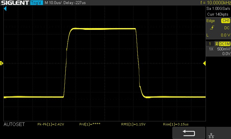

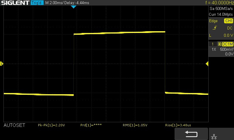

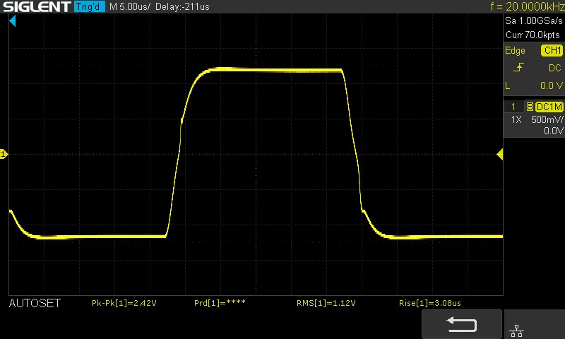

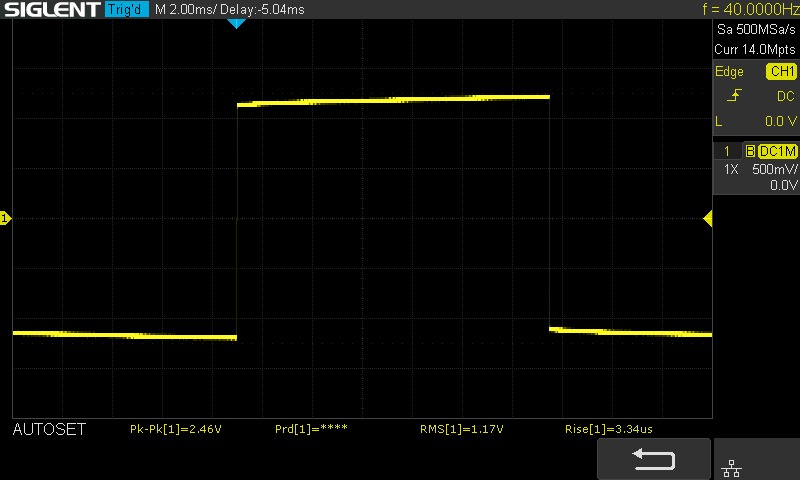

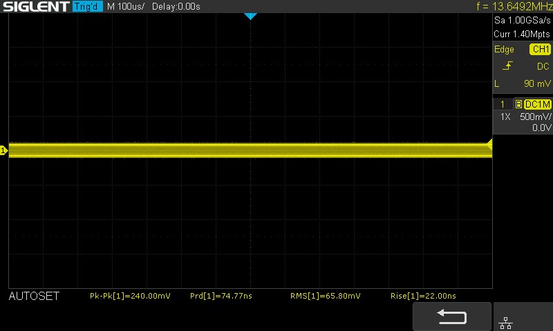

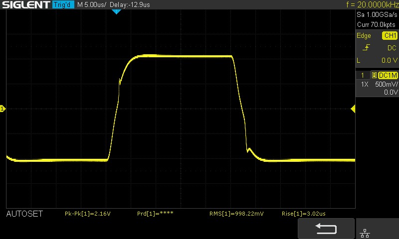

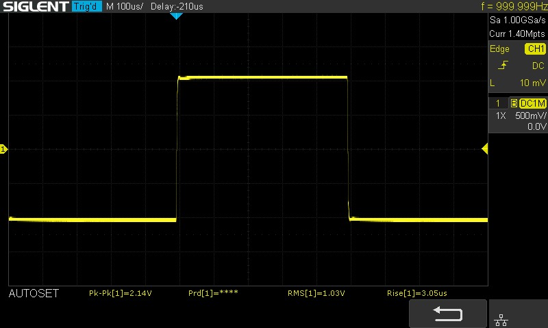

Good morning,
I tested the the Q17-Turbo with BD139-16 in Q12 stick on the heatsink. It causes an oscillation of 13MHz as with the BD139G. It is therefore confirmed that the BD139 whatever its version does not work if it is connected to the heatsink. This oscillation does not exist if the transistor is soldered on the component side.
I will now test the Toshiba TTC011B another candidate with better specs.
I also put you the measure with the KSC1845 in Q12. No problem that it is soldered on the component side or below stick to the heatsink.
To be continued in the next episode.
Stef.

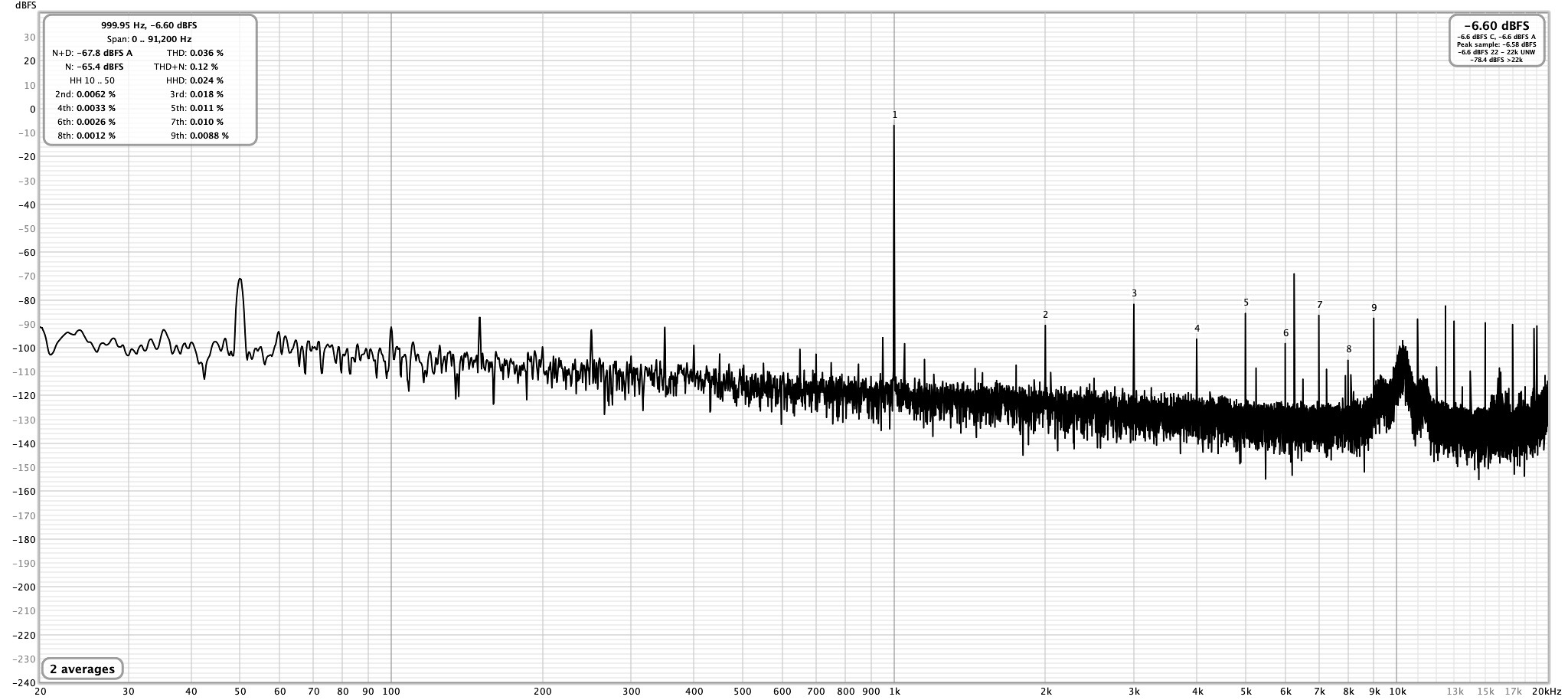

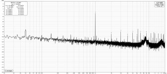

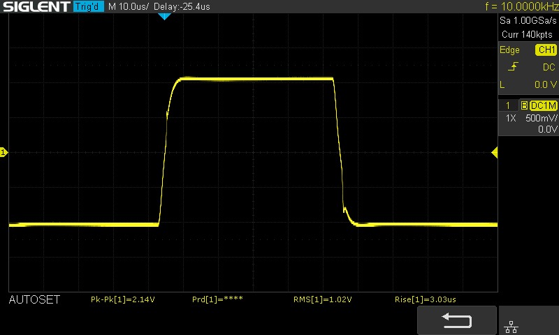

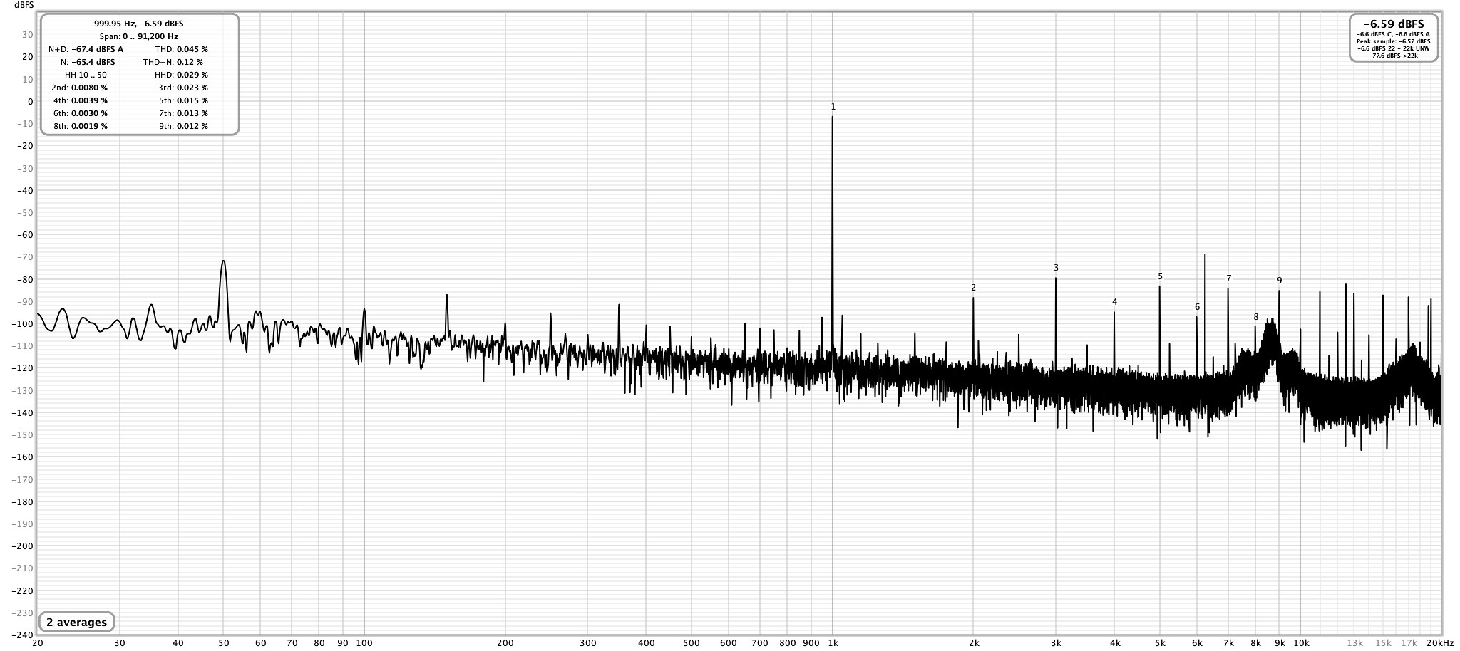

This is the second part of the measurements.
The good news is that there is no more oscillation with the Toshiba TTC011B, however the curves are not very good in my opinion. Worse than with the BD139 soldered on the component side or the KSC1845 whatever its position. The measurements of the Q17-Turbo also seem worse to me than the Mini (one pair Q17).
I also added the spectrum with the KSC1845 that I forgot to put earlier.
If you have any comments.
Stef.

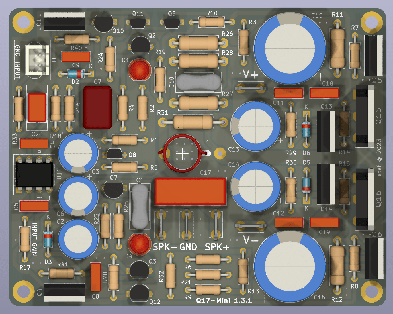

After almost a year, I finally updated the Q17-Mini PCB. This version does not bring big changes but improvements introduced over time.
Have fun.
Stef.
Changelog Q17-Mini 1.3.1:
  • Moved C10 for better placement (thermal).
  • Modified some parts of GND ground plane.
  • The SMD capacitors footprints have been moved slightly away from the active components. Was difficult to solder by hand.
  • Added JST-XH connector footprint for J1 (input).
  • Changed U1 to OPA1611 (Sound warmer and a little less midrange).
  • Updated C3/C6 to 47uF/25v (Nichicon Muse KZ UKZ1E470MPM1).
  • Changed R29 and R30 to 100R (no more noise at power on)
  • Replaced BD139G on Q12 with KSC1845 and updated footprint.
  • Component references and equivalences added in schematic.
https://github.com/stefaweb/Q17-a-QUAD405-audiophile-approach/tree/main/Q17-Mini 1.3.1
