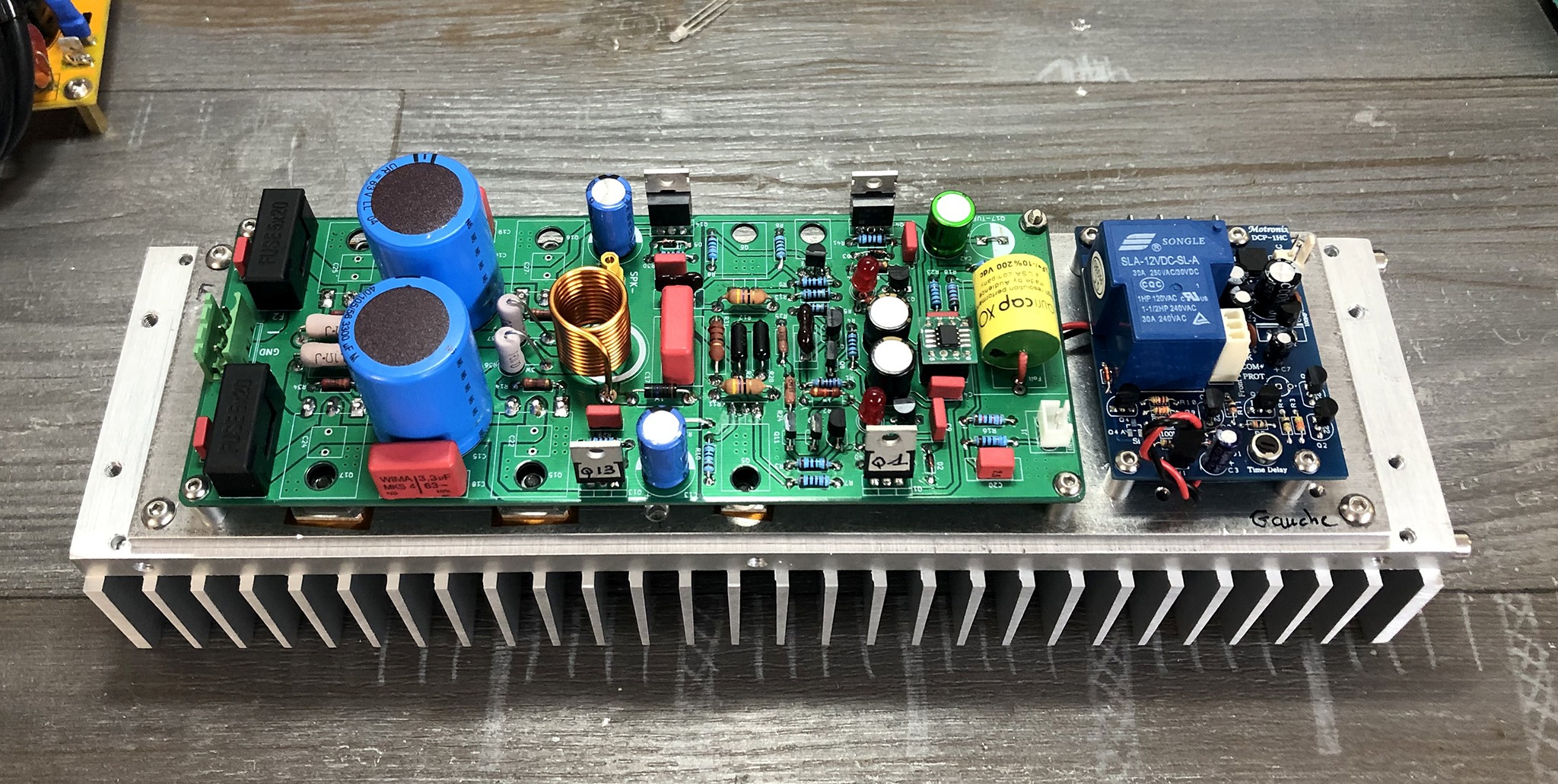

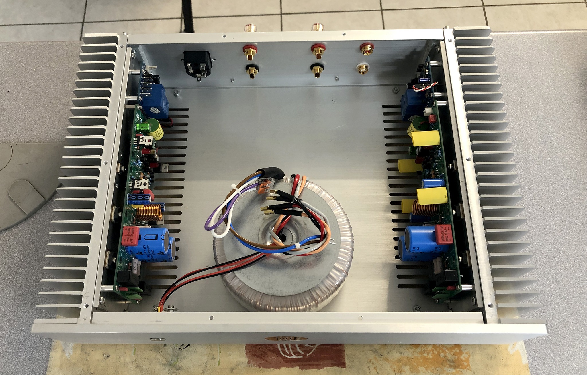

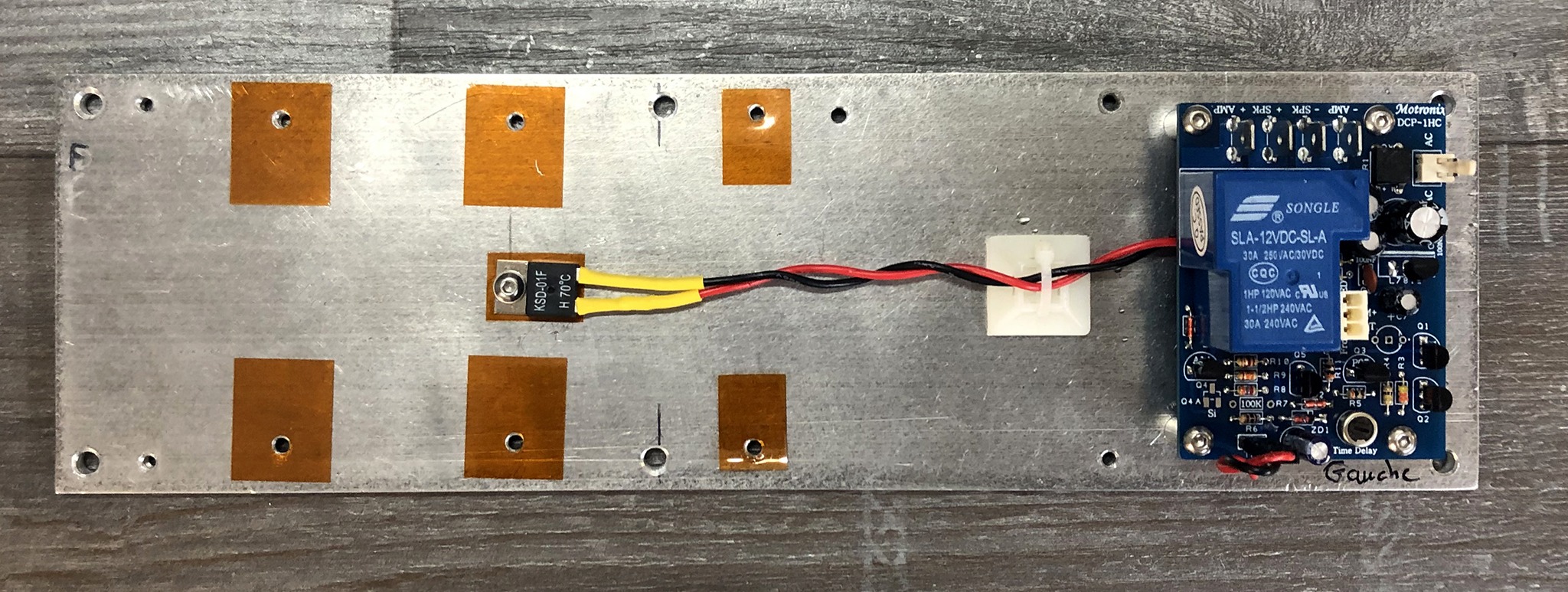

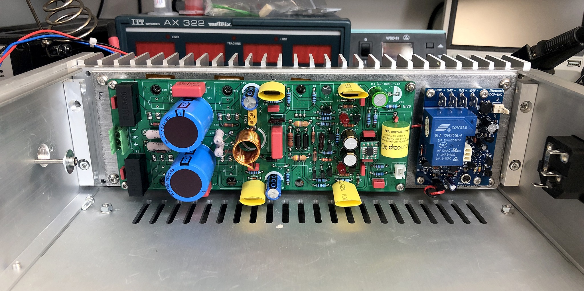

Hello,
The amp has advanced a bit this weekend. I'm missing a few screws to complete the integration of the board in the chassis. The transformer is a TALEMA 2x40Vac 500W. It gives 60/61Vdc loaded.
Stef.
