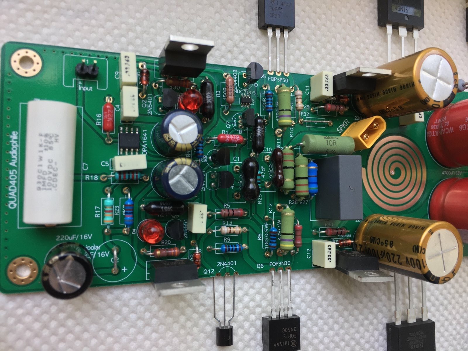

HI Tim,
Give me the references of some transistors which could advantageously replace the KCS1845 in Q12. I would do some tests and measures. The ideal would be to find a replacement for the BD139 with the same package which is easier to handle than the TO-92.
In the meantime, it seems more secure to me to simply replace the BD139 with a KCS1845 on my PCBs. The pinout is written on the PCB to avoid any errors.

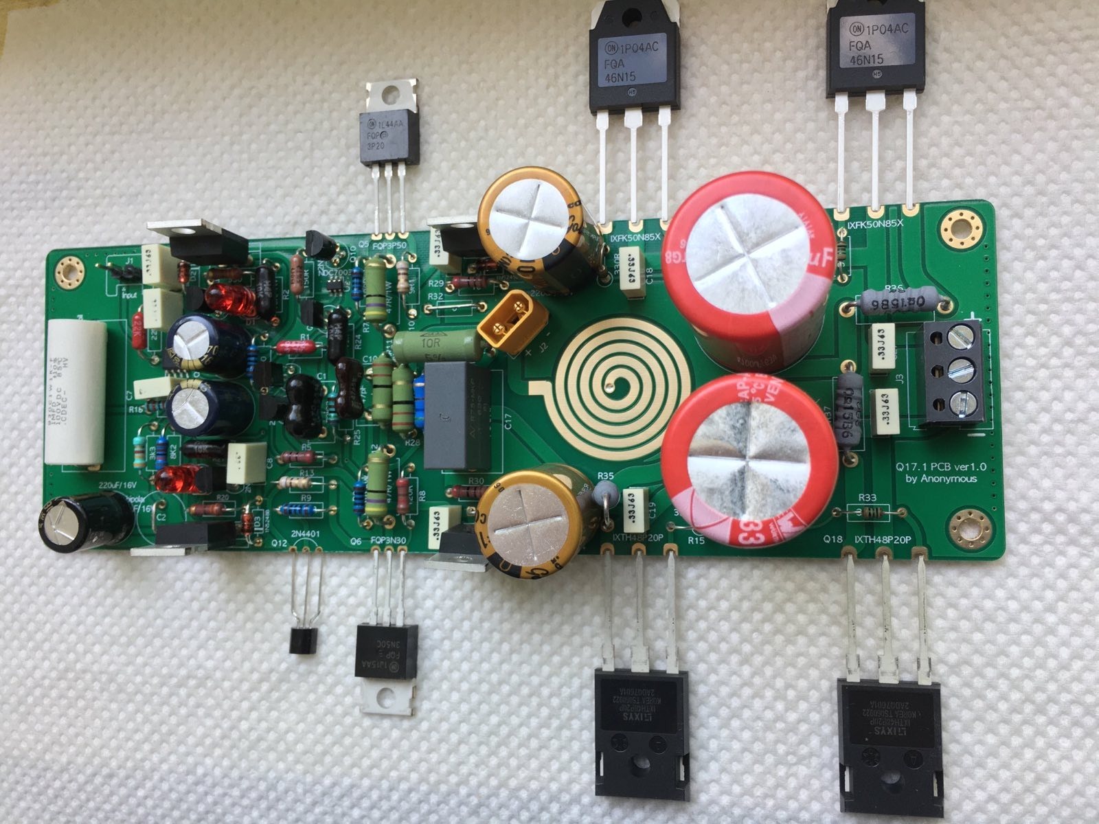

Do you have the heatsink holes drilled and tapped for the transistors and pcb mounting stand-offs? Correct mounting height and location of transistors should be known before they are soldered to the amp board. This eliminates stressing the legs if they are not aligned properly.

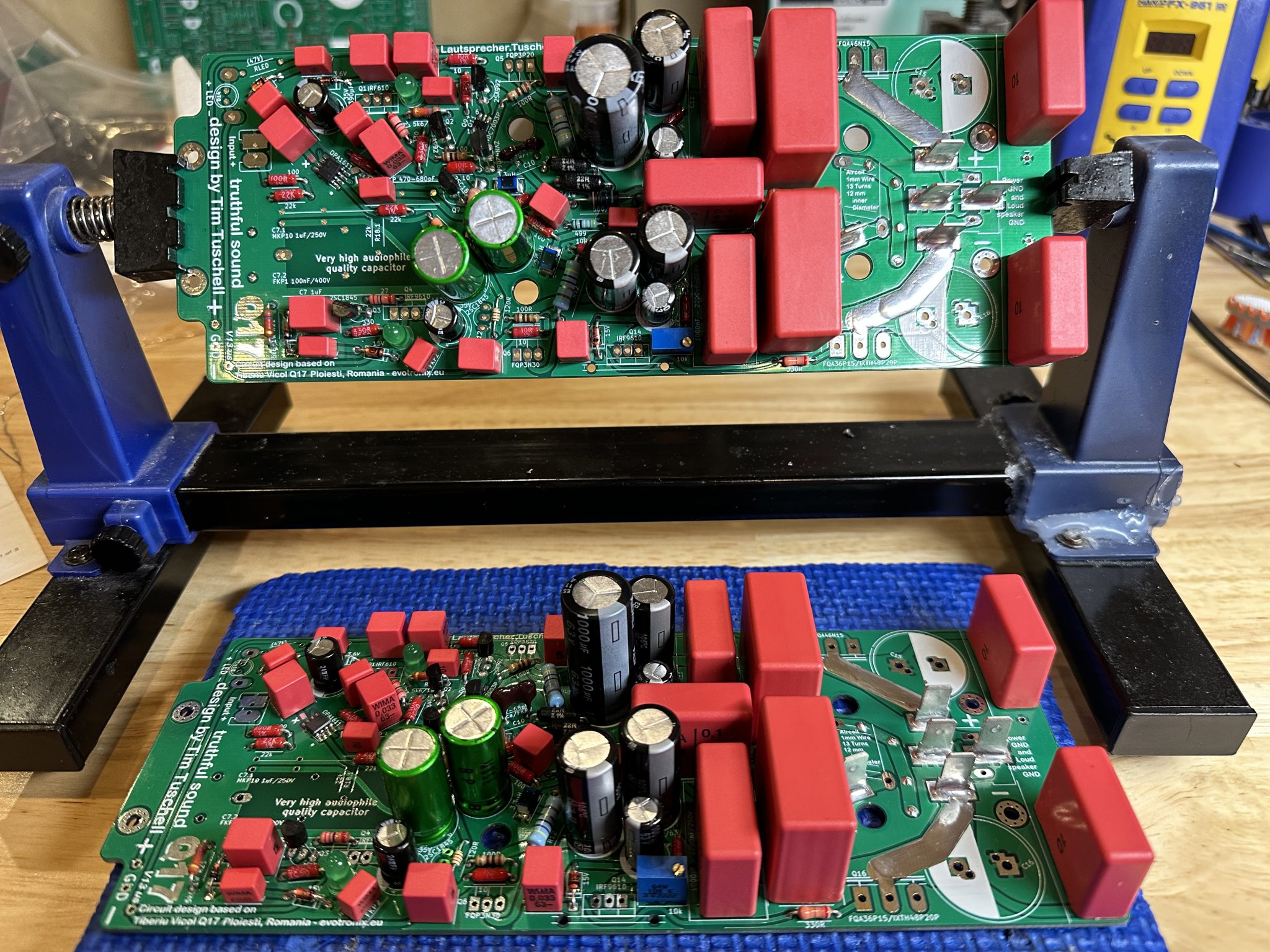

Guys, I got a problem,
I tried to power up this module via the 1A fuse and immediately left, the led in one side lit up and immediately went out. I checked each part 2 times to make sure it was in the right position. Where would you recommend to start looking? R29, R30 I used 10R 🙁
Friends, all ok...
The charging current of the 3300uF capacitors was probably more than 1A. I replaced with bigger fuses and it works, ... 😀😀😀
