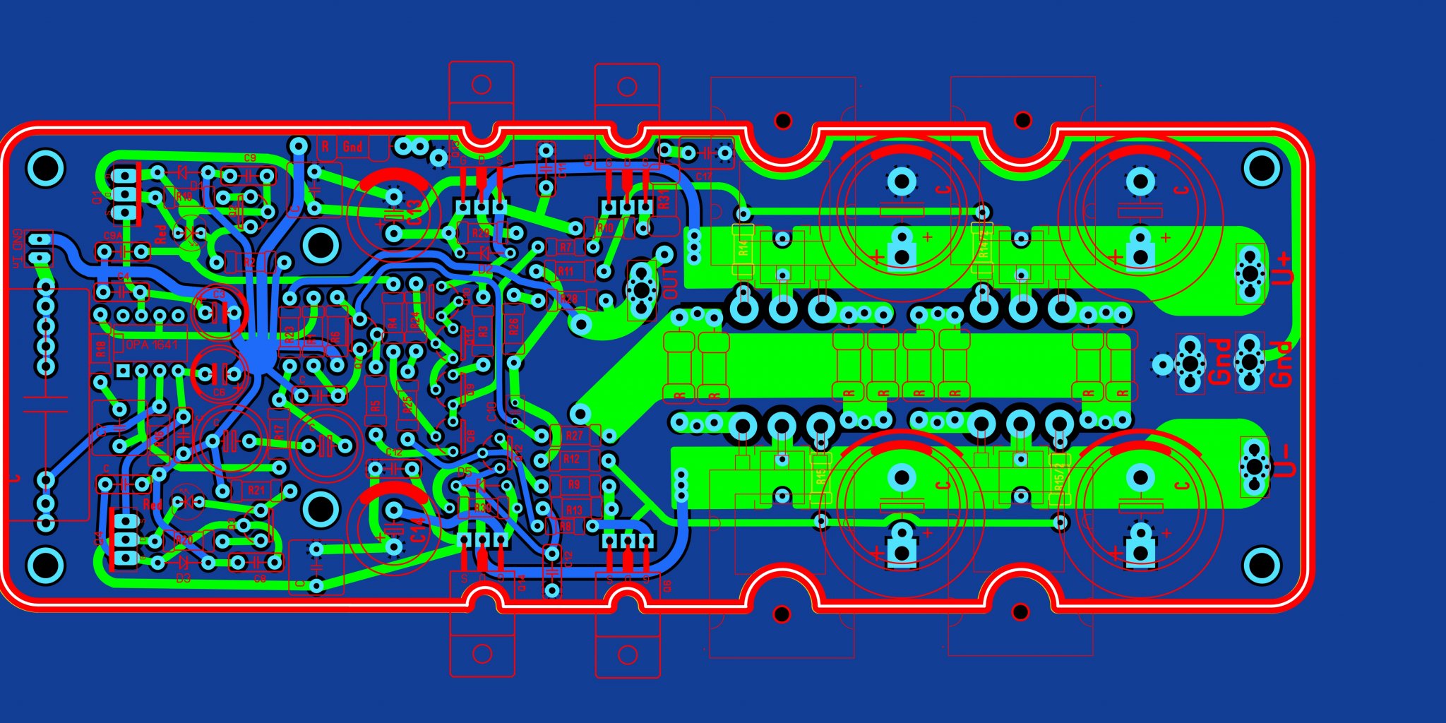

Hi! There is no way to measure such a small value. Made based on your measurements and photos. Also tried on the wires to remove it from the board.
Are you sure that the coil is 1.2uH?

So I can not run the board with the operational amplifier, and accordingly make measurements. The op-amp was bought by Arrow and it worked on the mini version(OPA1641)Look at voltage test point and see if you are near.
The ground star should be at input connector. Better use groud plane.This kind. The coil is not conveniently located.
Move the coil from input and cascode.

You can NOT run the amplifier without opamp.So I can not run the board with the operational amplifier, and accordingly make measurements. The op-amp was bought by Arrow and it worked on the mini version(OPA1641)
If you are able to do so, there must be a faulty component. Look at C1,C2, C7.

Have you not seen the video? It is clear that without Op-Amp the amplifier will not sound. But the supply voltages without op-amps are normal, there is no short circuit. On the common buses +/-35V, on the op-amp supply +/-15V, LEDs emit light. If you install the op-amp, the fuses burn out.You can NOT run the amplifier without opamp.
Of course we believe you. We only describe the normal behavior of the amp. Without an op-amp, the base of Q7 is in the air and causes an oscillation which saturates the output transistors. At 35v DC, R10 will take longer to burn out. 5-8 seconds for R10 is when powering the board at 50vDC. Just because the amp doesn't burn out or do not break fuses without an opamp doesn't mean it works. Leave it on longer without opamp and you will surely see that R10 heats up.

I think the board is unfortunate. The roads around the ОА are too long. The coil is close to the small transistors .

During my tests I had forgotten to put the OPA, the fuses did not blow,
I have found 36V DC at the output and the LED (D4) connected to the negative rail was off...
I immediately unplugged, put the opa, ...0V at the output and the board works normally 🙂

Quick update even after changing to IRF610/9610 the board behaves the same. Bulb is not getting switched off or low brightness and its consuming around 1.7A using a 0.1R resistor on the positive supply side with the bulb tester itself. I have given up now on these version of boards and maybe try the mini version which seems to work successfully for most of the people. I will try and salvage most of the expensive parts like caps and transistors. But thats for another build few months down the line.
