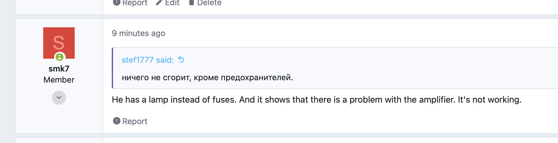

Putting light bulbs here and there is a nonsense.

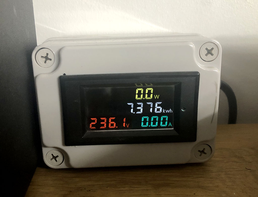

For my tests, I have this wattmeter in front of the power supply on the main.
It's very practical. When you switch on the amp, you see the consumption in real time.
For the Q17, it starts with a few Watts, then jumps sharply to around 25/50W, then back down to 14-16W. If after one and a half seconds, there is more Watts (like 50W, 100W, 300W), you must cut off immediately if the fuses have not blown.
