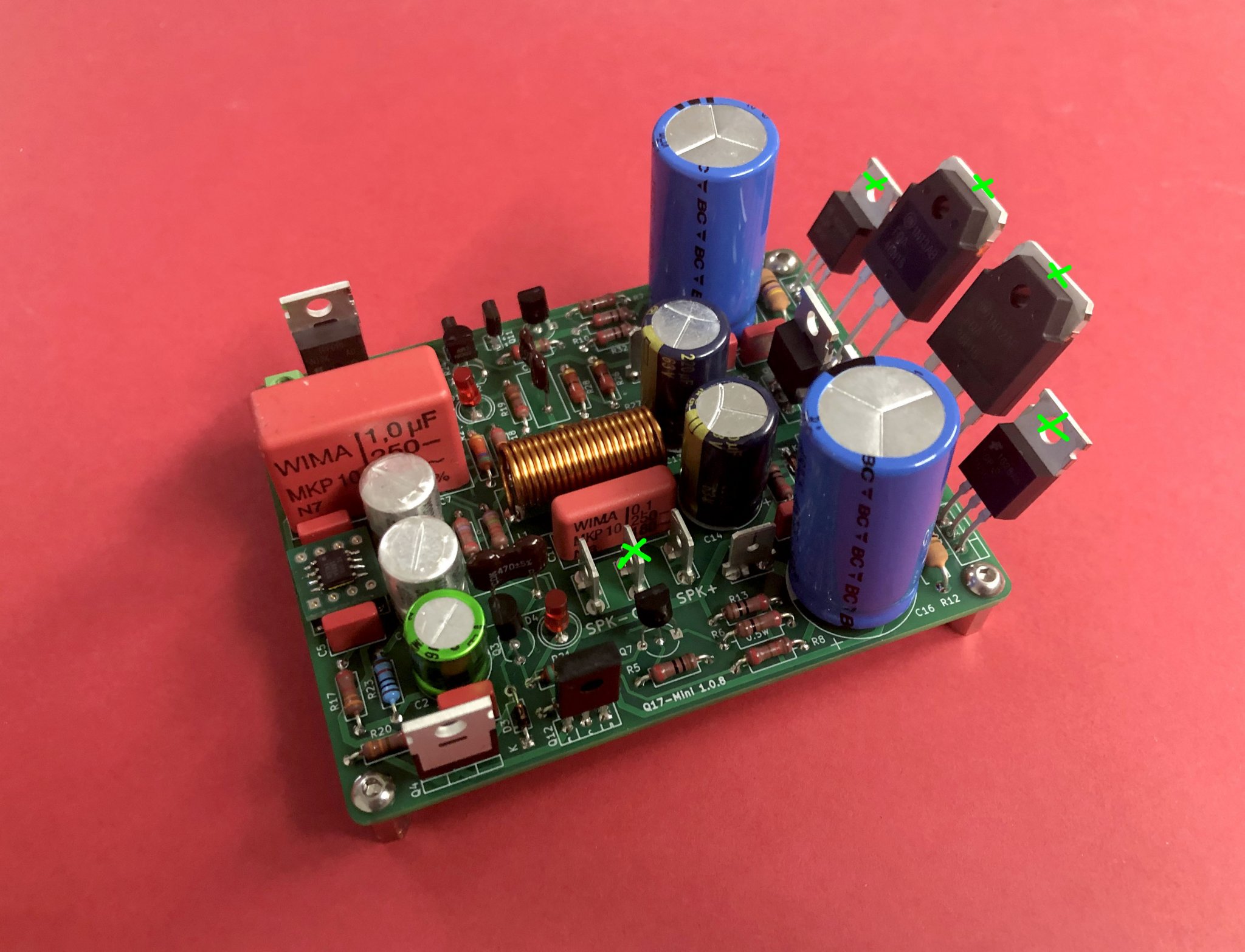

You have a short contact somewhere. Disconnect all cables and check resistance between GNDPWR and positive rail and negative rail. Check resistance between Q5, Q6, Q15 and Q16 metal part and GNDPWR. Should not be zero Ohms. Same with dissipator.

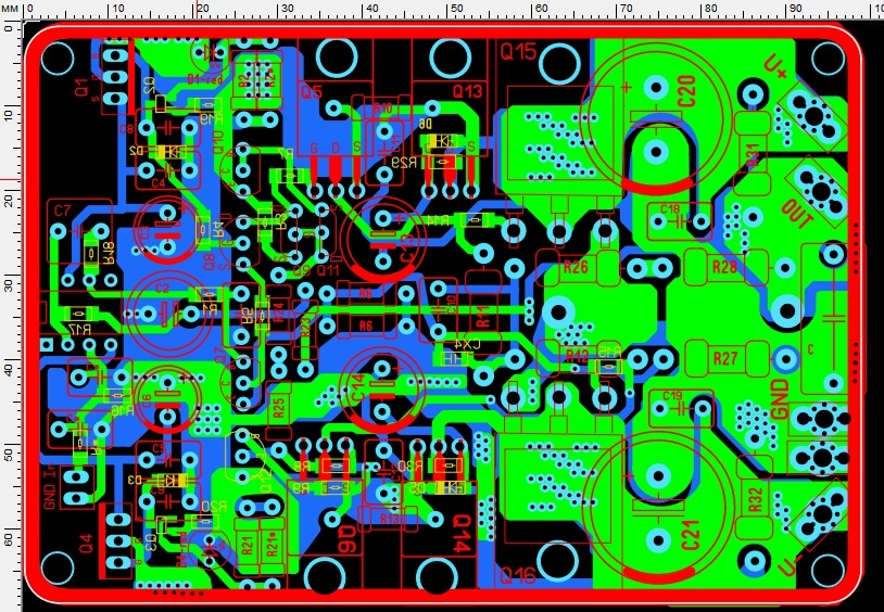

I looked at your PCB, it looks like Q9 + Q11 are installed in reverse, is that possible!

The metal part with the green cross. Check isolation of power transistors from heatsink too.

Thanks Stef, I always check each of the mosfets metal base for shorting to the heat sinks or not before powering up. I also checked each leg of the mosfet against the heat sink for shorting. None was their as I use a silicon thermal pad and grease. But I have not checked the ground power to the negative/positive rails and against the mosfet metal part. Will check that and for the last try will replace the FQP3N30/FQP3P20 with 610/9610 and run the amp. Also what do you suggest the input signal to be shorted during the testing of the amp which I usually do in all my class A amp builds.

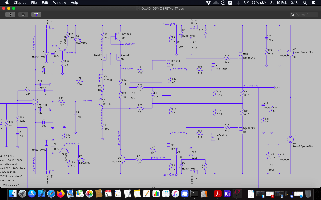

Have attached a simulation copy. Look at voltage test point and see if you are near.
