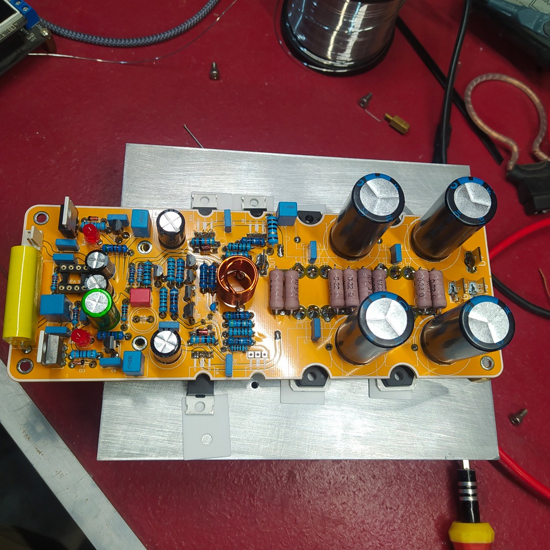

Hello Tibi,
Ground plane on both side is problematic to manage. Superimposed and uncontrolled ground planes can create parasitic capacitances and induce losses in the bandwidth of the device.
What is a "signal guard"?
Stef.
ps : C7 is connected as needed. If I reverse C7, the output offset is a bit higher. I put a "*" on the silkcreen to indicate the direction.

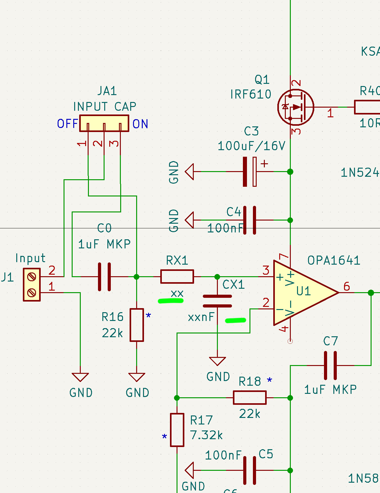

Again me.
For the input, I can try very easily with the P2 prototype this if you give me the right values.
Another subject, I tried to connect R6 to GNDPWR and the result is a burnt fuse on the positive rail. The circuit doesn't like it at all.

There is a LPF after opamp that limit amplifier BW at ~125KHz.
I do not use input LPF because internal cabling and PCB layout can eliminate any EMI. Cabling matter, pcb layout mater a lot.
If you want to "secure" input opamp I would go for a LPF at 1MHz. For this use 1K5 with 100pF.
Lately, I spent some time, to design a PCB with dual ground plane on input section. This ensure signal guarding as well. Two mosfet pairs, rounded traces, castelated holes etc.

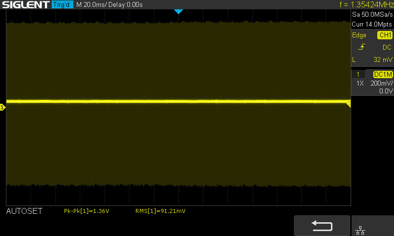

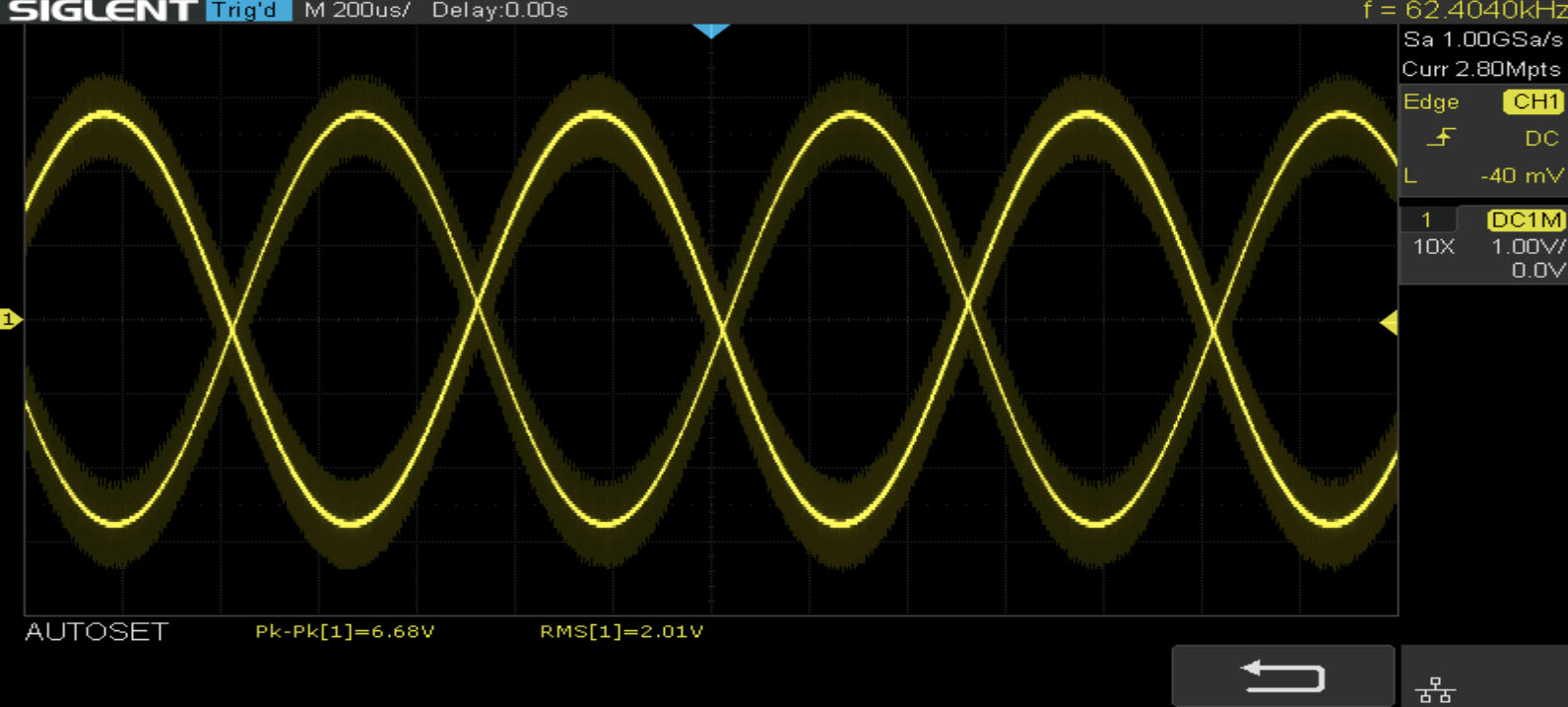

The prototype is broken again since yesterday after testing R6 connected to GNDPWR.
On the Fluke, I now have 41mv of DC output offset (was 36mV before). R8 is too hot after 3 minutes. For the first time, I connected the prototype to the scope and it's worse. See screenshots. The first is without signal and the second with 35mV RMS 1K sine at input.
I'll be good to check everything again. 😭
I will also remove component sockets that I no longer use. They don't have to improve things.
Stef.

Hello Stef,
I have had this experience several times now, that the amp no longer works after a test. What is inexplicable to me is that if I desolder the components and solder the same components onto a new board, the amp works again. I have tried this on purpose, without a realisation of what is actually causing the interference - i.e. the defect - wich part.
Maybe it would help to test what happens if you leave the currentless board on such an electrically conductive foam, so that all capacitors are discharged.
Regards Tim

Stef, I do not undestand how a gate resistor get hot. Maybe Q8 & Q10 and Q11 are faulty ?

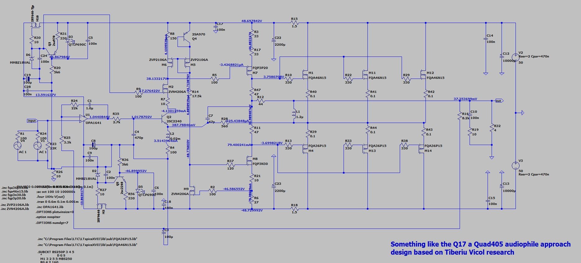

Hello,
I am trying to visualize the different experiences from the successful and failed experiments through the LTSpice simulation.
In the process, I have come to the following conclusion: The original circuit of the Q17 works in a working range that reacts nearly balanced when excited with square pulses. If parameters are changed slightly, this can very quickly produce needle pulses at the output - which I evaluate as potential oscillation possibilities.
I had reduced R13 to 9.x ohms on an amplifier, at this value the simulation also produces violent needle pulses at very low input signal (5mV peak). If I reduce R13 to 7.5 ohms, then I am in a different working range of the power amplifier and the needle pulses have disappeared in the simulation result. Comparing this simulation to one with Q12 as the MosFET, the behavior of R13=7.5 ohms for the original corresponds to Tibi's suggested R13=27 ohms for the Q12 Mosfet.
I have been aware for some time that the amplifier is very asymmetrical and is also an asymmetrical load on the transformer, but I did not realize until now that R10 and R13 have quite different functions. Therefore, in the schematic attached below, I have chosen R10 to be significantly larger than R13 (I am using the designation from Tibi's original schematic here so that you can allocate the components. In the simulation the names of the components change regularly).
In the simulation I added a resistor before the source of Q6. This has very little influence on the behavior of the amplifier.
With this circuit described here I can simulate small square pulses without needle pulses in the output even with several output pairs at power Mosfet. However, since this amplifier works especially towards high frequencies (the attenuation in the MHz range is lower than with a pair of output transistors), I also used L2 = 20 uH (as Tibi did in one of his last simulations). This inductance effectively reduces the high frequency component so that it becomes comparable to the original circuit.
For me this result from many simulations is a basis to get the deficits of the 3-fold Q17 under control. It is clearly more suitable than the variant with the additional capacitors, which is more of a symptom treatment than a systematic optimization or adaptation of the circuit.
The primary advantage of using a Mosfet as Q12 for me is that I can select R10 with 66 ohms (< 100 ohm) relatively high. This has the advantage that the feedback over the + rail is somewhat damped (that is my objective here).
Regards Tim

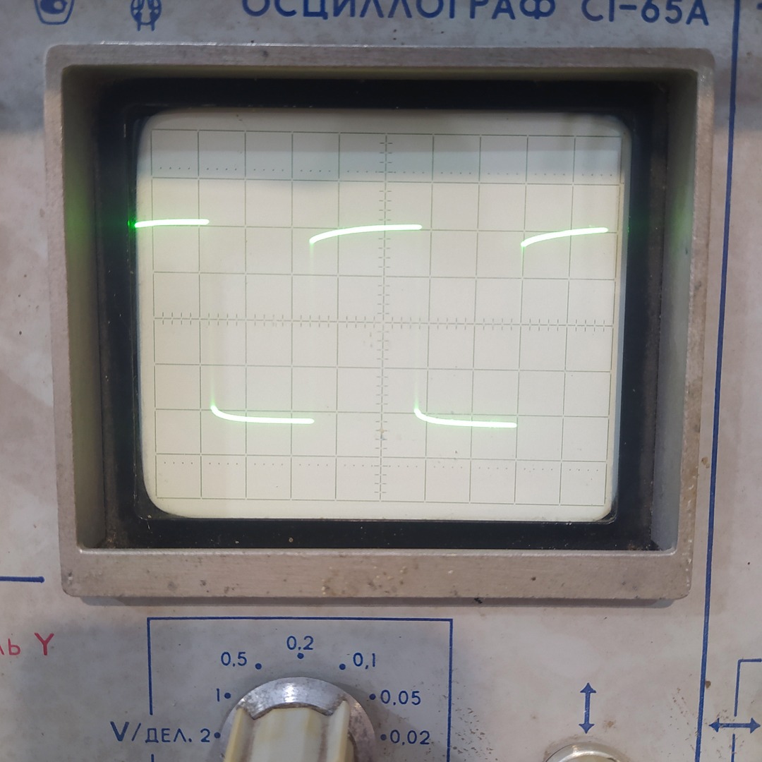

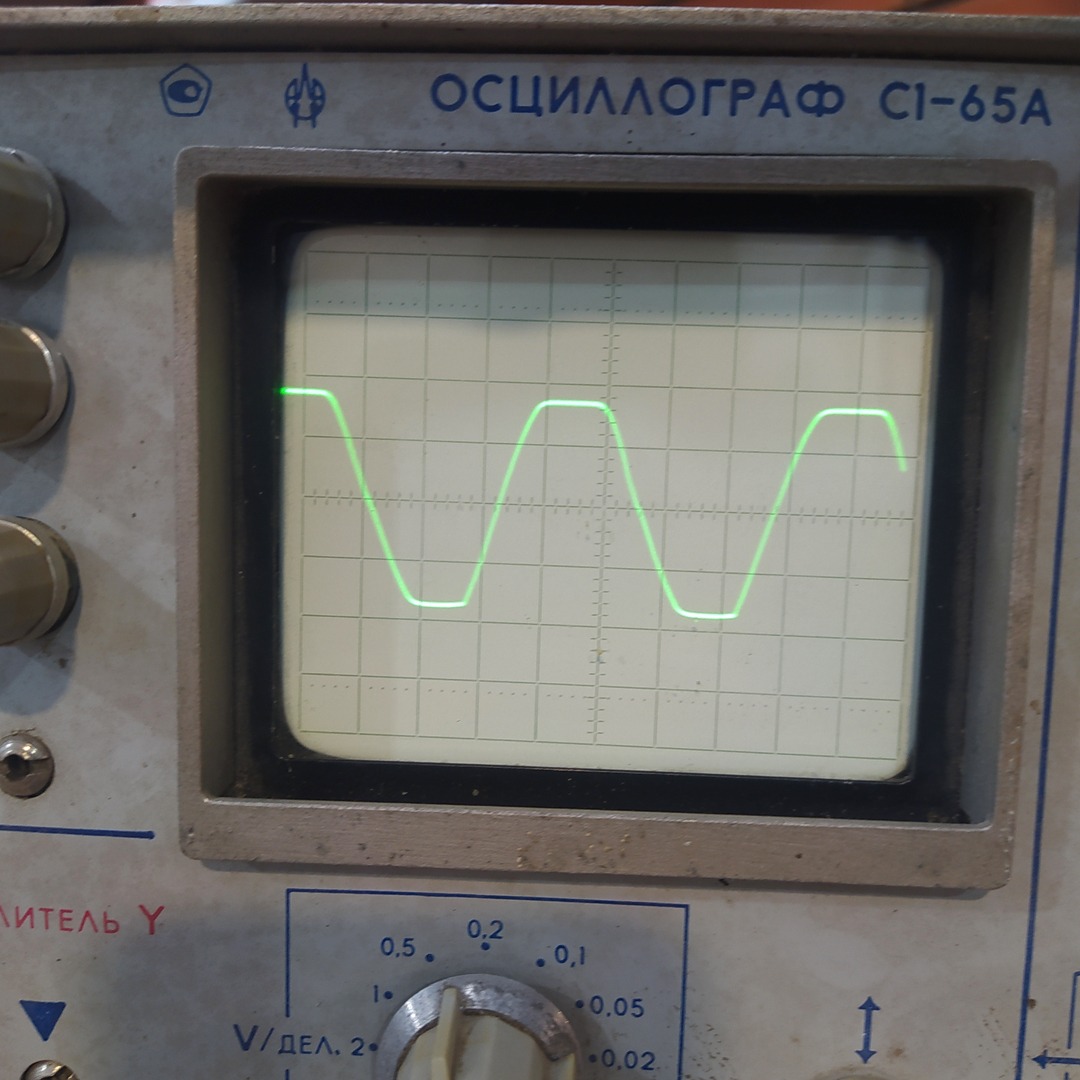

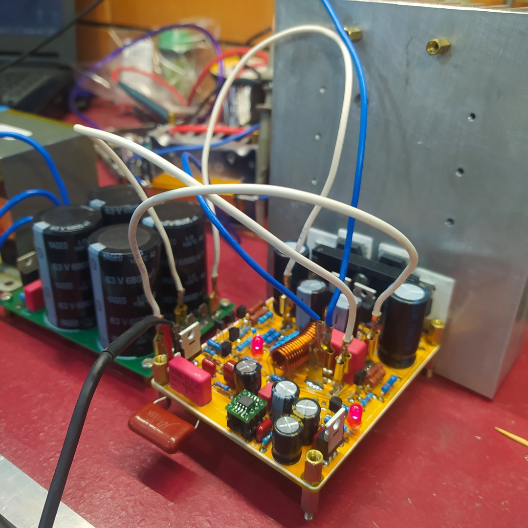

I also put together two versions. One mini version and one with two pairs. The mini version ran, but very unstable, the 1kHz square is very bad, the 20kHz square looks like a saw. Two times the output transistors burned out for no reason. With two pairs it didn't even start. I will try to make a new board and move the coil away .
Many boards were made at the beginning of the thread, but no results are seen here. Also would like to see 1kHz and 20kHz quadrature. The amplifier is very unstable.
