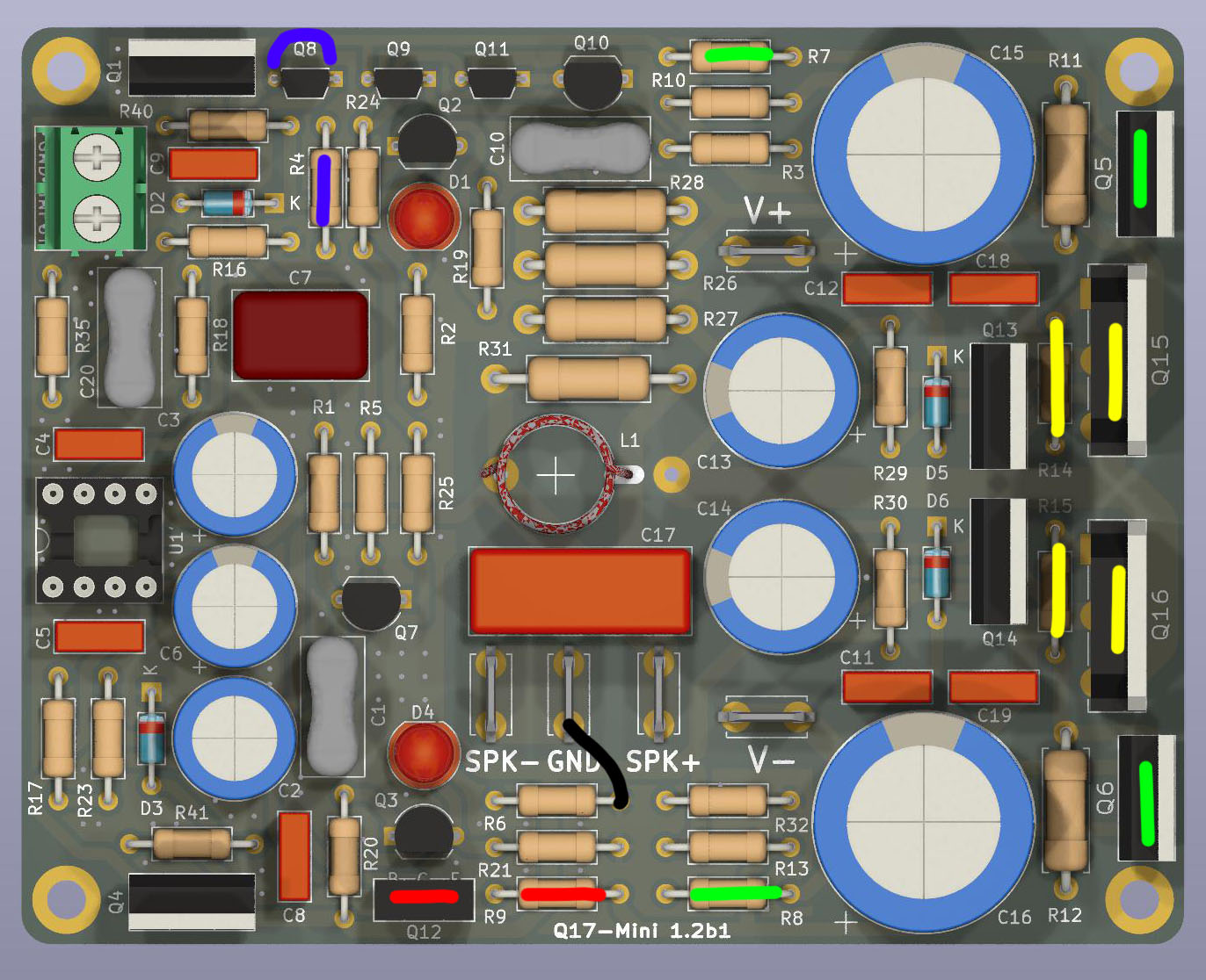

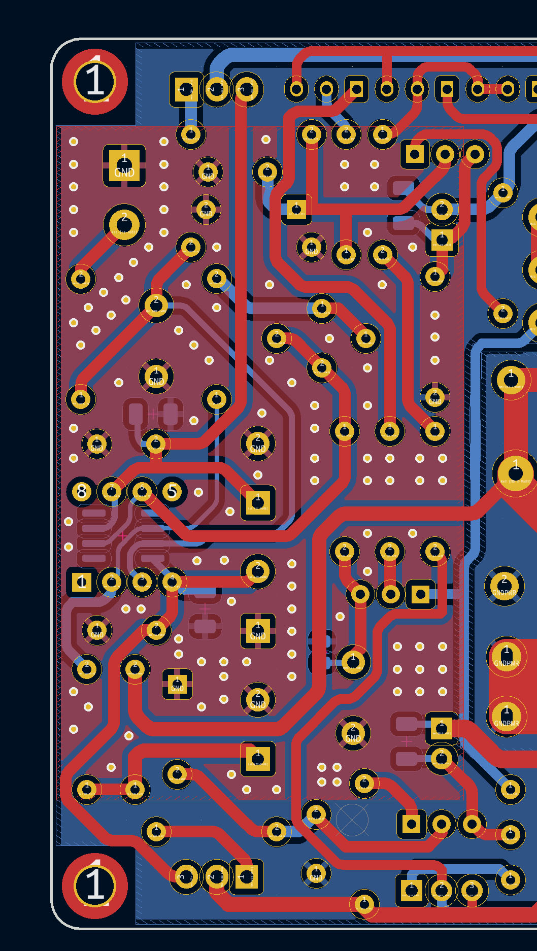

To fill the various holes? (Just to be sure).
I didn't dare to do it with the vias weighing that it could introduce pervert effects. I'm also doing a contest to use as few vias as possible. 😉 In the new version of the Mini that I am preparing for March, I have reduced the number of vias from 8 to 1.
Do we really need to add top ground plane on all the GND zone or only as in my example around the opamp?
Stef.
Vias is good used where is needed. There are several cases when this must avoided, but not here.
Top and bottom ground planes are already connected by numerous parts that are gnd connected, but adding more vias will make gnd plane more "compact", reducing planes resistance and avoiding any possible ground loops.
You may add gnd vias near input signal connector and around opamp.
Tibi
2os is costing a lot. I've see. But needed for a so small board.
PCBs with Gold have become overpriced! To say that I did it systematically golden 10 years ago. Newworld!
Like this. Is it okay or is it too much?
I will do a simulation of the gerber to see the cost of the VIAs with new files.
It's the last, I promise. 😉
Stef.

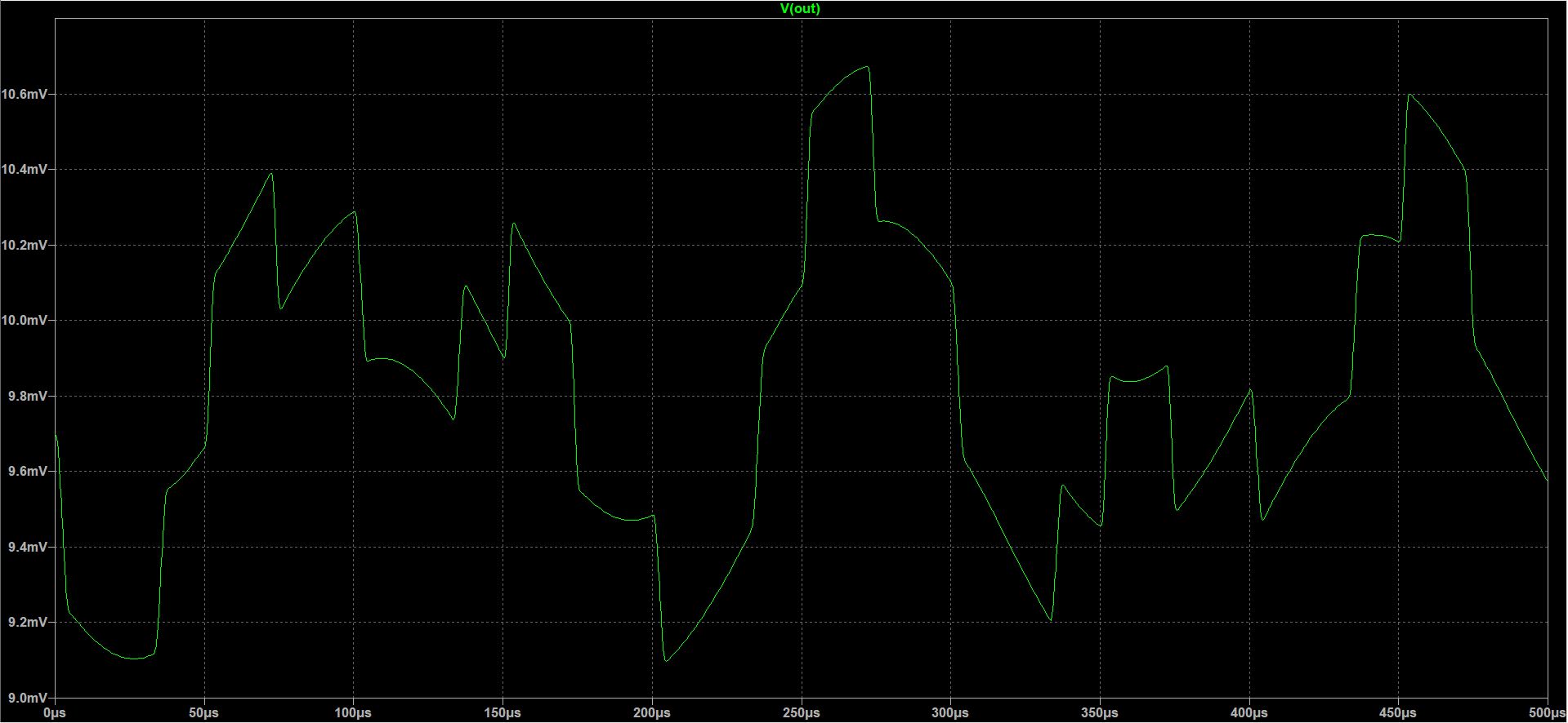

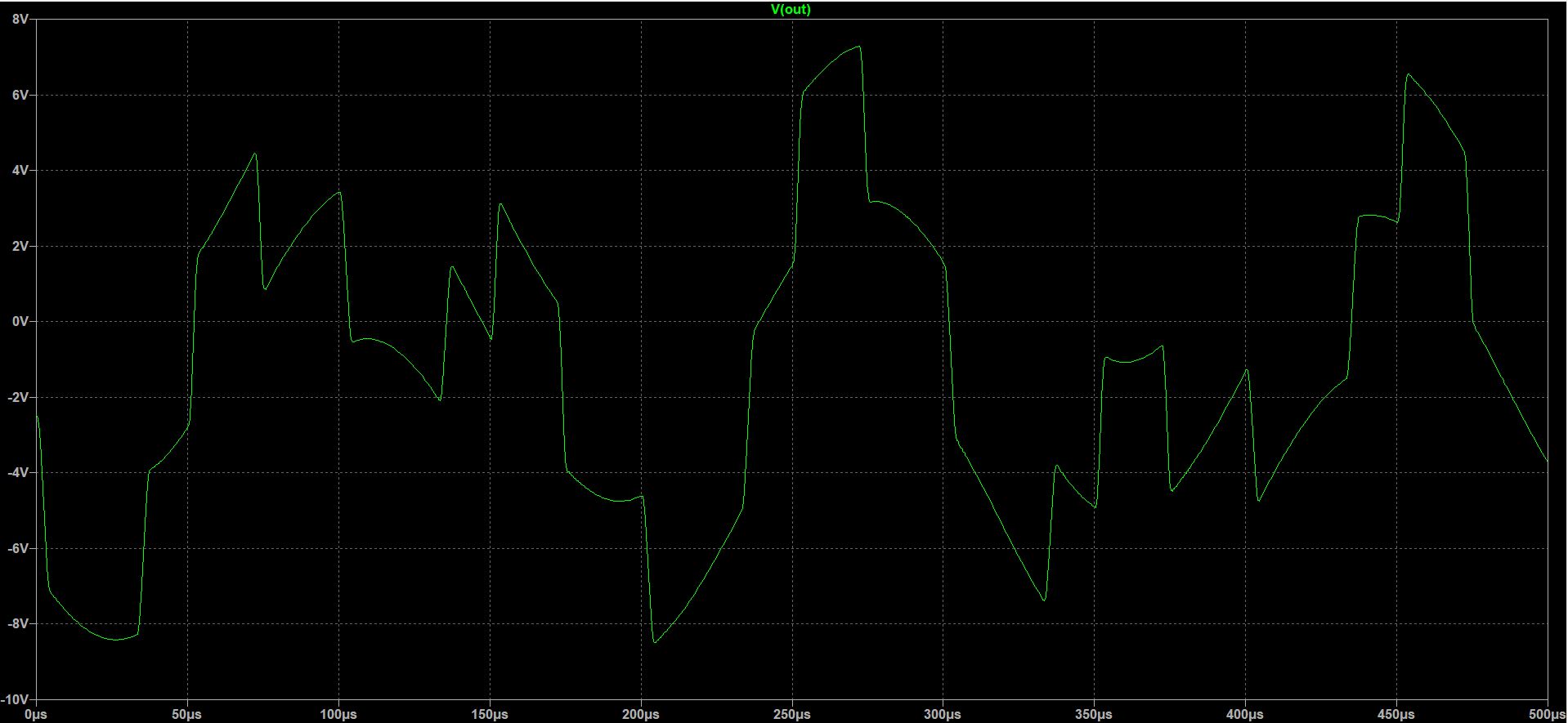

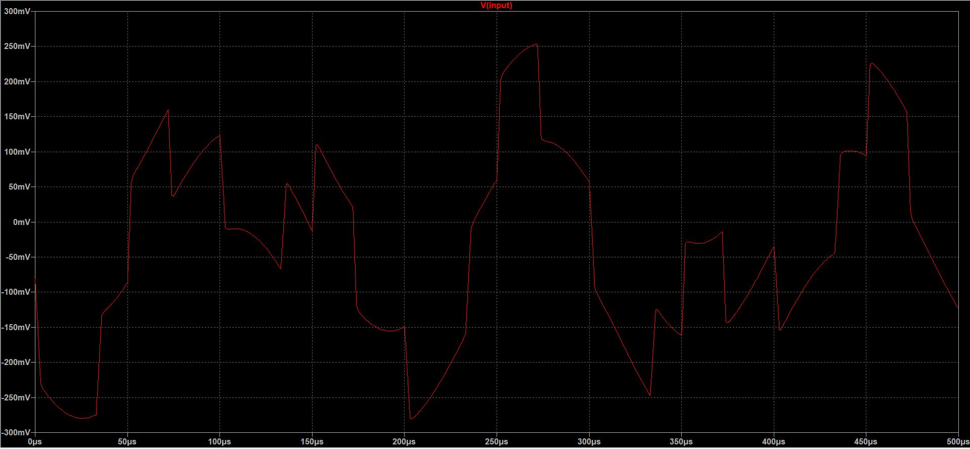

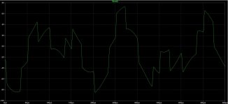

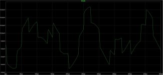

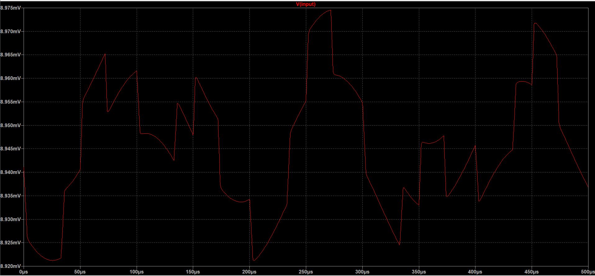

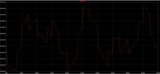

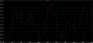

Hello Stef,
I have last done transient simulation with the following function generators, this at levels from 0.05mV to 0.5V at the input. This is to study small signals / large signals, harmonic behavior (square waveforms amplification) and aspects how capacitors for voltage stabilization affect the amplifier back.
1. sine 6kHz
2. sine 100 Hz
3. pulse 0,03ms negative amplitude 10kHz
4. pulse 0,02ms positive 0,05 ms delay 10kHz
All 4 signals at the same time of course.
Regards Tim

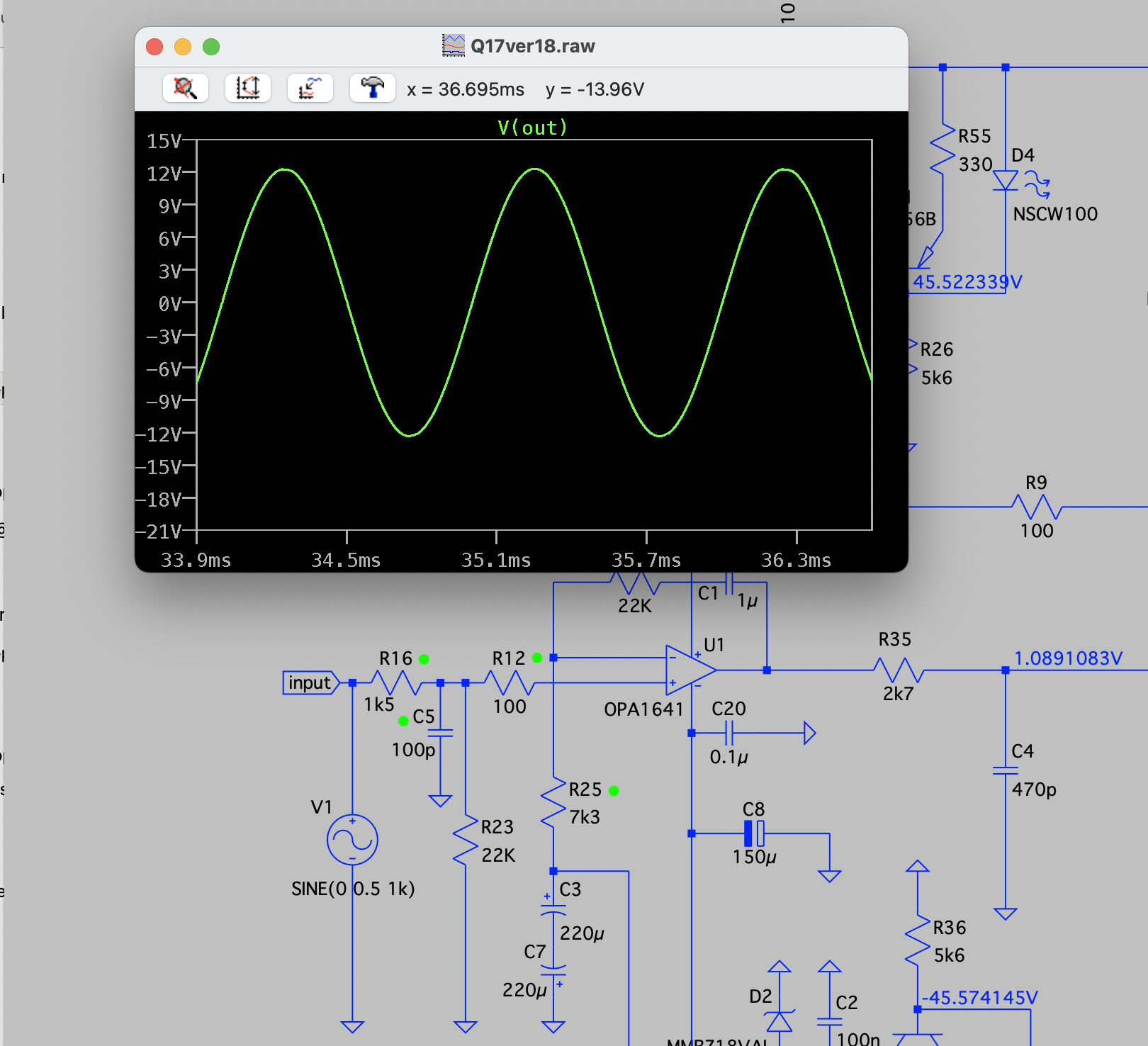

Hello Stef,
two things:
1. the simulation with the GND resistor R32 is much closer to reality.
2. I threw out the input resistor again and by installing an inductance L2 with an internal resistance of 7 - 10 Ohm (6.8 uH to 15 uH) the gain of the amplifier drops sufficiently (by 3 to 4 dB).
I expect that the amplifier loses authenticity when the resistance between the capacitors C2 and the OPA is increased. This changes the balance of the feedback from the output (I know, this is a DC servo and not feedback in the usual sense, but then it would make absolutely no difference how big the resistance R23 is. But since a difference between 10k and 8k of R23 can be heard, C2 does not behave ideally, but as an erroneous capacitor with a higher error angle. Therefore, no single low ESR capacitor works well as C2).
Tim

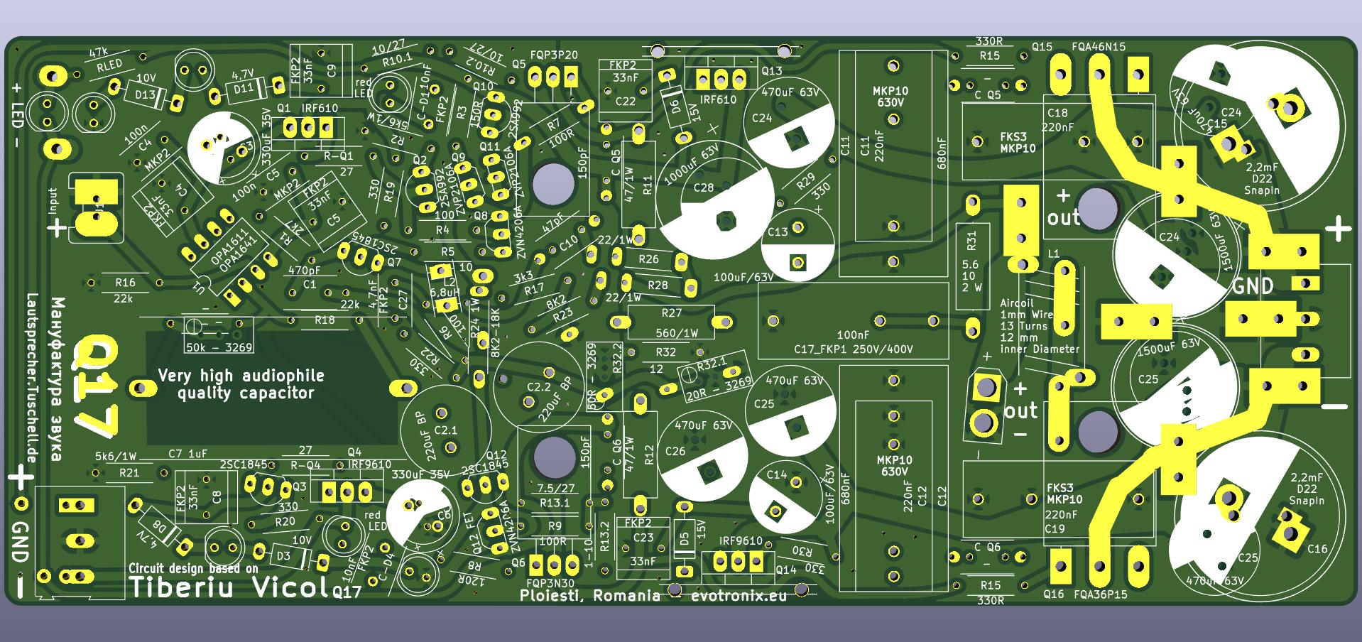

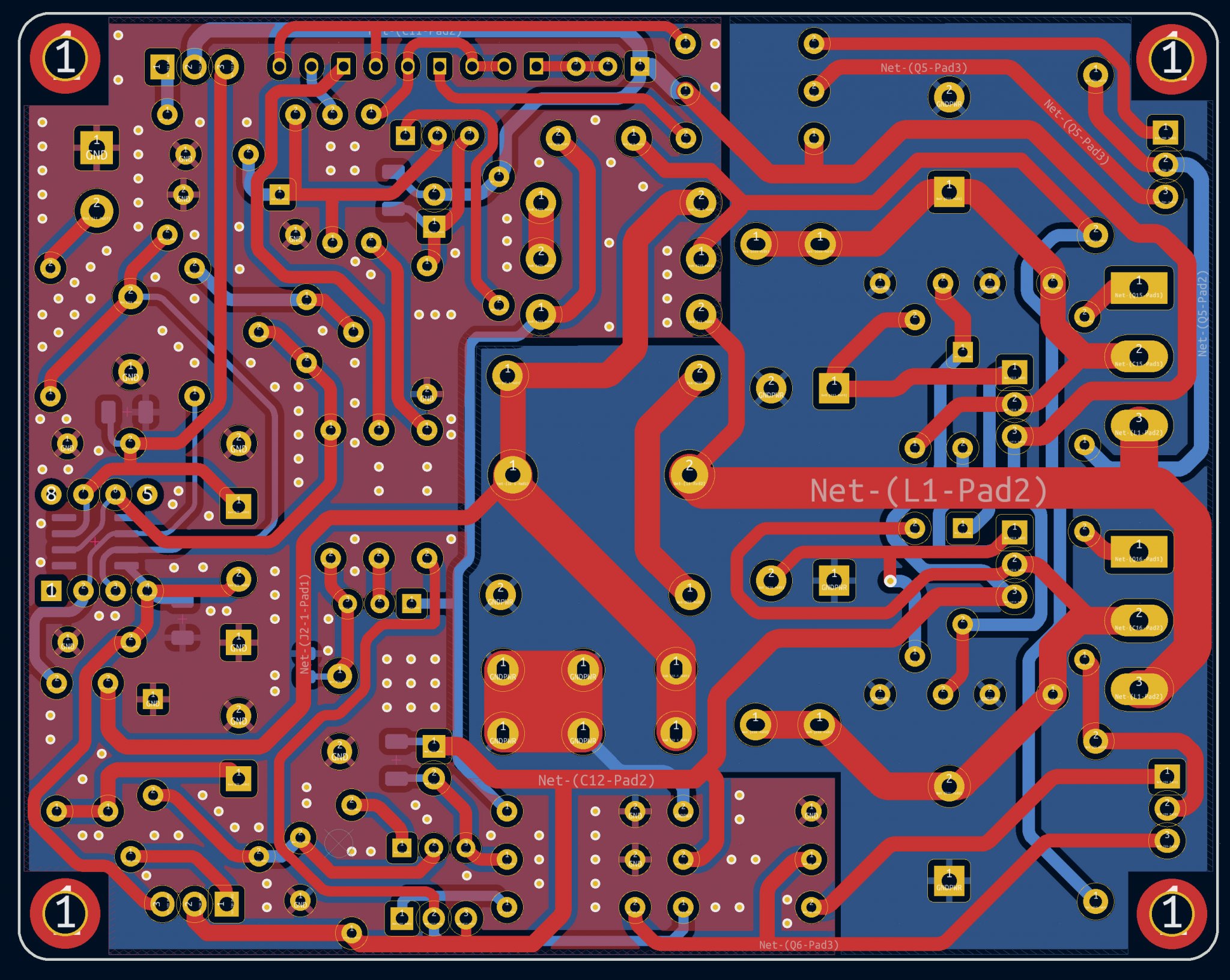

For the next Q17 test I have now ordered PCBs and these are based on the optimisation with the LTspice model on the one hand, so I have also made a modification to the ground system and I want to test Q12 as MosFET.
Q7 as JFET does not simulate nicely until now, especially in the small signal range, there should still be a lot of background noise. That's why I'm putting this on hold.
The PCB looks totally chaotic, as usual, but that doesn't matter to the electricity. In any case, many design notes have been incorporated, so I can see if they help.
Tim
There is a LPF after opamp that limit amplifier BW at ~125KHz.
I do not use input LPF because internal cabling and PCB layout can eliminate any EMI. Cabling matter, pcb layout mater a lot.
If you want to "secure" input opamp I would go for a LPF at 1MHz. For this use 1K5 with 100pF.
