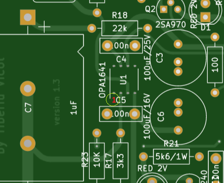

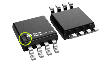

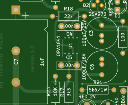

Quick question guys on the opa1641 orientation on the original tibi layout. I see from the gerber view the opamp sides have 2 white lines with being bigger than the other. Then the datasheet of 1641 from the below pic has a notch on one of the sides. Please let me know which side of the white lines does the notch on the opamp goes?
The schematic shows a 100nf decoupling cap at pin 7. The PCB image shows
that right where "C4" is printed, so I would say that is pin 7. Pin 6 goes to 22K resistor, so that is
further confirmation.
Correct. That larger line indicates the pin 1 of the OPA.The schematic shows a 100nf decoupling cap at pin 7. The PCB image shows
Yes, the notch indicates Pin 1 of the IC - that should go towards the larger line.
Pin 2 would be exactly where the silk screen legend has "C5" in the image below, and
Pin 7 would be where you see "C4" below.
Check for continuity between the input jack (not the grounded pin - the other one) and
the opamp pads on the PCB - the pad where you get a continuity beep is pin 3.

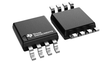

I just opened my opamp package from Newark/element14 and its a different marking which does not have the notch per the above data sheet but a single white line on one of the sides. Now this line should go towards the bigger white line on the PCB marking where OPA1641 silk screen marking?
Look carefully - one edge is bevelled - that edge would be on the side with pins 1 to 4.
See the cross section shown in this link
https://fdi.sk/posts/wrong-opamp/

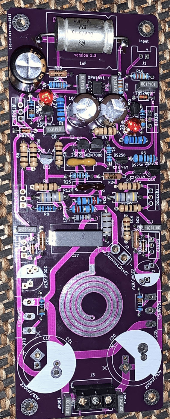

Looks good! That purple solder mask looks awesome, and it is
so great to be able to see the traces on the PCB, unlike the
matte black which seems to be in vogue now.

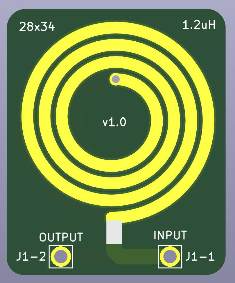

Hello,
If anyone is interested, I made a small PCB of the 1.2uH coil using the Tibi KiCad footprint.
Gerbers and KiCad sources are available on my GitHub repository.

Thank you, yes first time printed in Purple and they seem to look very good. Progress so far with the parts in my stash, need to get the higher voltage electrolytics 220/2200uf in 63v.Looks good! That purple solder mask looks awesome, and it is
just a little note: Nice board. Is it possible that you used 4.7 instead of 47ohm? In the picture it looks like a silver 4th ring.
One more thing, if it sounds very sleepy or dull, swap C7 for an audiophile foil. Regards Tim
Thanks will check the resistors as I remember checking every one in DMM before soldering. Also R26/28 I used my spare 22R but in 0.5w but the schematic says use 1W here. I hope the wattage would be fine otherwise need to replace with 1W.
Regarding C7 I like these Russian PIO caps but yes I do have other caps like Wima/Panasonic too. Will swap them later once I listen to these first.
