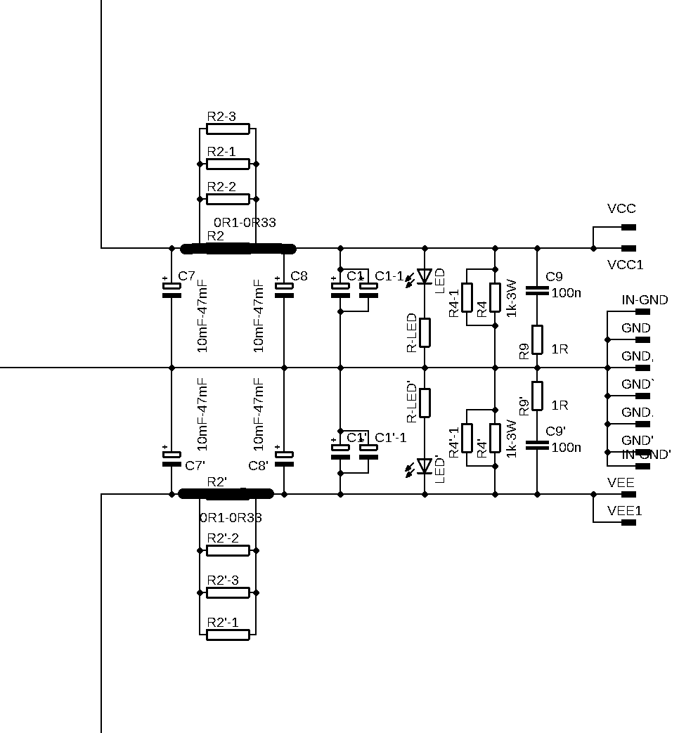

yes Stef that is the first plan for me to remove the existing resistors and short them 👍Hi manniraj,
Just shunt the resistors of your LT4320 PSU.
Stef.
If your power supply does not work with the Q17, you can always buy this PCB. It's not expensive and it works very well.

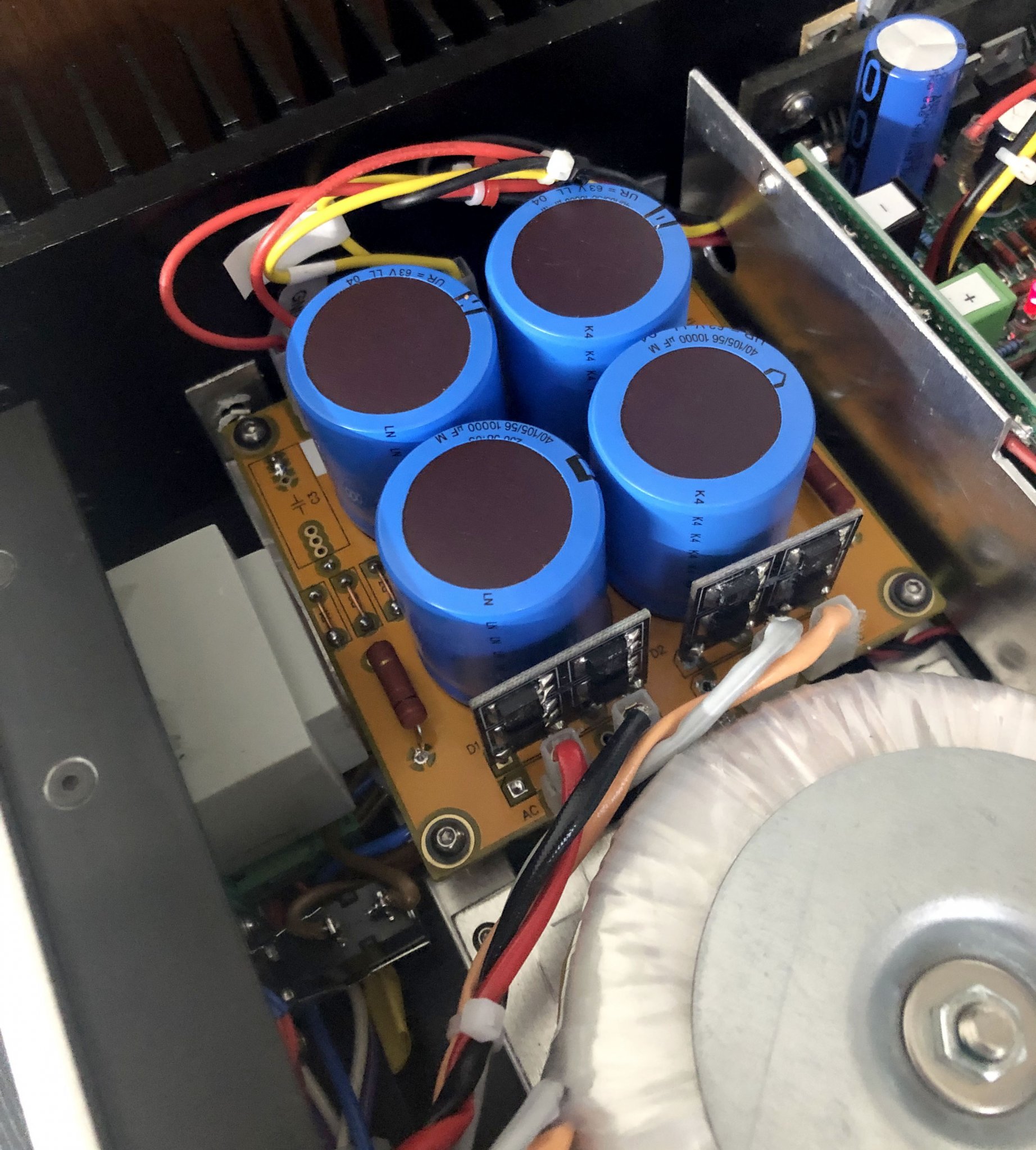

These psu boards seem to be similar to what Prasi laid out with 4 caps and optional resistors either a pair of BPR per side or using Panasonic 0.47R multiple ones underneath the PCB. I am using those psu boards as dual mono in my pass amps. I can use the same psu but remove the resistors and short them. Prasi psu boards are pretty good and robust 🙂
Q17 is a class B amplifier and I already mentioned that CRC should never be used in a class A/B or B amplifier
Tibi, can you briefly explain why PSU with CRC filter is not good for AB/B class amp?

II'll try to keep it short and simple - KISS. 🙂Tibi, can you briefly explain why PSU with CRC filter is not good for AB/B class amp?
Due class B operation that require high variation of current, resistor inside CRC filter will "see" a large voltage variation across him. Take Q17 where output currents may go form 0A to ~ 5A. A CRC filter with only 1 ohm resistor will see up to 5V modulation. The capacitor behind resistor will not help much and in fact will increase peak voltage.
Sonically this is translated in lazy sound, with poor dynamics and overall soft performance. Some people like this. Not me.
Same thing is happen with diode rectifiers. Voltage across each diode is modulated with load current. At 1A a Schottky diode is already at 0,6V voltage drop and at 5A is over 1V. Soft recovery diodes may go as high as 2V or higher at high voltage operation.
If you want a top performance amplifier ... I already mentioned what you should use.

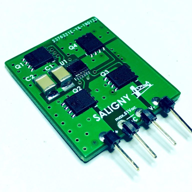

Hello Tibi,
You recommend this active bridge rectifier ?
https://evotronix.eu/main/
SALIGNY Standard
I use industrial diode bridges,
I surely have something to gain by replacing them.

@juju35135
Yes, Saligny Standard is my commercial design. A free THT version was posted by me in case you want to build yourself.

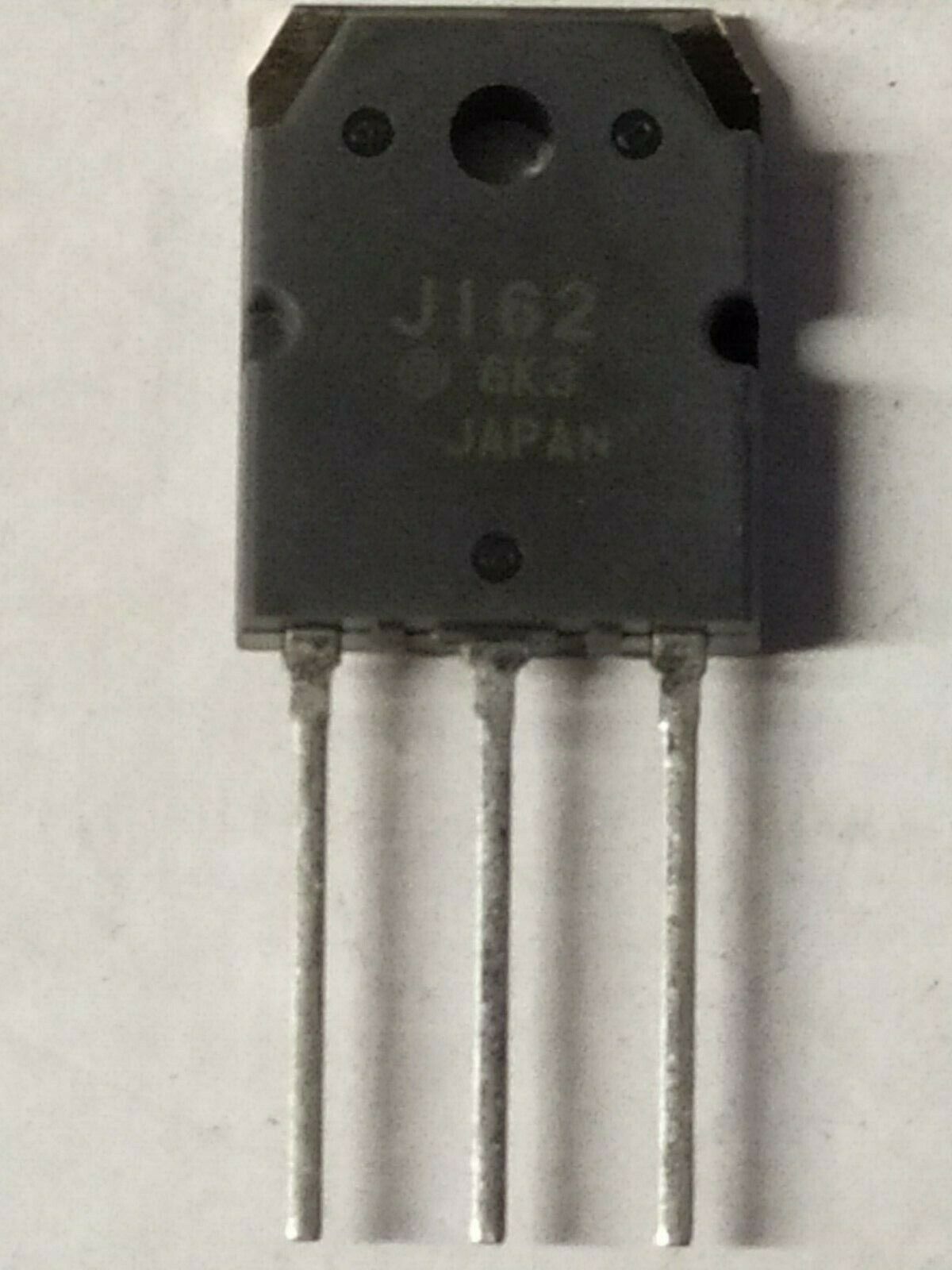

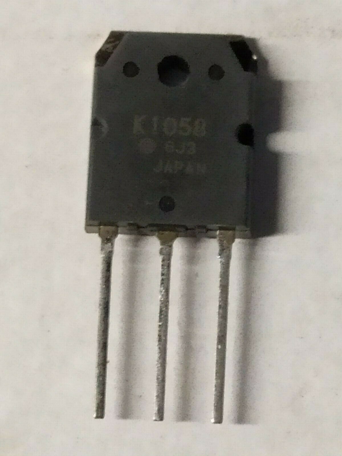

2SK1058 / 2SJ162 are lateral mosfet. These exhibit low transconductance. On other side, 2SK1058 / 2SJ162 are rugged and well regarded mosfets. As output drivers, these sound very well if you use easy to drive speakers with high SPL.
If you get these at very low price, you may adapt your PCB and use them in place of Q5 and Q6. No other schematic modifications are need.
Tibi

@juju35135
@tvicol
Hi Tibi, I'm not familiar with SMDs...
When I have some extra money. I will buy you a pair of rectifiers, it will be enjoyable to support your company. 🙂
