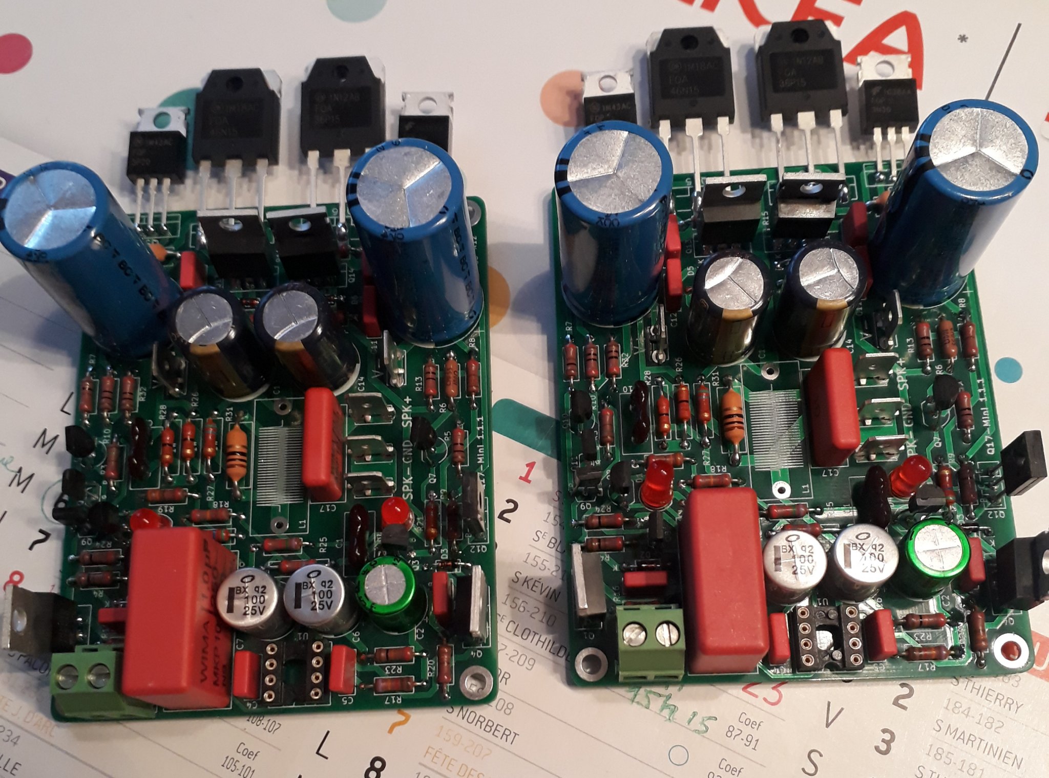

Hello Tibi, hello everyone,
I assembled my Q17mini boards using the PCBs designed by Stef1777
They have been working for a week, the results are promising.
Next step put in a case and enjoy 🙂
@Stef, I hope you will solve the problem on your prototype...
The boards operate at +/- 50V, linear PSU / 300VA

@juju35135
Congratulations !
Maybe you can comment on sound. How do you compare it with other amplifiers ?

Hello,
@Stef
Good news, you found the problem, ready for further testing and optimization 🙂
@Tibi
Thank you for your support,
Not having the power supply for the speakers protection module yet,
I just listened to the Q17mini on cheap loudspeakers...
Anyway, the sound is powerfull, very clear with good bass.
This weekend I started the casing, drilled the heatsinks and started attaching the boards....
When everything will be OK and after a little burn-in I will do some comparative listening and will keep you informed.
Julien
